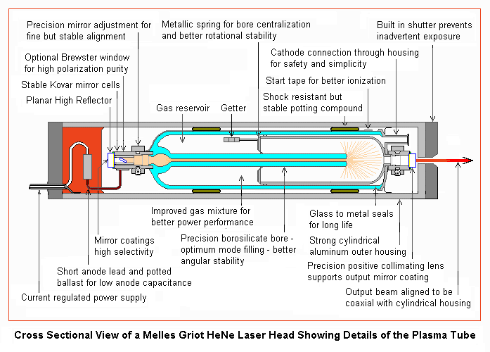

    The end of the mount is divided in two with a gap between the first and second sections. At the time of manufacture, HeNe laser tubes are aligned for optimum power output.
    On some HeNe tubes (as well as internal mirror argon ion laser tubes), this gap may me covered by a ring with three (3) adjustment 'grub' screws as shown below:
           \     ___
    	 \ _|   |_
              | |(X)| | |====> Laser Beam
    	--|_|   |_|-
    	 / ^|___|^   (X) denotes adjustment 'grub' screw (1 of 3 shown).
               |  |  +--- Adjustable part of mirror mount
               |  +--- Ring with three (3) grub screws
               +--- Fixed part of mirror mount
