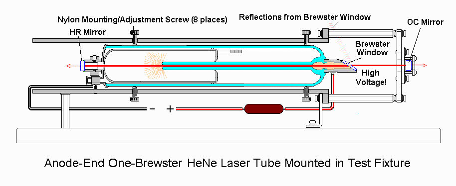

    Recall that green (543.5 nm) is one of the lowest gain of all the common HeNe lasers. So, getting any sort of green laser to work will be quite a challenge.
    I do have a working green HeNe laser using a special one-Brewster HeNe tube with an HR optimized for green and a matching HR mirror. OK, so the output isn't anything to write home about - maybe a µW - but the circulating green photon flux is fairly impressive. However, this setup is just about perfect in every way with an optically contacted fused silica Brewster window and super high reflectivity mirrors for both HRs. See the section: A Green One-Brewster HeNe Laser for details. But it's amazing that such a short (26.5 cm) one-Brewster tube will lase green at all!
    Also see the section: More on Other Color HeNe Lasers.
    (From: Steve Roberts (osteven@akrobiz.com).)
    The green HeNe lasing line was first observed by D. L. Perry. See: "CW laser oscillation at 5433 Å in neon", D. L. Perry, IEEE Journal of Quantum Electronics, vol. 7, no. 2, Feb 1971, pp. 102.
    Summary: CW laser oscillation at 5433 Å has been observed in the He-Ne laser. The transition is from the 3S_{2} to 2p_{10} level and is the 9th in this group of nine allowed transitions to exhibit laser oscillation....
    "Green #1 used a 65 cm long, 4 mm ID tube with a 7:1 fill ratio of He:Ne. Both optics had a 1% transmission at 594.1 (yellow) to kill that line. The current range was 16 to 40 mA (!!).
    The 611.8 nm (orange) line was used to align the laser (using red/orange optics). Then the green HR mirror was installed in the beam to align it and then the red/orange optics were removed."
    He obtained a power of 50 µWatts with this setup.
    Hey, but that's still much greater than the output power of that green one-Brewster HeNe laser and also greater than the output power of my red two-Brewster HeNe laser described in the sections starting with: Sam's DIY External Mirror HeNe Laser - Some Assembly Required!.

    One-Brewster HeNe Laser Parts and Assembly
    A drawing of a typical one-Brewster HeNe tube is shown in HeNe Laser Tube with Internal HR and Brewster Window with External OC mounted in its laser head along with the external mirror mount detailed below. This is the CLIMET 9048 laser head which uses the Melles Griot 05-LHB-570 one-Brewster HeNe tube.
    I have a limited quantity of CLIMET 9048 laser heads (with or without power supplies), as well as Melles Griot 1-B laser tubes, available for sale. See the section: Sam's Stuff for Sale or Trade and Items Wanted.
    The parts list and mirror mount drawing is provided below:
    (Not listed is any hardware required to mount the laser head and mirror mount assembly to a baseplate or enclosure.)
    The left photo in Sam's External Mirror Laser Using One Brewster HeNe Laser Head shows the complete system with mirror mount and an SP-084-1 OC mirror installed in the Simple Mounting Cell for Salvaged HeNe Laser Tube Mirrors. A Melles Griot 05-LPM-379 power supply brick set for 6.5 mA provides the excitation. The middle photo shows the adjustable mirror mount and support standoffs. This assembly can be easily swapped to another similar one-Brewster HeNe head requiring at most a touch-up of the mirror alignment. For the right photo, an SP-084-1 HR mirror has been installed in place of the OC to maximize the internal circulating power. The scatter of the 500+ mW circulating photons from the random dust particles (in a relatively dust-free office environment) is quite visible.
    Note that this HeNe tube operates reliably from a small HeNe laser power supply like the Melles Griot 05-LPM-379 because it has a wide bore and thus a low operating voltage (1,470 V from the power supply at 6.5 mA assuming a 68K ballast resistance). However, the 05-LPM-379 would appear to be a bit marginal for starting (8 kV instead of the 10 kV listed for the tube) and one recommendeded Melles Griot power supply is actually the 05-LPM-939 which has a somewhat higher maximum starting (and operating) voltage. While these tubes will work on either supply, starting is very quick with an 05-LPM-939 even for a tube that might (on a bad day) take a minute or more to start using an 05-LPM-379.
    Mirror Mount Plates for One-Brewster HeNe Laser has the mechanical details for compatibility with the CLIMET 9084. The only critical dimensions are the locations of the 4 corner holes and center hole. Everything else can be modified for use with your particular mirror(s). If you don't have some aluminum scrap, even Plexiglas or other rigid plastic can be used in a pinch. The hardware should be readily available from any electronics distributor or your junk box. :). The fixed aluminum plate and 4th standoff can be eliminated with a slight reduction in stability as shown in Anode-End One-Brewster HeNe Laser Tube Mounted in Test Fixture. (This also happens to be one of the less common tubes with the Brewster window connected to the high voltage.)
    If your junkbox is bare and you don't want to 'invest' in standoffs, 6-32 threaded rods or long screws and some extra nuts and washers could be substituted instead with slightly lower rigidity and ease of set up, but the standoffs are really much better. In any case, don't be tempted to use too thin a material for the mirror mount plate (not less than 1/8" for aluminum) as the adjusting screws may warp it enough to really confuse things. :( One-Brewster HeNe Laser Head with Very Simple Mirror Mount shows such a setup with a piece of a barcode scanner spinner mirror for the OC (though it actually is more of an HR in terms of reflectivity). This arrangement isn't fancy or elegant but is quite stable and relatively easy to align.
    Here is the parts list for the simplified setup:
    Or go a bit less basic as shown in Enhanced Simple Mirror Mount for One-Brewster HeNe Laser Head, built by Dave (Ws407c@aol.com) for one of these (purchased from me). He added springs and wing nuts which allow for easy adjustment (possibly too easy though as bumping one will mess it up!). Actually, the photo makes the mirror mount look much spiffier than it does in person. :)
    Almost any planar or high Radius of Curvature (RoC=r, more than about 12 inches) high reflectivity (R, more than about 94 to 96 percent at 632.8 nm) good quality first surface mirror will result in lasing action if mounted next to the Brewster window. However, the range of positions beyond this for the resonator to be stable will depend on the actual RoC as noted above. Here are the rules:
    Where:
    In practice, lasing may not continue quite to the limits but should come close.
    While OC mirrors from 5 or 6 inch barcode scanner HeNe tubes have adequate reflectivity, their RoC may be so short (typically 26 cm for the OC) that no lasing is possible until the mirror is more than 60 cm from the internal HR (more than a foot from the Brewster window). And, some longer HeNe tubes like the Siemens LGR-7641S use the same 26 cm radii for the OC mirror so tube length alone is no guarantee of a suitable OC curvature.
    Some examples of the approximate range of positions (*) where an external mirror (e.g., OC) of a particular RoC should work with the internal HR having an RoC of 60 cm:
     Distance to HR: 0  10  20  30  40  50  60  70  80  90  100 110 120 130 140 cm
           26 cm OC: (        =\              *********
           45 cm OC: (        =\*******       *****************
           60 cm OC: (        =\*************************************
           80 cm OC: (        =\*************         ***********************
          Planar OC: (        =\*************
    Dielectric mirrors are much better than aluminized mirrors but the latter may work in a pinch (though not that well, and some just don't have the required reflectivity even though they may look identical). I've gotten several mirrors from HeNe laser based barcode scanners and an old HeNe laser based laser printer to work with these HeNe tubes. A high quality dielectric mirror with very high reflectivity (e.g., greater than 99.9 percent such as a HeNe laser HR) and low losses should result in a great deal of circulating power inside the resonator - possibly up to a WATT or more and a very visible beam in there unless you are in a clean-room, but only a weak output beam. The OC from a typical medium length HeNe tube will result in a more modest 300 or 400 mW inside the resonator but a useful output beam of 1.5 to 5 mW. A mirror from that laser printer produced 750 mW inside the cavity with a 0.9 mW output. And those barcode scanner spinner mirror chips result in very high circulating power with only a few hundred mW of output. As a matter of fact, it is likely that these non-laser dielectric mirrors are actually probably better quality than the laser-quality mirrors of the 1970s.
    Even with just a bare tube or laser head without the external mirror mount, it is quite easy to test a mirror by holding it about 2 to 3 inches away from the Brewster window positioned so that the reflection of the light of the discharge from the bore is centered around the Brewster mount. Then, rocking the mirror about this position should yield flashes quite quickly if the mirror has adequate reflectivity and is of high enough quality. Thus the lasing ability of a newly acquired one-Brewster tube or head can be easily determined without constructing the mirror mount as long as a suitable mirror is available. Or, evaluating a newly acquired mirror using a known good one-Brewster tube.
    These HeNe tubes usually can produce a beam which is TEM00 or multimode depending on the mirror and a stop inserted inside the cavity. (This should happen on a red HeNe laser when the ratio of the aperture diameter to mode radius is about 3.5:1.) The higher order mode structure is quite interesting (not just a rectangular array). Higher quality mirrors will result in a more well defined mode structure. There is enough gain that additional Brewster angle optics (even a cheap microscope slide) can be introduced inside the resonator to act as an etalon, and possibly optics that are just AR coated as well.
    Note that there should generally be no need to touch the alignment of the internal mirror to get these to lase unless someone before you had mucked with it. I don't particularly recommend attempting this alignment though since unless the output beam is obviously non-circular (oval or cut off) even with the external mirror aligned for maximum output power, any benefit will be minimal. However, where there is a locking collar present, some careful tweaking (basically walking this mirror and your external mirror) is relatively low risk and may result in some additional output power by centering the intracavity beam in the bore. Only attempt this while the tube is lasing (unless you enjoy going through the entire alignment procedure using an external alignment laser) and take care with the high voltage! Where there is no locking collar, a standard Melles Griot locking collar from a dead HeNe laser tube can be installed.
    However, with a mirror and lens for the external mirror, it can be even easier to get these things lasing with basically no alignment. The mirror and lens are rather special though. See the section: Cat's Eye Mirror for Hassle-Free Alignment. I need to scrounge something along these lines. :)
    Initial Tests and Mirror Evaluation
    The one-Brewster HeNe tube I have is part of a CLIMET 9048 laser head, original application unknown (but likely particle counting or something like that). The actual HeNe tube is a Melles Griot 05-LHB-570 rated at 4 mW output with a matched OC mirror. (Since there are previously owned tubes, getting that much output power may be optimistic but the ones I've tried will all do at least 2 mW with sub-optimal mirrors, see below.) In order to test it, I constructed a mirror mount similar to the one described in the previous section. This enabled various mirrors to be easily installed and aligned and provided access to the inside of the laser cavity. Small mirrors could be 'quick checked' for lasing ability by positioning them inside the cavity (in front of any mirror that is already in place) and then attached to permit fine alignment.
    First, I fired the unit up on a Melles Griot 05-LPM-379 power supply brick to confirm that the tube was intact and had the correct discharge color. It did, though I figured this power supply might be a bit marginal. From the bore diameter of at least 1.4 mm, it would appear to be a tube which would tend to produce a beam with multiple transverse modes and would require a higher current than typical for narrow bore TEM00 HeNe tubes for maximum power output. During the subsequent tests, I used an adjustable HeNe laser power supply (the one described in the section: Aerotech Model PS2B HeNe Laser Power Supply (AT-PS2B) with a Variac (and its internal regulator disabled). A tube current of about 7.5 mA resulted in maximum power output. Note, however, that Melles Griot actually recommends 6.5 mA for the tube current and it turns out that the 05-LPM-379 power supply brick will provide this with no problem.) I don't know how life expectancy will be affected by runnnig at the higher current and the ballast resistor supplied with the CLIMET 9048 laser head may overheat after awhile.
    The OC-end of the laser head has a flange with conveniently located holes to attach the external optics. I used 4, 2-1/4" x 1/4 threaded spacers to mount a pair of 2"x2"x1/8" plates, the second of which is adjustable via using a hex wrench via cap-head screws and split washers used as springs. My mirror mount. :) See the HeNe Laser Tube with Internal HR and Single Brewster Window and External OC.
    Based on the geometry (assuming that the HR mirror has a radius of curvature of 60 cm as I had been told and later verified), a stable resonator should result for an external mirror at a 30 cm distance from the HR as long as its radius is between +30 cm and planar (concave) or -30 cm and planar (convex). This means that except for some short radius barcode scanner HeNe tube mirrors, almost anything else with enough reflectivity at 632.8 nm should work. At this point, I didn't really know the value of the required reflectivity to achieve threshold.
    I had several possible mirrors to try both from deceased internal mirror HeNe tubes as well as from a couple of external mirror HeNe lasers. Initially, for rough alignment, I used another HeNe laser (the A-Laser) firing down the bore of the 9048 without the OC in place. The returned a strong nicely focused reflection which (indicating a curved/concave OC) and centered in the A-Laser's output aperture. Then, without disturbing anything, the candidate OC-mirror was installed and the mirror mount adjusted to center its reflection in the A-Laser's output aperture.
    I first tried the OC from a dismembered tiny barcode scanner HeNe tube - a Melles Griot 05-LHR-002-246. No amount of fiddling resulted in any output beam. Nor did the use of its companion HR. (Using an HR mirror in place of the normal OC to test a laser results in the lowest lasing threshold since it maximizes round trip gain. Thus, it should be easiest to get going where losses are unknown. For a high power laser, this can be risky since the oscillations in the resonator could build up to a sufficient level to actually damage the optics. However, for a low power (at least) HeNe laser, such effects are unlikely.) I assume that these mirrors were unsuitable either because the reflectance was too low (for the OC) and/or they were curved with a radius of curvature that was too small (almost certainly the latter). (Later I did achieve lasing with that same HR. I don't really know what caused it to fail the first time.)
    Next, I tried the HR mirror from an unidentified (but probably Hughes) internal mirror HeNe tube, using the same alignment technique. And, almost as soon as I touched the adjustment screws to center the its reflection, a beam appeared! I almost missed it shining back into the A-Laser but then noticed the really bright scatter off of the Brewster window. With the a bit of tweaking and HR mirror adjusted for maximum output, the beam was weak (maybe 10 µW, just the minimal transmission through the HR that is normally considered waste!) but this was success! While not exactly strong, it was stable. Of course between the OC and the Brewster window, there was probably several hundred mW bouncing back and forth as evidenced by the dancing illuminated specs of dust. :)
    As expected, the laser produced a beam with multiple transverse modes - perhaps TEM44 though somewhat jumbled (not a nice rectangular or hexagonal array).

    Demonstration One-Brewster HeNe Laser
    I acquired a 3 mW HeNe laser that was built into a wonderful Plexiglas box with an output fiber-coupler. This was the aiming laser for some sort of big dye or YAG laser. Since 3 mW HeNe lasers are somewhat boring, even with exposed innards, I decided to replace the tube with one of the bare 05-LHB-570s and the fiber-coupler with an adjustable OC mirror. The result is shown in Demonstration One-Brewster HeNe Laser. The adjustable OC mirror mount is just the platter stack hold-down plate from a defunct harddrive seated on an O-ring with 4 screws. The OC mirror itself, installed in one of my standard mirror cells, is from an SP-084 HeNe laser tube. (I saved the fiber-coupler and fiber for future use - it has the standard hole pattern for mounting on most Melles Griot cylindrical laser heads.) Although not perfectly sealed, the Plexiglas cover provides enough protection so the Brewster window doesn't seem to require cleaning even after months of sitting on a shelf in my dusty basement, err, laser lab. :)
    A few months after constructing my one-Brewster HeNe tube test fixture (see the section: HeNe Laser Tube Test Fixture), I was given an 05-LGB-580, a tube identical to the very high quality 05-LHB-580 but with an HR mirror optimized for green (543.5 nm). Popping this tube into the test fixture along with a matching green external HR mirror, it took only about 5 minutes and there were piles of green photons bouncing back and forth between the mirrors! However, having previously gotten a HeNe tube with an obliterated mirror coating to lase (see the section: External Mirror Laser Using HeNe Tube with Missing Mirror Coating), I figured I could even make a carrot lase, so this green tube really wasn't much of a challenge at all!
    The setup is shown in Hughes Style One-Brewster HeNe Laser Tube Mounted in Test Fixture.
    To align the mirror, I first set the mirror adjustment screws so the mount was just snug. Then, while gradually tightening the Y adjustment screw, I rocked the mount in X by (pressing and releasing the plate near the X adjustment screw) until there were flashes of green light reflecting off the Brewster window, and then tightened the X adjustment screw to obtain a stable beam. Fine tuning of X and Y peaked circulating power by maximizing the size of the beam scatter on the Brewster window's surface (and thus the number of transverse modes).
    Note that since this tube has a glass Brewster stem (the part that holds the Brewster window), it isn't possible (or at least easy) to view the reflection of the bore light back from the mirror (the glow from inside the tube is too bright.) One option is to put a shroud over all but the central area to block this light. However, an alternative way to align the mirror is to view the reflection of the bore light from the mirror off of the Brewster window (from the direction shown in the diagram for "Reflections from Brewster Window"). When this lines up with the reflection of the center of the mirror itself, alignment should be close enough for lasing - you will see flashes. Then, fine tune. CAUTION: For a low power laser like this, viewing the reflection is safe even if it is lasing at full power as what comes off the Brewster window is much less than a mW. However, don't even think about looking at any such reflection for higher power lasers!
    Since both mirrors are very high quality HRs, not much comes out the ends (perhaps a µW or so) but the 4 reflections off the Brewster must total 0.1 mW. This thing came right up with difficulty (or lack thereof) of alignment and mode structure similar to the red one-Brewster tubes but lases green! There is probably several hundre mW, perhaps more than a 1 watt of circulating power based on the brightness of the green photons bouncing back and forth in there. It's nice and stable except that dust just loves to collect on the Brewster windows. Now, what can I do with high green photon flux?
    I tried inserting a microscope slide at the Brewster angle as well as nearly perpendicular but all variations killed lasing entirely - not surprising given the gain (or lack thereof) for the green line. And, as confirmation of how low the gain really is, while I can leave a red one-Brewster laser out for a week and have it come right up with nearly full power (at least by eyeball), I usually have to dust off the the Brewster window on this green one to get anything after only a few minutes (or less depending on conditions in my 'lab'). But then I'm still amazed that such a short tube can do green at all! :)
    I wonder what the reflectance of a OC would need to be for optimum output (rather than maximum intra-cavity flux)? I've obtained the mirrors from a physically broken 05-LGP-170, a large green internal mirror HeNe tube. (Don't ask but not mine, courtesy of "Dr. Destroyer of Lasers"!) These should make for some interesting experiments. :) The OC probably won't be optimal, having originated from a 16 inch long tube. But since the 05-LGP-170 was a polarized tube, it did have a Brewster plate inside so that at least will be similar in terms of losses. Hopefully, the OC will still have a high enough reflectivity to lase. If it does, almost any output beam would be stronger than what I have now!
    But, so far, it doesn't look too promising. I can barely get flashes from the salvaged HR and only with a super clean Brewster window - after 30 seconds to a minute of just sitting, enough dust (or something) collects on its surface to kill lasing totally. And, I can't get anything from the OC. Now, I haven't yet mounted them solidly - I'm just holding the mirrors (in their mounts) in my hand so this hasn't been exactly what you'd call a highly controlled experiment. However, with the high gain (relatively speaking) red one-Brewster tubes, it would be more than adequate to test out a candidate mirror. And, I was able to evaluate the matching green HR that came with the one-Brewster tube without difficulty in this manner. So, it must be a super high quality high reflector even compared to what goes inside green internal mirror HeNe tubes. Assuming a circulating power of over 100 mW and an output of 1 µW, its reflectivity must be greater than 99.999%! Since the gain for green is only a small fraction of the gain for red - much less than 1/10th its value, the reflectivity of the mirrors is super critical, even more so with the not absolutely sterile Brewster window inside the cavity. That last decimal point of reflectivity is significant as there just isn't much headroom and even a very small difference between the two HR mirrors can determine whether any lasing occurs at all.
    There is a very slight possibility that the salvaged 05-LGP-170 mirrors are damaged (say from running with reverse polarity) or defective ("Oops, Joe, you know that batch of dud green tubes, we installed the wrong mirrors!") as they did come from a tube that didn't lase and may have been a manufacturing reject to begin with. I could understand the OC not having high enough reflectivity since it was supposed to be for a much longer bore tube but I'm rather surprised that the HR is causing problems. The next step - to mount the HR and see if I can get sustained lasing without an automatic Brewster window wiper - is thus far proving to be very frustrating and so far my 'by hand' approach isn't working - there is no way to know if the Brewster window is clean enough for lasing without the mirrors being aligned and lasing. So, lack of flashes could be bad alignment or a dirty window - a "catch-22" situation.
    Even after setting up a red HeNe alignment laser, I have been unable to get the 05-LGP-170 HR (or even my super LLNL mirror) to do anything. With this rig, I can pop in the matching HR and get green flashes consistently but not at all for the other mirrors. In fact, I can't get any flashes from the 05-LGP-170 HR at all at this point - clean Brewster or not. Apparently, the mirror must have collected a film of crud or dust or something just sitting around and in a bag or from when it was out for testing. It certainly looks pristine but won't cooperate! :)
    I have subsequently tested the 05-LGP-170 mirrors for reflectivity of the green and yellow HeNe lines (using working HeNe lasers to provide the probe beams). For green, they appear to be quite good, at least to the extent that they reflect the green wavelength. Both reflect virtually 100 percent of green light - passing too little green to register on my laser power meter. For the HR, it is just barely possible to detect photons leaking out by eye. But I guess this is still inferior to the HR mirror which works with the green one-Brewster tube. However, the salvaged HR passes the yellow wavelength almost as though the mirror isn't there (less than 25 percent reflectivity) while the OC's reflectivity for yellow is about 98 percent. Either is low enough to kill the lasing on the yellow (and any other visible) HeNe lines entirely - which is surely the intent. Unfortunately, the HR inside the one-Brewster tube also reflects less than 99% of yellow so there will be no hope of getting it to lase yellow or any other non-green colors.

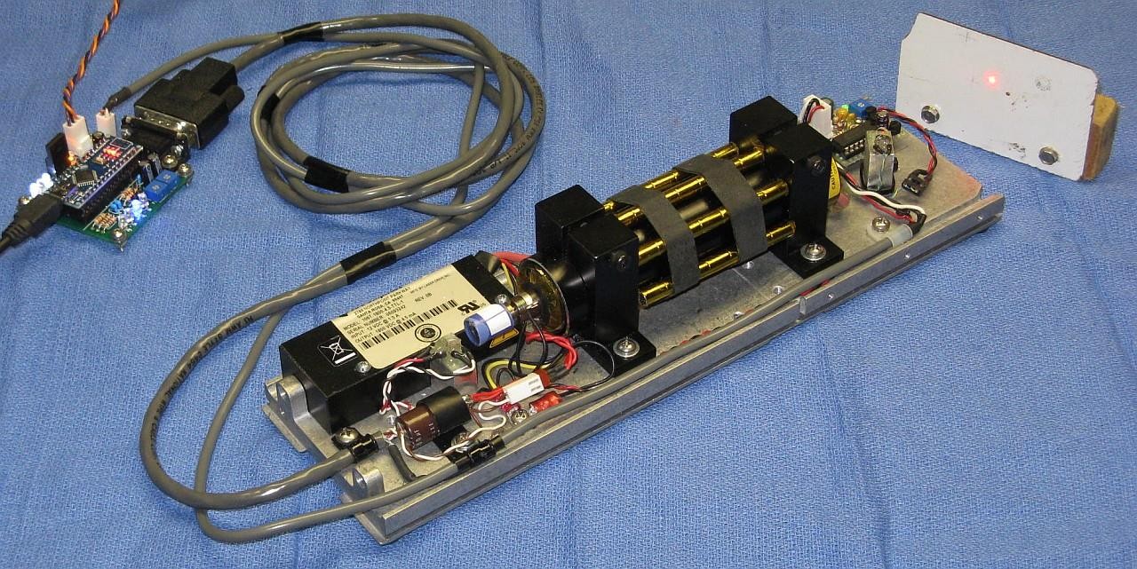

    Stabilizing a HeNe Laser Tube Using a Single Mode
    By using a short HeNe laser tube with a large mode sweep percentage (or with the addition of a polarizer to isolate a single mode), the laser can be locked to a specific power of the waste beam (or sampled output beam) with minimal circuitry. This results in the simplest implementation. But if you want to build a stabilized laser, consider one of the two mode approaches described later in this chapter. They are only slightly more complex but potentially can provide better performance.
    The following description was inspired by the paper: "A Very Simple Stabilized Single Mode HeNe Laser for Student Laboratories and Wave Meters", B. Stahlberg, P. Jungner, and T, Fellman, American Journal of Physics 58(9), September 1990, pp. 878-881. Copyright American Association of Physics Teachers. I have edited the description just a bit and extended it to allow the use of a wider variety of tubes.
    (Portions from: Steve Roberts.)
    1. Find a 0.5 to 1.5 mW (actual output power) random polarized HeNe tube in the range of 4 to 9 inches (100 to 225 mm) from mirror to mirror. Barcode scanner tubes work just fine. These are readily available from surplus dealers and on eBay.
    2. Test the HeNe tube by installing it in a steady mount with no drafts or air currents around it. Apply power and check the following as it warms up for at least 20 minutes. Check for the following:
      • Adequate output power: If the main beam isn't strong enough for your needs, then there's little point on using the tube. However, simply for an experimental stabilized laser, this is generally of little consequence. However, a tube longer than 9 or 10 inches may have too many longitudinal modes to allow stabilization with a single mode output.
      • Well behaved mode sweep: Slowly rotate a polarizer (e.g., Polaroid sheet) in the output to locate the axis of the polarization for the modes. Most random polarized HeNe laser tubes will have adjacent modes which are othogonally polarized with a fixed orientation. As the modes sweep through the neon gain curve, the output power from the polarizer should vary smoothly from a minimum to a maximum with a cycle that gets longer as the tube gets warmer and the rate of expansion slows. At 4 orientations 90 degrees apart, the output power will vary the most and for a short tube, will likely go to zero and stay there periodically. This is good. Mark these orientations on the tube for future reference. But if the output power changes erratically, abruptly, very little, or not at all, the tube should NOT be considered suitable for the stabilized laser project.
      • Consistent waste beam and output beam power: If the waste beam will be used for sampling, this is important for your sanity. It also has implications for stability even the waste beam is not being used for anything. Monitor the power in the waste beam and output beam simultaneously to assure that they track each-other fairly closely. With some mirrors, the temperature of the mirror has a strong effect on reflectivity due to etalon effects inside the mirror glass between the mirror coating and uncoated outer surface resulting in a periodic variation in effective HR reflectivity as a function of temperature. As an example, for a 1 mW tube with an HR mirror reflectivity of 99.97 percent producing 30 µW in the waste beam a change of even 0.01 percent (from 99.97 to 99.96 percent) would result in an increase of 10 µW in the waste beam. If the waste beam was used for intensity stabilization, that would be a 33 percent change in the amplitude! But, it may be difficult to find a tube that is really perfect in this regard since it's not something that most applications care much about. An even simpler initial test is to shine the waste beam on a white card in a dark room and look for a ghost beam off to the side. If one is present, then the HR mirror was ground with wedge and is less likely to suffer from this problem. If there is no wedge, it will be necessary to add an angled plate to the HR mirror using an index matching cement (5 minute Epoxy may be satisfactory if care is taken not to trap bubbles in it during mixing.)
      The best way to do these tests is to use use a data acquisition system or laser power meter with a graphing display capability to monitor the output of one of the polarization orientations (through a polarizing filter) for the main beam and waste beam. The power should appear along the lines of either the red or blue plot of Plot of Melles Griot 05-LHR-640 HeNe Laser Tube During Warmup (Polarized). The 05-LHR-640 is a very short tube so the valleys of the plot may not be as flat or even go to zero power on yours. But the power should always vary smoothly with no abrupt changes. Compare this to Plot of "Flipper" Aerotech OEM1R HeNe Laser Head During Warmup and the closeup of flipping behavior in Plot of "Flipper" Aerotech OEM1R HeNe Laser Head During First Part of Warmup, which are the mode power variations of an otherwise healthy 1 mW HeNe laser head with a chronic case of flipperitis for much of the warmup period. :) The flips are virtually instantaneous, probably order of a few hundred photon round trips in the laser resonator. Also note that the frequency of the mode cycles for a flipper is double that of a normal tube - each mode would normally be what resulted from tracing the continuous curve and not taking the discontinuities as is evident in Plot of "Flipper" Aerotech OEM1R HeNe Laser Head During First Part of Warmup (Combined). So following red-blue-red, etc., ignoring the green lines.
      However, at some point in the warmup period something very interesting occurs: The tube seems to revert to being well behaved! This only happens within a half dozen or so mode sweep cycles of thermal equilibrium and is consistent from run to run. The cause is unknown, nor is it known whether the tube would continue to behave if stabilization was attempted. It may indeed behave since the temperature at which it would run is well above the transition point. Plot of "Flipper" Aerotech OEM1R HeNe Laser Head at Transition to Normal Behavior (Combined) shows the abrupt change from flipper to non-flipper in stark detail. Note that the "envelope" of the mode plot is virtually unchanged at this point but the green transitions have disappeared. There are at most 3 or 4 additional complete mode cycles beyond what is shown and then the temperature of the tube is in equilibrium with its surroundings with only small slow fluctuations remaining.
    3. Obtain a metal film type lab heater that will run off of your power supply, or wind a bifilar heating element using resistance wire or even fine magnet wire. A bifilar winding is desirable to cancel the magnetic field from the heater and is made by carefully wrapping a pair of wires side-by-side for the length of the winding. Short them at one end and drive the coil via the two wires at the opposite end. Since equal and opposite current is flowing along the pair of wires, virtually no external magnetic field is generated. However, an even better arrangement (but one very difficult to do by hand) is longitudinal back and forth glued to the tube. This results in a much higher bandwidth and more predictable response. But that's for the advanced course. :)
      As a guideline, the maximum heater power should be about the same or a bit more than that of the HeNe laser tube. So, for example, if the laser tube is 4.5 mA at 1,400 V (6.3 W) like the SP-117A, a 7 or 8 W heater should work. For a 12 V power supply, this would have a resistance of around 20 ohms. The paper actually suggests double this - about 15 W - which is fine as well and would provide a wider operating temperature range and faster warmup, but also results in higher power dissipation in the driver.
      A home-built heater can be made from magnet wire salvaged from a relay, solenoid, or other similar device. Magnet wire can also be purchased from an electronics distributor. Or, thin film heaters can be purchased from suppliers like Minco. Home-built heaters are less expensive and easily customized to the desired dimensions and resistance/power, but commercial heaters are more convenient since they can be moved from one tube to another without unwinding a hundred turns or more. :) But if your time isn't factored in, they are also much more expensive - $30 or more for a single heater!
    4. Mount the tube at its center with a long aluminum ring and RTV Silicone, or two rings near the ends as long as the tube is free to expand slightly (it doesn't need much - about 0.1 mm!). However, the center ring mound may better isolate the tube from the environment.
    5. Install this assembly in a tight metal box that keeps out stray light and lets the tube reach thermal equilibrium. Painting the box black inside might help to minimize stray reflections causing instability but really isn't necessary as long as the sampling optics/photodiode are enclosed. You can even put the entire thing in a box with a Plexiglas cover.
    6. Poke a hole for the output beam in the box. Use the waste beam off the rear mirror to illuminate a broad area photodiode. Using such a photodiode eliminates the effects of beam wander on the sensor surface. It is very important to arrange the photodiode so there are no back-reflections into the laser tube. Even a very small amount of power back into the laser cavity can destabilize it. At the very least, it will increase the noise level, but might also cause the modes to flip polarization at random times even for an otherwise well-behaved tube. To prevent back-reflections, angle the photodiode (and polarizer) and don't mount them too close to the mirror. To help this, as well as to minimize bore light shining on the photodiode, attach something opaque to the mirror that has a hole only large enough for the waste beam to pass. A red filter to block out most of the bore light would also be desirable.
    7. Although a short tube may have up to a 20 percent output power variation with mode sweep, most are lower and may make reliable and stable locking rather finicky. More importantly, without some means of locking to a specific mode polarization, the polarization of the output when stabilized will randomly be one of the two orthogonal modes. Therefore, I (Sam) recommend adding a polarizer between the tube and photodiode, oriented based on the mark placed on the tube, which will result in a much larger signal swing and fixed polarization orientation when stabilized. The paper mentions the use of a polarizer, but sort of as an afterthought. The polarizer can just be a tiny piece of a Polaroid sheet.
    8. Any garbage op-amps can be used - 741s, LM358, etc. Use regulated +/-15 VDC power supplies.
      The photodiode has its anode grounded and its cathode feeds the negative input of the first op-amp and the positive input is grounded. The value of the feedback resistor will depend on the actual amount of power in the waste beam or sampled beam. The paper used 330K ohms for a BPW34 photodiode and their specific tube, with a 47 pF shunted across the 330K ohms to assure stability. (This may not be needed but won't hurt.) For typical short Uniphase tubes, 1M or even higher may be desirable to obtain a nice large signal swing.
      The differential amp is a second 741 with a 1M ten turn pot as its feedback resistor, and two 10K resistors as its inputs, one on the - terminal and one on the +. The plus terminal is fed off the ten turn 50K pot which has a 1M trim pot on its high side, to set the upper limit. The high side is fed to +15 V through the 1M trimmer, and the low side is of course grounded. The negative terminal goes straight to the trans-impedance converter's output via the second 10K input resistor.
      The second op-amp then feeds a Darlington transistor pair made with a small signal NPN and a 2N3055 that has the heater in its collector circuit. Use a 1K between the opamp output and the Darlington base. Put an ammeter on the heater.
      And, of course, shield everything.
    Principle of operation: When the tube contracts the mode tens to drift to a higher frequency and thus the intensity of the output beam decreases, provided you start with a mode on the high side of the gain profile. As the converter voltage falls it approaches the set point of the pot and the heater is energized more (set quiescent heat for about 4 watts) the tube expands, forcing the mode frequency to decrease and sliding the beam to a higher gain point of the curve. To ensure your single mode, run the polarizer test again, adjust the set point so you only have 1 mode with no drift. (For the longer tubes, getting a single mode may not be possible at a reasonable set-point. So, just add a polarizer in the output.)
    The authors of the original paper achieved a stability of 50 MHz with this method, over long periods of time, as compared to a commercial polarization stabilized HeNe using a beat frequency method. This will get you a better then 1% amplitude (or intensity) stability. God only knows what it does to the coherence length, as I have no way to measure that.
    I (Steve) didn't come up with this, I just built it, and have seen similar methods used on a surplus measuring interferometer. The nice variation is to run this beam through a 40 MHz AOM, and beat the frequency shifted beam against a non-modulated sample, then phase lock it to a 40 MHz crystal, but thats time consuming and needs a critically designed RF amp and photodiode circuit as the second order correction. I used a short aerotech tube that is no longer made.
    The original article gives full theory. They showed a drift as little as 2 MHz over 15 minute time spans, and as little as +/-6 MHz over an hour compared to the reference laser, and the locking frequency is repeatable to 50 MHz if you switch the unit on and off.
    That 50 MHz uncertainty could probably be reduced greatly if the temperature of the tube was monitored during preheat and then the feedback loop was enabled at the same temperature every time.
    Note that the feedback loop described above is for all intents and purposes, pure gain or proportional control. The paper does suggest using an integrator and more sophisticated techniques but I suppose since the intent was to do the simplest possible implementation, there were no details.
    I would expect the coherence length of this laser (or of any other home-built thermally stabilized HeNe laser) to be quite long at any given instant - possibly hundreds of meters or in the same league as a commercial stabilized HeNe laser - if the tube is isolated from vibration and AC magnetic fields, and the power supply is well filtered. What is not available with this scheme, which may be used in some commercial models, is high bandwidth piezo control of mirror spacing so there's no way to deal with short term fluctuations. However, the commercial stabilized HeNe lasers I've seen just use the heater approach. I do think that you could do better than the authors of the paper have achieved and match or exceed the performance of typical commercial systems with enough care in construction, particularly with respect to these factors above, as well as feedback for thermal control, and providing adequate thermal insulation (but not total isolation).
    By using two longitudinal modes and straddling them on either side of the gain curve (see the next section), it should even be possible to spec an absolute wavelength/frequency to 9 or 10 significant figures. What other device can you build at home that can claim such precision?! :)

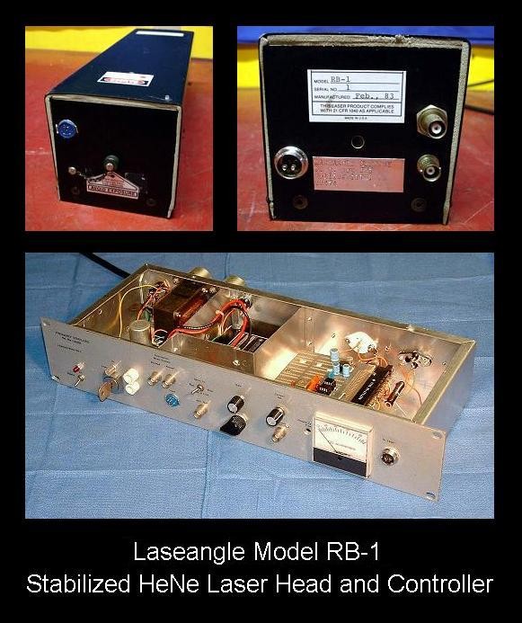

    Sam's Laseangle RB-1 Stabilized HeNe laser Conversion
    Laseangle was a company that built some stabilized HeNe lasers in the early 1980s. I don't know if they ever actually sold anything commercially but there is a reference in a paper to the use of 6 of their systems. Perhaps, the researchers were related to the company founder. :)
    I was given what must have been a prototype or testbed - the RB-1. The RB-1 consisted of two pieces as shown in Laseangle RB-1 Stabilized HeNe Laser Head and Controller. The connecting cables were nowhere to be found when these photos were taken. The laser head is S/N 1 and and the controller is S/N 2, so at least two of these systems were built. The thing clearly wouldn't be caught dead going out to a paying customer, though it's likely that the RB-1 or its successor eventually morphed into the Newport NL-1 (maybe "Newport Laseangle 1"?) as a result of a merger or buy-out. However, I've yet to see an actual NL-1 (or production RB-1 if there ever was such a thing).
    The RB-1 laser head contained the HeNe laser tube, with wrap-around heater, a beam sampler assembly that diverted all of one polarization to a photodiode and part of the orthogonal polarization to another photodiode, and preamps for the photodiodes. The base is a 3/4 inch thick aluminum slab with a 1/8 inch aluminum cover sealed with foam rubber.
    The controller housed what appears to be a standard Laser Drive HeNe laser power supply brick, DC power supply, feedback circuitry, and heater driver. There were controls on the front clearly not for an end-user, like 8 or 10 gain settings and a fine gain control for one of the op-amps, selection of which mode signal to pass to an output, a current meter for the heater, and so forth. People who typically use these things would have no clue of what to do with the knobs and switches. But I've yet to see a user manual!
    While the mounting of the HeNe laser tube is somewhat overkill and the beam sampler is a nice solid unit with an adequate number of adjustments, the electronic construction of both the laser head and controller are, to put it politely, a disaster. Everything is on those copper strip prototyping boards, with capacitor upon capacitor added in various places no doubt to tame noise pickup or instability. (Someone must have had stock in a capacitor company!) The designers must have had a goal of using strange and hard to find connectors wherever possible which they did for the separate cables of the photodiode signals (blue multipin) and heater drive (microphone two pin). Power for the HeNe laser tube came from a standard Alden on the controller but at the laser head had both the medium voltage BNC on top for the positive and the normal BNC on the bottom for the negative. Someone must have been toasting marshmallows above the DC power supply voltage regulators since there is a nice brown spot on the ventilation grill there. I have no intention of powering up either the controller or the entire laser since the cables with their strange connectors are nowhere to be found, it's not worth constructing replacements, and the thing would probably explode in any case.
    My mission was to convert the laser head alone into a basic self-contained stabilized HeNe laser suitable to use to demonstrate a simple stabilized HeNe laser. It will be donated to a university Physics Demonstration facility.
    The original HeNe laser tube was from Uniphase, a garden variety model but was end-of-life - hard start, hard run, white-ish discharge color, and only about 0.4 mW of output (probably should have been around 2 mW). Its length of 8 inches is somewhat unusual - 6 or 9.5 inches being more common, at least today. While a 9.5 inch tube would satisfy the criteria for the number of modes, it would just barely fit, but with marginal clearance for the high voltage on its anode mirror mount. So, I installed one of the 6 inch tubes I'd already selected for well behaved mode sweep behavior. The beam sampler uses the main beam, so any variation in waste beam power is more or less irrelevant.
    The original beam sampler included a polarizing beamsplitter cube to extract one of the mode signals and prevent it from reaching the output at all, and a separate angled plate to extract a portion of the orthogonal mode. A pair of EG&G SGD-100A photodiodes (may be similar to the Perkin Elmer FFD-100) fed LF356 op-amps.
    Of all this, only the angled plate and the mounting hardware for all the beam sampler stuff was retained. I wanted the beamsplitter cube for other uses but also needed to roughly equalize the power to the 2 photodiode channels to keep the new controller happy. (Single mode locking would probably have satisfied the design goals but it would only take a bit more effort to use both modes.) So, in place of the beamsplitter cube, I built a little angled mounting post and added a bit of an optical window to act as a plate beamsplitter. In place of the EG&G photodiodes which were too nice to use here, I installed a pair of my normal $2 photodiodes - which also have a larger area making them easier to align with the sampled beams. A red filter was glued in the beam path in front of each photodiode to block bore light. These were left in place. A piece of Polaroid polarizing film was cut to fit in front of each photodiode to select the orthogonal modes. Some experimentation showed that one set of orientations resulted in approximately equal power in the orthogonal polarizations to each photodiode - within 20 percent - which would be good enough. For the other possibility, they differed by perhaps 2:1.
    The new controller was constructed on a piece of perf. board to fit in about the same space as the original preamp. The rear panel of the laser head was modified to have a power switch, Preheat/Off/Lock switch, LEDs for the heater (yellow) and the two modes (red and green), the Offset pot, and a Tuning input BNC (more to fill the existing hole than to be something essential!). The original connector on the front of the laser head was left in place just in case someone would want to monitor various signals (though I have no intention of wiring anything to it at the present time). The orignal controller came in handy though. Its rubber feet were transferred to the converted laser head. :-)
    The HeNe laser power supply is one of those little copper covered bricks made by Laser Drive for a variety of barcode scanners. It easily fits on the baseplate behind the laser tube. The system runs from 12 VDC at about 1.5 A max. A 2 amp fuse (in a socket) was included for good measure. These little plug-in fuses were about the only thing worth salvaging from the mainboards of Sparc-II workstations. :)
    Views of the completed unit are shown in Laseangle RB-1 Stabilized HeNe Laser Conversion Rear Panel and Laseangle RB-1 Stabilized HeNe Laser Conversion Interior. Some labeling of the rear panel will be needed. Inside, the HeNe laser power supply is on the left next to the tube with its heater. The large black object is the modified beam sampler assembly with the red and green dots indicating which section is associated with the vertical (green) and horizontal (red) polarization modes. The controller is on the elongated perf. board with heatsink. The bare blue connector is left as an exercise for the student (or professor) to provide for signal monitoring.
    The system now works like the one described in the section: Sam's Home-Built SP-117 Compatible HeNe Laser. After a 10 minute preheat period, it locks easily and will clearly be able to demonstrate the basics of a two mode stabilized HeNe laser. The control loop is a bit underdamped, probably because of the smaller thermal mass of the 6 inch tube. The wrap-around heater, originally used with the RB-1, is also slightly higher power. But if the user wants to play with the gain of the integrator, its proportional feedback resistor is in a socket (no pots in the entire thing). I just picked the first one that seemed reasonable. I make no guarantees on frequency drift or noise, but with the cover in place, the amplitude of either polarized mode settles down after a couple of minutes to a short term variation of less than +/-0.25 percent. Since it's locking on the mode ratio, the frequency variation this corresponds to should be quite respectable, probably less than +/-2 MHz. This is better than 1 part in 108!
    I assume that the ugly cover will be replaced with clear Plexiglas. ;-)
    Specifications (of sorts) and operating instructions for the SL-1 ("Sam Laseangle 1") can be found at SL-1 Operation Manual. There's a good reason it is under the "humor" directory, but the actual operating instructions are serious. :)

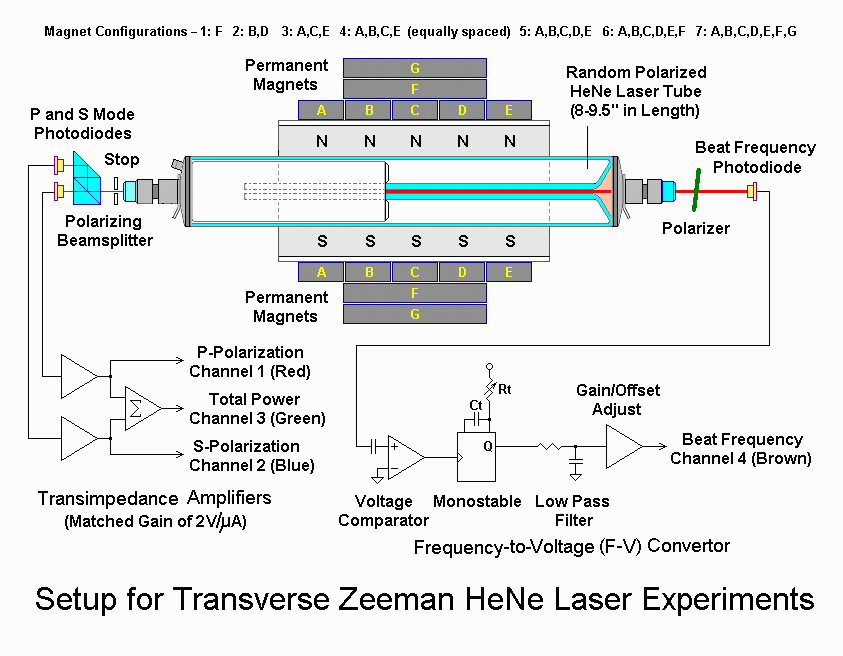

    Two-Frequency HeNe Lasers Based on Zeeman Splitting
    I originally got interested in doing this because I had acquired the HeNe laser tube for the HP-5501 interferometer. This is a "two-frequency laser" which generates a beat signal (in a photodetector) between 1 and 2 MHz using Zeeman splitting. I had also acquired the reference detector PCB from an HP-5518A laser which is used in a very similar interferometer. See the sections starting with: Hewlett-Packard/Agilent Stabilized HeNe Lasers for way more information than you could possibly want.
    However, in a nutshell, the basic approach used the most common type is shown in Dual-Mode Stabilized Axial Zeeman-Split Dual-Frequency HeNe Laser. A short HeNe laser tube is surrounded by a powerful cylindrical magnet with its field oriented along the axis of the tube. This splits the neon gain curve into two components separated by a few hundred MHz. When a cavity mode is near the center of the split gain curves, the result is two lasing modes (F1 and F2) separated by a few MHz in optical frequency. One of them has left-handed circular polarization and the other has right-handed circular polarization. A Quarter WavePlate (QWP) converts these to orthogonal linear polarization. A portion of the output beam is sampled and both for the stabilization feedback and to produce the "REF" or difference frequency between the two lasing modes. Electronics drives the heater wrapped around the laser tube (as in the diagram, or alternatively as with early HP lasers, a PZT) so that the lasing modes are equal and thus centered on the split neon gain curves.
    The HP-5501 laser tube is easily powered with a small HeNe "brick" for a 1 to 2 mW laser. The optimal current is between 3.0 and 3.5 mA. The connections are positive (with ballast resistor) to the terminal near the output lens, negative to the terminal on the side of the big glass bulb, and no connection to the terminal at the end which is a piezo for controlling cavity length. Using that for the negative connection may result in damage to the tube. The HP-5501 tube is constructed with a very stable resonator structure having an ultra-thick cylinder with a small bore and ends that are precision ground for the mirrors, which are held in place by springs (!!) - no adjustment possible other than for cavity length via the piezo element at the cathode-end. That cylinder is made of Zerodur, a special very low thermal expansion coeffient glass/ceramic developed by the Schott Glass. In fact, longitudinal mode cycling present with normal HeNe lasers is virtually non-existent in the 5501A. A stack of ALNICO ring magnets similar to magnetron magnets (though not quite as powerful) surround the tube covering about 2/3rds of the bore but not the whole length - the discharge can be seen at both ends. Aside from the huge solid cathode and funny construction, the tube is otherwise unremarkable as a HeNe laser goes. The output is less than 0.5 mW and there are ghost reflections/interference from the slightly tilted non-AR coated outer glass window through which the beam emerges.
    The HP-5501 tube is mounted inside the magnet assembly using a combination of RTV silicone and black rubbery stuff. It is possible to get it out non-destructively by removing the magnet retainer/mounting bracket at the output-end and then picking away at the adhesive/sealer pulling off magnets as they become free (protect the fragile tube) and then finally the bracket at the HR end. However, it's best to leave the tube snuggly in place to maintain alignment with the output optics. A photo is shown in HP-5501A Laser Tube Removed From Magnet and Output Optics Assembly.
    Someone had sent me a partial schematic of the reference PCB so I was able to determine where to connect power and take the signal output. After confirming that it did respond to a laser pointer, I powered up the HP-5501 tube and immediately got a nice beat signal on my scope of around 1.5 MHz - the difference in energy levels which translates to a difference in frequency caused by Zeeman splitting via the large cylindrical magnet surrounding the tube bore.
    But, for some (at the time undetermined reason), when I went to reconnect it after doing the experiments below, I could not get any beating unless the gain of the detector was turned all the way up and there was no polarizer in the beam. And even then it was very noisy turning on and off at a 20 KHz or so rate. The laser appears to work fine otherwise. Then, after sitting on the shelf for about 6 months after this, I fired it up and immediately got a strong 1.9 MHz beat and it has continued to operate perfectly. Go figure. :) (I'm fairly sure I was using the required polarizer for all these tests but am not positive.) I still have not resolved this mystery. As far as I can determine, there isn't anything that is different to account for either its change of heart about cooperating or the much higher beat frequency. However, it's possible that the temperature was different by enough that the cavity spacing placed the lasing lines in a region where there would be no beat. Even though the mirror spacing is determined by a rod of Zerodur, an extremely low expansion material, a big enough temperature change could still result in no beat since the beat only occurs over 10 or 15 percent of the mode sweep. Now this tube was a reject. From later experiments, I have determined that the PZT doesn't work at all. In fact, it appears that either the terminal at the back of the tube does not connect to the PZT, or the PZT return from the opposite side does not connect to the terminal on the side. This lack of contact was confirmed by measuring the capacitance between the back and side terminals. It's over 1,000 pF on a good 5501A tube, but only a few pF on the bad tube. By being able to carefully compare this tube with the components of another 5501A that had been fully disassembled, it now appears as though some parts may even be missing! Two spring contacts should be installed in holes drilled through the HR mirror to make the connection between the front of the PZT disk and the cathode/side terminal. The holes are clearly visible through the frosted edge of the HR mirror. But while it's hard to clearly see what's inside, those holes may actually be empty! If so, someone in the HP Tube Assembly Department must have had a really bad day. ;-)
    I later obtained a really old HP-5500C laser, (which uses the same tube) to analyze. The driver is just a voltage controlled high voltage power supply module and the labeling on the printed circuit board is "PZT"! It runs on 15 VDC and provides 0 to 1.5 kV when fed a control voltage of 0 to 15 V relative to the negative input. The power supply for the HeNe laser tube itself is just a potted brick that runs on 15 VDC but it does have an enable input which must be tied to the positive input to turn it on. (In looking back on this referring to the HP-5501A schematic which I assume to be similar, it may not be an enable but a current control input.) In the HP-5500C, both these power supplies (no model or manafacturer available) run on the -15 VDC power supply so plus is actually ground. And, the wire color coding is confusing: Pink/red is -15 and black is ground.
    I also have an HP-5501A laser head and on this one, the HeNe laser power supply also runs on the -15 VDC supply, negative is violet and black is ground. There is a white/green control wire that appears to be driven to +15 VDC to turn on the laser but the circuitry isn't just a simple interlock. Applying power to the laser head is all that is required to turn on the laser and get it to "Tune" (as HP calls it) to the proper conditions for stable two-frequency operation.
    Another sample of the bare tube I obtained on eBay was comatose on arrival (lit up but no output). However, it came back to life over the course of about 12 hours. I wouldn't have expected soft-seal behavior from this very high quality hard-seal tube but it had been sitting on someone's shelf for over 15 years! There is no obvious getter so perhaps the cause was just slight outgassing of internal parts over this time period. Without being run periodically to clean it up, the result was enough contamination to prevent lasing.
    Anyone can take a commercial two-frequency laser tube and make it work. So, that's pretty boring. :)
    To see what I could do with a common HeNe laser tube, I dug up a typical 1 mW, 6 inch randomly polarized barcode scanner tube and connected it to the same brick power supply. Without any magnet, there was still a signal from the detector. It was varying widely in frequency as the tube heated, no doubt a byproduct of mode cycling. In actuality, this was due to the stray magnetic field of the HP tube which wasn't far away. With no magnetic field present, there were no detectable beats, as expected. (Where more than one longitudinal mode is present, there would be beats at a frequency determined by the mode spacing, c/(2*L), but this is about 1 GHz for these 6 inch tubes and not detectable by any equipment I have available. For multi-transverse mode tubes, there would also be beats at much lower frequencies but all these HeNe barcode scanner tubes operate TEM00.) The effect of the magnetic field was confirmed by moving a magnet in the vicinity of the tube which would generate all sorts of variable frequency beats with detectable effects as far as a foot or more away from the tube. Hey, could this be used to create a new sort of musical instrument - a laser based successor to the Theremin for the new millenia? :) If so, I declare first disclosure for patent purposes. :)
    Anyhow, to create a true Zeeman split two-frequency laser, I installed the HeNe laser tube inside a fairly powerful cylindrical magnet. If the tube would have fit inside magnetron ring magnets, I would have used a stack of them but this tube is a bit too wide. So, I used a magnet assembly that was supposedly for "flavoring" wine by placing the neck of a bottle of wine in the hole in the magnet and pouring the wine through the magnetic field - each polarity for two possible flavors. Yeah, right. :) I picked it up at a garage sale for 50 cents simply because the magnets seemed nice and powerful. The length of the magnet assembly was about 2 inches. I initially centered the tube in the magnet and used a bit of packing to keep it secure. A diagram of this rig is shown in: Demonstration of Two-Frequency HeNe Laser Using Zeeman Splitting.
    A polarizer (Polaroid sheet) was needed to obtain a consistent signal. Without a polarizer in the output beam, it was almost impossible to get any response on the oscilloscope though with careful adjustment of the beam position (and presumably intensity on the detector), a weak and somewhat unstable beat could be found. However, when a polarizer was added, there was a very strong beat signal almost continuously - at times more than 25% of the average power when measured with an analog (continuous) sensor. The orientation of the polarizer didn't appear to matter at all, just that it be present. (I did confirm that this wasn't simply a matter of needing some attenuation to stay within the dynamic range of the sensor.) And, any polarization preference the tube may have had totally disappeared once the tube was installed in the magnet. This implies that the polarization is no longer linear and probably consists of two circularly polarized beams with the Zeeman split frequency difference for each oscillating mode (based on the quantum mechanical properties of isolated gas atoms in a constant axial magnetic field). Mode cycling of the HeNe tube as it heated resulted in a periodic instability or momentary loss of signal.
    The result was similar to the behavior of the commercial two-frequency laser except for instability at times as it warmed up. Depending on the position of the magnet, the frequency could be varied from about 500 kHz to over 1 MHz with the highest frequency produced when the magnet was closest to the anode-end of the tube. An explanation for the frequency's dependence on position is that locating the magnet closer to the anode-end of the tube puts more of the magnetic field inside the short bore. The frequency still varied cyclicly by 10 percent or so as the tube heated due to mode competition. With a single magnet (about 1/2" thick) near the cathode, the weak field behavior could be produced with the beat frequency varying from DC to a few hundred kHz based on mode cycling.
    The beat frequency is about 1/3 to 2/3 that of the HP tube, which might be accounted for by a proportionally lower magnetic field compared to that assembly. However, in testing various tubes (see below), identical model tubes in identical positions resulted in a wide variation of beat frequencies. Even repeating what I thought were identical experiments at different times resulted in widely varying results so there's more going on than can be accounted for by the simple explanations of Zeeman split two-frequency lasers I've found so far.
    I seem to have lucked out with the first tube I tried and have now tested a few others. It would appear that for best stability in beat frequency, the tube should be a "flipper" - one that oscillates single (longitudinal) mode at one polarization and then abruptly switches polarization but still remains single mode as the modes cycle during warmup. It could be that flippers are more symmetric or isotropic, which is one criteria for a HeNe laser to respond well to Zeeman splitting. When more than one mode is oscillating as with most non-flippers where modes gradually come and go, the beating is not a clean waveform but a superposition of beating of the two (or more) modes:
    It is quite straightforward to further stabilize this rig with a heater and temperature feedback to control cavity length. This should result in a system which produces a clean and highly stable signal with specs similar to commercial units. As a qick experiment, I did just that with the last tube in the HP-5501A magnet/wave plate assembly. The feedback had to use the output rather than the waste beam since only there are the Zeeman modes converted to linear polarized modes. So, an additional non-polarizating beamsplitter was needed so that the output beam could also be input to an optical receiver for display on a frequency counter and oscilloscope. The wave plates were adjusted as best I could by feel so the Zeeman modes were linearly polarized and orthogonal at the output. Baiscally, this was trial and error until the amplitude of the mode changes seemed to be a maximum and balanced. Stabiilzation was then trivial using the controller described in the section: Sam's Home-Built SP-117 Compatible HeNe Laser. The tuning knob could then be used to adjust the frequency. As a practical matter, a wide range of wave plate orientations would result in enough mode variation for locking, but the maximum tuning range required reasonably balanced modes. There's no doubt that this will also work with any of the other non-HP magnets, but then the wave plates would need to be added.
    However, there's one strange characteristic of this setup compared to a "real" HP Zeeman laser: With the 5501A and 5517C that I've checked, when the beat frequency is present, the actual frequency is a maximum when the modes are equal, then gradually goes down on either side and abruptly disappears. With the "Frankenstein" laser, the beat frequency is a minimum when the modes are equal. The only obvious difference would seem to be that the cavity length is a bit longer - around 5-1/2 inches compared to between 5 inches. But there are many other parameters that might be significant. For example, it could be a different gas fill ratio or the use of pure isotopic He and/or Ne. Interesting. Just when I thought I had an idea of how this works, another mystery! :)
    However, it's possible that I had the phase of the feedback reversed so it was locking on the opposite slopes of the gain curves. If this tube produced a beat signal for the entire mode sweep cycle as some do with modest magnetic fields, then it might lock either way, but would end up at the wrong place. Where the beat only appears for part of the mode sweep cycle, it could still lock at the wrong place, but then there would be no beat.
    Using an electromagnetic solenoid instead of the permanent magnet for these experiments would permit dynamic control the beat frequency. In fact, a phase locked loop (PLL) could be used to lock the output to a reference oscillator. Since even with a permanent magnet, the beat frequency varies slightly with the position of the mode on the gain curve, once the range is known, phase-locking to a reference frequency would result in a highly stabilized laser. Though, depending on application, stablizing the mode position on the gain curve may be more desirable. The latter is what is done in all the HP/Agilent metrology lasers.
    I leave this and countless other variations as exercises for the student. :)

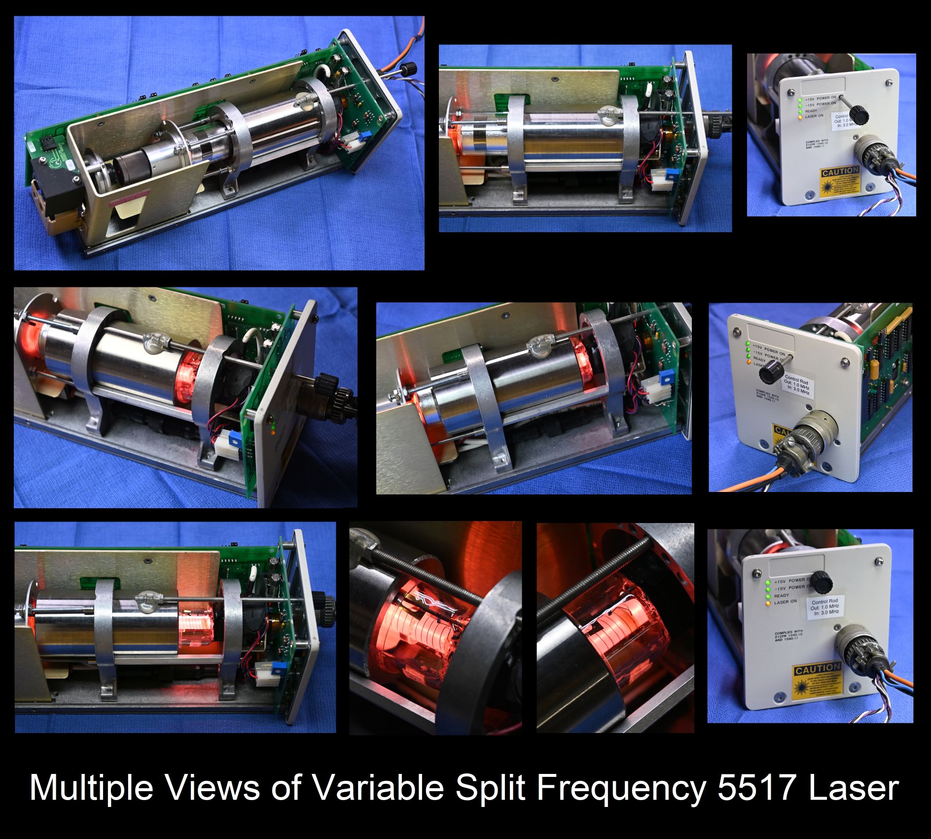

    The latest version includes a genuine HP-5508A Measurement Display and my simple educational version, Sam's Interferometer Measurement Display 1 (SG-MD1). See Photo of Two-Frequency Interferometer Laser Tester 2.

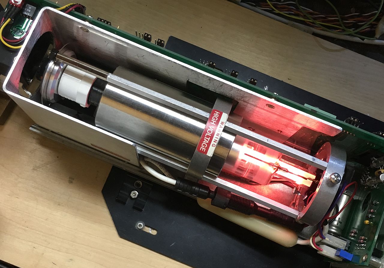

    Installing a Common HeNe Laser Tube in an HP 5517 or 5501B
    The original HP/Agilent HeNe laser tube used in these lasers is custom made, rather special, and very expensive. For more information, see the sections starting with: Hewlett-Packard/Agilent Stabilized HeNe Lasers and in particular: HP/Agilent 5517A/B/C/D.
    OK, so the first question one might ask is "Why would anyone in their right mind want to do this?" :) The quick answer is: "There are many HP laser bodies out there with marginal or dead tubes but perfectly good electronics, and these can be had for next to nothing.". Originally, I was planning on simply installing a conventional well behaved random polarized HeNe laser tube with no magnet and then would have a stabilized HeNe laser for little cost. After all, most of the work has already been done. It's true that the special HP tubes have an internal heater which results in faster response, but I doubt this would matter given the slow sampling speed of the LCD switch.
    However, what may make more sense, and is actually easier in some ways, would be to retain the magnet assembly and only replace the glass HeNe laser tube and add an external heater. The result would then be a fully functional two-frequency Zeeman laser. Even if it didn't quite meet HP/Agilent specifications (for lifetime at least), such a laser could be very useful for educational purposes if nothing else. And for the same reason people climb mountains, "because it's possible". Well almost the same reason! :)
    My plan was to use a six inch tube like the Typical Uniphase HeNe Laser Tube from a Barcode Scanner. This one is from JDS Uniphase, but Melles Griot and Siemens (now LASOS) have similar tubes, and all are compatible with the HP/Agilent HeNe laser power supply. The heater will consist of about 50 feet of #32 wire wound bifiler style on the outside of the tube. The tube+heater will be installed in place of a dead HP 5501A tube in a 5501A magnet assembly. And from previous experiments, I already know that this arrangement can be stabilized using my home-built controller.
    The heater should have a cold resistance of around 8 ohms - same as most HP lasers. I don't know what type of wire is used in HP laser tube heaters, but if it were copper, the set-point temperature would have to be in the vicinity of 100 °C to obtain the factor of 1.285 with respect to cold resistance. My heater isn't going to get that hot, so the factor will be smaller, but hopefully the adjustment pot on the controller PCB has enough range. Even though the thermal response time of the Uniphase tube with external heater will be much slower, I don't anticipate any real problems in making this work. Famous last words!
    Well, it does work, sort of. Preparing the laser tube was straightforward using 50 feet of #32 wire for the heater resulted in a resistance of about 8.5 ohms. The result is shown in Replacement HP HeNe Laser Tube With Heater Using Barcode Scanner Tube. A combination of modified pill bottles, electrical tape, and rubber wedges were used to mount the tube inside the 5501A magnet assembly. It was necessary to add a negative lens to the low divergence tube to convert it into a high divergence tube. (This was actually the lens originally removed from a similar tube which was required to be high divergence in the barcode scanner.) Otherwise, the beam diameter at the HP beam expander was so narrow that the final beam was only about 2 mm in diameter so (1) I wasn't entirely sure it would reliably hit the photodiodes inside the beam sampler and (2) it was difficult to align the interferometer for a reliable signal. In hind-sight I should have used a high divergence tube to start. No hig deal - the lens is held on with a piece of plastic tubing. With the high divergence (8 mR), the beam is large enough at the input to the beam expander to produce a 5 or 6 mm diameter collimated beam from the laser with most of the power making it through. It's still not really as wide as wouild normally be the case with the beam expander aperture actually cutting off the edge of the beam, but close enough for now. Another minor glitch had to do with feet. Yes, feet! :) Only one of the two base castings on the ends of the 5501A tube magnet assembly would fit into the 5517D case, so the casting at the other end had to be removed. (Remarkably, though I suppose not that surprising, the hole spacing in the castings is the same for the 5501A and 5517/5501B.) This didn't make for the most stable arrangement in the World during testing and adjustment, with the tube assembly balancing on one set of feet! See Replacement Tube Assembly Installed in 5517 Laser - Initial. For a more permanent setup, I added spacers, nuts, and washers so that the two base castings would be at the correct spacing for all the holes to line up. And, 3 Nylon screws to center the cathode-end of the tube. (Shifting the position of the optics assembly provides adjustment at the other end.) See Replacement Tube Assembly Installed in 5517 Laser - Final. Of course, using the actual magnet and optics in its mount from a 5501B or 5517B/C/D laser would eliminate the mechanical issues, but I haven't taken one of those apart yet.
    Here are some of the more significant issues:
    As a matter of fact, I had used the magnet assembly from a 5501A and my SP-117/A compatible controller (see the section: Sam's Home-Built SP-117 Compatible HeNe Laser) to do something similar at lesat a year before trying it with the 5517 chassis. This is shown in Two-Frequency HeNe Laser Experimental Setup 1. Now, you know what they say about sausage and how one shouldn't see how it's made? :) This photo is of a very raw setup with no effort made to pretty it up. The 6 inch laser tube with heater is driven by a HeNe laser power supply brick, which is itself powered from a home-built 24 VDC power supply. Since the wave plates are required to separate the modes for stabilization, there is a beam-splitter cube sitting between the tube/magnet assembly and HP 10780A optical receiver. It directs part of the output beam to a polarizing beam-splitter and a pair of photodiodes (clamped in the red vise), the same ones used with the SP-117/A compatible controller, visible at the lower left of the photo. As shown, the laser has stabilized with a difference frequency of 1.2833 MHz.
    Removing the glass tube intact from a 5501B or 5517 tube assembly that conforms to the diagram above - all those in the small case - is the sort of thing that anyone in their right mind would only attempt at most once, unless appropriate noxious chemicals are available to dissolve the potting compound without damaging anything else (except that they likely will also rot your internal organs). Naturally, this represented a perfect challenge! The result is shown in Major Components of HP/Agilent 5517B/C/D or 5501B Tube Assembly. It was extracted from the magnet using thin tools, knives, and other instruments of torture to nibble away at the potting compound between the glass tube and magnet. This tube is actually from a 5517B laser. Of course, if there was no desire to save the original glass tube, this could have been done using any technique that would work! However, the 5501A and some very old 5501Bs have magnets in multiple sections, so doing tube-ectomies on those isn't quite as difficult. I did later remove the intact glass tube from a 5517D. I'll spare you the suspense - it appears identical to that of the 5517B in all the physical parameters that can be determined without going inside. :) For the 5517A, 5518A, and 5519A/B, removing the tube intact using physical means alone is different, though perhaps not more difficult, but an additional step is required since the outer casing needs to be removed first. One hand-tool approach is to slice around the casing with a hacksaw where it narrows taking care not to go too deep, and pull off the front part. Then slice length-wise on opposite sides and split the casing like a walnut. This allows the tube and magnet to pop out. As you may have guessed, a 5517A was my third intact tube-ectomy. :) The only other instance I've heard of anyone doing this was where a rotary tool (e.g., Dremel) with a cutoff wheel was used to slice the outer casting AND magnet lengthwise. Or maybe it was a Sawzall. :) But the hacksaw really doesn't take very long at all to get the casing off - 10 or 15 minutes at most. Then the fun begins since don't want to sacrifice the magnets, even if I had something that would cut the AlNiCo.
    Next, I installed a similar 6" barcode scanner tube in the 5517B magnet. The 5517B laser normally has a REF frequency of 1.9 to 2.4 MHz, but with the standard tube, it produced a maximum beat frequency of only about 1.3 MHz. Matching of the magnetic field to the active discharge region of the tube is also critical to maximizing the REF frequency. While this may have been an issue with the 5501A magnet, it was quite well matched in the 5517B magnet. So, I was about to conclude that a modified tube is essential in achieving a higher REF frequency. But then I had a thought: I had selected both these 6" tubes for high output power. Suppose I could adjust the output power somehow, which in effect would be adjusting the cavity loss? Two possibilities came to mind on how to do this: (1) Run the tube on reverse polarity to cause sputtering at the anode-end mirror (now acting as the cathode) which would increase losses at the mirror or (2), adjust the mirror alignment to be slightly sub-optimal. I first tried (1) since I didn't like the idea of installing a misaligned tube. (Not that I liked the idea of degrading a tube permanently any better but...) However, all that stuff about ruining tubes in a few minutes with reverse polarity is highly overrated, at least for some tubes. After 10 minutes, all that had happened was that the output had gone up from 0.7 to over 0.9 mW. Now, this was probably just the normal effect of warmup, but output power was clearly not declining precipitously as I had expected. So I gave up before doing something I might eventually regret.
    But (2) worked very well with the following very approximately results:
                        Beat Frequency
        Output Power   Tube 1    Tube 2
          1.3  mW      1.3 MHz
          0.9  mW      1.5 MHz   1.6 MHz
          0.75 mW      1.6 MHz   2.0 MHz
          0.6  mW      1.7 MHz   2.2 MHz
          0.5  mW      1.9 MHz   2.4 MHz
          0.4  mW      2.2 MHz
    The listed Output Power is directly from the tube after appropriate mirror misalignment. The output power of the laser would be about 30 percent lower due to the beam expander, wave plate, and beam sampler losses. The Beat Frequency is the maximum value meausred during mode sweep, which generally occurs close to where the laser would lock. So, the tube that had an output with optimal mirror alignment that was lower, produced a higher output power for any given beat frequency. This is the tube I shall use to build my SG-5517B laser. :)
    Eventually, I may do some more careful measurements, but this seems to open up a very interesting possibility: Build a single type of tube assembly that can be tuned to the desired REF/split frequency, even after installation. It seems like this could certainly be varied from a 5517A to at least a 5517C, and perhaps even a 5517D, by adding a single screw adjuster to the rear mirror mount! It would also allow periodic tunups to maintain the same output power and REF/split frequency as the tube ages.
    I then realigned Tube 2, above, for maximum power (whicn ended up being about 1 mW after warmup) and added a bracket to the cathode-end mirror mount with a screw that applies sideways pressure to the mirror mount stem. Since it only needs to reduce output power, only a single screw should suffice. This was installed in the 5517B magnet assembly shown above, whose previous tenant had been removed. And that was installed in the original 5517B body from which it came. See Replacement Tube Assembly With Adjustable REF Frequency Installed in 5517B Laser and Closeup of Bracket Attached to Mirror Mount to Adjust Alignment. It is now possible to adjust this laser to meet the REF frequency specifications for the 5517A (or 5501B), 5517B, or 5517C, while still maintaining adequate output power. It won't make it to a 5517D though at any useful output power, if at all.
    In fact, anecdotal evidence suggests that Excel Precision may do precisely that with their 1001A/B/F lasers. These use tubes of conventional design with metal mirror mount stems. On two Excel lasers I tested, the OC mirror was way out of alignment. When realigned, the output power sent well above the value listed on the label, and REF came down to a low but acceptable value, even though these were no doubt well used lasers. While it's possible that alignment had drifted over time - something not possible with HP/Agilent lasers but quite common with most other HeNe lasers - deliberate detuning to achieve a specific combination of output power and REF frequency is a distinct possibility.
    And, I did take apart another 5517B tube/magnet/optics assembly where the tube was known to already be physically broken. But I couldn't just take a wrecking ball to it because I did want the internal organs intact - especially the mirrors for analysis. However, that was much quicker nonetheless.

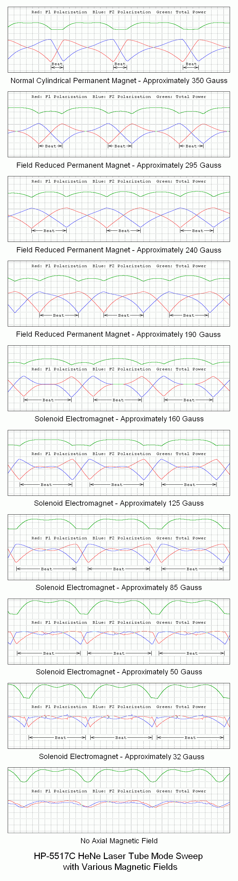

    So what does affect the Zeeman beat frequency and which of these is likely to be used by HP/Agilent to control it?:
    From the above list, it would seem that options are quite limited and only the cavity loss adjustment via the OC mirror reflectivity is known to have a large effect on Zeeman beat frequency without affecting other parameters that are believed to be similar or identical for all these lasers.
    It would be best to use semi-custom tubes to achieve the proper difference frequency without torturing the tube. :) And even then, it's not clear if the other specifications including required long term stability could be achieved using the external heater. But it would certainly be adequate for educational purposes, both in terms of student projects to do the installation and analyze the behavior, as well as for general studies in laser based metrology systems.
    Whether the approach of installing a standard HeNe laser tube can be used to refurbish HP/Agilent lasers (at least 5501Bs, 5517As, and 5517Bs) at reasonable labor cost is still not clear. The rather short life expectancy of most conventional HeNe laser tubes compared to genuine HP/Agilent tubes is one major issue. However, I am investigating the possibility of offering to rebuild 5501B and 5517B lasers with all the risks spelled out up front. One option that partially deals with the short life expectancy is to charge a much lower price for a "recharge" when the replacement tube reaches end-of-life since much of the hard work will already have been done. Comments are welcome. Please contact me via the Sci.Electronics.Repair FAQ Email Links Page.
    However, a more fundamental issue may be one that cannot be dealt with using an off-the-shelf tube. While these experiments above worked after a fashion, it's clear that several aspects of performance are inferior compared to those of the genuine HP/Agilent tubes. In particular, it's not possible to adjust the wave plates so that the MEAS signal is clean when the position is changing AND there is decent independence of F1 and F2. It may not be possible to achieve either. This is likely due to very significant rogue modes being present, and these are a fundamental property of the tube's design. As will become clear below, it may not be possible to even come close.
    Later, I selected a tube for maximum power just to see what the result would be in a 5517 magnet assembly. Here is the data during mode sweep (unstabilized) for tube #3:
        Parameter                      Minimum    Maximum
        Output Power (no magnet)       1.32 mW    1.38 mW
        Output Power (with magnet)     1.38 mW    1.47 mW
        Beat Frequency (with magnet)   1.26 MHz   1.58 MHz
    Without a magnetic field, there is of course no beat frequency. With the tube's active discharge centered within the 5517 magnet, the beat frequency is present for perhaps 50 percent of the mode sweep cycle. bot the output power and beat frequency are a minimum around the center of this region. This is where the laser should be when it's locked - centered on the Zeeman-split neon gain curve, but differs from the behavior of the normal 5517 laser tube, where the locked position is with minimum output power and maximum beat frequency. It's also interesting that the output power is more than 6 percent higher in the axial magnetic field. With a minimum output power of over 1.3 mW, this tube should produce more than 1 mW once the optics are installed.
    The increased power may be related to both the likely difference in gas-fill isotope ratio and thus shape of the neon gain curve, as well as the profile of the intracavity mode volume, with the long radius hemispherical resonator configuration of this tube, compared to a nearly pure hemispherical resonator in the genuine HP/Agilent tube. Why this might occur is shown in Comparison of Normal and Zeemon Modes in a Short HeNe Laser. The total output power in each plot is the sum of the red (F1) and blue (F2) modes. For the particular combination of cavity length and neon gain curve depicted in the diagram, the total output power with a magnetic field is higher than without a magnetic field. Of course, other things affect actual output power to even with this configuration, the difference would not likely be as dramatic. The lasing modes from the split gain curves are offset from the normal longitudinal mode position - one higher and the other lower. The difference between them results in the Zeeman beat frequency. However, the extent of the shift is at most a few MHz, much smaller than how it is depicted here.
    I installed the tube in the magnet/optics assembly from a 5517B. The output power was now between 0.9 mW and 1 mW.
    What I expected to happen when this tube was that it would lock normally but with perhaps a fuzzy MEAS signal due to rogue modes. However, this was not the case. In fact, it refused to lock at all within a reasonable time and when it finally did, the lock position wasn't at the center of the Zeeman-split gain curve, but rather near one end of the range over which there was any beat frequency, with an output power of around 925 uW. The lasing line location was inferred based on the beat frequency of around 1.46 MHz when locked. (See the chart, above.) At this lock position, the MEAS signal has some modest amount of fuzz likely due to rogue modes when the position of the mirror (my remote "tool") was changing. But the 5508A Measurement Display was happy enough with it and didn't generate any errors. By fiddling with the wave plates, it was possible to achieve a stable lock near the minimum of the beat frequency range, presumably also near the center of the Zeeman-split neon gain curve. However, at this location, any change in mirror position resulted in gargantuan amounts of fuzz with an almost unrecognizable MEAS signal and instant "SL Error" from the 5508A. My home-built measurement display was also hopelessly confused losing huge numbers of counts with any position change. As far as I can tell, there is no orientations of the wave plates that results in a totally clean MEAS signal when the remote mirror is moving though it is quite clean over much of the range when stationary.
    The inability to lock at the correct location on the Zeeman-split neon gain curve must mean that the rogue mode amplitudes are so large that they overwhelm the difference of the F1 and F2 modes that should be driving the error amplifier/heater. Even when the lasing mode was nearly stationary at what should have been the correct location, it would eventually drift away from it with the beat frequency increasing until it disappeared. For this reason among others, I don't believe it's a problem with the thermal response of the heater/tube combination but rather based in the fundamental nature of this tube's mode characteristics. My next experiment will be to monitor the output on a Scanning Fabry-Perot Interferometer (SFPI) to actually look at the modes. I won't be able to see the individual F1 and F2 modes since they differ in frequency by such a small amount (less than 1.5 MHz) but should see them as one peak, along with a pair of peaks due to the rogue modes, all spaced around 1.1 GHz apart - the FSR of the tube. With a short tube such as this, there would be at most 2 modes lasing at any given time if there were no magnetic field. As the amplitude of one increases, the amplitude of the other decreases. But with the Zeeman-split neon gain curve, there should be at least 3 modes, and the amplitude of all of them will likely be quite large simultaneously.
    I actually looked at the mode structure of both of the last two rebuilt lasers on a Spectra-Physics model 470 SFPI. (The first rebuilt laser one using the 5501A magnet assembly was no longer intact when I got around to doing these tests.) For the adjustable 5517 laser (tube #2) set 5517A mode (minimum REF frequency, maximum power), the mode structure looked similar to that of a normal healthy 5517C. (I don't expect the mode structure to differ by HP/Agilent laser model.) There were at most two modes present at almost all times and they were fairly clean, but there were small blips present on either side in addition to the main mode after the laser had locked. What the SFPI wasn't able to show was whether the split Zeeman mode consists of independent F1 and F2 components,
    However, for the high power tube installed in a 5517B magnet (tube #3), the display was....totally confusing. This was in part due to the 2 GHz FSR of the SFPI, which results in aliasing of any modes spanning more than 2 GHz. But when aligned with the SFPI very carefully such that the FSR doubles to 4 GHz, what was happening became obvious: When one mode was at its peak - presumably centered on the Zeeman-split neon gain curve - there were modes on either side of it with greater total power. Since these would be on the opposite slopes of the neon gain curve, the feedback error signal from them would have the opposite polarity compared to the main modes, pushing the lock point away from the center. After many false starts, the laser did finally lock, but with 3 modes present with relative amplitudes of approximately 15, 100, and 70 were 100 was the F1/F2 or Zeeman mode - a rather skewed arrangement to be in a stable configuration! But although it might take 15 minutes to lock from a cold start, this is repeatable.
    Such weirdness is much more interesting and entertaining than simply having a higher power two-frequency laser, though perhaps not particularly useful!
    Tube #4 will probably be a Spectra-Physics 007 with a total length of 4-5/8 inches and mode spacing of 1.36 GHz. However, there are a couple potential problems with these. The rated output power is lower - 0.4 mW - though I was able to find one producing about 1 mW. And the beam diameter and (lower) divergence will require a change to the beam expander, or just accept a narrower beam. Also, it's cathode-end output which makes insulation more challenging. But even this tube is longer than the one in a Zygo 7705, which appears to have a length closer to 4 inches.
    Next, I wanted to check out the performance of an SP-007 tube (same as the Melles Griot 05-LHR-007). These have about the shortest cavity of any modern commercial HeNe laser tube with a distance between mirrors of only about 110 mm for an FSR of 1.36 GHz. This is even shorter than the 5517A/B/C/Ds (127 mm) and close to that of the 5517E/F/Gs (101.6 mm). Based on testing with a Scanning Fabry-Perot Interferometer (SFPI) with the normal magnetic field, it should be pure two-frequency when locked even though it may not have a fancy isotopically pure gas-fill. The predicted split/REF frequency should be about 1.85 MHz, near the top of the range for the 5517A (1.5 to 2.0 MHz), and nearly up to the 5517B (1.9 to 2.4 MHz). The spec'd output power of these tubes is only 0.4 mW, but they typically do 0.7 to 1.0 mW when new, which should result in decent output power for these Zeeman laser experiments. I've selected one labeled 0.8 mW. By fiddling with mirror aligment (and thus cavity loss), it should be very easy to push it into the range of the 5517B, almost certainly the 5517C, and possibly even the 5517D while still maintaining adequate output power.
    Well that was the theory. Winding the heater, adding an expanding lens to obtain a decent size beam after the HP beam expander, and installing and aligning the tube were no problem. A beat frequency signal is present for much of the the mode sweep cycle, though it is very fuzzy for much of it and kind of fades away, getting even fuzzier before disappearing rather than ceasing abruptly. One hypothesis is that since the gas fill is likely not isotopically pure, the gain curve is quite spread out and with the modest magnetic field, allows for two split modes to coexist over a large portion of the mode sweep. But since their split frequencies are not the same, the resulting interaction results in a fuzzy signal. Or something. :)
    The laser locks reliably with a REF frequency of between 1.5 and 1.7 MHz. This is a bit lower than I had predicted, but the mirror reflectivity for the very short SP-007 tube may be higher than 0.99, the value I had used in calculating it. However, no amount of fiddling with the wave plates results in a clean REF or MEAS signal. But this doesn't appear to be due to rogue modes - when in motion, though still not clean, the behavior of the MEAS signal is as expected. One issue may be some sort of ripple at a few hundred kHz that is present even when there is no normal beat frequency, possibly due to plasma oscillation. However, adding an additional 30K ohms of ballast near the anode and/or adjusting laser tube current have only a small effect - it never goes away. I've tried an adjustable HP-compatible Laser Drive 111-Adj-1, a Melles Griot 05-LPM-379, and a modified (adjustable) Aerotech LS2 (linear) HeNe power supply. As far as I can tell, the additional ballast made absolutely no difference. And this tube, which can normally run down below 3 mA, just barely stays lit at 3.5 mA - touching the anode wire makes it flicker. It's also not possible to obtain totally orthogonal F1 and F2 signals, though they aren't as bad as I first thought only monitoring the test point on the 10780C optical receiver, whose output is a highly non-linear function of the signal amplitude. Using a Thorlabs DET110 (biased photodiode), the crosstalk was found to be less than 5 percent and it's quite possible that more careful adjustments of the wave plates would reduce it further. But the several hundred kHz amplitude ripple is always present at about 10 percent of the total output power, so that may be the main problem. Aside from these anomalies, it behaves the same as an HP laser! :)
    It seems that the SP-007 tube is very sensitive to current and the value of the ballast resistance. With the added ballast moved within an inch of the tube, it would stay lit at 3.0 mA and the amplitude of the oscillation was somewhat lower. So, I then proceeded to determine the optimal ballast based on what resistance value allowed the tube to stay lit at the lowest current. This turned out to be just about 75K ohms, with which it will stay lit almost down to 2.5 mA. Funny about that value. :) Using this ballast with the adjustable linear power supply results in decent performance at up to nearly 3.5 mA. The REF signal is clean and the MEAS signal is clean enough during motion that I would not normally give it a second glance in my usual testing of these lasers, though F1/F2 orthogonality is still not up to HP/Agilent standards with a minimum of about 5 percent crosstalk - the ratio of signal amplitude with a polarizer at 45 degrees compared to 0 or 180 degrees is only about 20:1. At 3.5 mA using the standard HP (VMI) non-adjustable HeNe laser power supply, there may be a bit more fuzz in REF and MEAS than with the optimal current but it's not worth dedicating an adjustable power supply for these tests. The laser locks normally and works without errors using both the HP-5508A and SG-MD1 Measurement Displays. So, the only remaining functional issue is the poor F1/F2 orthogonality. Fiddling with all 4 of the wave plate adjustments is unable to reduce it further. However, I can't rule out the possibility that this particular wave plate asssembly is damaged in some way. That's unlikely but not totally out of the question. But as they say: "It's close enough for Government work", especially given that this is only a proof of concept setup anyhow. It won't be used in a Fab producing nth generation CPUs. :) In addition, I've found somewhat similar behavior when installing a normal 5517B tube in a 5501B laser. The F1/F2 orientation of these tubes differs by 90 degrees but simply rotating the HWP - what would be the expected modification - does not work well. Even with extensive fiddling, the original wave plate assembly is unable to produce decent orthogonality. But a wave plate assembly from a 5501B laser requires only minor adjustments to produce excellent orthogonality even though they should have identical components. So, there is likely something I still don't understand about all this - as hard as that may be to believe! :-)
    The Melles Griot 05-LHR-640 is a bit longer with a 1.272 GHz FSR, but it would probably also work. And although the spec'd output power is only slightly higher at 0.5 mW, the output power of these tubes tends to be much greater - over 1.2 mW for some samples. However, the optimal operating current is 4.5 mA and even new ones may not stay lit at the HP/Agilent default of 3.5 mA, so their use would require replacing the HeNe laser power supply. The SP-007s are spec'd at 3.2 mA, but are at least not terribly unhappy at 3.5 mA.
    Converting an HP/Agilent Metrology Laser into a Basic Stabilized HeNe Laser
    Literally thousands of 5517 and other HP/Agilent lasers are in existence and many of these turn up surplus, usually with bad tubes but good everything else including the HeNe laser power supply and control electronics. Since most applications don't require - or desire - a two-frequency laser, what about turning one of these into a conventional stabilized HeNe laser outputting a single mode? If the tube is good and locks normally, by far the easiest approach is to simply block one of the two orthogonal polarized frequency components (F1 or F2) with a polarizer or polarizing beam-splitter. Job done. :) For a reasonably healthy tube, the resulting optical frequency will likely be within 10 MHz or so of the published specifications for the laser. The disadvantages are that most of these lasers (at least the ones that are affordable) that still work at all have weak tubes so the output power will typically be 100 µW or less. And many have totally dead tubes.
    However, the entire tube/magnet/optics assembly can be replaced with a common barcode scanner tube with the addition of a heater. There's ample room for a 9 or 10 inch tube that would produce an output power in a single mode of 0.5 to 1 mW - similar to that of most commercial stabilized HeNe lasers. For more power, a new tube can be purchased from a company like Melles Griot. For example, their 05-LHR-092 has "non-mode flip optics" and will only set you back about $400.
    In fact, there is no benefit to using the original HP/Agilent tube even if it is removed intact. For one thing, the output power may actually be lower without the magnet. More importantly, my testing has shown that these tubes are extremely sensitive to stray magnetic fields and may not have well behaved mode sweep behavior under any conditions, rendering them useless because it would not be possible to reliably stabilze the mode position. See the section: HP/Agilent 5517 Mode Behavior for more details.
    The general procedure to install a conventional tube is as follows:
    1. Locate a suitable HeNe laser tube. One candidate is the Spectra-Physics 088, no longer manufactured but many are still kicking around. One benefit is that it should run on the existing HeNe laser power supply.
    2. Test the tube for well behaved longitudinal mode behavior and identify the polarization axes.

    Experimental setup:
    See Setup for Transverse Zeeman HeNe Laser Experiments. This is somewhat between a functional block diagram and schematic as some details are omitted for clarity. The four channel signals feed a $25 data acquisition widget from DATAQ attached to a 10 year old notebook PC. A set of transimpedance amps were added to the existing mode detection photodiodes monitoring the waste beam to boost the amplitude for channels 1 and 2. A stop with a 0.5 mm hole minimizes bore light reaching the photodiodes and blocks backreflections from the beamsplitter and photodiodes. Initially, a supposedly non-polarizing beamsplitter provided the input for both total power and beat frequency from the output beam. But this was introducing some anomalies in total power (more below) as well as reducing the amplitude of the beat frequency input signal. So later, a summer was added to compute total power from the two modes, and the beat was taken directly from the output beam (as the diagram shows). Total power is monitored on channel 3. For the beat frequency, a photodiode is mounted behind a polarizer oriented at 45 degrees to the natural axis of the polarized modes - and the magnetic field in this case. That angle produces the strongest and cleanest signal. It is AC-coupled to a Frequency to Voltage (F-V) converter consisting of a high speed voltage comparator, retriggerable monostable, and low pass filter. Gain and offset adjustments enable the limited beat frequency excursion to match the voltage range of channel 4 of the data acquisition system.
    For most of the experiments, a U-shaped aluminum frame (one half of a small Bud Minibox!) was used to provide a way of mounting multiple magnets on each side of a HeNe laser tube or laser head. This allowed for easy installation and removal as well as changing the field orientation or offset, without disturbing anything else. The separation is about 2-1/4 inches. In all cases, magnets on both sides face the same way with all South poles on one side and all North poles on the other side toward the tube. For all but the test with a super strong magnetic field, the magnets used are made of ferrite, about 2" by 5/8" by 1/4", magnetized N-S on the large faces. Their strength is estimated to be several hundred gauss.

    (A collection of the sequence of plots with increasing magnetic field of the same orientation may be found in Spectra-Physics 088 Zeeman Frequency Behavior Versus Transverse Magnetic Field Strength. This will open up a single new window for your viewing convenience. The field strength numbers are arbitrary but are guaranteed to increase monotonically! :) Individual plots (including all those in the PDF) are linked within the text, below.)
    First, a set of three ferrite magnets (A, C, and E) was placed on each side of the tube. The 2" x 5/8" (H x W) magnets were spaced about 5/8" apart. Plot of Spectra-Physics 088 Mode Behavior in a Moderate Transverse Magnetic Field shows the behavior of this tube with respect to the polarization modes and total output power. The four segments of data (in addition to those with no field) correspond to the field being aligned with each of the two primary mode polarization axes and each of the two polarities (N and S). With no field, the modes are almost perfectly symmetric with the orientation of the polarization changing smoothly between P and S. But with the field applied, the modes become moderately polarized. Note how the frequency of the ripples has doubled. The mode amplitudes continue to change smoothly without flipping but they no longer want to change very much from a polarization determined by the orientation of the magnetic field. This doubling is consistent with the mode splitting where all modes appear in both oreintations. Curiously however, the polarization preference is opposite what it would be if a very strong magnetic field were applied in the same direction to cause the tube to become linearly polarized. Varying the strength of the field strength will be shown to produce some very interesting behavior.
    Before examining the effects of various magnetic fields more closely, as a reference, refer to Plot of Spectra-Physics 088 HeNe Laser Tube During Warmup (Detail). This shows a few cycles of the mode sweep with no magnetic field. For this length tube, the P-Mode (red) and S-Mode (blue) plots represent the two dominant longitudinal modes. There may be some low level additional modes contributing to these when near the peaks and the center of the gain curve, but for the purposes of this discussion, they can be ignored. So, each mode cycle here has a period of 2 FSRs or a change in tube length of 1 wavelength at 633 nm since there a mode in between. And from one peak to an adjacent peak (red to blue or blue to red) is 1 FSR. Since the modes also differ in frequency by 1 FSR which in the case of this tube is 643 MHz, there can be no low frequency beat.
    Plot of Spectra-Physics 088 Zeeman Frequency Behavior in a Moderate Transverse Magnetic Field (Hor-N-3) shows the frequency of the beat obtained from a photodiode sampling the output beam with the three sets of magnets. This is the identical magnet configuration as in the plot with the multiple magnet orientations, above. The magnetic field in this case is aligned with the P-Polarization (red) axis. The brown curve is the output of the F-V converter with the approximate calibration in kHz shown on the left.
    For this peculiar double frequency mode behavior, the peaks of the P-Polarization (red) correspond to the two modes being equally spaced on either side of the (original) gain curve and maximum total power. Similarly, the peaks of the S-Polarization (blue) correspond to a single mode at the peak of the (original) gain curve and minimum total power. (This is similar to what would happen with a conventional polarized laser where adjacent modes of the same polarization are 1 FSR apart rather than 2 FSRs as is the case with a random polarized laser.) For both those cases, the frequency is approximately in the middle of its range, most rapidly increasing or decreasing, respectively. However, the beat frequency is a minimum or maximum when the polarized mode amplitudes are changing most rapidly. This does NOT correspond to where the modes are equally spaced on either side of the gain curve nor where a single mode is centered on the gain curve peak, but it is roughly half way in between.
    See Spectra-Physics 088 Zeeman Frequency Behavior Versus Mode Position on Gain Curve (Hor-N-3). The purple modes on the little gain curves are referenced back to the mode locations with no magnetic field. With the field, the distinction between the P-Mode and S-Mode becomes fussy since the laser is operating in the funny single mode regime. The fat red and blue bars show the actual contributions from the P-Mode and S-Mode with the magnetic field.
    The relationship of the beat frequency to the phase of the mode amplitudes remains the same regardless of which of the four magnet orientations are used (from the first plot), lagging the P-Polarization by about 90 degrees and leading the S-Polarization by about 90 degrees. For example, Plot of Spectra-Physics 088 Zeeman Frequency Behavior in a Moderate Transverse Magnetic Field (Ver-N-3) has the magnetic field at 90 degrees compared to the previous plot. As can be seen, the various amplitudes and frequency excursion do change slightly.
    The shape and amplitude of the total power waveform in these and the following two plots may not be quite correct due in part to some peculiarity of the supposedly non-polarizing beamsplitter used to split the total power and beat frequency beams so it may actually have a slightly smaller ripple than shown. That beamsplitter definitely has enough of a polarizing effect to be annoying (probably about 10 percent at 633 nm). I originally suspected this because the shape changes noticeably when using the transmitted or reflected beam for the total power photodiode. For all subsequent plots, I added a summer to the mode op-amps to calculate the total power from them rather than to measure it separately. The gains were equalized so the the measured total power (without the beamsplitter) and the computed total power were the same.
    I also tried orienting the same sets of magnets at 45 degrees with respect to the primary mode axes. This resulted in little or no beating over any part of the mode cycle regardless of output polarizer orientation.
    Later, I repeated the same experiment with only 2 magnets on each side of the tube. With this setup, no matter how they were arranged, there was a detectable beat over only a very limited part of the mode cycle, two small to be of use and rather boring. We return to this later.
    So, then I went to a larger number of similar magnets - 4 magnets (A, B, C, and E, equally spaced about 3/16" apart. They were individually taped in place on the aluminum frame so as not to jump away, as they tended to do being oriented with like poles pairs repelling each other on the sides. I took data in the original (Hor-N) orientation. The frequency excursion increased by about 15 or 20 percent, but the center frequency was virtually unchanged. This is shown in Plot of Spectra-Physics 088 Zeeman Frequency Behavior in a Moderate Transverse Magnetic Field (Hor-N-4). Note the increased excursion of the frequency and also that the two mode amplitudes are much closer to being equal with slightly less ripple. The scale factors for all three sets of plots are approximately the same.
    Next, I squeezed 5 magnets side-by-side touching (A-E) with the results shown in Plot of Spectra-Physics 088 Zeeman Frequency Behavior in a Moderate Transverse Magnetic Field (Hor-N-5). The modes are closer to being overlapping. The beat frequency excursion has increased by a few percent (note frequency scale change to make it fit on this and the next two plots!).
    Now a little wiggle or dip has developed on the rising edge of each cycle of the frequency waveform. With 3 and 4 magnets, that was just a momentary reduction in slope. Here, it actually reverses direction. That also coincides with the point of smallest beat signal amplitude. During the first few cycles of warmup, the signal drops out momentarily around that point and for a stronger magnetic field, the signal becomes too small or non-existent on every cycle. That dipsydoodle behavior is also mentioned in the Laboratory for Science Model 220 manual as a possible place the PLL feedback loop will get stuck (if the particular tube/magnet combination has it). Their solution is to manually open the feedback loop, allow the tube to warm up or cool off for one half of a mode cycle, then close the feedback loop so it locks on the large falling slope. Well, whatever works. :)
    Adding a sixth pair of magnets next to the others had no significant effect. But, placing an additional magnet on each side cross-wise at the center of the stack of 5 magnets (A-E with F on taped on top of them) did allow the modes to completely overlap as shown in Plot of Spectra-Physics 088 Zeeman Frequency Behavior in a Moderate Transverse Magnetic Field (Hor-N-6). The ripples have decreased in amplitude significantly. I'm beginning to be convinced that the size and relative amplitude of the ripples is affected to some extent by the uniformity of the magnetic field.
    Pushing the magnet array slightly to one side (which must increase the field seed inside the bore) forced the modes to start to move apart, continuing in the same direction as the field increased as shown in Plot of Spectra-Physics 088 Zeeman Frequency Behavior in a Moderate Transverse Magnetic Field (Hor-N-7). The dip has become larger but not much else has changed. Then, pushing the magnets further to one side results in the ripple becoming larger as shown in Plot of Spectra-Physics 088 Zeeman Frequency Behavior in a Moderate Transverse Magnetic Field (Hor-N-8). And, the beat frequency can be seen to disappear twice each time around the location of the now very pronounced dip.
    As expected, adding a 7th set of magnets pushed the modes still further apart but interestingly, the beat frequency now does not disappear entirely at any time but does have some serious wiggles and a much greater excursion within the wiggles as shown in Plot of Spectra-Physics 088 Zeeman Frequency Behavior in a Moderate Transverse Magnetic Field (Hor-N-9) (note another scale change). However, observing the waveform on an oscilloscope reveals that the time waveform during that transition region of rapidly varying frequeniecs is not a pure tone but a mixture of at least two frequencies.
    Then, removing the magnets from the frame altogether so they could be placed closer together pushed the modes even further apart to the point where the laser is almost totally polarized but now the beat does disappear for about 30 percent of the mode cycle as shown in Plot of Spectra-Physics 088 Zeeman Frequency Behavior in a Moderate Transverse Magnetic Field (Hor-N-10).
    And, for completeness, I went back and moved the magnets 8 inches apart to reduce the field to a very low value. I used the 6 magnet array for convenience since at this large distance, the field seen by the bore of the tube will be quite uniform regardless of the specific magnet configuration. The result is shown in Plot of Spectra-Physics 088 Zeeman Frequency Behavior in a Moderate Transverse Magnetic Field (Hor-N-1). Note how the modes have just begun to flip into the double frequency behavior. There is no beat except for a glitch of random height just where the modes would have crossed if no field was present. Increasing the field slightly by moving the magnets 5 inches apart results in a beat for part of the mode cycle as shown in Plot of Spectra-Physics 088 Zeeman Frequency Behavior in a Moderate Transverse Magnetic Field (Hor-N-2).
    There's also one other quirk worth mentioning: Without a magnetic field, both modes tend to increase in power during warmup, along with the ripples, and of course the total power. But here, after the first minute, the P Mode and its ripples are virtually constant in amplitude, or slightly decreasing. In fact, if allowed to run out to 20 or 30 minutes, the envelope of the P Mode goes down by another 5 percent while the S-Mode remains constant.
    And I'm sure you were wondering what would happen with an even more powerful magnetic field. You were, weren't you? :-) With the single pair of super strength rare earth magnets that will convert a random polarized tube to a linearly polarized tube, there was absolutely no detectable beat frequency. (The orientation was similar to F but on a frame that produced a separation of only about 1-1/2 inches.) The lack of any beat isn't surprising considering that when linearly polarized, the amplitude of the required orthogonally polarized mode is very close to zero. See Plot of Spectra-Physics 088 Mode Behavior in a Strong Transverse Magnetic Field (Hor-N). So, there's a range of magnetic field strength and configuration where there is any beat, and an even smaller range where the beat is present during the entire mode cycle as in these plots.
    However, note from the plot that although the S-Mode (blue) is quite close to 0, the P-Mode (red) and total power are rather lumpy. Of course, this is probably not the ideal magnetic field configuration to force linear polarization being only a single pair of magnets. And, the polarization ratio is probably only about 50:1, not the 500:1 or 1000:1 of a normal linearly polarized HeNe laser.
    In the future, I intend to return to these experiments filling in some of the missing pieces with better control of magnetic field. Perhaps, I'll find a nice 10 ton electromagnet on eBay. :)
    Summary of Zeeman beat observations
    So, here is the behavior for this specific laser tube, a Spectra-Physics 088, serial number blah blah :), outputting about 1.4 mW, random polarized. The cavity length is such that normally, only two modes will oscillate simultaneously except when a mode is very close to gain center. Then, there may be a small contribution from two modes out on the tails of the gain curve but this can be ignored. The mode spacing is nominally 643 MHz.
    For the following, refer to the fabulous PDF which combines the mode plots in Spectra-Physics 088 Zeeman Frequency Behavior Versus Transverse Magnetic Field Strength. This will open up a single new window for your viewing convenience. The field strength numbers are arbitrary but are guaranteed to increase monotonically! :) And recall that the ripple frequency with a magnetic field is double that of the normal mode sweep shown in the first plot. The horizontal scale factors are not all quite equal on these plots, but they are fairly close on the first pair so that provides a good comparison of no field and moderate field behavior with respect to ripple. And, it really doesn't take much of a magnetic filed to destroy that wonderful symmetry in the first plot!

    This one takes advantage of an existing laser which already has a fast cavity length adjustment, specifically the HP-5500C or HP-5501A interferometry lasers. These have the same tube, whose rear mirror is mounted on a PZT with a range of about 2 FSRs for a voltage input of 0 to 1,500 V. A high voltage ramp generator can be used to drive the PZT but it has to have a range of near 1,500 V. I tried an SP-476 scanning Fabry-Perot interferometer driver but even on the 1 kV range, it could barely move the mirror through 1 FSR. Another alternative might be a PMT power supply. However, the HP lasers include a convenient controllable PZT HV power supply module that can be adapted for this purpose and they have a full 1.5 kV range.
    HP-5501A lasers often appear on eBay and although they are likely high mileage and well below spec'd power, there may still be enough life remaining for any reasonable experiments. However, it should be confirmed that there is some output before buying as it's possible for them to have extremely hard-start or no-start tubes, or be too weak to be useful even here. HP-5500Cs also turn up, though less frequently, but they are older and the tubes are even less likely to work well enough for experiments.
    The PZT HV power supply runs on 15 VDC. In the original laser, the pinkish wire is -15 VDC and the black wire is ground or 0 VDC. The control input, PZT CON (white wire with a red stripe), is referenced from -15 VDC and has a calibration of 10 V/kV. This input has a rather low impedance (about 1K ohms) so I added a 200 ohm series resistor from the function generator output just for insurance to not load down its output too much. This cuts down the input signal somewhat but it covers the full 1.5 kV range. There is also a monitor signal, PZT MON (white wire with a yellow stripe) that tracks the actual HV output and has a calibration of 1 V/kV referenced to ground. Its impedance is rather high so a Hi-Z meter or scope probe is needed to get an accurate reading. PZT MON may just be a 1:1000 ratio tap on a really high resistance voltage divider from the HV output, which also serves as a safety bleeder.
    It's a simple matter to drive PZT CON with a triangle wave from a function generator at a convenient frequency to observe the mode and Zeeman beat frequency behavior in real time without dealing with silly things like heaters and thermal time constants. I haven't attempted to generate a scope display at high speed since I'm not sure how happy the PZT power supply will be with a hundred Hz control signal and I don't have a 4 channel scope anyhow, which would be desirable to view the two Zeeman modes, the PZT voltage via PZT MON, the beat frequency (converted to a voltage), and perhaps the total output power. But running at 5 to 10 seconds per cycle into a PC data acquisition system is fine.
    To use the HeNe laser tube with an external magnetic field rather than the axial magnetic field of the HP lasers requires removing it from the existing magnet assembly. None of that is needed or wanted, only the tube. The wave plates were used to convert circular polarized modes to linear modes but the transverse Zeeman laser already produces linear modes. The beam expander just adds an annoyance in terms of requiring the beam to be precisely centered. And, the magnet assembly restricts the orientation of the tube to what it was originally due to the anode connection, but for the transverse Zeeman laser, the linear polarization axes will want to be aligned with X and Y.
    It does take a bit of care and effort to gouge out the rubbery filler compound and RTV silicone sealing the tube to the magnet but since there are 3 magnets and they can be removed as gouging progresses, no extraordinary means are required to get at anything. The tube is shown in HP-5501A Laser Tube Removed From Magnet and Output Optics Assembly. It could conveniently be used without the magnets, and could be oriented to align the original polarization axes with the beam sampler. A pair of O-rings centers it inside the magnet when used there. The beam expander was removed since a narrow beam is easier to align with the photodiodes. But the wave plates were retained since they are needed to convert the circular polarized Zeeman modes to linear polarized modes, and align them with the X and Y axes. The bare tube was positioned on a wooden V-block when used without the magnet.
    For the modes, I used the same polarizing beam sampler from the Transverse Zeeman Laser Testbed 2, above, which has a polarizing beam splitter and a pair of silicon photodiodes. Since the only beam from the HP laser tube is the main output beam, a non-polarizing beamsplitter was added to divert part of the beam to the beam sampler and send the rest to an HP-10780A optical receiver. Its output, which is the Zeeman beat frequency logic signal, is applied to the frequency-to-voltage converter. Four channels of data (X and Y modes, PZT drive voltage, and beat frequency converted to a voltage, when present) are captured by the DATAQ data acquisition system on my ancient KIWI laptop. For the beat frequency plots, regions where there is no beat at all or where the frequency is way off scale due to multiple modes are not shown to reduce clutter. Total power would also have been nice, but the DATAQ unit only has 4 channels.
    The PZT was driven with a 1.5 kV p-p triangle wave in all cases. This was generated by the PZT power supply from an HP-5500C fed a 15 p-p signal from a Wavetek function generator. The noise in the PZT drive plots may be due to the fact that it is the actual PZT MON output of the HV power supply, which comes from a Hi-Z voltage divider, and no attempt was made to filter or shield it. Since the plots of the modes and beat frequency are generally noise-free, I assume the actual HV is clean it's simply an artifact of the measurement setup and not actually in the PZT voltage.
    The only problem with this setup is that the response of the PZT in the tube seems to have significant hysteresis. As the voltage increases, the first part is stretched and likewise when the voltage decreases. So, the display is compressed and distorted. It's quite repeatable so as a practical matter it doesn't make that much difference, but is simply ugly. I do not know if this is a characteristic of all these tubes, or just this sample. I do not have another healthy tube to check at the moment. From the plots, it can be seen that the high voltage triangle drive waveform is reasonably linear and is thus not responsible. Running at a speed of 10X or 0.1X on the PZT drive doesn't seem to make any significant difference so it's not an issue of a time constant (electrical or otherwise). It can also be seen that despite its larger FSR range, the effect is not as severe with Tube 2. The cause could be electrical polarization of the PZT material itself or something along those lines, but this behavior does seem strange.
    Of course, this same approach can be used to study the normal (non-Zeeman) modes of the tube (without any magnets), as well as the axial Zeeman modes using the original magnet/wave plate assembly (as above), or any number of variations limited only be one's imagination (and free time).
