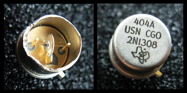

Phototransistor: A bipolar transistor where the collector-base junction is exposed to light and takes advantage of the gain of the device.
