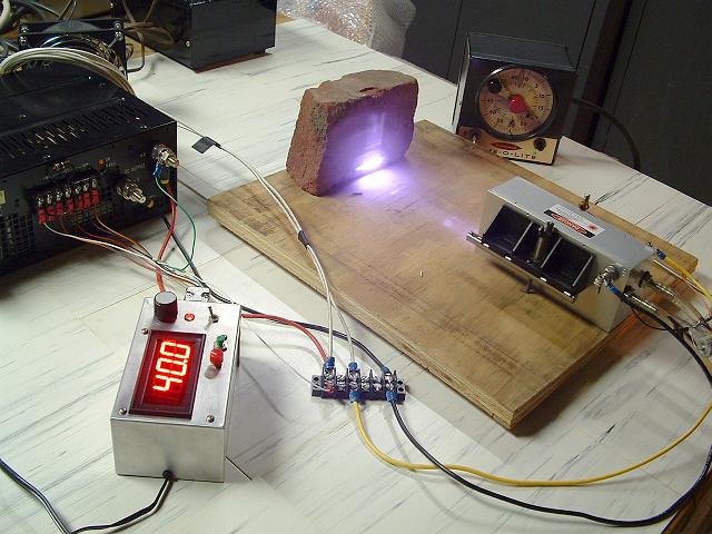

    And Those Really High Power Laser Diodes?
    You may have read about truly high power laser diodes - those putting out WATTs, 10s of WATTs, or even 100s of WATTs from a one diode or an array (bar) of diodes in a single package, or multiple laser diode bars. These are usually near-IR emitters, often at 808 nm. Solid State Diode Pumped (DPSS) lasers are driven by these light sources with some providing upwards of 1,000 WATTs (and the upper limit is climbing as you read this). Also see the section: Diode Pumped Solid State Lasers.

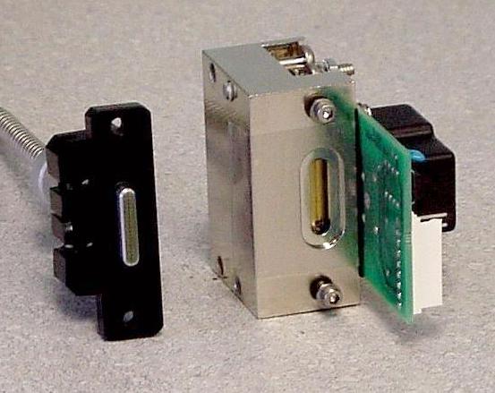

    About those laser diode bars:
    (From: Walter Skrlac (Walter.Skrlac@t-online.de).)
    "Bars are a 10 mm wide chip with typically 16 to 24 emitters, each emitter being about 150 microns wide and emitting up to 2 watts of power per emitter. The highest power for solid state laser pumping is 40 watts from a 19 emitter bar. Almost all bars are a single chip, multiple emitter device. I do know that in the beginning days of bars, Siemens produced a 5 watt device consisting of 5 separate 1 watt laser diodes mounted in a row 10 mm long. The individual laser diodes are connected in parallel so you can't switch them individually."
    The good news is that this technology is developing very rapidly.
    The bad news from our perspective is that there are no really low cost sources, new or surplus, for these diode lasers as far as I know at the present time. However, prices have been dropping rapidly since this was first written. The cost of 1 W 808 nm laser diodes has dropped below $100 new, and with luck, much cheaper from surplus sources and on eBay.
    Actually, it isn't necessarily the diode itself that is so expensive. A 1.5 W 800 nm diode chip goes for about $10 when they are purchased in reasonably large quantities. However, these are only about 0.5 mm on a side and maybe 0.1 mm thick. Mounting means using low temperature solder and flux to bond the chip to a large heat sink and copper strip (for the two connections - no monitor photodiode, that function must be performed externally). The soldering is best done on a hot plate (to raise the temperature of the heat sink and chip to almost the melting point of the solder), with a fine tip iron for the last few degrees. They have an HR and OC side, and a top and bottom, and thus orientation matters. So, if you have access to a surface mount rework station with a stereo microscope, a steady hand, infinite patience, and don't sneeze much (which will blow your chips away to never be found again), you could try your hand at the mounting. I have a couple of these diode chips so once I get up the nerve to try this, I will report on success or failure.
    The better way to deal with these laser diodes is to have them already mounted on a heat sink. But now we're talking about $100s for a single unit. But, for a number of reasons, the best type of high power laser diode to get is probably a fiber-coupled module. Then you don't have to mess with beam shape issues, the diode is safely tucked away out of harm, and the fiber output can easily be adapted to your favorite crystal shape. Some power is lost in the coupling but it appears as though the specs I've seen are similar for the bare diode assembly and fiber-coupled module. Of course, the cost for such a module now appoaches that of a nicely equipped PC. :) For more info, see the section: Anatomy of Fiber-Coupled Laser Diodes.
    Laser diode bars/assemblies of much higher power are available - up to the kW range and beyond. Of course, the prices go up as well. Check out CEO Laser as one possible supplier. They have a wide variety of really interesting items but unfortunately without any prices. Bars can be connected in series to ease the power supply requirements enabling them to be driven with lower current at higher voltage (e.g., a 4 bar configuration would use 8 V at 50 A instead of 2 V at 200 A). With individual chips on a common heat sink, this really isn't an option.
    Note that most high power diode lasers are near IR - often around 800 nm for pumping DPSS lasers or 830 to 870 nm for thermal platesetters. High power visible laser diodes are much less common and usually limited to less than a watt at 670 nm. Not that this is terrible. :)
    If you have your heart set on one of these for your birthday, all I can suggest at the present time is to keep track of what is available surplus and to check with the manufacturers listed in the chapter: Laser and Parts Sources. They do show up on eBay but accuracy of the description and operating conditoin may be unknown. If this is for some sort of academic project with a legitimate research objective, you may be able to obtain a cosmetic reject or one that doesn't quite meet specs by persistent pleading with one of the laser diode manufacturers. Or, if you can deal with the bare chips, it may be possible to beg a few from one of the companies that produces DPSS laser systems since they use them by the carload, and when purchased by the carload, the cost goes way down.
    Keep in mind that obtaining the diode is only a small part of the problem. To drive them reliably, particularly near their maximum power rating, will require a suitable constant current laser diode driver and proper cooling. However, if reasonable precautions are taken and they aren't run near their maximum ratings, actually blowing them out totally isn't nearly as easy as with their low power counterparts.
    And, needless to say, at these power levels, your eyes (and flammable objects) don't get a second chance - laser safety must be at the top of your list of priorities.

    Optically Pumped Semiconductor Laser (OPSL)
    Nearly all semiconductor lasers are powered by electrical current through the gain medium. However, for certain materials, it's also possible to use another laser to optically pump it. This has some significant advantages in terms of controlling transverse and longitudinal modes and beam shape.
    The first commercial OPSL was the Coherent, Inc. "Sapphire", a replacement for low power argon ion lasers at 488 nm. (I think the use of Sapphire is unfortunate as this has absolutely nothing to do with the Ti:Sapphire laser with which it may be confused.) The Sapphire is a Vertical External Cavity Surface Emitting Laser (VECSEL), but one that is optically pumped. (Also see the next section.) The resonator is in many ways similar to that of a frequency doubled Diode Pumped Solid State (DPSS) laser but with an InGaAs quantum-well semiconductor instead of a laser crystal as the gain medium. It is pumped by a high power 808 nm laser diode and lasing at the fundamental IR wavelength of 976 nm. This is intracavity doubled to 488 nm.
    Go toe Coherent, then "Lasers and Systems", "OPSL" for more information.
    One beauty of the OPSL approach is that with an appropriate choice of material and doping, the basic gain medium - the semiconductor disk - can be designed to lase at most or all of the range from 635 nm to 1,500 nm and beyond. (The UV/blue area is probably not viable yet). Thus, this entire range of wavelengths as well as one half the wavelength (frequency doubled or SHG), and possibly higher harmonics are available with the beam characteristics of a solid state laser. This technology may also be called a "Semiconductor Disk Laser".
    There is some information on the Sapphire including hacking the photodiode calibration to boost output power on W's Coherent Sapphire Laser Page.
    Several other companies are developing lasers using a similar approach and systems at many wavelengths - including those in the yellow/orange "no laser land zone" - are now available or will be in the near future. And, apparently, some companies call their OPS lasers "DPSS" even though strictly speaking, they aren't solid state in the traditional sense. There are a couple of ways of telling if a DPSS laser is really solid state:
    The first is the extended cavity semiconductor laser like the optically pumped Coherent Sapphire, but they may also be electrically driven like a normal laser diode (so only one laser instead - no pump diodes), and mentioned in the next section. However, many companies are now using a directly doubled diode approach - a laser diode feeding a doubler crystal outside the laser cavity, possibly periodically poled lithium niobate (PPLN) or KTP (PPKTP). This is probably not efficient enough to be practical for high power lasers, but for a 10s of mW, it's much simpler.

    Laser Diodes with Built-In Beam Correction
    Laser diodes are also available with the corrections built in. Check out the Circulaser(tm) from Blue Sky Research. These look like any other 3 pin bare laser diode in a standard 5.6 or 9 mm package but produce a nearly circular diffraction limited beam requiring no additional beam aberration correction for many applications. Their divergence is also much less than that of a typical normal laser diode (8 degrees typical) easing the requirements of additional collimating or fiber coupling optics and capturing more of the available optical output power. Complete specifications and a photo of a typical device can be found at their Web site.
    I have tested a Blueskyresearch PS106 (now discontinued but similar to the VPSL-0655-007) which is a 650 nm, 7 mW Circulaser(tm). The beam is indeed nearly perfectly circular with a divergence of about 8 degrees FWHM - less than that of the lower divergence (slow) axis of the typical bare laser diode. For datasheets, go to Blueskyresearch, then "Semiconductor Laser Products".
    Aside from the convenience of not having to worry about their funny beam shape, putting a microlens next to the laser diode itself results in much more of the light being used compared with what gets through inexpensive external optics. With the typical collimating lens used in laser pointers and diode laser modules, as much as 40% or more of the light from the diode may be wasted largely due to its high divergence in the fast axis (30 or 40 degrees total at the half power point, perhaps twice this at the 10% point) - a very significant fraction gets blocked by the small aperture of the collimating lens.

    Spectra-Physics High Power Fiber-Coupled Laser Diode Bar
    Unlike the Opto Power unit above, this Spectra-Physics "FCBar" places a special 19 core fiber end in close proximity to a 1.5 cm laser diode bar. See Spectra-Physics FCBar Fiber-Coupled Laser Diode Bar - Overall View and Spectra-Physics FCBar With Diode and Fiber Separated. The large black object is a relay which shorts the laser diode terminals when no power is applied. There is also a personality EEPROM on the PCB. There is a fiber microlens for fast-axis collimation. Since the fiber cores are relatively large (probably around 200 um), high efficiency coupling can be achieved as long as they are relatively close and aligned with the emitting apertures. Clamps and screws allow the tip to be positioned precisely so each of the 19 cores aligns with its mating aperture, close but not touching - about 0.1 mm in the samples I've seen.
    There is a temperature sensor but no TEC. The module was designed to mount on a "cold plate" fed directly by a hermetic recirculating chiller, water chiller, or tap water.
    At the other end of the armored cable, the 19 fibers terminate in an FC connector with a large multimode core. Why 19 fibers? Probably because 19 cylinders pack nicely into a nice hexagonal array with a somewhat circular perimeter. The series is 1, 7, 19, 37, 61,.... Of course, other values will work and for most applications it doesn't matter. The lower power version of these modules use a 7 core fiber.
    The laser diode bar has a threshold current of about 6 A and should be capable of at least 15 watts of output from the fiber. It was part of a solid state laser which was pumped by a pair of these FCBar modules. The output power of the solid state laser at 1,064 nm was probably around 10 W. I plan to test this diode further in the near future. Another unit I am testing has a threshold of 12 A, with a maximum rated output of 26 W. Its output at 25 A is 10 W with 22 W at about 40 A. Based on the test data for a similar new diode, it's a bit weak - 26 W at 40 A is typical. But it would probably still meet rated specifications. The model number is DMJ-ZLM-24-08. It's called an FRU Diode Module.
    A datasheet for the versions of these diodes in current production (but without the electronics) would appear to be a version of the Spectra-Physics (now Newport) Prolite SCT series. (Go to Newport and search for "Prolite SCT".) The exact models may not be listed here as there may be versions with intermediate rated output power (like the 26 W) not shown. But, it should be possible to interpolate power and current to get a reasonably accurate idea of the behavior.
    And, placing a CASIX DPM0102 composite crystal next to the diode array produces nice multiple (up to 3) parallel beams of green light. :)
    Repairing a Shorted FCBar Module - Sort Of
    I've come across several fiber coupled laser diode array modules which have a symptom of an almost dead short across the diode even with all other components (relay, reverse protection diode) disconnected. Upon disassembly, there was a very obvious carbonized area on the face of the diode as well as carbonized crud on the face of the fiber tip. I have preliminary results of repair attempts on two such modules. There is no way to get full power as one or more of the individual diodes has basically blown up. But some or most of the remaining ones may be salvageable.
    I believe the cause of these failures is contamination or moisture getting onto the front facet of the laser diode array. The modules that have failed in this way are not hermetically sealed due to the passage of the thermistor temperature sensor leads through oversize holes in the PCB. Three units arrived in this shorted state. One unit failed while I was attempting to cool it on one of those ice packs used for keeping your lunch cool and I expect there was condensation.
    Of course, if you have the big $$$ available, replacing the laser diode assembly itself is likely to be much more useful than the kludge below. Then, it would be a "simple" matter of realigning the fiber cable. But, the diode will have to come with the fiber microlens for fast axis collimation (added $$) and its individual emitting apertures must have the same spacing (pitch) and similar size compared to the original. In cases where that was a custom OEM part, a suitable replacement may not be available.
    The following is not something you should admit to in the presence of your boss, if he/she has anything to do with laser diodes. It's a long shot but if the alternative is the trash, there is nothing to lose. Here's the procedure. No guarantees of anything! Refer to Spectra-Physics FCBar Fiber-Coupled Laser Diode Bar - Overall View.
    1. Detach the fiber-optic cable assembly by removing the two screws holding it to the silver colored block of the FCBar module. Once the cable is free, inspect the elongated "tip" for debris and damage. On each of the four units I've seen, there was a very visible clump of carbonized debris covering the fiber tip opposite the diode(s) that shorted. Lens tissue an alcohol easily removed it without a trace. Once it has been cleaned, set the cable aside with protection for both ends.
    2. Detach the printed circuit board by removing the two Philips head screws connecting it electrically to the laser diode, the 4 hex head screws holding the PCB in place, and unsolder the two thermistor wires (not on all units). Set the PCB assembly aside in a safe place.
    3. Remove the hex head cap screws attaching the diode terminals to the diode block and pull out the copper terminal assemblies. Set them aside.
    4. Remove the remaining 3 hex head cap screws holding the diode block in place and set them aside.
    5. Carefully loosen the diode block from the heatsink compound or indium foil and remove it.
    6. Closely examine the output area of the diode. Opposite where the crud was on the fiber tip, there will be a corresponding blackened/melted area behind the fiber microlens. The lens itself may also be damaged. Hopefully, the short circuit is localized to this area.
    7. The trick is to carefully scrape away the front facet of the bad diode with a knife or razor blade to clear the short. What I suspect happens is that a bit of contamination or moisture on the front facet creates a conducting path. Current builds up in the immediate vicinity quickly heating and destroying the diode. The failed diode and at least one on either side will likely remain dead but hopefully, some, most, or all of the others can be salvaged. If the failed diode is near the middle of the array, it may be possible to do the scraping without removing the fiber microlens. However, if it's near one end, at least one end of the fiber microlens should be detached to provide enough compliance to get the knife or razor blade behind it.
      Work in small increments and use a current limited power supply to check the short. At some point, the remaining shorting crud may be vaporized and the diode will suddenly spring to life.
    8. Once the short is removed, the module can be reassembled. If the fiber microlens popped off or broke, you're on your own. If only one end came loose, use a drop of Epoxy to reattach it but make sure excess doesn't interfere with the location of the fiber tip.
    9. Reinstall the diode assembly. Center it and reattach the electrical terminals.
    10. Carefully check that the fiber tip of the fiber-optic cable assembly is about 0.1 mm from the fiber microlens when fully seated. Above all, it must not touch as the fiber microlens will likely shatter in that case. See the next section for the fiber replacement procedure.
    I told you this was a long shot! Comments welcome but nothing like: "There is no way in h*** that this can work!". :) I was able to recover 6 of 19 emitters on one module and 14 of 19 on another. Whether they will survive for any length of time is another matter.

    There are now laser diodes (or possibly laser diode arrays) with optical output measured in 10s, even 100s of watts though these will not be what you would call tiny and will probably require buss bars for electrical power and plumbing for cooling!
    Example of Laser Printer Diode Laser Module
    (Portions from: Chris Leubner.)
    This Laser Printer Diode Laser Module is from an older Xerox laser printer, laser scanner/duplicator, or similar device. It shows an example of a typical assembly consisting of an IR laser diode with collimating optics (in the metal barrel) and electronics driver board.
    Laser diode and optics characteristics:
    Note that this is only the front-end. It does not include the beam scanner (motor driven multifaceted mirror), field correction and directing optics, or beam position sensor - which would be present in a complete laser printer. The output of this module is a collimated IR laser beam. The actual focal point will be at the image plane (photosensitive drum surface) after passing through the other optics.

    The photo shown in Fiber-Coupled Laser Diode for Platesetter is of the assembly (one of up to 32) used in an ECRM "DesertCat 8", a high speed drum scanner for exposing printing plate masters in the graphic arts industry. It is a fiber-coupled laser diode mounted on a heatsink with TEC and thermistor temperature sensor. The diode in the little round can looks like it is from SDL though I've heard that Kodak may be the manufacturer of the overall assembly. The output is via an ST fiber connector.
                                          Power Output (mW) at a current of (A):
      Mfg/Model/Wiring     WL    Thresh   0.3 0.425 0.50 0.75 1.00 1.12 1.25 1.50
     ECRM/Kodak/SDL?     830 nm  280 mA    20   125  200  420  640  750*
      Wiring labeled
      on PCB.
    *The tested Iop value of 1122 mA was printed on the diode assembly. I assume that was for 750 mW since it agreed with my measurements. This may not be the maximum output power though (likely rated 1 W).

    Characteristics of Some Really High Power IR Diode Lasers
    Here are a couple of WHOPPING BIG DIODE LASERS!
    The first is shown in:
    The package is about 15 cm long and shoots a rectangular beam out the window at the right that focuses to a 1.5 cm line about 15 cm beyond it. On the sample in the photos, the threshold current is around 17 AMPS (!!!) and the slope efficiency is about 0.5 or 0.6 W/A. I could only go to 30 A using my cobbled together power supply described in the previous section. At this current, it produces 6 or 7 W. The slope efficiency seems a bit low but perhaps some power is being lost inside the box or maybe it's just a bit tired after long hours of plate-making. A similar diode is rated at 35 W max and 65 A`max (whichever comes first) with a typical threshold of 18 A.
    I had assumed the wavelength would be around 830 nm based on the intended application (see below). However, I have been told that it is made by Coherent, Inc., and may be closer to 810 nm which could be good for side-pumping Nd:YAG. Another sample which I tested for wavelength indeed showed multiple modes between 808 and 813 nm. This might be acceptable for pumping Nd:YVO4 but probably less than ideal for Nd:YAG which has a narrower absorption band.
    Without the integrator plate, wave plate, and objective lenses, most or all of the beam still exits the laser but it is modestly diverging. How do I know? Because this laser originally had those components knocked off and just bouncing around inside the package. While there is some surface damage to the broken off optics, they are still usable, though probably not to factory specs. Amazingly, the diode bar itself seems to have survived despite the original trauma and subsequent shipping.
    This laser is probably used in an Agfa platesetter along with a Silicon Light Machines linear spatial light modulator using "Grating Light Valve" or GLV technology as they call it. Essentially, the output of the diode is a rectangular beam that focuses to a 1.5 cm long line about 15 cm beyond the output aperture. The focal point is at the modulator - a MEMS (Micro Electro-Mechanical System) device that can selectively reflect or diffract the beam at 256 or more individual locations.
    See Silicon Light Machines Products and Technology and Xcalibur Platesetter Brochure.
    The reflected light from the GLV modulator is reimaged onto a master printing plate rotated on a drum and thus scanned helically with some number of pixels written simultaneously. This has some key advantages. Rather than having a gazillion individual diodes as in systems using the diodes described above, this uses a single BIG diode laser. The GLV device provides higher resolution and greater flexibility as well. And there should be a lot lower cost of maintenance unless, of course, the BIG diode in the BIG diode laser dies!

    CAUTION: If you do acquire a diode like this, they must be tightly coupled to a very good heat sink to survive. At a current of 1 A, they will be dissipating over 4 W. That's a lot of power for a 5.6 mm package! Clamp between a thick aluminum plate and aluminum heat sink (preferably temperature controller) with as much surface area as possible in direct contact.
    I have begun to test one of these diodes. It's clamped to a thick aluminum angle bracket which is screwed to my high power TEC plate maintained at 20 °C. The threshold current is about 201 mA and there is a small amount of hysteresis - 1 or 2 mA. So the lasing doesn't start gradually but "pops" on and "pops" off. And even just above threshold, it is already way too intense to ignore safety precautions - especially considering that the perceived brightness is about 25 times *lower* thatn the 555 nm peak.
    What's even scarier is that even though laser diodes are quite susceptible to damage, with just a bit of care, powering is trivial. While I was using a lab controller for testing, AA cells are quite adequate once the basic parameters (operating current and voltage) have been determined approximately. See High Power Laser Diode from Casio Projector Powered by AA Cells. Two similar bare diodes are shown next to the U.S. Quarter for size comparison. The entire "power supply" consists of 4 AA Alkaline cells, a 5 ohm current limiting resistor, and a switch. In the photo, the LD is running at only about 100 mW. It could easily run at 1 W with a lower value resistor. (However, for diode health, a basic current regulator like a LM317 would be desirable if running near its maximum ratings.) Rigs like this - along with a collimating lens - are showing up on eBay and elsewhere without regard to either safety regulations or safety in general.

    The Nidek DC-3000 is a system that provides up to 2 W of output power via several types of fiber-optic delivery devices for use in treating a variety of retinal eye disorders and is typical of this type of laser. While the DC-3000 dates from the early 1990s, the DC-3300, which is the modern version, has virtually identical specifications (but a spiffier front panel!). More information including detailed specifications may be found on the Nidek Web site. Similar ophthalmic lasers are manufactured by other companies.
    The overall system consists of the laser itself with a user friendly control panel, and the delivery devices. There is also a detector unit for checking power output.
    The laser/optics consists of a pair of SDL (probably SDL-237X) ~800 nm laser diodes with beam shaping and collimating optics feeding a polarizing beam splitter used as a beam combiner. Both diodes are oriented the same way so one of them has a Half-Wave Plate (HWP) in its beam path to rotate the polarization by 90 degrees. I assume two diodes were used either because a single high power diode would have had too large a stripe width to be easily coupled into the fiber, or because a suitable single high power diode wasn't available at the time. It appears as though both diodes are used at all power levels.
    The collimated combined beam passes a photodiode power monitor beam sampler and a dichroic mirror to combine it with the aiming beam from a red HeNe laser. The beam sampler must also check for back reflections because the laser produces an error and shuts down if the output alignment is highly incorrect.
    The beam is then focused via an anamorphic lens into a fiberoptic cable of the delivery device. For the ENDO probes, the fiber core diameter is 400 um and virtually 100 percent of the power in the collimated beam makes it into the fiber. However, for the other delivery devices, the fiber core may be only 180 um, in which case there is some loss, perhaps on the order of 25 percent. This is one of the reasons the specifications call for only 1,500 mW except with the ENDO probes.
