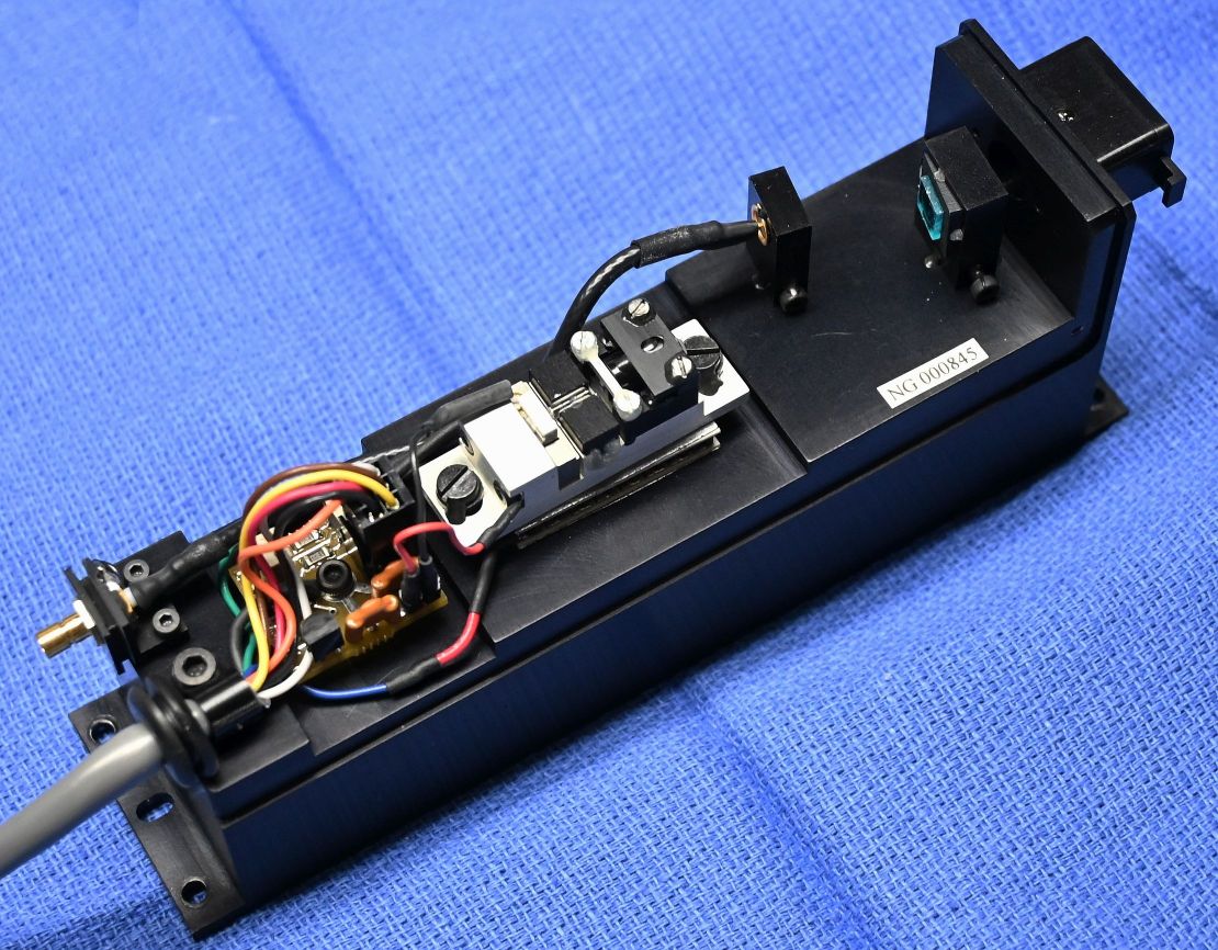

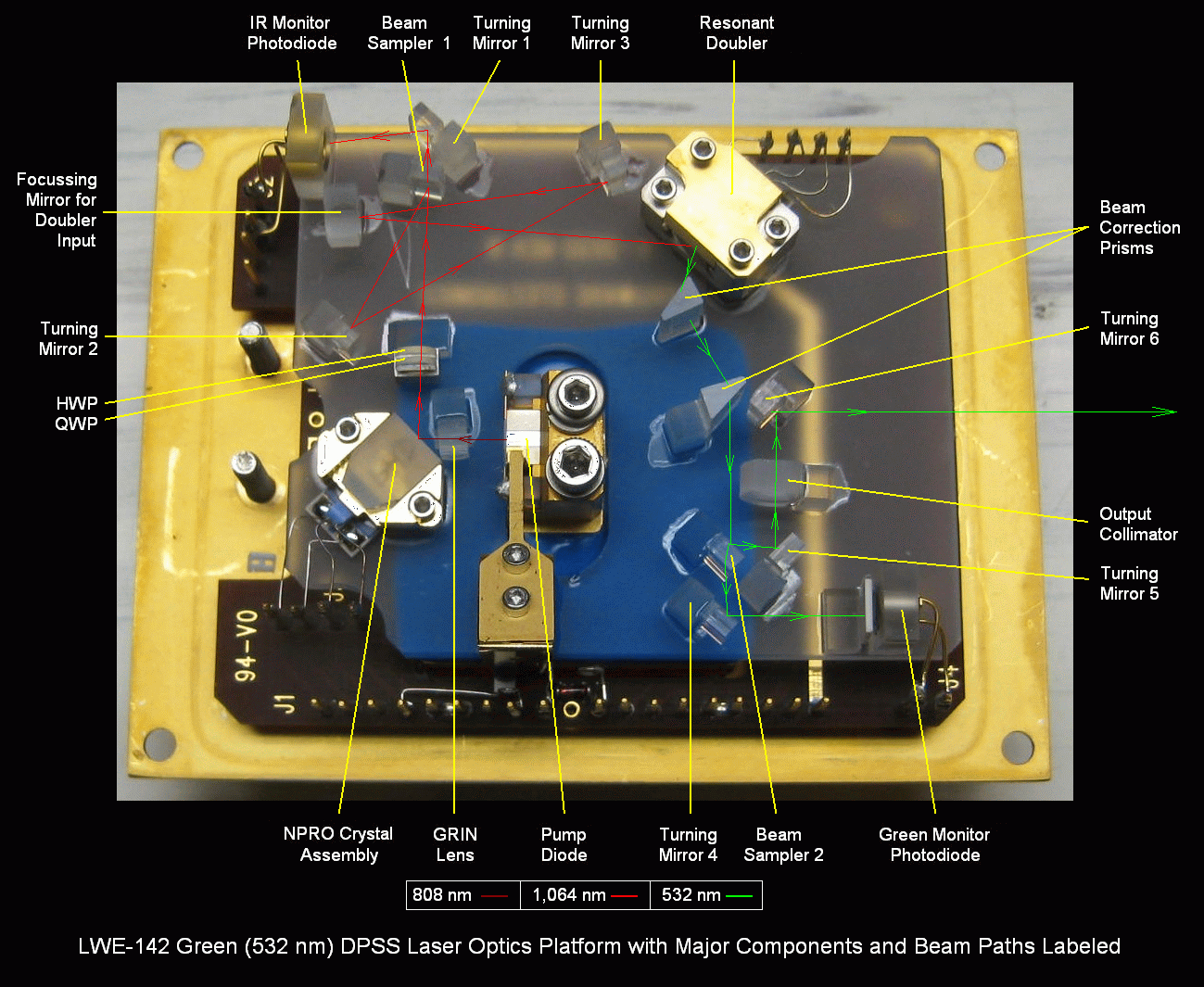

The laser head consists of the flashlamp and YAG rod in a sealed box, the KTP doubling crystal (outside the cavity), servo controlled apertures (variable slits) for X and Y spot size, and a servo controlled attenuator to adjust pulse energy. Note that this attenuator approach is much simpler and more consistent than alternatives using adjustable capacitor voltage or pulse duration control.
The YAG rod is probably about 50 mm long by 3 or 4 mm in diameter, AR coated both ends. The mirrors are glued to the cavity box with the end plates being on split washers to do the alignment. (At first I thought they were non-adjustable, until I attempted to disassemble it!) The servos are the types used for RC models but work fine in this application. :) Optics are glued to precision X-Y adjustable mounts. A fiber optic light pipe cable introduces a targeting beam for viewing the dimensions of the laser spot into the light path via a 45 degree dichroic mirror which is transparent to the laser beam but reflects an adequate portion of the white light beam.
Energy into the flashlamp is about 28 joules (66 uF at 850 V provided by three 200 uF, 330 V photoflash capacitors in series). Triggering is via an SCR and EG&G trigger transformer to an external electrode on the flashlamp. I don't know what the exact maximum output energy is but for this application, but less than a mJ is adequate once the beam is focused to a spot of a few um.
Output energy per pulse is adjusted by rotating the polarization of the green beam with respect to a fixed polarizer, rather than by controlling the energy storage capacitor voltage or actual energy into the flashlamp. A half waveplate in the green beam is physically rotated by a servo based on the setting of a knob on the front panel.
The optics chain consists of:
The optical path is a loop - the laser shoots down but the two pairs of bounce mirrors turn the beam around twice by 180 degrees. The primary benefit of this arrangement is that the laser head can be about half as long compared to one that was linear. The four folding mirrors do provide additional degrees of freedom to adjust alignment into the microscope objective, but this also makes alignment quite counter-intuitive. And, the slow pulsed laser (maximum rate of 1 pulse per second) doesn't make this any easier! An sensitive averaging thermal or pyroelectric laser power/energy meter with a small probe that can be placed at various locations within the optics chain is essential. Doing it by eye would not be fun!
The controller consists of analog knobs for X and Y aperture and laser power (operating those RC servos, all with digital readout, presumably simply of voltage on the pots), single shot or 1 pulse/second select, and a knob for the targeting light source brightness via a phase control dimmer. Nothing is particularly high tech, but does seem reliable! There are a bunch of trimpots on the hand-wired logic board (!!), probably to adjust the servo limits and maybe set the repetition rate. I don't believe there is any regulation of the laser energy or even flashlamp voltage.
Although the output of the YAG rod is clearly dangerous (it is probably 10 mJ or more) and the final green output may even be hazardous to vision, the system has a Class I rating (unconditionally safe) because everything is fully enclosed under normal operation, it's essentially impossible to place one's eyeball at the output when said eyeball is in its normal location. :) And with the usual delivery via a microscope objective, the beam is very widely diverging at that point and essentially harmless even if reflected from a mirrored surface. There are two sets of head interlocks (which can be bypassed for servicing via jumper plugs): A magnet on the cover and dual reed switches detects cover removal, and a tilt sensor detects if the laser head is not vertical to within 20 or 30 degrees. These are in series with the master interlock connector at the back of the controller and any one of them disables primary power to the high voltage transformer. (The rest of the system continues to function). The firing logic requires a momentary SPDT switch to close one circuit and open the other within a short time. For manual operation, this would generally be a footswitch, but could be from a computer controlled relay, or possibly direct from TTL levels.

There are a number of versions. An older one, the DPY-305c consists of a power supply unit and laser head, which looks sort of like a Startrek phaser: Adlas DPY-305c Laser Head. The power supply attaches to the laser head via a cable with an 8 pin plug, but there are only 6 separate connections as the main power feed is doubled up with two pins for +5 VDC and return. That leaves 4 remaining signals, 2 of which are fat wires and the other two are the same color. These are for the TEC drive. Indeed, the resistance across the two fat wires is close to 0 ohms. And although one of the wires to the connector is green (it's not ground!), a tell-tail fat red wire can be seen spliced to it snaking into the bowels of the laser head, approximately where the TEC would be. So, it's almost certain that the laser diode driver is entirely within the laser head powered solely by 5 VDC, but the TEC driver is in the power supply box.
The unit I'm testing is a model DPY305c, no output power rating listed. The laser head itself has quite a bit of circuitry in its squarish rear section, along with a heatsink and cooling fan. The laser/optics are in a cylinder protruding out the front. Unfortunately, gaining access to the laser/optics appears to be a major undertaking, requiring extensive disassembly. The circuitry inside the laser head is on two small PCBs, one above the other, attached via wiring and components with additional parts sandwiched between them. From the similarity in some of the electronic components that are used, it's possible that the same designers worked on the Adlas 300 prior to developing the DPY315M and what later became the other Compass-M lasers. But none of the spiff and polish of the Compass-M construction is evident anywhere in this laser head and some of the soldering is absolutely dreadful. It looks like getting to the laser optics platform may be near impossible without extensive disassembly and unsoldering of wires or worse.
The laser powers up but is extremely unstable with wild and continuous output power fluctuations between less than 1 mW and perhaps 50 mW, though the 5 VDC power is rock stable. The actual rated output power is not known but it has been suggested by a Web search that some versions of the Adlas 300 at least are rated up to 250 mW. (The CDRH sticker lists 300 mW for 532 nm so that can't be the rated output power. Not surprisingly, these stickers are identical to those used on the Compass-M lasers!) Given the difficulty of access and the relative rarity of these lasers, I'm not sure how far I will go. If anyone has additional information on these lasers, please contact me via the Sci.Electronics.Repair FAQ Email Links Page.
The power unit is probably more than just a set of DC power supplies, but also the actual regulated current sources for the pump diode and TECs, which are then programmed by the controller.
Except for the key-lock power switch; power, emission, and READY LEDs; and "CAL" and "SCAL" pushbuttons (more below), all of the user interface - what of it there is - takes place via an RS232 port. This allows the output power to be changed, shows status, and enables the initiation of the CAL and SCAL functions. A DB9F to DB9F cable with pins 2 and 3 swapped is required to connect it to a PC. Protocol is 9600 baud, 8 bit, no parity. I used PCPLUS emulating a Televideo 925 but the basic interface doesn't use any screen commands, so the terminal type is irrelevant. However, there is a special "ADLAS.EXE" program (DOS/Windows) that may do more.
These lasers use a linear cavity like the Coherent Compass-M, but with nothing folded, not even the output beam path. So, the pump diode is at one end and the output aperture is at the other. Thus, the lsaer head is about twice the length of C215M or C315M with a similar or slightly larger cross-section (not including the heatsink).
When first powered up, the laser goes through a CAL procedure based on the previous power setting, which is stored in NVRAM. CAL keeps the pump diode temperature and current fixed, and systematically varies the resonator parameters over a limited range while monitoring output power and keeping track of the maximum during this search. The parameters that are varied are probably RES and KTP temperature as with the C315M. It then goes back and tries to lock using the stored parameters - what it calls the "test point". If unsuccessful after some predetermined time or number of complete searches, it goes to SCAL or "Super Calibrate" which widens the range of variation including bumping up the pump diode current, and if that doesn't work, eventually incrementally decreases the selected output power until it succeeds, or fails and gives up.
When powered from a cold start, or when running CAL or SCAL, the RS232 spits out several numbers periodically. The first two are probably essentially the RED and KTP temperature coordinates as they increment in a fixed sequence. The third number is proportional to the output power. For every set of 3 numbers, it also spits out about 16 lines with simply an "*" located in proportion to the output power. So, watching the lines scroll down the screen shows a rough graph of the power trend. The user manual describes this by stating that "some activity can be observed which is of no meaning to the user". :) When it has completed a search, it resets the parameters to the "test-point" values and tries to lock if the peak output power it has memorized is at least equal to the selected output power.
Once the laser becomes READY, the output power is very stable with only a slight drift as everything reaches a steady state temperature. However, it's possible that it may call for a CAL to be initiated (automatically) if parameters drift too far during warmup. This would be similar to the behavior of the Coherent C215M, where the overall resonator is not temperature controlled.
While the specifications do not mention single frequency or Single Longitudinal Mode (SLM), the first one I have tested is definitely very pure SLM and should be ideal for holography or interferometry applications.

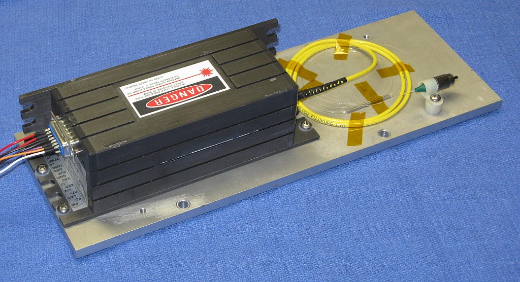

In terms of beam characteristics, the beam profile of all samples of the C315M (or C215M or C415M) is virtually identical, nicely circular and Gaussian. This probably derives from the robotic assembly line resulting in a very high degree of consistency from one unit to the next. The beam from a C532 is less consistent varying from perfectly circular to significantly elongated (usually vertically). Both lasers are linearly polarized vertically.
Both lasers should be good for holography and interferometry. However, since the C532 is a unidirection ring laser, it's virtually guaranteed to be single mode and have long coherence length. The C315M is single mode under most conditions, though not guaranteed by the resonator configuration. As a practical matter it probably doesn't matter.

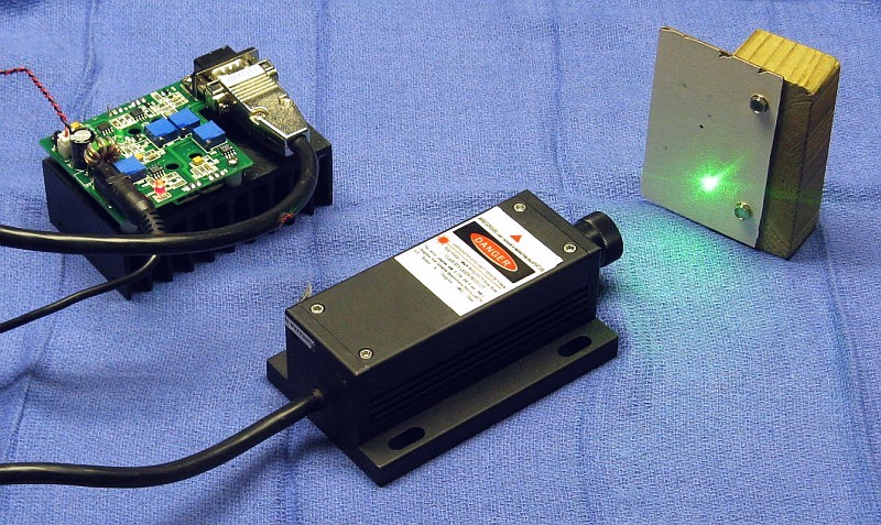

I've constructed the circuit below inside a little (antistatic) plastic box with the salvaged backpanel-to-mainboard game port adapter from a defunct PC. CAUTION: The wiring of these may not be standard - use an ohmmeter to confirm pin association between the DB15F and IDC16 header. See Photo of C315M Laser Control Panel 1. This has been tested on the C215M, C315M, and C415M. The indicators are an LED turned on by the "T" switch and a status LED (not shown above) which flashes at about a 2 Hz rate when the "L" switch is on but before the laser has stabilized and on solid when the power level selected has been achieved is locked in. See: C315M Laser Control Panel 1. (Note: This updated version actually uses the logic confirmation of TC-On and LD-On for the LEDs rather than the switches themselves. Thus if the laser turns off due to some fault, one or both LEDs will also go off.) I have a few bare (unpopulated) printed circuit boards available for this control panel, though I'm not convinced using the PCB is much easier than just constructing the circuit on a piece of prototyping "Perf" board. Note: These do not designed to autostart - the switches should be sequenced manually.
Note: Since the Power Set input has a resistance of only 10K ohms, the actual power is NOT linear with pot rotation. The non-linearity is reduced for lower resistance pots but it may still be annoying even with a 1K ohm pot, about the lowest resistance that should be used. Therefore, where there is no panel meter display of the power setting and a linear relationship is desired, a unity gain buffer using a rail-to-rail 5 V op-amp like the National LMC6482 should be added.

The optical design of the C215M laser head is virtually the same as for the C315M but there is no TEC at all for the resonator and the connections for the upper LD TEC are also not present. This was determined both by the observation that the P3 pot (RES temperature setpoint) was missing from the head PCB (but the pads for it are there) and the RES TEC and Upper LD TEC pins read as an open circuit. (On some samples, the P3 pot and its associated components are present but presumably serve no function on C215M lasers.) The connector pins for the RES and LD thermistors are also shorted together internally which means there is no separate RES thermistor. Therefore, the conclusion is that the LD and RES mounting plates are one in the same. The lack of an upper LD TEC wouldn't appear to matter much as it's likely both TECs would only be needed under worst case conditions of high diode current and high heatsink temperature. Since the C215M runs at lower power, this situation wouldn't be present.
Despite the lack of a RES TEC and upper LD TEC, it seems as though the C215M can be powered by the Coherent Analog Controller for the C315M though it is not known if the efficiency and stability of laser output power will be as good as with the proper controller. With the lack of a RES TEC, one of the required optimization parameters is lacking. However, it's very likely that the optical platform is actually thermally tied to the laser diode since it almost certainly does need to be temperature stabilized. What the implications of having the same LD thermistor for both the LD and RES temperature control loops means is not known. I also don't know whether anything else has also been changed, or if they just accept the consequences for this lower power laser.

The following are brief descriptions of each of the labeled parts in the last photo which is also included here as C315M Cavity Components and Output Optics.
What appear to be the threshold, operating, and maximum current for the laser diode when new are scribed on the top of the laser diode case. (The order of these values may not be the same in all instances.) For example, a typical set of numbers might be: 0.70 1.75 2.43. I assume these are in amps for the specific laser head at its optimal temperature settings. In the example, 0.70 would be the lowest current for any green output; 1.75 would be the current at the head's rated output power, and 2.43 would be the maximum safe current for the diode (and probably the current limit setting on the head PCB). However, I have seen at least one case where the Coherent Analog Controller increased the current higher than the engraved value so I'm not sure how much attention is paid to it. But I didn't let it increase it much beyond the value so it might have just been my measurement error.
Note that contamination on this surface may result in a change in the photodiode sensitivity since it is in close proximity to it, possibly long before there is a noticeable effect on the beam. It's possible that even in the sealed enclosure, there can be enough change over time to result in a power drop off because the scatter increases photodiode sensitivity. Maybe that's why the photodiode for power monitoring in the C415M is separated by a significant distance from the angled plate.
By careful temperature tuning of the KTP and cavity length, it should be possible to select single longitudinal mode/single frequency operation of this cavity design using the polarization preference of the Brewster plate and birefringence of the KTP crystal to implement a birefringent filter, and the KTP surfaces as an etalon. See the section: Birefringence or Etalon Effect Used for Mode Selection in C315M?. This would select out a single mode within the YAG gain curve. Since there is separate control of KTP temperature and overall cavity length (via temperature control), there are enough degrees of freedom.
The "roof" and stops don't appear to affect beam quality in any major way. However, they do suppress ghost beams inside the laser. One purpose may be to minimize stray 808 nm and 1,064 nm "light" from hitting the power monitor photodiode. Without the roof, Stop 1, and Stop 2, the photodiode sees about 50 percent more power with the lid in place than without it. I don't know how much of this is 808 mm or 1,064 nm rather than the desired 532 nm.

I then tried this stunt on another C315M laser head that had been partially disassembled but it turned out to be a hopeless case. Among other things: The gold plated case walls are gone - removed using a Dremel tool by the previous owner - and I had to wire a connector directly to the laser substrates; the Brewster plate had popped off, fell on the floor, and was reinstalled; the diode was swapped from the dissected C315M laser head whose photos are immortalized in the Laser Equipment Gallery (Version 1.94 or higher) under "Coherent Diode Pumped Solid State Lasers"; and the first turning mirror came unglued. Aside from these minor problems, the head is in perfect condition. :) However, it wasn't totally dead. True, the threshold for green lasing with the temperatures at optimal settings was found to be 1.3 A and the maximum output power was around 10 mW at 2 A, but driving it with the LDC-3900 sure beat the 4 variable voltage power supplies (no temperature feedback) I had been using! Someday I may attempt to determine what exactly is wrong as I don't believe it is due to a weak or misaligned pump diode. I later tested both diodes and found them to be fine. There could still be contamination on an inaccessible optical surface (i.e., the HR mirror or rear face of the YAG rod) or even on the other surfaces that I haven't cleaned adequately. It doesn't take much to kill power when there are 8 intracavity surfaces!
Later, I tested a pair of C315M-100 heads I had attempted to repair on the LDC-3900. These both had intact head PCBs but neither was totally healthy so testing them on the Coherent Analog Controller wouldn't prove much.
To use the LDC-3900 with the head PCB in place, the thermistor pullups must either be removed or have +5 VDC (pin 25) jumpered to Common (pin 23). The result is a sensor with a 5K ohm resistance at around 25 °C resulting in a temperature reading of around 42 °C using the default C1/C2/C3 parameters and the incremental sensitivity around (actual) 25 °C is about 2 actual °C for each unit in the readout. However, the response of this equivalent 5K thermistor as the temperature moves away from 25 °C is not at all close to a true 5K thermistor and I have so far been unsuccessful in determining a set of C1/C2/C3 parameters that would result in anything close to actual temperature values for the setpoint and readout. Thus, the values for "T Set", below, are not the actual temperature. Nor do they have enough precision. At least one additional digit of resolution would be needed to accurately set the temperatures for maximum performance.
On one of the laser heads, Turning Mirror 2 and Output Lens had popped off. These were straightforward to reinstall. However, it was then found that the lower LD TEC was nearly open and had to be bypassed with a jumper wire to be able to use the upper LD TEC. This works well enough on the LDC-3900 if the laser is on a good heatsink which is well cooled so that the waste heat from the upper LD TEC can get through the dead lower LD TEC. But I'm not about to risk it on the Coherent Analog Controller. However, on the LDC-3900, the settings below resulted in an output power of 100 mW at 2.0 A of pump current:
Function I Limit C1 C2 C3 Gain T Limit T Set ---------------------------------------------------------------------- LD TEC 3 A 1.125 2.347 0.855 30 50 °C 42.1 KTP TEC 200 mA 1.125 2.347 0.855 30 60 °C 41.1 RES TEC 1 A 1.125 2.347 0.855 30 50 °C 39.9
With finer resolution in the temperature settings, somewhat higher performance would likely be possible.
The other head had its OC Mirror popped off and a damaged KTP crystal. See the section: Reinstalling the OC Mirror on a Compass-M Laser Head. After reinstalling and aligning the OC mirror and replacing the KTP crystal from a certifiably DOA head, the output is still low. It is only producing about 10 mW at 1.5 A of pump current on the LDC-3900 with the following temperature settings:
Function I Limit C1 C2 C3 Gain T Limit T Set ---------------------------------------------------------------------- LD TEC 1 A 1.125 2.347 0.855 30 50 °C 38.1 KTP TEC 200 mA 1.125 2.347 0.855 30 60 °C 42.0 RES TEC 1 A 1.125 2.347 0.855 30 50 °C 40.6
The head was also tested on the Coherent Analog Controller resulting in 25 mW at 2.2 A (the third number engraved on the diode case, though the controller did go up to 2.5 A producing 36+ mW.) I set it for 21.5 mW which was at 2.13 A. So, it's now officially a C315M-20. :) While I didn't actually compare the performance that carefully, I'd say that the results of the 5 minute controller algorithm were comparable to my hour long adjustment procedure on the LDC-3900. :)

The following are brief descriptions of each of the labeled parts in the last photo which is also included here as C415M Cavity Components and Output Optics.
The threshold, operating, and maximum current for the laser diode when new are scribed on the top of the laser diode case. For example, a typical set of numbers might be: 1.08 2.78 3.53. (The order of these values may not be the same in all instances.) I assume these are in amps for the specific laser head at its optimal temperature settings. In the example, 1.08 would be the lowest current for any green output; 2.78 would be the current at the head's rated output power, and 3.53 would be the maximum safe current for the diode (and probably the current limit setting on the head PCB).
Here are the specifications for the 532 (from the user manuals and various other sources):
(High power versions are those with a maximum rated output power of 200 mW or more.)
Here is some more technical info on the laser and controller:

Here is a brief description of each component:
I dissected a dead SDL-2372 by filing around the edges and drilling a hole in one corner of the top so I could use a screwdriver as a lever to pry the top off. The laser diode itself is on a standard C-mount screwed to a large gold plated copper block along with the temperature sensor thermistor and monitor photodiode. The block is soldered to a TEC which almost fills the bottom of the case. On the dead one, the solder had come apart and the block also came loose from the terminal pins. I don't know if that was all due to mechanical shock, poor manufacturing, or the TEC being overdriven in the heating direction. I reassembled it with silver Epoxy instead of solder and it still works, though the slope efficiency is near the low end of the acceptable range listed in the specifications. So, it may be normal or a sign of prior damage. There is no obvious problem with the beam profile so it's possible that nothing is wrong.
Although a bit hard to make out in the photo, the intracavity beam path is: cry1 (YAG), then reflect off of the left surface of op4 (HR mirror), through cry2 (KTP), then reflect off of the right surface of op6 (OC mirror), through op5 (angled plate), and finally back through cry1.

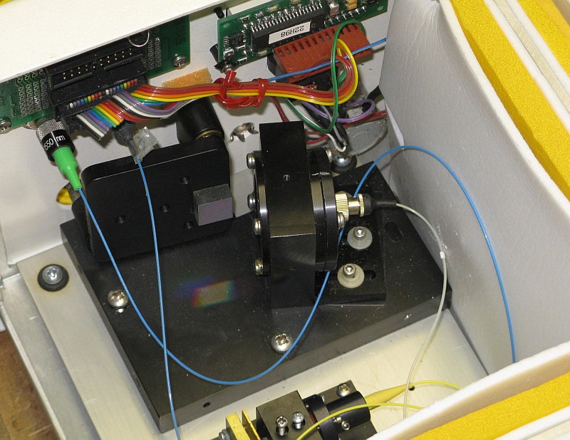

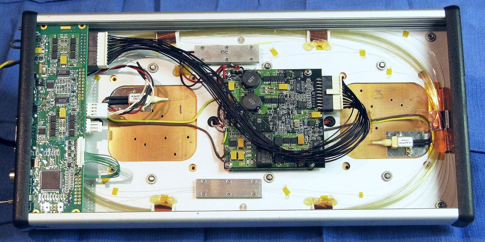

Like the also very high quality but lower power C532, the Verdi is based on a unidirectional ring cavity configuration. The ring virtually guarantees low noise single frequency operation. The actual Verdi cavity is dual fiber pumped and has a "bow tie" or "figure of eight" geometry as shown in Ring Cavity Resonator of Coherent, Inc. Verdi Green DPSS Laser. Each fiber can provide 20 or more watts of 808 nm pump power (depending on the Verdi output power rating). A photo of the inside of an actual Verdi can be found at Coherent Verdi DPSS Laser Cavity with Components Labeled.
Here are descriptions of the various parts. For the optical paths, brown lines are 808 nm pump light, red lines are fundamental 1,064 nm, yellow lines are 1064 nm + SHG 532 nm, and green lines are the 532 nm output.
Note: Although the CDRH sticker on uGreen lasers usually says "125 mW max" even for a 10 mW laser, we all know what that means - absolutely nothing. It's just a safety rating, not an actual output power rating. These lasers are not designed to run at more than 50 mW, though it's likely that the 10 mW and 50 mW lasers of the same model series are actually the same, except possibly for the pump diode. So, anyone listing these on eBay as 125 mW lasers should be politely informed of the facts. :) Having said that, I have seen around 100 mW from a particularly "hot" sample of a uGreen 4601-050-1000 when driven close to the diode current limit. This may be relatively safe for a laser using discrete crystals and optics. However, I wouldn't recommend pushing your luck with uGreen lasers using a composite crystal like the 4301 (and 4501) as they may have a relatively low destruction threshold.
(There are also Uniphase uBlue lasers but I have no idea if they are in any way similar to the uGreens in their construction details.)
The first laser head I tested was a 4601-010-1000, possibly an OEM model for the graphic arts industry. The second number in the model is the rated power - 10 mW in this case. The controller is a model HYB B 2.3, an older style. It runs off 5 VDC and required up to 5 A during warmup, settling back down to about 2 to 3 A after stabilizing. (Higher power models will likely require greater power supply current and a 10 A power supply is recommended.) The laser is manufactured in the UK.
Most of the uGreen lasers including the 46XX/47XX models use diode pumped vanadate-KTP-OC mirror Fabry-Perot cavities and their design appears conventional in all respects except one: The vanadate is ground with significant wedge and also mounted at an angle so that the the intracavity beam (which is aligned with the axis of the laser) is deflected slightly at its surface. The angle isn't anywhere near the Brewster angle for a vanadate-to-air interface. The purpose is most likely to eliminate any reflections from the surface (even though it is also AR coated). The polarization preference of the vanadate along with the birefringent filter effect provided by the KTP is likely sufficient to maintain single mode operation for the modest range of power over which the uGreen laser operates (10 to 50 mW). This is confirmed by the behavior of the laser with respect to temperature adjustment of the laser cavity.
