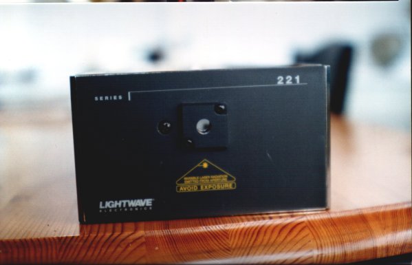

And a front view, showing the output window.

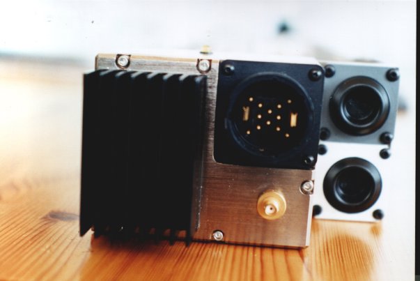

And a rear view, showing the PSU connector, modulation connector, heatsink for the AOM driver, and in-and outlet for chilled water for the diodes.

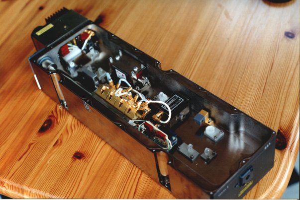

OK. It's been almost 10 minutes since the postman brought it here: GOTTA YANK THE LID OFF!

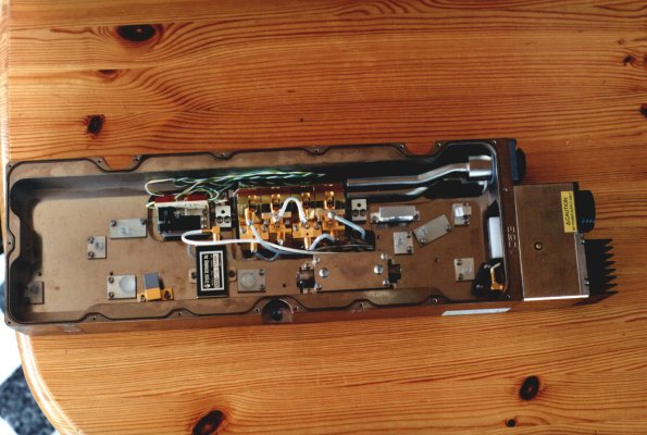

Another full view of the insides of the laser.

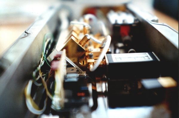

The center part of the laser, with the YAG pumping assembly and the AOM (a bit blurry, sorry).

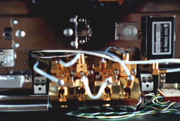

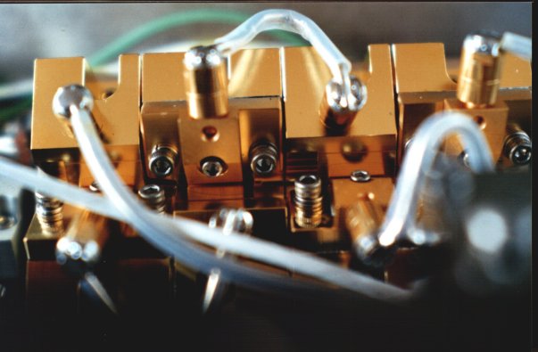

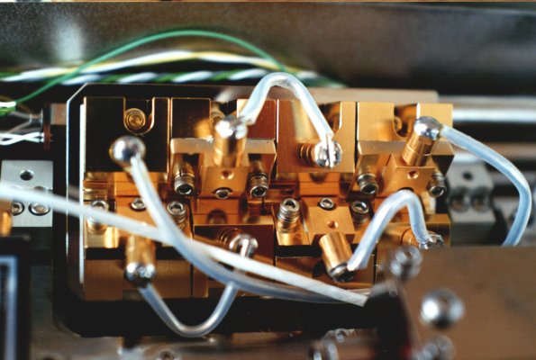

The YAG pumping assembly. It consists of 4 individual diode bars. I think they are 20 watts each.
Another view of the pumping assembly. You can just spot the end of one of the two YAG rods below the unbracho screw in the center of the picture. They are VERY thin - about one millimeter in diameter - and 4-5 cm long.
A view into the end of the yag rod and assembly.

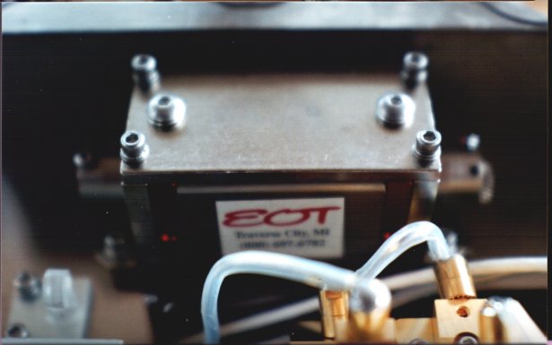

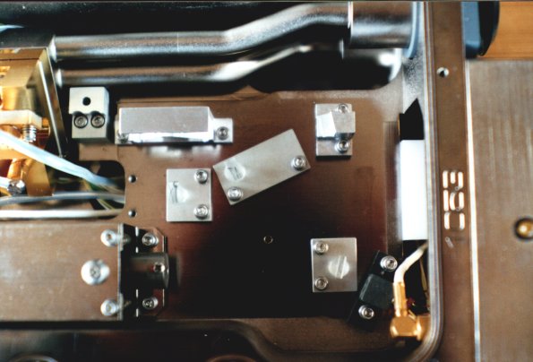

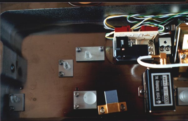

According to Bob, this strange gizmo is a called a "Faraday isolator". Its purpose is to prevent laser reflections going back into the laser cavity. It's like a diode for light.

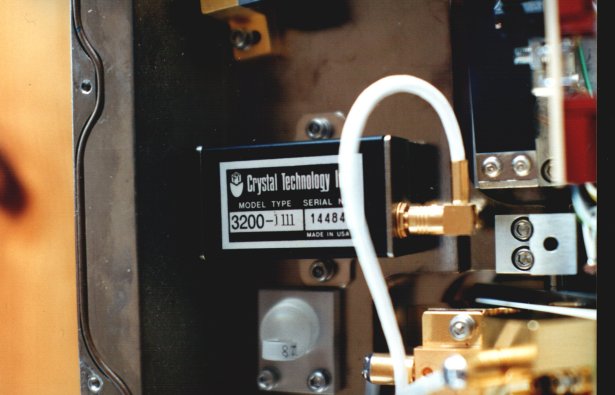

The AOM. For some reason it is only capable of dimming the laser down to approximately 3 watts.

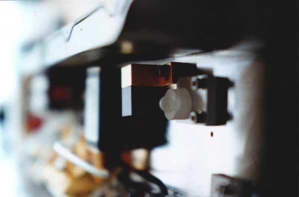

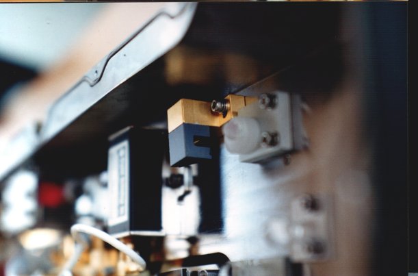

At first I thought this was a holder for a KTP crystal, if you wanted to double the output frequency to 532 nm (the laser is available in a 532 nm version too). But now I know, it is just a beamblock for the beams from the AOM, when the AOM turns off the light.
Another view of the beamblock, with the AOM in the background.

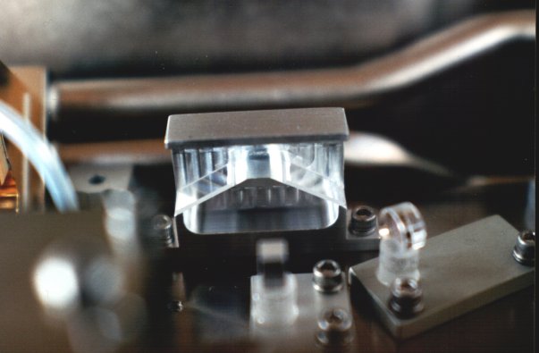

The beam shaping prism assembly, placed at the end of the YAG pumping assembly.
Another view of the back end of the laser, with the beamshaping, mirrors, photodetector and so on.
The photodetector, behind one of the mirrors. Gotta remember to tighten that screw on the photodetector.

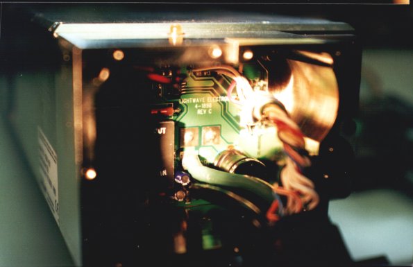

The insides of the back electronics box. The round black thing in the bottom is a coil, connected in series with the diodes. Strangely enough there doesn't seem to be a relay to short the diodes, when they are not in use, to prevent damage from static discharge. I hope the diodes are still OK, or else this is going to be a very expensive project. :-(

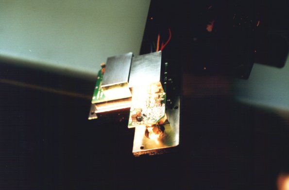

The controlling HF electronics for the mounted on the backplate.
Another view of the electronics.

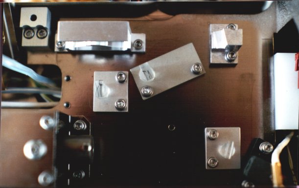

To my luck they had written on some of the optics, what they are, but I have a bit of difficulty reading their writing and understanding their terms, so a bit of help would be appreciated!
I have put numbers on the optics on the picture, with the writing on them, here:
  1. "200 CM HR IH" (I understand that it has 200 cm radius of curvature, and is an HR mirror, but what is IH)?
  2. This is the beam shaping prism assembly. I could not find any writing on it.
  3. There is no writing on this optic either, but on the holder, "JS" is engraved.
  4. "200 CM OC IV" (output coupler with 200 cm curvature, IV maybe just mean 4, but why 4)?
  5. "FL+ HR/HT JX" (FL+ could also be FLT (Filter?) HR and HT are understood, but I thought they meant the opposite of each other, and what is JX (could be TX (transmissive)?
  6. "FL+ HR Blood" (FL+ could be FLT, Blood could be Bleed or Blccd, I have no idea what this means, except the HR part).
  7. "32mm JC" (JC could be TC or IC. I guess this is some focusing optic for focusing the laser light into the AOM. (32 mm focal length)?
  8. "75mm HZ" (again I guess something about 75 mm focal length, but what does HZ mean)?
  9. "FL+ HR JX" (FL+ could be FLT, JX could be TX or IX. again, I understand the HR, but the rest, I don't know anything about.
  10. "FL+ HR/HT JX" (FL+ could be FLT, JX could be TX or IX. Don't know what this does).
