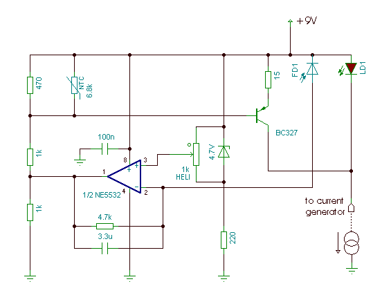

"I am designing a driver circuit for a laser diode (NEC NDL3220S). The problem is that the spec sheet says the output of the monitor photodiode at rated power is max: 0.5 ma, typical: 0.3 ma, min 0.1 ma, at 5 V. This is a huge range! If I set for 0.3 ma and the actual output is 0.1 mA I will burn out the laser. I do not have equipment for calibrating the laser output directly."(From: Alan Wolke (74150.451@CompuServe.COM).)
Welcome to the wonderful world of laser diodes! You'll find that a 5:1 range in monitor current is typical, with even a full order of magnitude being common! This is one reason why most laser diode based applications have a provision for trimming/tuning the driver circuit to the particular laser.
Your safest bet is to design the feedback loop to operate with less than the minimum monitor current, and provide the ability to actively tune it to the appropriate operating point. Thankfully, the relationship between output power and monitor current will remain reasonably constant over the lifetime of each particular device. So, once it is properly set, you're done.

For your high power diodes, you can use a simple constant current driver (assuming the diode doesn't require PD based power sensing feedback.

The idea is to be able to safely test laser diodes or complete drivers with the ability to limit current initially to a guaranteed safe value until circuit operation and/or laser diode behavior can be determined. This should substitute for an expensive lab supply for testing of lower power devices.
The circuit is shown in Sam's Laser Diode Test Supply 1 (SG-LT1). As drawn, it is suitable for laser diodes requiring between about 25 and 250 mA. With obvious changes to certain part values, the same circuit should be usable at up to an amp or more - but I won't be responsible for any destruction of expensive laser diodes that might result!
More modern lower dropout regulators like the LT1084 can be substituted for the LM317. For load currents above about 100 mA continuous, heat sinks will be required on the IC regulators.
The addition of a voltmeter might be desirable though the knob position of the voltage adjust pot corrected for the voltage drop of the current limit regulator will probably be good enough

Start with the two pictures, it's more fun that way and this text will make more sense. They are LM317-Based Laser Diode Driver Traces and LM317-Based Laser Diode Driver Schematic and PCB Layout.
Description: This laser diode modulator exceeds the performance of many, for a few reasons. First, the LM317 regulator, though not approved by most experts for this task, is clearly aimed at excellent transient handling, and is known for this ability. If 1.5 amps is not enough, you can substitute for the LM317 with an LM338 to get up to 5 amps, and even gang several of them (as described in the data sheet, and see the detail, below), making huge output power available with a very simple circuit. Graphs in various data sheets support my assertion that it should be fine up to at least 1 MHz with arbitrary waveshapes, and there is a radio engineer called Harry Lythall who accidentally made an LM317 oscillate and subsequently transmitted successful messages at 1.8 MHz and who thinks it can be pushed to higher frequencies. (I think that with a sine wave requirement for radio broadcast, he is certainly right about this, but I have no ham license so I won't be trying to prove it).
How to use it: Set the pot to maximum, remove modulation from input. Switch on power. Adjust the pot downwards till the beam all but disappears as the diode current drops just below lasing threshold. Then apply modulation. That's it.
Details of use: Build the board as described in the second picture (some details from the main text below will be needed to do this right). LM317-Based Laser Diode Driver Artwork can be used to make the PCB. If you can't get an LT1215 op-amp use a CA3240 for now. It's slower but it works well if about 200 kHz is all you need (it will still do this better than the Die4drive or Flexmod N2 drivers). To get fast modulation, to well beyond 1 MHz, a fast slew rate is needed. Large gain bandwidth product is less important because both halves of the op-amp are running at unity gain, but stability at unity gain is important. To optimise the compromise between stability and speed, some small ultrafast ringing occurs, but nothing that harms a laser or disturbs a show. The LT1215 needs several picofarads of compensation for unity gain stability (one capacitor for each stage, a tiny surface mount device soldered to pads on the back of the board). For speeds below about 200 kHz we can get away with a CA3240 (which needs no such compensation), making this by FAR the easiest laser driver to find parts for! But we want a FAST laser driver, do we not? :)
Wire the pot so the ground is on the top end of the scale, a fully clockwise turn should ground the wiper. Use a GOOD pot, a sealed cermet or polymer track type. Even better, a potentiometer IC which offers several useful advantages for remote control as well as low noise and long life and secure retention of setting... At minimum it's all modulation, at maximum it's all fixed output current. The board has space for a single turn cermet preset pot, and four pads, so it can be mounted such that full clockwise turn can be all modulation, or full fixed output current, depending on preference.
Any input subtracts from the reference voltage, and full input almost cancels it (but not quite, it it wise to avoid ground clipping in the op-amp if possible, to prevent strange behaviour at high speeds). When this inverted modulation is passed to the second stage via the pot, it subtracts from the load's high side voltage, making the regulator reduce its current when the original input goes low. At full input or pot maximum, as either case removes input to the second stage inverting input, the second stage output equals the load's high side voltage, which in turn means the maximum current is solely determined by the regulator's fixed resistor. The input's zener diode prevents a signal capable of driving the regulator to output more current, as does clipping at ground in the first stage even if the zener failed.
The pot is also useful as a simple fader in absence of modulation, and if set to minimum position, allows remote dimming by varying an input DC voltage from 0V, to 5V for full output. Note that local dimming with the inbuilt pot overrides the modulation at maximum setting, you cannot modulate to reduce from maximum preset brightness. If you need to do this, as with some inbuilt laser modulators, you need to invert your signal before input to the driver, as is usual in any laser system that conforms to high side drive and active high input. Usually you'd only need to do this when the laser's inbuilt modulator does not conform.
The second op-amp stage takes into account whatever the laser diode voltage drop is, so any dynamic shift in that value with changes in current is automatically compensated. Dangerous input, including overvoltage, reversed polarity, even moderate static discharge, is prevented from harming the driver or laser diode by a combination of input resistor and zener diode. The zener's capacitance also forms a filter with the 100R resistor, that allows clean waveshapes at 1 MHz while slowing down any transients fast enough to cause trouble later if they got through. Don't tempt fate by being careless of static discharge, otherwise add a large 6V metal oxide varistor across the input socket if you insist on riding the lightning. C3 and C4 on the board are for power supply decoupling. Make C3, the closest one to the op-amp, a 0.1 uF low ESR ceramic, and C4 a 40 V, 22 u low ESR tantalum.
Another important aspect of the use of two op-amp stages is the repair of mark/space ratio symmetry at high speed due to differences in rise and fall time. As one stage falls when the other rises, the differences cancel to an extent great enough to allow higher performance than with a single stage. Despite two stages slowing the transitions more than one, this is still true, as scoping the output of the first stage, then the second, will demonstrate. A small asymmetry exists at 1 MHz anyway, but far less than appears on the first stage.
NOTE: An SPDT switch could select either the input on the first stage, or the output from it, to feed to the pot. This could allow a simple way to get compatibility for systems with inverted signaling, but the price will be a loss of symmetry correction for high speeds because in this case the first op-amp stage is not used.
