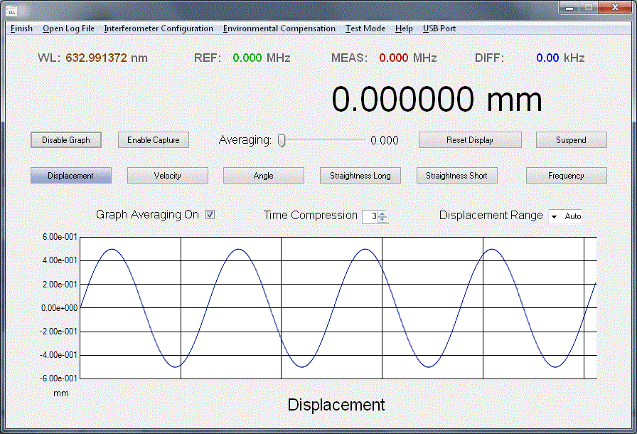

The status LED on D13 is the heartbeat/status indicator for homodyne depending on firmware version. Currently it pulses at between a 1 and 2 Hz rate. Since heterodyne firmware V2.09 MEAS2 uses that pin, it is not available. The availability of that critical LED is the major reason for the firmware upgrade. This is all fully subject to change without any notice. ;-)
Most of these details are really only relevant if there is a desire to modify the firmware, which is not advised since no support will be provided if even 1 character in a comment field is changed without prior approval from µMD2 Central. :) This approval process normally requires a minimum of 3 years, 7 months, 24 days, 11 hours, 35 minutes, and 22.37 seconds, but often takes a lot longer. :-) For wiring using the firmware provided, only the pin assignments matter.
Note that if updating firmware, the GUI may also need to be updated and vice-versa. However, given the stability of the GUI, this is unlikely. And none of the 5,263,782.5 known bugs are significant enough to recall the µMD2 crew back from their extended vacation any time soon.
Here is the communications format between the firmware and GUI. This information is of little relevance if using the GUI, but will be useful if writing your own application software or for data analysis. Each of the values is sent as an ASCII string representing a signed (if needed) decimal number separated by spaces at the sampling rate. The firmware maintains a FIFO buffer so that if the USB data is delayed for some reason, no data should be lost (hopefully):
The same format is used for both homodyne and Heterodyne modes but not all fields will be filled in or relevant for homodyne.

Loading the Arduino IDE
(If you purchased the from me directly, or via eBay, the latest released version of the firmware has been preloaded, so the following step should not be necessary unless a later release is available or you would like to hack the firmware - which is not really recommended.)
The Arduino IDE will work with all versions of the firmware. As of Spring 2021, the latest version that supports the Teensy is 1.8.13. It can be downloaded free from the Arduino Web Site but since it isn't the latest, go to "Software", "Previous Release", and there will be an option for version 1.8.13. Save it to your Downloads directory or any other convenient location. It will probably be an executable, so just run it. There is no actual installation, it will just unpack and copy files to the selected Arduino program directory. (With Windows, this is typically located under "Program Files" or something similar but has no relation to where the actual sketches and contributed libraries may be located.) It can be named anything but "Arduino IDE" or "Arduino V1.8.13" are suggestions.
Go to Download Teensyduino.... and follow the instructions for your OS (assuming Windows). If this is your first time using an Arduino board, it may ask to install the device driver. When it finished, start the Arduino IDE and go to "Tools", "Board", "Teensyduino", and select "Teensy 4.0".
If the OLED display is enabled ("#define OLED 1" is present and not commented out near the start of the firmware), an additional library will be required. Go to "Tools", "Manage Libraries", search for "u8x8" and install the library that it finds.
Plug the board into any available USB port. Windows should recognize it. Go to "Tools", "Port", and select the correct port. With the µMD2 firmware, it will be named something like "COM7 Serial (Teensy 4.0)".
Note: Plugging in a virgin :) Teensy (one probably having only the Blink sketch or another one that doesn't open a COM port) may result in Windows issuing notifications about installing a new device. It's best to wait until that completes before attempting to upload a sketch. Before then, the COM Port in "Tools","Port" may be something strange. This should not be an issue with Teensys having µMD2 firmware pre-loaded.
Windows seems to like to reassign Teensy COM ports for unfathomable reasons, so check COM port setting for uploads and the µMD2 GUI.
Uploading the µMD2 Firmware
The firmware (via the links, above) is provided as a source file which probably has an extension of ".pde" or ".ino" (though the specific name doesn't matter - it's just a text file). However, the name may NOT contain any dashes "-" due to the peculiar restrictions of Java or something. Make a directory with the name of the firmware (without the extension) and put the firmware file there. For example, if the file is named umd2_FW_v123.ino, make a directory called umd2_fw_v123. and put umd2_FW_v123.ino in it. Note that case matters so the name of the directory and name of the firmware file (without the extension) must match case character-by-character exactly. Thus Interferometer.pde is not the same as interferometer.pde
In my experience so far, compiling and uploading firmware has been a bit fiddly for the Teensy 4.0, mostly related to the USB (COM) port assignments and whether or not the software or hardware reset button needs to be depressed. These were never issues with the Atmega boards. More to come on this topice as it becomes available.
  1. Plug the board into a USB port. I've occasionally seen problems using a USB port replicator though these generally are acceptable. But if the board doesn't come up or behavior is more erratic than usual, go to a direct USB port.
  2. Use Ctrl-O to open the firmware file. Select the directory, double click on it, and then open the firmware file itself. The source code should appear in the same window unless a file is already open, in which case a new window will appear.
    (Or for testing, just go to Files->Examples->01.Basics->Blink and upload that. It's easy to make change and then see immediately that thay are taking effect without risking the rest of the Universe.)

When started, the µMD2 GUI (henceforth simply called the "GUI") comes up in Displacement mode with graphing enabled. The only action required by the user is to select the USB COM port. Once selected, the readout and graph will begin displaying the interferometer data.
Even if there is no encoder or interferometer hardware attached to the board, it is possible to confirm that the Teensy is talking to the GUI. Go to "USB Port" and select the same COM as used to upload the firmware. The graph should immediately start scrolling to the left indicating that it is accepting valid data, even if it is all 0s. With homodyne, there will be no error detection, but the fact that it started scrolling means the communications link is working.

Main Window Controls and Readouts
This graphic below shows the typical GUI main window at startup.
µMD2 Main Window in Displacement Mode with Graphing Enabled (Startup Settings)
(REF, MEAS. and DIFF only valid for heterodyne; may not appear for homodyne. Other mostly meaningless parameters may appear above the WL line depending on if the GUI thinks they are enabled. Go to "Test Mode" to turn them off. The GUI will remember the setting.)
The first set are the selection buttons at the top of the window. Note that except for USB Port, these require only a single click to activate:
µMD2 Main Window with Test Mode Function Generator Triangle Displacement Waveform
These may all be accessed via Alt-first letter.
The next set are the buttons, checkboxes, and other widgets on the main window:
The format is slightly modified when Frequency mode is selected. This graphic shows the actual DFT of the triangle waveform in the one above. Note that the DFT coefficients go as 1/N rather than 1/N-squared because it's actually using the velocity data, which is a squarewave.
µMD2 Main Window in Frequency Mode with Graphing Enabled
