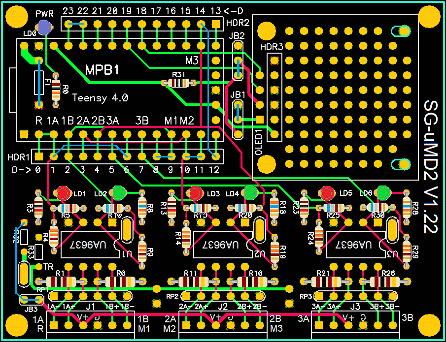

SG-µMD2 PCB Layout Version 1.22
Refer to the SG-µMD2 board layout below. Clicking on these will bring up higher resolution versions in a single separate tab or window depending on your browser settings:
SG-µMD2 V1.22 PCB Layout Diagrams with 100 & 150 Ohm Terminators (Left), Minimal Single Axis V1.00 PCB, and Three Axis Populated V1.00 PCB with OLED Display (Right)
(JB1 and JB2 Jumpered on Layout Diagrams for OLED GND on the Left and VCC on the Right)
(All kits going forward will have red and green LEDs for the A and B signals; the original prototype was all boring green. Please pay attention to the values for the current limiting resistors as they differ by more than an order of magnitude for the red and green LEDs to equalize their perceived brightness. Where the signal LEDs are all green, the R3,R8,R13,R18,R23,R28 will be 10K ohms.)
In addition to the resistor color codes and component references, the layout diagram also shows the signal locations for homodyne and heterodyne on the Teensy.
The populated PCB shows all components required for a three axis system with the OLED display. The terminating resistors (near the screw terminal blocks) have not been installed since their value may depend on the specific configuration, and can often be left out. Five pin headers may be substituted for the screw terminal blocks if desired. The signal LEDs shown are all green in the photo, sorry. :) (These show the V1.00 PCB, updated versions will be forthcoming.)
Summary of SG-µMD2 Jumper Locations
The following show the locations of all of the possible wire jumpers that may be needed.
SG-µMD2 V1.22 PCB Layout Diagrams with Jumpers (Blue); 100 Ohm Terminators (Left) and 150 Ohm Terminators (Right)
Jumper Description (in blue)
