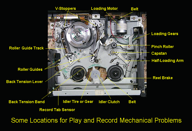

Please refer to the photo: Typical VHS VCR Tape
Transport Components or Sharp VCR Transport with
Major Parts Labeled for parts identification.
The following description applies to 99.9% of the VCRs in existence today.
I have seen one that had a sideways loading mechanism - very weird.
Looking at the unit from above with the front toward you:
Some VCRs use gears in place of rubber (as is the case with the VCR shown in
the photo: Typical VHS VCR Tape Transport
Components. Teeth can break off but these are generally quite reliable.
Some high-end decks may have separate motors for reel rotation.
Also on the same assembly are tilted metal guide posts - again
one for each side. These sometimes fall out with obvious consequences.
Proper functioning and adjustment of the roller guides is the most critical
requirement for proper tracking. (However, do not touch their settings
without being really sure that they are at fault and not until you have
read the sections relating to tape path alignment.) Clean and inspect.
A hard, shiny, dried out pinch roller can lead to tape edge munching and
erratic sound, speed, and tracking. Clean thoroughly. Inspect for cracked,
hard, shiny, or otherwise deteriorated rubber, and lack of free and smooth
rotation. Replace if any of these are present.
Even if you have no obvious record or playback symptoms, if the pinch roller
appears concave or with a distinct worn ridge, replacement is recommended -
erratic behavior will soon be the result. A tape which runs off center due
to a bad pinch roller may result in tape edge damage and over time can also
alter the wear pattern of the audio/control head and various guide posts.
A quick test of the pinch roller is to put the VCR into PLAY and *carefully*
try to stop it from turning between your thumb and forefinger - a good pinch
roller will not be easy to stop.
However, don't replace a pinch roller that is in good condition. The
replacement may be inferior. (Apparently for at least some JVC VCRs, the
original pinch roller is of very high quality and will last the life of
the VCR if cleaned properly.)
For additional information on replacement rubber parts, see the section:
Determining belt, tire, and pinch roller
specifications.
The cause for all of these is very often a bad idler tire or other dirty,
worn, or tired rubber parts. See the section below: "General guide to VCR
cleaning and rubber parts replacement". A VCR that just munched down your
favorite tape is very likely only in need of a little tender loving care.
WARNING: Don't turn a simple repair into a full length double feature. Most
tires and belts come off without extensive disassembly. However, if your VCR
is the exception, DO NOT remove anything to get at the rubber part that may be
part of a critical timing relationship - racks or gears, for example - before
fully understanding the implications of this action. In some cases, if a gear
is rotated even one tooth from where it should be, there can be unforeseen and
catastrophic consequences. See the section: Mechanical
relationships in VCRs for more information before proceeding any further!
Do not attempt to clean the video heads until you follow the proper
procedure given elsewhere in this document, you can break them - very
expensive lesson. In most cases, they do not need attention anyhow.
Q-tips and alcohol (91% medicinal is OK, pure isopropyl is better. Avoid
rubbing alcohol especially if it contains any additives) can be used
everywhere except the video heads. Just dry quickly to avoid leaving
residue behind or damaging the rubber parts further.
Cleaning may get your machine going well enough to get by until any replacement
rubber parts arrive and to confirm your diagnosis.
Things to clean:
Clean the pinch roller (presses against the capstan in Play, Record, and
Search mode CUE and REVIEW) and until no more black stuff comes off. Use
as many Q-tips as necessary until no more black gunk collects on Q-tip.
If the pinch roller is still hard, shiny or cracked, it will probably need
replacement. Many are available for about $6 from the sources listed
at the end of this document. It is sometimes possible to put the pinch
roller in an electric drill, drill press, or lathe, and carefully file off
the hard shiny dried out rubber surface layer, but only use a last
resort - and this fix is probably temporary at best. For a very detailed
and complete step-by-step procedure, search for "VCR crinkling tape, sound
fading, speed flipping" on
Google Groups.
(This is an archived sci.electronics.repair newsgroup posting.)
If the idler tire appears cracked, glazed, or dried out, it will need to be
replaced. About $.50 to $1.00. As a temporary measure, you can usually
turn the tire inside-out and replace it. The protected inner (now outer)
surface will grip well enough to restore functionality until a replacement
tire arrives - and verify the diagnosis as to the cause of your problem.
Also, the idler assembly includes a slip clutch. If this weakens, the
idler may not have enough force to press on the reel table edges. If it
becomes too tight, there may be audio, video, or crickled tape problems
and/or excess wear of the idler tire. When in doubt, the entire idler
assembly is often available as a replacement part. They can often be
disassembled and adjusted if necessary.
Make sure that there are no twists when a square cut belt or replacement
is installed on its pulleys.
On some models, you may need to unscrew circuit board(s) blocking access
to either the top or bottom of the tape transport. Make notes of what
went where - particularly different types of screws and routing of wires.
Any belts that appear loose, flabby or do not return instantly to
their relaxed size when stretched by 25% or so will need to be replaced
and may be the cause of your problems. Belts cost about $.30 to $2.00
and complete replacement belt kits are often available by model for $3. to
$12. Meanwhile, the belts will function better once they are cleaned,
maybe just enough to get by until your replacements arrive.

A light machine oil like electric motor or sewing machine oil should be
used for gear or wheel shafts. A plastic safe grease like silicone grease
or Molylube is suitable for gear teeth, cams, and the roller guide tracks.
Unless the VCR was not properly lubricated at the factory (which is quite
possible), the only likely areas needing lubrication are the roller guide
tracks - clean and grease. Sometimes you will find a dry capstan, motor,
lever, or gear shaft but this is less likely.
In general, do not lubricate anything unless you know there is a need.
Never 'shotgun' a problem by lubricating everything in sight! You might
as well literally use a shotgun on the VCR!

See Some Locations for VCR Mechnical Problems
parts identification in a typical transport.

Once all the obvious problems and cockpit errors have been eliminated,
mechanical problem still likely even though the VCR does not abort
immediately. A worn idler tire, worn or defective idler clutch, bad belt,
or improperly adjusted backtension, are all possibilities.
This is particularly likely if the problem is more likely to occur or only
happens near the end of tapes as the required takeup reel torque is greater
and any of the above mechanical problems will be exacerbated.

If the roller guides get hung up on the tracks while being retracted,
even for an instant, the tape may become tight around the roller guides,
pull on the non-driven reel, and stop the operation before the tape is fully
wound back into the cassette. Check for obstructions and for adequate
lubrication of the roller guide tracks.
If it is a late model Sony, the 'half loading arm' could need lubrication.
See the section: Late model Sony VCR munches tape on
eject.

If the Mode Switch contacts are dirty or worn, or if it has somehow loosened
on its mountings and shifted slightly, one or more of these positions will
report back incorrectly or erratically signaling an error condition. For
example, a transition from state 1 to state 4 directly would totally confuse
the poor controller. A Mode Switch that shifted out of place (or where
other timing relationships in the VCR are messed up) might result in certain
operations stopping at the wrong position as well. For example, if the
Mode Switch shifts one way, the pinch roller may never quite press against
the capstan or the roller guides may not snuggle up to the V-Stoppers as
they should in play mode. If it shifts the other way, operations may fail to
complete and run against the mechanical stops - stripped or broken gears may
even the result.

Assuming you are having the same problem on multiple tapes and that
using a known good (new) tape results in damage:
This is an indication that your tape path alignment is off or your rubber
parts (probably the pinch roller) need replacing. The tape is wandering
up and down as a result of unequal pull from the capstan due to a glazed/worn
pinch roller. There could also be other aspects of tape path alignment like
roller guide tilt (which is probably not adjustable), A/C head tilt, dirt,
roller guide height (don't mess with it), etc. See the chapter: "Tape Path
Alignment and Backtension Adjustment. It could also be worn feet on the
roller guide assemblies causing the guides to not be perfectly vertical.
Replacement of these parts may be the only cure. Other much less likely
possibilities: excessive or varying backtension, tight idler clutch,
electronic problems.

First, clean the tape path properly, especially the capstan and pinch roller,
tape guides, A/C head. Inspect the pinch roller for glazing, cracking,
etc. and replace if necessary. See the sections: "General guide to VCR
cleaning and rubber parts replacement" and if necessary, the chapter: "Tape
Path Alignment and Backtension Adjustment".

Possible causes for loss of lock:
Inspect the tape path really really carefully to determine if there is some
obstruction preventing tape-control head contact or other mechanical problems.
Try cleaning the tape path and checking the rubber parts. Check power supply
voltages if you can determine what they should be (see the section:
VCR power supplies. If these procedures to not
reveal anything amiss, you will need a service manual to pursue electronic
faults.
When the bottom of the tape gets creased, the control head may no longer
align with the control track and you loose servo lock on the sync signal.
Your audio may be fluctuating in intensity as well since the audio track
is wandering also and the tape may be intermittently going in and out of
correct tracking and/or changing speeds. Since the tape can no longer
seat stably on the lower drum guide ridge, there could be other problems
such as noise bars along the top or bottom of the picture, jumping, etc.
It could be the guide posts or other tape path components, but before you turn
every screw you can find and make the problems hopelessly worse, replace all
of the rubber parts - belts, idler tire, pinch roller. And while you are at
it, give the machine a good cleaning.
A dirty, worn, hard, dried out pinch roller in particular can result in
the tape wandering up and down causing tracking problems and creasing the
tape in the process. This is probably the most common cause of tape damage
assuming the VCR itself has not been abused (i.e., jammed cassette removed
using a pair of Vice-Grips(tm).)
With a thorough cleaning of everything before buying the new rubber (which BTW
should not be more than a total $10 to $15 from a place like MCM Electronics),
you may at least see a temporary improvement in performance - and confirmation
of the diagnosis.
You really need to determine exactly where the tape is being creased.
Once you do this, you may be able to determine the cause and visually
verify whether the problem is affected by any of your adjustments or probing.
Some other possibilities include:
(From: Raymond Carlsen (rrcc@u.washington.edu).)
There is a simple way to determine if the tape is skewing or has a tendency
to do so... just reduce the back-tension by holding the arm so the tape is
not as tight around the drum. If there is any tendency of a worn pinch
roller to skew the tape, that will show it up quickly. I make my test tapes
on an old linear stereo VCR and record two different tones on the two audio
channels. When I play that tape back on a VCR with linear mono audio (all
of them now), the two tones will play with equal volume if the audio head
height is correct AND the tape is not skewing up or down. I can determine
what's happening by ear, without even looking at the tape, and before the
tape is damaged. Note: there are some machines that tend to skew even if
the pinch roller is good. Those require more aggressive alignment
procedures than the service manuals usually supply. Almost everything on
the take-up side of the tape path can be "adjusted" for the really stubborn
ones (even shims to tilt the capstan rotor), but in a few cases, there is
just no way to get it perfect. With machines getting cheaper and cheaper, I
don't spend any time on dogs unless it's a high end deck and the customer
knows what it's worth.
(From: Vern (vgdeuel@ticnet.com).)
Tape damage along the top edge usually indicates too much back tension
which, among other things, can be caused by the P2 roller not turning
freely. Using a Tentelometer, check the back tension at the full erase
head; it should be about 30 grams. Then check the tape tension just
before the A/C head. If it's up around 80-100 grams or so, change the
P2 roller and even the P3.
(From: Jerry G. (jerryg50@hotmail.com).)
Take a careful look at the capstan shaft and see if the capstan (where the
pinch roller touches) is very clean. If it has black or brown markings
(coating) on it, you must clean it off very well. Use alcohol and a Q-Tip.
Take care to not scratch the shaft.
If the rubber pinch roller is shiny, or looks dried out and or cracked, change
it. This area other than the reels is a prime cause of speed problems. The
tape when under normal torque can be slipping between the pinch roller and the
capstan shaft.

Play and Record Mechanical Problems
Quick list of common mechanical problems
The following aren't in any serious order but those toward the top of the
list are the most likely to occur:
VCR refuses to record
If efforts to record (directly or via the timer) are totally ignored or
cause the cassette to be ejected, then the record protect tab on
the cassette may be broken off or the record protect sense switch in the
VCR may be dirty or defective. This switch sits just under the cassette
slot (on front loaders). Locate it by referencing the tab position on the
loaded cassette. It can easily be tested with an ohmmeter - if you can get

VCR eats tapes
The most common cause of a VCR eating tapes is a dirty/worn idler tire
preventing the takeup reel from turning. See section:
General guide to VCR cleaning and rubber parts
replacement. The idler tire transfers motor power to the appropriate
reel hub. If dirty, worn, dried out, glazed, cracked, or otherwise
deteriorated, it will slip and cause the takeup reel (in
play mode) to stop turning at some point. Hopefully, the microcomputer
senses this and tries to wind the tape back into the cassette. But,
you guessed it, this requires the idler tire so you end up with a mess
of tape inside the machine. When you go to eject, you may get the cassette
with a tape loop hanging out. If you are careful, you may be able to
extract the tape without crinkling it too badly but don't just pull - it
will break or be hopeless damaged. You will need to remove the top cover
and carefully lift the tape loop out of the machine and wind it back into
the cassette. If there is any significant crinkling or a partial break
in the tape, discard the cassette. If it is priceless and irreplaceable,
see the section: Recovering damaged or broken tapes.
DO NOT try to use it or just return it to the video store without informing
them of what happened - it is unfair the next renter as a badly crinkled or
partially broken tape can destroy expensive video heads.

Video head drum stops or slows during play or record
Check whether the backtension on the tape is applying so much
pressure to the drum that it is slowing it down. Backtension should be
just enough to keep the tape in good contact with the drum. If it is too
tight, then you backtension felt may be worn or adjusted too high. There
is a lever just as the tape exits the cassette - push this to the right to
reduce tension. Someone may have attempted to repair a broken backtension
band and reduced its length - I got a VCR for repair once where this was
done.

This may mean that the record protect tab on the cassette is broken off or the record tab sense switch is dirty or bad.
This could be the result of a dirty or defective record sense switch or misalignment preventing proper engagement with it. Some VCRs check for the record tab constantly while others just check when the REC button is pressed or the timer initiates record.
It could also be a defective reel or tape end sensor halting record though these would likely affect playback as well.

You should also check the backtension adjustment - if too loose, head to tape contact will be compromised. Try increasing it momentarily by pushing the backtension lever slightly to the left while the tape is playing. The usual way to adjust backtension without a backtension meter and service manual is to look at the image just before vertical retrace at the bottom of the screen - this is normally not visible unless you can reduce vertical size or play with vertical hold to get the vertical blanking bar to appear. Of course, most modern TVs don't have any such controls! This is the head switching point and when the backtension is properly set the image above and the bit of image below this break will be approximately aligned.
If increasing backtension helps, either the heads are marginal or the back- tension was low. However, low backtension will usually show up as a waving or flagging effect at the top of the picture.

This is probably a mechanical problem, most likely an adjustment or fault related to tape path alignment. However, it could also be due to electronic problems with the video or servo circuitry. The vertical sync could be corrupted or the head switching point not set correctly.
