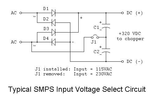

    Line rectification is usually via a voltage doubler or diode bridge. One common circuit uses a bridge rectifier as a doubler or normal bridge by changing one jumper. The voltage across the switching transistor is usually around 160-320 V. Some universal supplies are designed to accept a wide range of input voltages - 90-240 VAC (possibly up to 400 Hz or more) or DC - and will automatically work just about anywhere in the world as long as a suitable plug adapter can be found.

    Switching between 115 VAC and 230 VAC input
    Assuming it is not a wide compliance 'universal type', a common way to do this is with a jumper (or switch) in the line input circuitry below (also shown in Typical SMPS Input Voltage Select Circuit):
                      D1
        AC o-----+----|>|-------+---------+-----o DC (+)
                ~|    D2        |+        |
                 +----|<|----+  |       +_|_
                      D3     |  |     C1 ---
                 |    D4     |    +--o-o--+     +320 VDC to chopper
        AC o---+-+----|<|----+ -  |  J1   |
               |~            |    |     +_|_
               +-------------|----+   C2 ---
                             +------------+-----o DC (-)
