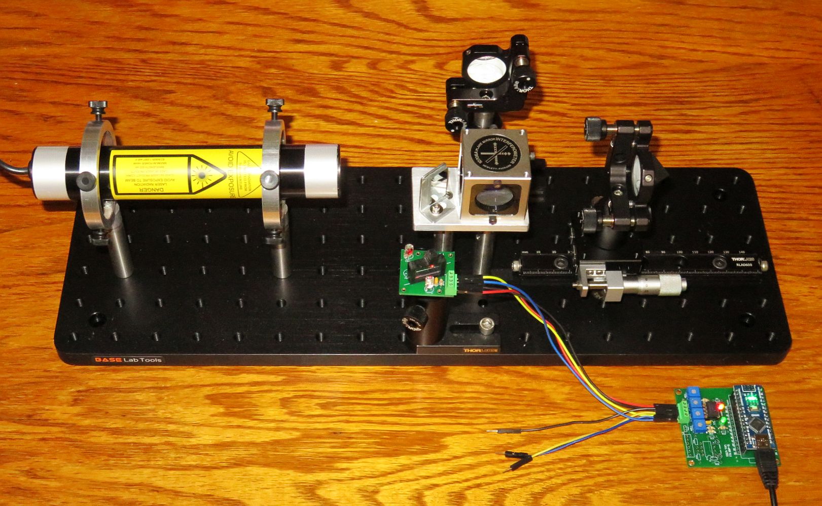

    The photo below shows the Basic version configured for the LI. There are minor variations in the actual kits depending on version and whether they are the "Basic", "Deluxe", or "Deluxe+" versions, though this layout will work for all of them. Differences will be noted below. Where the total path length and PLD is small, no beam expander is needed for the laser as in the Basic version. This may result in a larger signal since the entire beam hits the detector. But the smaller beam makes it more sensitive to alignment.
    Typical Linear Interferometer Setup with Quadrature Decoder and µMD0

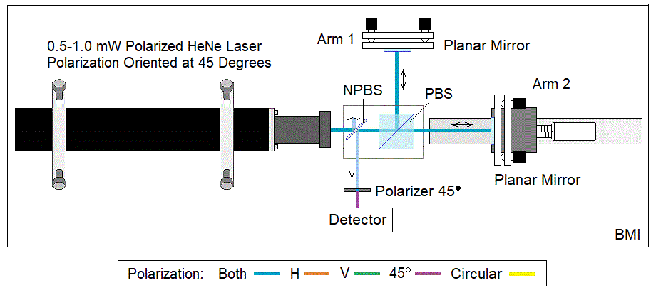

    Classic Michelson Interferometer
    All of the measurements performed by these systems are based on variations of the Michelson interferometer, invented over 100 years ago by Albert Michelson. This is one of the simplest interferometer configurations but also one of the most widely used. Even though a two frequency laser is used here instead of the linearly polarized laser in the other kits, most of the basic priciples are the same. The specific differences will be noted.
    The textbook version is shown below:
    In short, a light beam is split into two parts which are bounced off of a pair of reflectors and recombined at a detector. Any change in the relative path lengths of the two "arms" formed by the reflectors results in a phase shift between the waves in the two beams resulting in constructive or destructive interference, which can be measured and converted to displacement (change in position) down to nanometer precision. All other types of measurements made by these systems are based on opto-mechanical configurations designed such that changes in the measured variable are detectable by what is in essense a Michelson interferometer.
    Where the Path Length Difference (PLD) between the two arms is small, the requirements for the laser are not very stringent. In fact, for very small PLDs, an LED or even a totally incoherent source like an incandescent lamp may be substituted for the laser. However, to be useful for the PLDs necessary for most applications (millimeters to 10s of meters or more), the light source must be a laser. And not just any laser, but one that has a narrow "linewidth". While the popular concept of a laser is of a light source that is monochromatic (single color or wavelength), in reality most lasers do not even come close. It takes careful design and implementation to achieve that. For these metrology applications using the so-called "homodyne" interferometer, the laser should ideally produce an output that is a single optical frequency with a linewidth approaching zero. In practice, it isn't that narrow but can still result in a linewidth of much less than 1 MHz, resulting in a usable PLD of 100s of meters. This is usually a low power stabilized HeNe laser. However, for PLDs of a few inches, a common (much less expensive) unstabilized HeNe laser will be adequate. Within this range, all the modes will be sufficiently correlated and the fringe contrast/signal amplitude will be acceptable.

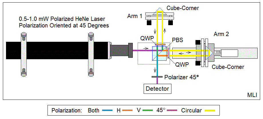

    The first enhancement of the Michelson interferometer is to add a means of separating the outgoing and return beams so that there is vitrually no optical power returned to the laser. The simplest way to do this is to replace the mirrors with Retro-Reflectors (RRs), typically cube-corner (trihedral) prisms, which have the property of returning the beam directly back parallel with the outgoing beam, but which may have an offset. In this way, virtually none of the reflected light ends up back at the laser. The use of the RRs also greatly reduces the sensitivity to alignment as any change in their angle is converted to a small change in the distance between the outgoing and return beams, but they remain parallel.
    All of the practical interferometer configurations include at least one cube corner retro-reflector.

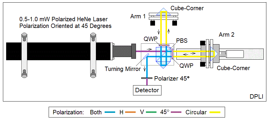

    Polarizing Beam-Splitter
    The second enhancement is to use a Polarizing Beam-Splitter (PBS) in place of the 45 degree partially reflecting mirror. While a plate beam-splitter could be used, the PBS cube (or simply PBSC) is much more common. (The acronyms PBS and PBSC will be used interchangeably throughout this document.)
    The beams reflected to the two arms of the interferometer then have orthogonal polarization which effectively makes them independent until they are combined at the detectors.
    The result is then one of the most widely used configurations - the Linear Interferometer (LI), which was the first one used by HP in their original 5500A laser interferometer displacement measuring system. (As an aside, I do NOT know where that name "Linear Interferometer" comes from except perhaps that the inital configuration was in-line with the laser and thus "linear".) In practice, Arm 1 is used as the reference and is made as short as possible with the Cube Corner (CC) attached directly to the PBS cube. Both arms can move where differential measurements are required.
    With the use of the PBS, the maximum amount of the laser optical power is available - virtually nothing exits out the unused side of the beam-splitter as it would in the original Michelson setup, above. However, at least half the power is lost in the detection scheme that is typically used so it would end up being similar. In principle, this wasted power can be diverted to a second detector. Their difference will then have twice the amplitude and the signal-to-noise ratio will nearly double (but with opposite phase). This is rarely, if ever, done though. But for the more complex multi-pass interferometer configurations described later as well as for use with two frequency lasers, the use of the PBS is essential to avoid incurring very large losses, or for the schemes to work at all.
    As noted for the heterodyne interferometer - probably the most popular type used for high performance metrology applications and the topic of this kit - the laser actually produces a pair of optical frequencies that are othogonally polarized. They are typically separated by 100s of kHz to 10s of MHz called the "split" or "REF" or reference frequency. Most commonly the split frequency is in the small number of MHz range. For the HP/Agilent 5517 laser in this kit, it has been adjusted to be between 1.5 and 2.0 MHz. F1 is the lower optical frequency and is the horizontally polarized component; F2 is the higher optical frequency and is the vertically polarized component. As long as the difference frequency between F1 and F2 is reasonably stable, the specific value only impacts the maximum slew rate possible for the moving mirror or cube corner. It has no effect on the resolution. Think of the split frequency as a carrier that can be conveniently manipulated by AC electronic circuits. So just as with radio, the carrier does not carry information but makes it convenient to process that information. There are also several other advantages including reduced affects of signal amplitude and less sensitivity to interferometer alignment. Everything with respect to the interferometer optics and configurations is similar except that instead of the phase change between the two (essentially base-band) polarized components derived from the laser, it is the phase change between the REF signal (F2-F1) and a "MEAS" signal (F2-F1+ΔF1) with ΔF1 being a result of the Doppler shift from the moving reflector.
    The maximum PLD is virtually unlimited for the two frequency laser with usable PLDs of 10s or even 100s of meters or more - impacted more by issues of beam divergence and collimation than the stability of the laser itself. However, since it is the PLD that is being measured, you can't purge it from your brain, sorry. ;-)

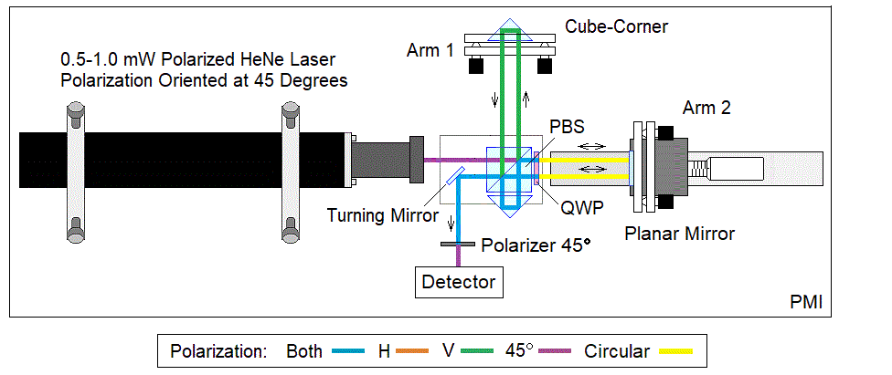

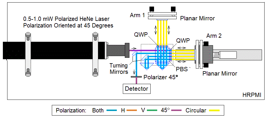

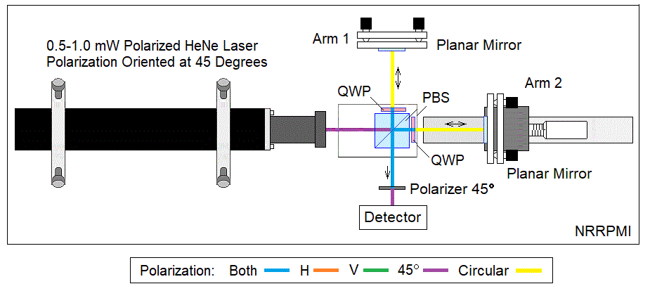

    Common Interferometer Configurations for Displacement Measurements
    Here are several interferometers that may be used for measuring displacement (change in position). The first 4 are the most common.
    When used in a displacement measuring system with a 633 nm HeNe laser, 1X represents a full cycle resolution of 1/2 wavelength or ~316 nm; 2X of ~158 nm, and 4X of ~79 nm. For a homodyne system with a Quad-A-B deterctor, there are 4 counts per cycle so that gets multiplied by up to 4. For a heterodyne system using µMD2, there are 2 counts per cycle so that gets multiplied by up to 2. The very commonly used PMI or HSPMI will then have a heterodyne resolution of ~79 nm and interpolation techniques can extend it down to under 1 nm. However, if the signals are noisy or asymmetric, the benefits may not be achievable.

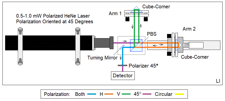

    Although HP called the combination of the PBSC and reference CC attached to it, the "Linear Interferometer", the term "LI" here will refer to the entire setup. And to enable the PLD to be set to zero, the CC normally attached directly to the PBSC will be mounted a few inches away.

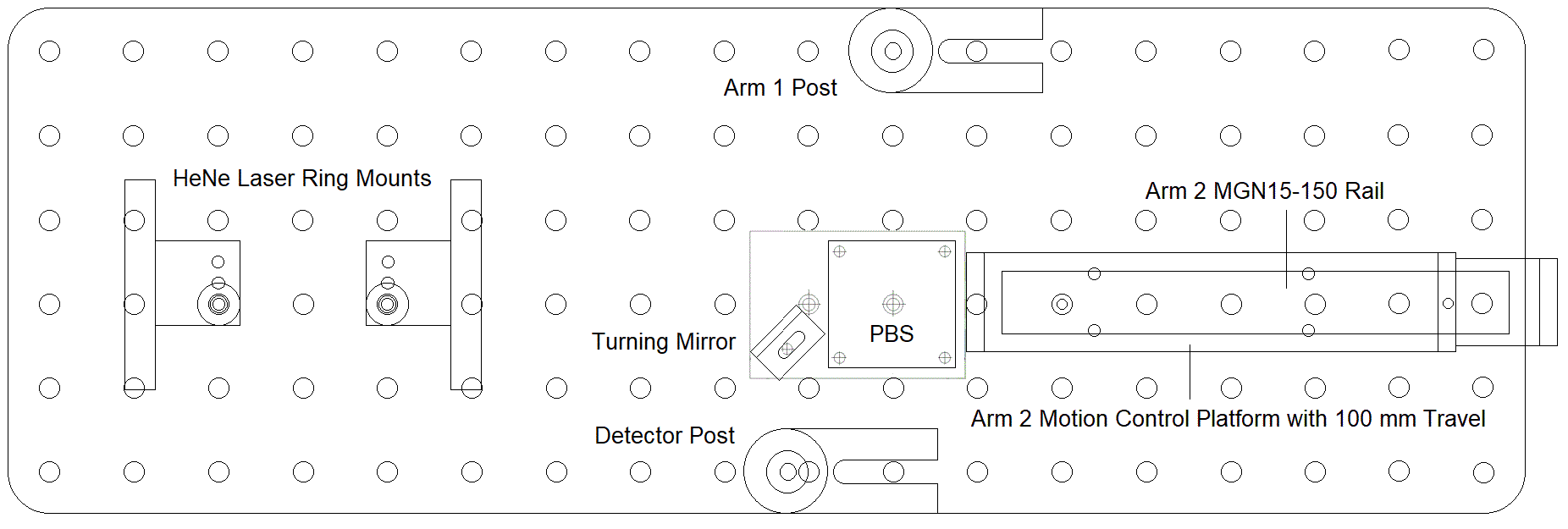

    The diagram below shows the general arrangement of the laser, beam splitter, cube corners, and detector.
    Linear Interferometer Diagram and Suggested Breadboard Layout
    The other configurations will have a few additional or substitute parts and small variations in the horizonatal position of the laser and placement of the detector but are otherwise similar. Therefore the LI setup will be described in more detail.

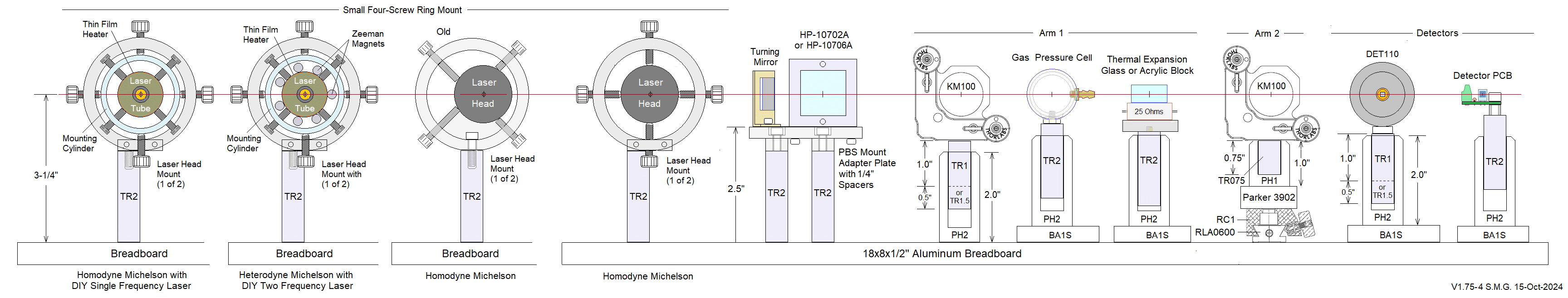

    Setting the Heights
    The following diagram shows the relationships of the various mounts for setting the heights during assembly. This diagram applies to all V2.1 setups. 4-1/4" places the laser in the center of the PBS vertically:
    Required Optical Components and their Suggested Heights - V2.1
    And this diagram applies to all V1.75 setups. 3-1/4" places the laser in the center of the PBS vertically:
    Required Optical Components and their Suggested Heights - V1.75
    Note that the primary differences between these are in the size of the posts and postholders as V1.75 does not need to accomodate the additional height of the optional motion control components. Similarly, everything in V2.1 can be reduced in height by around 1" if there is no desire to accomodate them. V1.75 also assumes the use of the Parker 3902 stage which has a thickness of 1/2". To use the typical generic stage requires that everything be raised by a bit over 1/4". This isn't rocket science, you'll figure it out. ;-)
    The heights of any Retro-Reflectors (RRs) in the setup will be what most affect the beam height. This is true of the Linear Interferometer (LI). Where there is an RR attached to the PBS cube like the Plane Mirror Interferometer (PMI), the alignment of the laser will need to be used. However, there is a wide tolerance and enough degrees of freedom so in the end, it should not really be much of a problem to set it up.

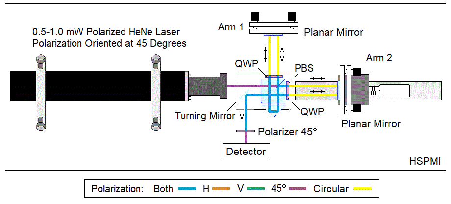

    Here is an annotated photo of the Deluxe version configured for the HSPMI:
    Deluxe Version Configured for the High Stability Plane Mirror Interferometer with µMD0
    And if you have a sharp eye, you will notice that this is actually not exactly a V2.1 or V1.75 setup but should be close enough for government work. Live with it. ;-)
    The Deluxe+ version would be similar except for the larger breadboard and longer rail; The Basic version does not include the beam expander, mounted CC, QWPs, or planar mirrors.

  • Arm 1: These steps assemble the components of Arm 1. It may be desirable to block the return beam from Arm 2 until the initial Arm 1 adjustments have been done.
    1. (V2.1 only) Attach a 2" post holder to a BA1S holddown with a 1/4-20 3/8" cap-head screw. Orient it so the thumbscrew (knob) is accessible. Attach this assembly to the baseplate using a 1/4-20 1/2" cap-head-screw.
      (V1.5 only) Attach a 2" post holder to the breadboard using a 1/4-20 setscrew.
    2. KM100 or similar mirror mount: Secure to a 2" post with an 8-32 cap-head screw. Slip the post into the Arm 1 post holder and hand tighten its thumbscrew. Adjust the two alignment knobs so that the mounting plate is parallel to the backplate in both directions. If the adjustments are hard to turn, check that any locking screws are not tightened. Else, total removal, cleaning, and lubricating with a tiny amount of light grease or machine oil will be required.
    3. Cube Corner (CC) trihedral prism: Install a CC in the mount with its apex facing out and oriented so that a flat is at the top or bottom. This is to orient the prism so that the beams do not hit an edge. It should be secured with either a soft-tipped set-screw or Nylon wide-head screw. DO NOT overtighten - it should be snug enough not to fall out (these are fragile!) but not so tight as to smash the CC! Note that the CCs mount backwards from what might be expected so that their edge can be secured securely. :) They thus face through the mount.
    4. Start with the knobs of the adjustable mount set so its fixed and moving plates are approximately parallel and orthogonal to the beam axis as in the diagrams. The BA1S can be moved to adjust the coarse horizontal position of the return beam. The post holder's thumb-screw may be loosened to move the adjustable mount up or down to adjust coarse vertical position of the return beam. The return beam should hit the PBSC at the same height as the incident beam, and offset 1/4" to the left of center. The spacing between the centers of the incident and returns beams should then be 1/2".
    5. Using your piece of paper with the Arm 2 return beam unblocked, there should now be two spots reflected from the turning mirror corresponding to the returns from Arms 1 and 2. (Unless, that is, you're very lucky and they are already superimposed perfectly!)
    6. Adjust the position and orientation of the CCs to superimpose the return beams from Arm 1 and Arm 2. This can be fine tuned with the adjustable mount knobs initially by eye. Then later once the oscilloscope is set up, it can be further optimized by maximizing signal amplitude from the detector.
  • As a quick test, place a linear polarizer (LP or LP/CP with the non-adhesive side facing the beam) with the polarization axis at 45 degrees in the combined return beam. If the alignment is close, very slight rotation of the linear stage micrometer should result in the intensity varying dramatically. Further fine tuning of the alignment may be required to maximize the variation and uniformaty of the fring pattern. The optimal alignment will be where it goes almost totally dark to light. Of course, much more more can be done using these simple observations including effects of alignment, expansion using a lens, display using a Webcam, etc.
  • Set up the oscilloscope: (If using a USB scope, this assumes that the required software and device drivers have already been installed on your PC or MAC.) For input, use one of the scope probes on the 1X setting (there is a slide switch on its body).
  • Single Channel Detector: These steps assemble the components of the fringe detector. Parts for the home-built (custom) detector are normally provided in the kits but a DET110 may be available as an option.
  • Adjust the position of the detector so that the combined return beams are centered on the active area of the sensor.
  • If alignment is close, the amplitude of the signal on the scope should vary dramatically as the micrometer is rotated by the smallest amount - (or from just touching the breadboard or anything on it)! The wavelengths of light are TINY! Each full cycle is 1/2 wavelength or around 316.5 nm. The micrometer moves the stage by 0.5 mm per full rotation, or around 1,389 nm/degree.
  • The amplitude can be maximized using the knobs on the Arm 1 and Arm 2 adjustable mounts. The signal amplitude may vary slightly (up to ~20 percent) in a periodic cycle over a time scale of seconds to minutes in addition to it probably increasing slightly as the laser warms up. The time scale will depend on how long the HeNe has been on. Why? There can be several causes.
    And for those new to interferometers, to reiterate, the optimal alignment will also be where the signal instability is maximized. ;-) Almost ANYTHING will affect it from touching the apparatus or table on which it is on, to just walking across the floor. The wavelength of light is really really small. ;-) To put this in some perspective, a full cycle of the signal with the Linear Interfemeter is a change in PLD of 316.4 µm (1/2 wavelength of 632.8 nm or 1/3,160th of a mm). That's about 1/158th the diameter of an average human hair (~50 µm) or 1/22th the diameter of a human red blood cell (7 µm). Street traffic will be detectable, as will drafts from the A/C, changes in temperature, and siesmic events. Some of these effects can be further explored using parts in these kits.
  • Now you're set to explore all sorts of exciting aspects of interferometry. ;-)

    The basic Plane Mirror Interferometer (PMI) as its name implies uses a plane mirror instead of a cube corner for the remote reflector. It has a double pass architecture which halves the distance for a full fringe cycle at the detector for a movement of the reflector in Arm 2 (called the "measurement arm"). However, it is not desirable to use a PMI here because it is double-pass only for Arm 2 but single pass for Arm 1. Thus while the PLD can be set to zero, the spacings or lengths of the two arms (as well as the change in displacement) are not the same, which at the very least is confusing. (More on this in the section on the PMI.)
    Normally, the Arm 1 mirror would be mounted along with the QWP on the PBSC as the reference since absolute PLD doesn't matter with the single frequency or two frequency lasers used in metrology applications. But as with the LI, we need the PLD to be close to zero or ohter specific value for experiments using a multi-longitudinal mode laser. (The "other specific value" would normally be a small integer multiple of the laser's internal cavity length. Why?)
    High Stability Plane Mirror Interferometer Setup
    Assuming the LI was already built, not many changes/additions are required:
    1. Install the HP retro-reflector (10703A) on the PBSC face closest to the detector. The orientation should be such that the beam doesn't hit an apex. This usually means the serial number (if present) runs up and down.
    2. Install QWPs (HP 10722A or unmarked) on the faces toward the Arms. Their orientation does not matter as long as the screw slots are used.
    3. Replace the unmounted cube corner retro-reflectors with circular 1" planar mirrors. The mirror mounts can be rotated 180 degrees to make them easier to adjust.

    Motion Control Platform
    This is currently an option but may be included standard in the future.
    It would replace the Thorlabs or ball bearing rail and carrier with a stepper motor-driven platform and an Arduino-compatible board to drive it. Among other things, this will enable the characterization of non-linearity, backlash and displacement scaling error. These are critical parameters in CNC machine calibration. In addition, controlling Arm 2 motion electronically should introduce far lower vibration than actually touching the micrometer knob.
    However, these are not super precision rigs. Their selection was based on the small size to fit the interferometer setup - and cost. So they may have significant free-play, backlash, and other errors. But that's exactly the sort of thing that experiments can aim to characterize. The main issue is that they use a lead screw (not a ball screw) into a threaded brass block. And aside from a setup like that being inherently imprecise, the machining is sometimes, well, not so great as well. :(
    (Doing something similar using a servo motor rather than stepper motor is possible and theoretically superior, but likely much more expensive and complex.)
    The basic components are:
    The setup below was used for the initial implementation and is similar to what will be included in the kit, (currently an option). This rail with a travel of 200 mm would fit easily fully on the "Extended" version of the interferometer. In fact, rails with a 250 mm travel would also fit and they may be available in the future. For the shorter setups, a rail with a travel of 100 mm would be used. Putting the motor on the left enables a micrometer stage with the knob on the end to be used without hitting the motor housing, which is at a greater height than the platform. However, to minimize the PLD for the homodyne setups, the motor should be on the right using a micrometer stage with side-mounted knob. For Heterodyne, the absolute PLD doesn't make any difference so there's no real need for the reflector to be able to move as close as possible to the interferometer.
    Holes will need to be drilled or drilled and tapped on the breadboard to mate with the Metric hole spacing of the rail. BA-type hold-down clamps or even industrial strength double sticky tape would also work, if a bit clunky.
    To mount the micrometer stage on the stepper platform, an adapter plate is needed unless one is willing to simply use glue. It's the same one used with the ball bearing rail, so that can be transferred if available. 5-Minute Epoxy would be satisfactory, and could be removed if necessary. (If installed on a V2.0 setup, the optical centerline increases by 1/2 inch so some parts change, mostly Thorlabs posts and spacers.)
    The Atmega 328P Nano runs the firmware in the link, below. This is for testing only or if all that's desired is a manually-controlled motorized stage. ;-) It has no error checking so twiddling the knob faster than the motor can move so it just whines is very easy, and there are no limit switches so the flaform can smack into the end plates. But as can be seen, there are many extraneous useless LEDs. ;-) The DM320T controller is set for 400 pulses/mm and the lowest motor current of 0.3 A. Higher current will increase the maximum speed to some extent, but don't go above a sustained current of more than 0.6 A. CAUTION: I you decide to play with a rig like this, make sure the DC to the DM320T is clean and comes on quickly. Else the DM320T may get into a funky state which among other things can send lots of current through the motor, as well as not respond to drive pulses. At least, that's what appeared to have happened on more than one occasion when ramping up the input voltage manually. A 12 VDC wall adapter solved that. I don't know if the red Fault LED on the DM320T being off is sufficient to guarantee correct operation.
    Test of 200 mm Travel MCP (left), on Extended Heterodyne Setup (Left-Center), Test of 100 mm Travel MCP (Right-Center), and on Basic Homodyne Setup (Right)
    The photos show samples of the 100 and 200 mm travel MCPs along with typical installation on the optical breadboards. The electronic Solderless BreadBoard (SBB) with the Nano driving the 200 mm versions is my original rig for testing the quad decoder sketch; the one with the 100 mm versions is all that's needed and is what will be included in the kit. Feel free to add decorative LEDs. ;-) And yes, if you look closely, the tip of the micrometer is not touching the bracket in one of the pics. That's because the stage can be locked in place and wasn't unlocked for the photo. ;-)
    The hardware is the easy part and a mock-up has been constructed as shown above. For V2.1, the motion control platform can be substituted for either the Thorlabs or ball bearing rail with virtually no changes to anything else. But for V2.0, it will not quite be a drop-in as the heights have increased by 1/2 inch. So some opto-mechanical components will need to change - mostly Thorlabs posts and spacers, but there would be negligible additional cost involved.
    The software to make this educational and useful is the challenge.
    An Arduino sketch for an initial version that simply enables the platform to move based on Quad-A-B encoder signals - NOT from the interferometer! - can be found at:
    The SG-µMD0, SG-µMD1, or SG-µMD2 PCBs can have firmware added for motor control in addition to their other duties. Or another microcomputer could be used.
    Suggestions for actual challenging applications (and coding volunteers) are welcome. :( :-)
    Mechanical installation
    1. Motion control platform: If purchased at the same time as the interferometer, holes will already have been drilled in the breadboard for the stepper motor rig, with the motor on the right. These locations will enable the maximum usable travel.
      Secure the platform on the breadboard using four 6-32 1/2" cap-head screws if the holes are tapped, or 6-32 3/4" screws and nuts if not. Take care to assure that it is aligned.
    2. Adapter plate and stage: These are the same as used for the ball bearing rail. If transferring them, first remove the stage and then the flat head M3 screws securing it to the ball bearing rail carriage Reinstall in the opposite order on the MCP using the appropriate set of holes. To maximize range, have the plate extend on the side away from where the knob is located.

    Original Michelson Interferometer (BMI)
    This is identical to the original except that it uses the polarized laser and PBS cube as the beam-splitter. But note that the PBS passes and reflects the X (parallel to the baseplate) and Y (orthogonal to the baseplate) polarized components and they retrace their steps on the return journey. Thus a Non-Polarizing Beam-Splitter (NPBS) must be inserted to pick off both of them before passing through the linear polarizer at 45 degrees to combine them for the detector. The NPBS can be the variable Attenuator Plate (AP) that is part of the quadrature decoder, but mounting it and determination of the optimal attenuation is left as an exercise for the student.
    No Retro-Reflector Plane Mirror Interferometer (NRRPMI)
    The PMI is probably the most common of the interferometers that use a planar mirror.
    Single Beam Interferometer (SBI)
    Modified Linear Interferometer (MLI)
    The MLI adds a pair of QWPs to direct the beam to the detector out the side of the PBSC and is achitecturally similar to the SBI but with offset beam paths that have two additional advantages: (1) retro-reflections back to the laser are reduced further and (2) the beams don't hit the apex or edges of the cube corner trihedral prisms. However, only under very specific cercumstances would the additional cost of the QWPs likely be justified.
    Double Pass Linear Interferometer (DPLI)
    The remote reflector is a cube corner which is better for long distances yet it has double the resolution of the normal LI, the same as the PMI.
    High Resolution Plane Mirror Interferometer (HRPMI)
    This doubles the resolution over the PMI or HSPMI. The HRPMI is also high stability because the two beam paths have the same length through the optics, and a PLD of 0 if the distance in Arm 1 and Arm 2 are the matched. This will be much more complex to align and will require a few additional parts and a lot of determination. ;-)
    The HRPMI is essentially an HSPMI in which instead of the return beam going to the detector, it is reflected back into the interferometer, but offset in position by an additional cube corner and traverses all of the optics a second time. So instead of 2 passes, it becomes 4 passes, and the losses will more than double reducing the signal level significantly. In principle, this could be extended to 6 or more passes using a similar approach, but as you will undoubtedly see if you're crazy enough to attempt to implement the HRPMI, it's already tough enough to align.
    The HRPMI setup requires some additional optics (another turning mirror and adjustable mount for an unmounted cube corner). The laser may also need to be positioned further to the left to make space. The only way to really test it without a measurement display would be with one of the methods of fine tuning path length - loudspeaker, PZT, air pressure, tmperature, etc. The micrometer stage will simply not have fine enough control to reliably detect a difference between X1 or X4. Thus the setup is shown with the loudspeaker.

    Micro Measurement Display 0 (µMD0)
    µMD0 is a very inexpensive system for precision readout of displacement (change in position), angle, straightness, and more in metrology applications using (homodyne) interferometry with single frequency HeNe lasers. Where the path length difference is limited to a few cm, it may also be used with (unstabilized) multi-longitudinal mode HeNe lasers. µMD0 may be used with devices like linear and rotary encoders which produce Quad-Sin-Cos or Quad-A/B signals.
    For the purposes of these interferometer kits, µMD0 consists of three parts:
    1. Interface from Quad-Sin-Cos analog signals to Quad-A-B digital signals, consisting of very simple circuitry to provide gain and thresholding.
    2. Atmega 328 Nano 3.0 (or similar Arduino-compatible) microcomputer board, which runs the µMD0 firmware.
    3. Micro Measurement Display (µMD) Graphical User Interface which typically runs on a Windows PC or laptop.
    The general organization of a typical system is shown below (though the one implemented in this kit differs in some subtle details):
    Typical Homodyne Interferometer Measurement Setup using µMD0
    To convert the analog sin and cos signals to something for a low cost microprocessor with adequate performance requires a simple interface which provides gain and threshold adjustments. (While it has analog inputs, their conversion rate is way too slow.)
    Referring to the schematic, the trim-pots on the left are the load resistors for the quadrature detector. The 100K value should be satisfactory to resultin a signal of a few volts p-p using a laser with an output power of around 1 mW and no beam expander. (The expanded beam may slightly exceeds the dimensions of the photodiodes so the sensitivity will be reduced.) For a lower power laser or a laser with a beam expander, larger values may be required. Or for finer control, fixed resistors can be added in series with the trim-pots. The trim-pots on the right adjust the comparator threshold for the Sin and Cos signals from the Quad decoder, with the feedback resistors providing some hysteresis. The Atmega 328P Nano 3.0 board runs firmware that is compatible with the µMD GUI. Of course, no high tech system would be complete without indicator lights, so LEDs are added to monitor the A and B inputs. ;-)
    The minimal implementation is shown below along with a shot of the laptop screen while twiddling the linear stage micrometer:
    µMD0 and Interface Schematic (left), Impementation on Solderless Breadboard (Middle), µMD GUI Display while changing Displacemet (right)
    A schematic with slightly more detail like pin numbers may be found at: µMD0 Sin-Cos Analog and RS422 Digital Interfaces.
    A simple assembled PCB for quad decoder is included. Blank PCBs are available for the µMD0 and interface, but should not be required for a student project. ;-)
    The ptototype setup is shown below, but with the dual Thorlabs DET110 detectors and interface without gain adjustments, sorry. ;-)
    Overall Setup showing Interferometer, Scope, µMD0 with Interface, and µMD GUI Display
