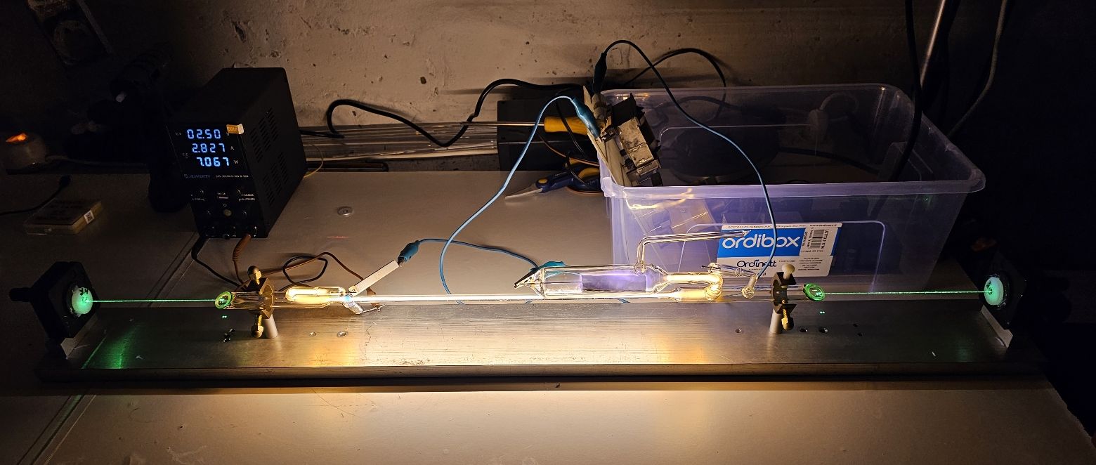

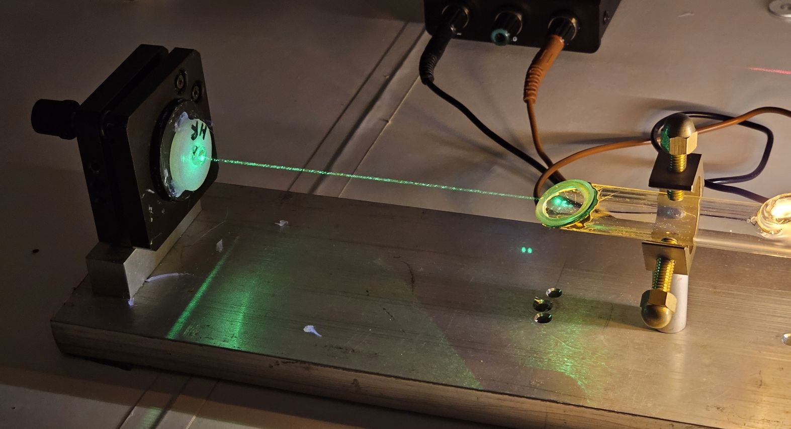

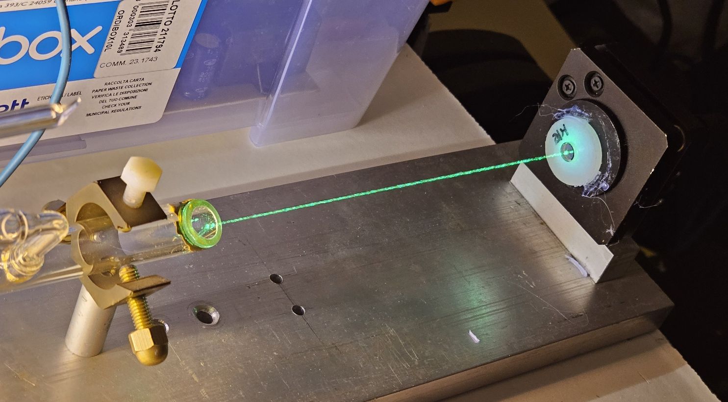

    Andrea's Helium-Selenium (HeSe) Laser
    (From: Andrea Verniani.) The laser tube is built with borosilicate glass (COE 33) 55 cm long and uses amateur-made electrodes. The cathode consists of a titanium sheet wrapped around itself and spot welded onto a 1 mm tungsten rod. the anode is simply made up of a single piece of tungsten that passes through the glass. The ends of the laser tube are cut at the Brewster angle and support quartz windows (fused silica). The windows are vacuum-welded with a special enamel that must be baked in the oven. You can almost say it's a hard seal. The active zone of the tube is formed by a borosilicate glass capillary with an internal diameter of 2.3 mm. There is a small lateral glass arm with a diameter of 8 mm heated by a nickel-chromium filament with a small quantity of very pure selenium inside.
    The tube is then connected to the vacuum system and subjected to a heat treatment using an electric discharge to remove impurities from the tube, followed by a series of treatments with pure helium and heating of the selenium to make it melt and free it from any trapped gases. Then we proceed with the degassing of the cathode by induction heating. The vacuum is produced by a turbo-molecular pump and reaches a value of 10-6 Torr.
    After two hours of vacuum, the tube is filled with pure helium at a pressure of 12 Torr, separated from the vacuum line and ready to be used. The mirrors used for the cavity were initially a pair of broadband type 2 (SAM) and subsequently a pair of multi-line argon mirrors obtained from an ALC 60 laser.

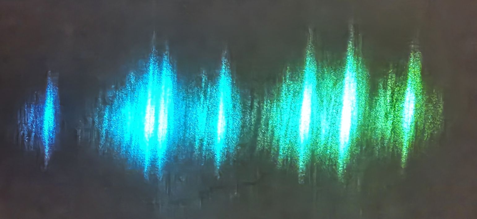

    With type 2 broad band mirrors we obtained lines in green and yellow, while with ALC mirrors we have blue, green but no longer yellow. However, it must be said that: the discharge current unfortunately is a maximum of 80 mA, with higher currents new lines are also generated, we will see in the future with another power supply with greater current. The laser has been working for days and is still in excellent operating condition.
    Here are some photos:
    And a bit later, I managed to get a power supply that delivered 105 mA and as expected a line appeared in the orange-red. ;-)
    Here are some short videos of the laser:
