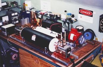

The main recommendation for your first CuCl/CuBr laser is to NOT make significant changes to any of the basic specifications (dimensions, materials) of the laser assembly and power supply.
My copper halide laser is similar to the original article in "Light and its Uses" but with some updated components used in construction. For instance; instead of a quartz heater next to the plasma tube, I employed high temperature, laboratory type, heating tape wrapped directly around the plasma tube. This was purchased from AmpTek Company. I used the medium watt density, 1/2 inch wide tape. The 36 inch length is the perfect length for wrapping the 24 inch, 14 mm OD quartz plasma tube, covering 21 inches using closely spaced wraps. This product is capable of reaching 1400 F. The temperature of the laser is controlled by a process controller with a digital readout of the actual temperature via a thermistor mounted very close to the plasma tube. This unit was calibrated using a temperature probe inside the plasma tube before the laser was completed.
The plasma tube is constructed of heavy walled quartz tubing to avoid the possibility of the high voltage plasma arcing to the heating tape. The 2 mm fused quartz walls have a breakdown voltage of between 30,000 and 40,000 volts. Well above the 15,000 volts passing through the plasma tube. The Diagram of CuBr Laser shows the general construction details.
The high voltage power supply uses a mechanical distributor to double-pulse the laser at the required repetition rate. The motor (salvaged from a clothes dryer, I believe) is rated at 1725 rpm (but probably actually running close to 1800 rpm under these essentially no-load conditions). With the size if the sheaves I am using this has the pulser electrodes spinning at approximately 7000 rpm. This is something that can and should be adjustable anyway. The speed of the electrode assembly can affect this lasers operation. Just another parameter to play with to optimize this laser's output.
WARNING: The potential danger from the energy stored in C1 and C2 cannot be overemphasized! R1 and R2 are 100M ohm bleeder resistors rated at 5 W and 20 kV, which safely discharge these capacitors in about 10 seconds once system is shut down.

I have just completed a home built copper halide laser. I decided to use copper(II) bromide (in helium) instead of copper chloride as the lasing medium. I had read that this copper halide was more efficient than the chloride. Also of interest is the addition of a small amount of hydrogen to the mix to dramatically increase output power. I have yet to try this, as I just obtained the copper(II) bromide. I was very fortunate to produce a beautiful, bright, green beam on the very first try. This is somewhat unusual with home built systems.
I am currently using a mechanical pulser (similar to the one described in the Scientific American article) to produce the closely spaced, rapid, high voltage discharges required for this laser's operation. This leaves something to be desired, as it is very noisy. I had considered the use of thyratrons for this application until I saw the price of these. (YIKES!!)
My copper bromide laser is very unique in many ways. It is certainly the first laser I have ever built that not only requires eye protection, but ear protection also. :-) The pulser, when in operation, is very LOUD.
