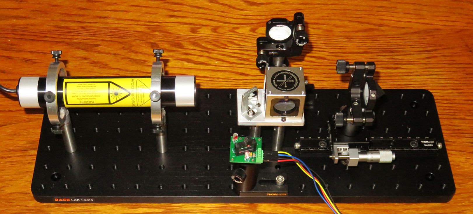

    The photo below shows the Basic version configured for the LI. There are minor variations in the actual kits depending on version and whether they are the "Basic", "Deluxe", or "Deluxe+" versions, though this layout will work for all of them. Differences will be noted below. Where the total path length and PLD is small, no beam expander is needed for the laser as in the Basic version. This may result in a larger signal since the entire beam hits the detector. But the smaller beam makes it more sensitive to alignment.
    Typical Linear Interferometer Setup with Quadrature Decoder and µMD0

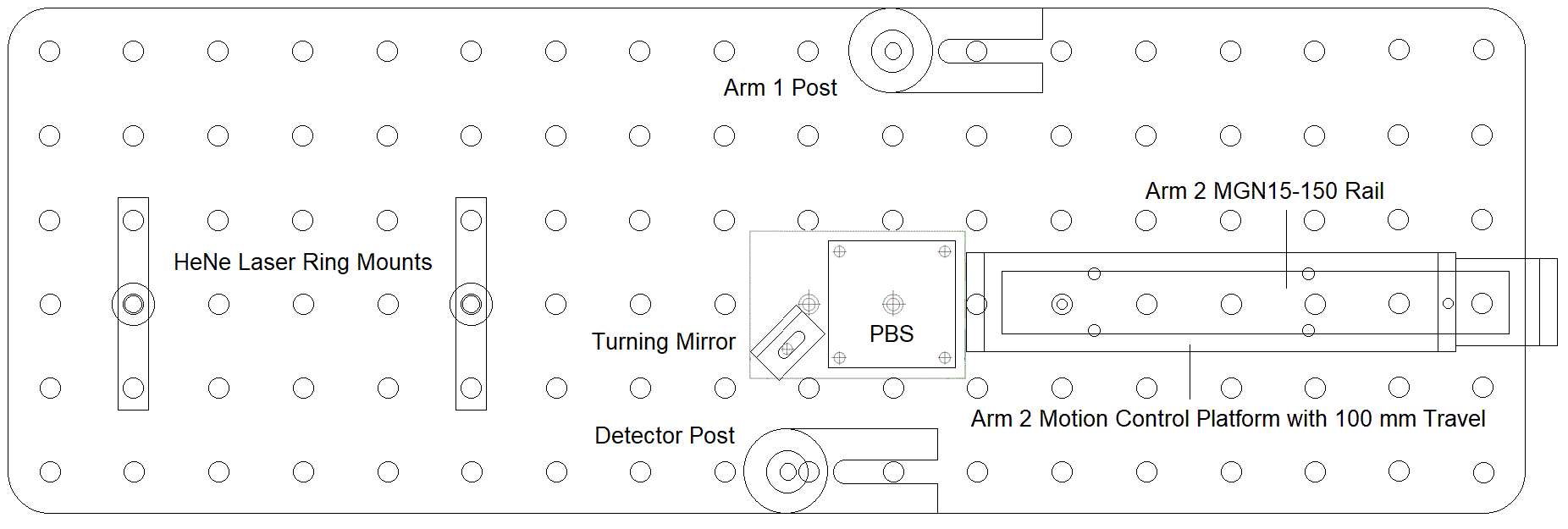

    The diagram below shows the general arrangement of the laser, beam splitter, cube corners, and detector.
    Linear Interferometer Diagram and Suggested Breadboard Layout
    The other configurations will have a few additional or substitute parts and small variations in the horizonatal position of the laser and placement of the detector but are otherwise similar. Therefore the LI setup will be described in more detail.

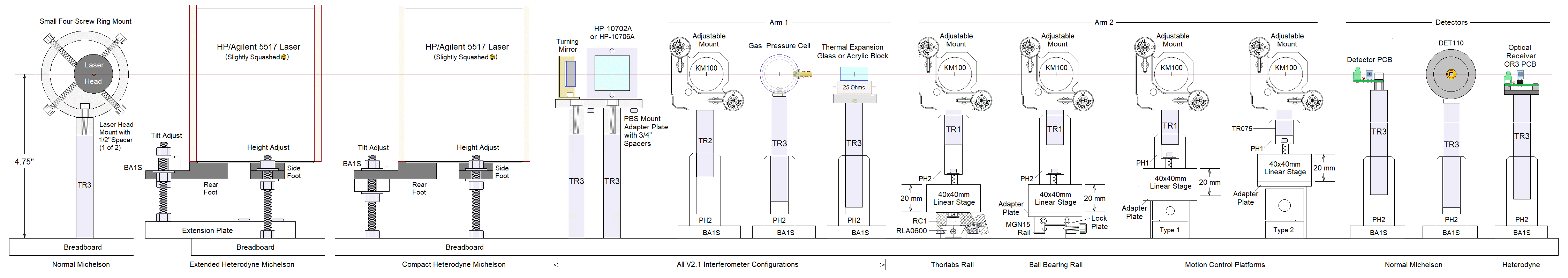

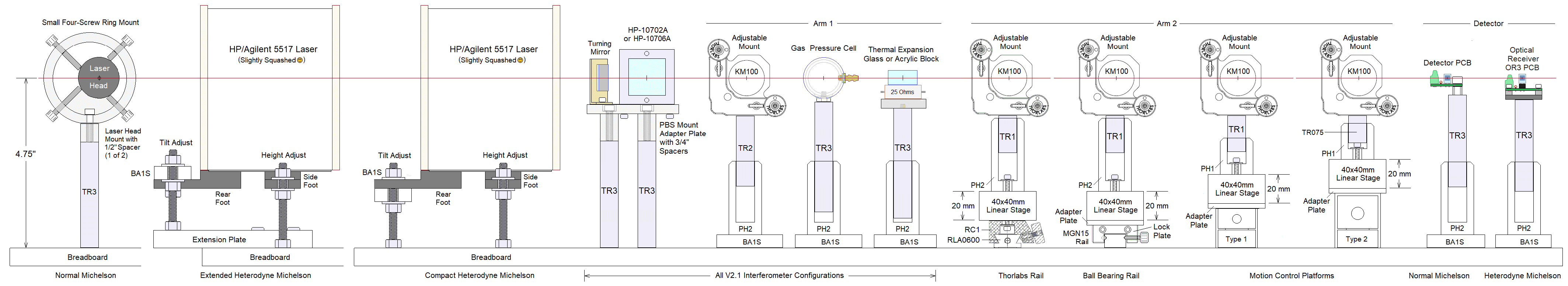

    The following diagram shows the relationships of the various mounts for setting the heights during assembly. This diagram applies to all V2.1 setups. 4-1/4" places the laser in the center of the PBS vertically:
    Required Optical Components and their Suggested Heights.
    The heights of any Retro-Reflectors (RRs) in the setup will be what most affect the beam height. This is true of the Linear Interferometer (LI). Where there is an RR attached to the PBS cube like the Plane Mirror Interferometer (PMI), the alignment of the laser will need to be used. However, there is a wide tolerance and enough degrees of freedom so in the end, it should not really be much of a problem to set it up.

    Photos of each of the three versions with typical interferometers are shown below. The first is the Basic version with the 6x18" the breadboard, configured with Linear Interferometer and quad decoder PCB attached to the SG-µMD0 PCB:
    The next one is the Deluxe version configured for the High Stability Plane Mirror Interferometer. The laser includes a beam expander but it is otherwise configured the same way.
    The next is the Deluxe+ "Stretch" version on the 8x24" breadboard.
