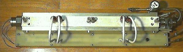

    Another Carbon Dioxide? Laser (Gallery)
    (These photos, description, and questions are from: Daniel Ames (dlames2@aol.com).)
    Here is another strange and interesting laser. To be honest, I really very little about this one. I don't even know if it really is for CO2 or CO!
    Description:
    And now for the good stuff:
    As someone once said, aside from the unknowns, everything else is obvious (--- Sam). :)

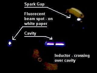

    PRA Nitromite Model LN100 N2 Laser (Gallery)
    (These photos and description are from: Daniel Ames (dlames2@aol.com).)
    This is a Nitromite model LN100 nitrogen laser that operates at atmospheric pressure so it doesn't need a vacuum pump to operate. The laser is completely self contained except for the nitrogen gas. The manufacturer is PRA - Photo Chemical Research Associates, Inc. There is a very similar type N2 TEA at the Photon Technology International Model GL-3300 Nitrogen Laser Operation Manual Page.
    The cavity is only 1.5" in length. This laser sure is a great example of the N2 UV lasing properties. When the spark gap's pressure is too low, the output power drops off substantially. With the spark gap's N2 pressure at atmospheric - it will not even lase. I have been using between 15 to 22 psi in the spark gap. These pressures seem to work well with this laser. With 15 psi, the pulse repetition is more uniform than at 22 psi. The cavity is not sealed so a flowing pressure of +1 or less psi helps keep the output stable.
    Description and features:
    The top cover has been removed for the photos.
    There is much more information on N2 lasers in the Home-Built Nitrogen Laser chapters of Sam's Laser FAQ.

    Waveguide Carbon Dioxide? Laser
    View 03 View 04 View 05 View 06
    View 07 View 08 View 09
    View 10 View 11
    View 12 View 13 View 14
