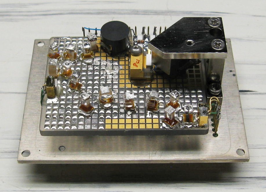

The LWE-122 is a diode pumped IR (1,064 nm) laser utilizing a monolithic Non-Planar Ring Oscillator (NPRO). This and other Lightwave lasers are extensively covered in Sam's Laser FAQ, in the chapter: Commercial Solid State Lasers. Unlike the LWE-142 (below), most of the electronics are in a seprate microprocessor-based controller and the laser head only has a personality EEPROM and possibly photodiode preamp. The laser head IS the optics box. The cover and connector PCB seals via rubber O-rings.
Apparently, the LWE-122 never caught on as very few appear to have ever been built. It was succeeded by the LWE-125/126, which is functionally similar but with the controller built into the laser head (like the LWE-142).
Here are photos of an LWE-122 system and what's inside the laser head.
