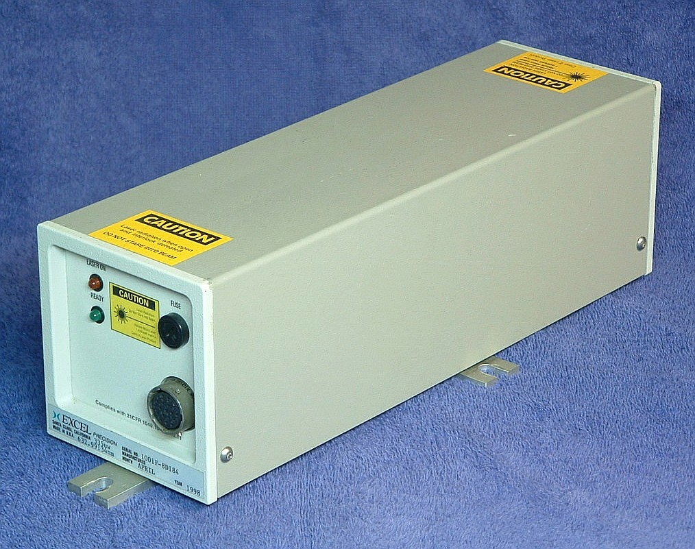

View 03 - Right back view.
View 04 - Back closeup view. The connector is physically and
electrically compatible with HP/Agilent interferometers.

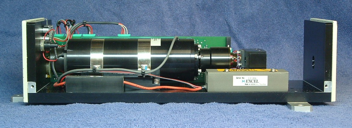

View 08 - Right side interior view. The HeNe laser power supply
is at the lower right with the ballast resistor at the lower left.
The fat red (anode) and gray (cathode) wires are clearly visible.
Unlike the 1001f, this HeNe laser power supply does not appear to
be shielded.
