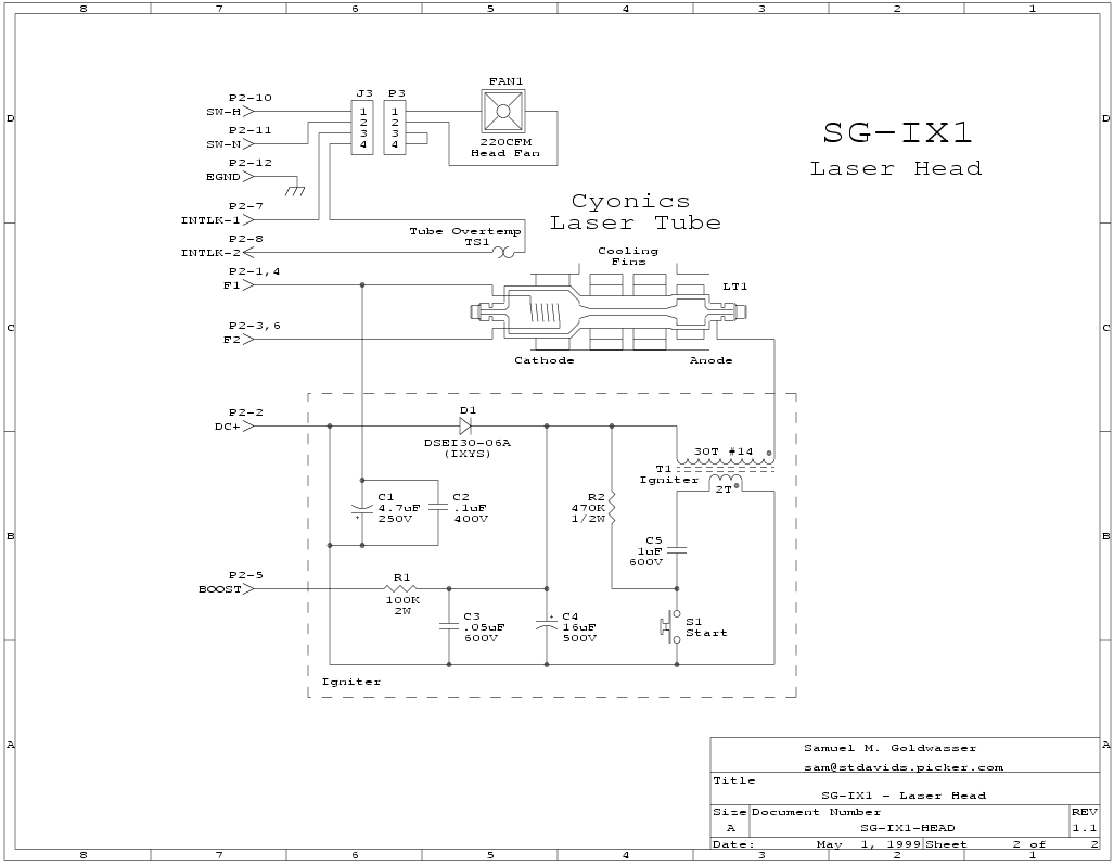

      SG-IX1     115 VAC    N   NA       ***********                    "

    5. The designs of the home-built ion laser power supplies can be easily adapted to almost any small (air-cooled) laser head. A few of the models that are either known to work or expected to work without difficulty include the ALC-60X, NEC GLG3030, SP-162A/B/C, and Cyonics/Uniphase 22XX.

    SG-IX1 Schematics
    The diagrams are available in PDF format. There are two (2) drawing sheets:
    Components are numbered independently for the SG-IX1 power unit and laser head.

    SG-IX1 Laser Head
    The SG-IX1 Laser Head is a intended as a suggestion and may differ from what you have if you are testing a commercial laser head. It includes the Cyonics air-cooled argon laser tube and its HUGE fan and igniter. Like the head for SG-IT1, this stripped down head has no light sense circuitry or interlocks. The part numbers below refer to the SG-IX1 laser head unless otherwise noted. Except for the tube and blocking diode (D1), *everything* was scavenged from my junk pile and random parts bins. Therefore, you have no excuse - an ion laser head is easy to build. For example:

    During and after construction, the power supply was tested on a Variac via an isolation transformer. The final test was done with its outputs shorted (DC+ to F1) to confirm that the hot-plate ballast resistor could take it and the dual range meter and current select switch worked as expected. (The isolation transformer was temporarily removed for this test since there was no way it could ever possibly handle the current.)
    After I was happy with the power supply, I built the laser head with its igniter and made sure that this didn't blow up using the Variac/isolation transformer setup and multimeter before installing the Cyonics tube.
    With everything powered at normal line voltage (still using my Variac and isolation transformer), a diffuse pulse of blue-purple light could be seen from the tube each time the Start button was pressed. The dual range meter also showed a corresponding pulse of current and dip in voltage - now this was very promising. I didn't expect the tube to light with my 200 W isolation transformer in place so I would have to remove it!!!
    And then, all h**l broke loose. :) Actually, what happened was that the main breaker tripped (CB1) as soon as the Operate switch (S3) was turned on. Hmmmm. Since I knew the ballast resistor was correctly connected, the only way this could happen would be through the filament return to Earth Ground. Then, it hit me: I had grounded the can on the tube surrounding the filament to the case! Of course, it would arc directly from Ground to the filament since this was at a high enough potential to break down the gas in the tube - not having to go through the capillary - and bypassing the ballast resistor!
    Once that 'feature' was removed, the tube fired up instantly and reliably as far as the discharge was concerned. I currently have the current select switch (S4) jumpered for 3.5, 5.0, and 7.5 A. This works as advertised though the tube sometimes drops out when changing settings - presumably due to a momentary dip in voltage. No problem, a push of the Start button takes care of that.
    However, as expected, there was no lasing from my semi-broken Cyonics tube at any current setting. It was possible that the current wasn't high enough but I suspected that this wasn't really the problem as I had attempted to get this tube working with the pulsed supply described in the section: Ar/Kr Ion Tube Pulse Test Circuit 3 without success even with a peak current of more than 15 A.
    I assumed this to be either still a result of improper mirror alignment (though as best I had been able to determine with a HeNe laser alignment jig, I thought it should have been close enough) or some other as yet undetermined problem with the tube. So, I built a mirror adjuster out of a 3" long piece of 1/2" copper tubing (plumbing pipe) which with some reaming, just slips over the collars on the mirror mounts. It is WELL INSULATED with multiple layers of plastic electrical tape (but I still remain clear of it when starting just in case).
    Using this widget, I tried rocking the mirror mounts while the tube was powered with SG-IX1 at up to 8 A but still no success. I figured at the time that it was possible that leaving the existing collars in place restricted movement too much but I didn't dare remove them yet as the mirrors at BOTH ends of the tube would likely be messed up after that! This tube has severe cathode sag but the bore is clear - barely - with the filament just barely missing it so while its days might be numbered, that in itself should not affect its ability to lase. The person who gave me the tube assured me that the problem would be mirror alignment but I was still not convinced.

    Having played with SG-IX1 for awhile, I decided to design a super simple linear current regulator to replace part of the ballast resistor and provide continuously adjustable current to the ion tube. I didn't want to bother with separate low voltage power supplies, op-amps, or loop equations. The result is a basic regulator using a linear pass-bank of 6 2N3055 NPN power transistors driven by an adjustable voltage source derived from the main DC+ rail. This isn't quite as precise as one using fancy control loops with integral/differential system equations but should still have much lower ripple and much better line/load regulation than the brute-force hot-plate supply.
    Tube current is adjustable from about 0 A (or as low as the tube will sustain a discharge) to 10 A (though I probably wouldn't want to leave it at more than about 8 A continously).
    I expect to transform SG-IX1 into SG-IY1 once I scrounge up the rest of the additional parts!
    Note that SG-IY1 still does not have any provision for light control - which is essential for maximizing tube life (at least for some laser heads wich are prone to plasma oscillations). See the section: Tips for Maximizing Ion Laser Tube Life.
    SG-IY1 Schematics
    The diagram is available in PDF format. There is only one (1) drawing sheet:
    Being a simple addition to SG-IX1, the same laser heads can be used.
    As you might expect, most of the diagram is the same as SG-IX1 (though slightly rearranged to fit everything on the single sheet - one of the other important requirements of this design!). A few of the changes include:
