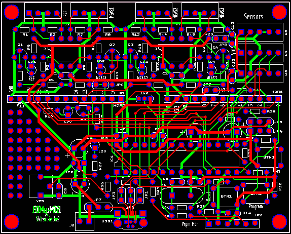

SG-µMD1 PCB Layout Version 1.2
Refer to the SG-µMD1 V1.2 board layout and photo below.
SG-µMD1 PCB V1.2 Layout Diagram (Left) and Three-Axis Populated PCB (Right)
Click on the photo for a high resolution version which will open in a separate window for reference during assembly.
As can be seen by comparing this layout with that of the chipKIT board, most parts are in similar locations. The USB connector has moved to the bottom of the board along with its associated jumpers. The Arduino headers have moved slightly and there are now complete layout patterns for up to 3 measurement channels and locations for the environmental sensors.
For use with environmental sensors, additional components will be required that are not part of the standard SG-µMD1 kit.
The populated PCB shows all components required for a three axis system without sensors. The terminating resistors (R1,R2,R7,R8,R13,R14,R19,R20) have not been installed since their value may depend on the specific configuration. The hole spacing is such that a machine pin header strip with unused pins popped out can be installed so that resistors can be plugged into it.
IMPORTANT: All the resistors are labeled using the standard color coding as shown in the main µMD1 manual and below. Normal color vision is required to be able to identify these reliably. Even then, it is sometimes difficult to confirm the values that differ in one band or in poor lighting. And a magnifier may be required to read some markings on these and other components. If in doubt, have someone else assemble the kit or assist you.
For those not familiar with the common resistor color code (Black/0, Blown/1, Red/2, Orange/3, Yellow/4, Green/5, Blue/6, Violet/7, Gray/8, White/9), the resistors near the small IC in the upper left of the photo of the SG-µMD1 PCB shown above are 680 (blue-gray-brown or 68 with 1 zero) ohms and 330 (33 with 1 zero) ohms. The gold stripe indicates 5 percent tolerance on the value but for the use here, tolerance doesn't matter. (It's possible the resistors you use will have 4 stripes where 3 of them are the value and the 4th is the multiplier, along with one for tolerance. If in doubt confirm the value with a multimeter.) The chart below is from Digikey. (If the link decays, a Web search will readily find another one.)
The LEDs in the area for MEAS2 and MEAS3 are equivalent to the chipKit DP32 LED2 and LED1, respectively.
