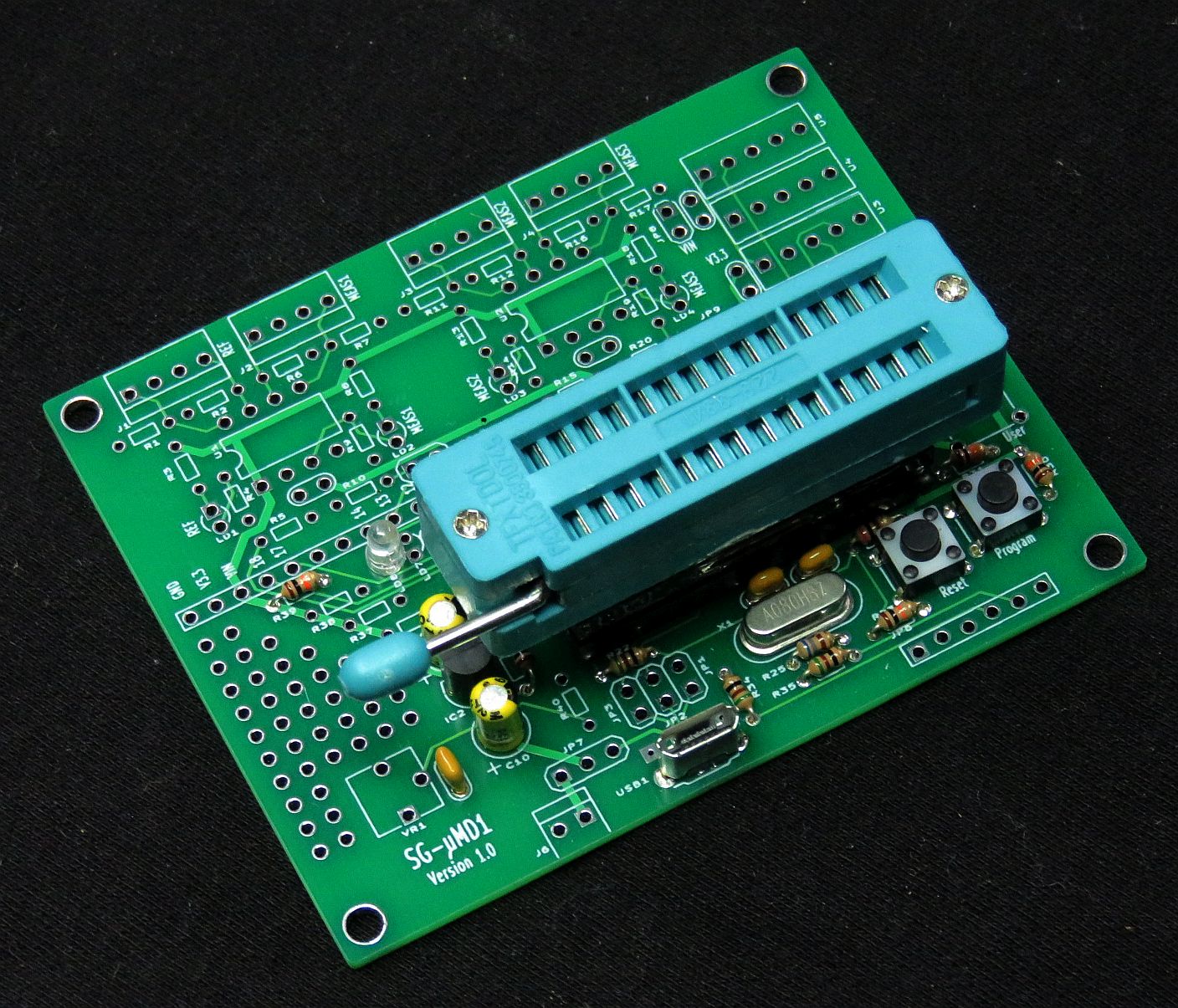

SG-µMD1 V1.0 PCB MPLAB Version with ZIFF Socket. V1.2 is Nearly Identical
The 28 pin SDIP ZIFF socket is plugged into a leaf-spring socket which is plugged into a machine-pin socket. The stack is glued together on the edges so that it easily plugs into the socket on the SG-µMD1 PCB. Installing a right-angle header for JP6 would be beneficial as a straight header blocks the Reset and Program buttons. Of course, the PIC32 can be plugged directly into the on-board socket.
All components are through-hole and except as noted in the detailed assembly procedure, should seat flush on the PCB. They shouldn't be suspended in mid-air swinging in the breeze. :) Most components are identified on the silk-screen and with only a few exceptions, the label won't be obscured when the part is installed.

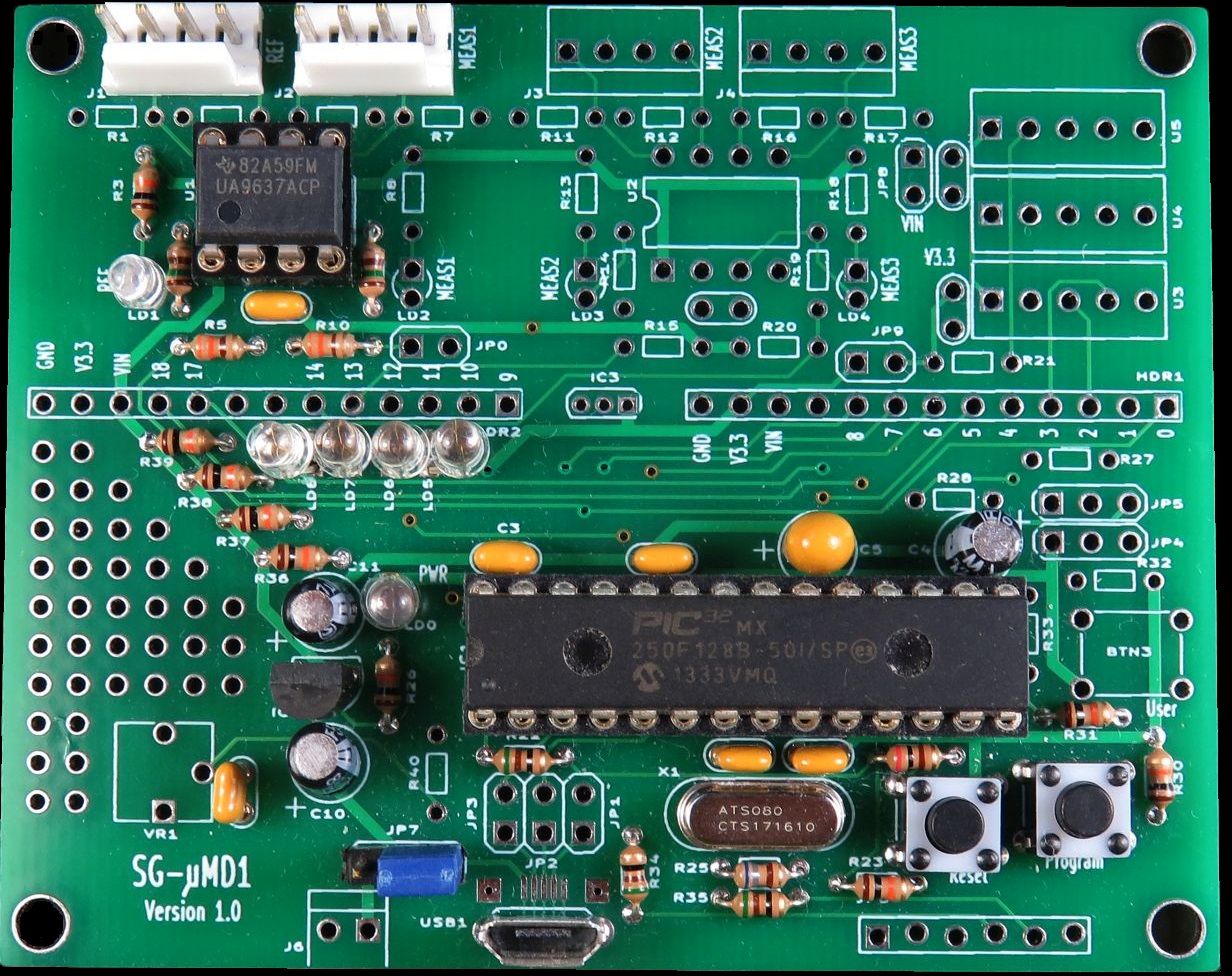

SG-µMD1 V1.0 Single Axis PCB shows the PCB populated with the parts for a single axis system without sensors. Only the parts below the headers are required for MPLAB and USB download support.
A low power soldering iron with narrow tip and thin (e.g., #22 AWG) rosin-core solder will be required. DO NOT even think about attempting this without suitable soldering equipment. It's well worth the investment. A Weller soldering gun or propane torch will not work. :) Rosin core solder is also essential. And while I'm quite confident that you never make mistakes, a means of component removal such as a de-soldering pump (e.g., SoldaPullt™) will be highly desirable. Screwing up component removal can easily ruin the PCB and is not covered under the unlimited limited warranty. :-)
Total assembly time should be well under two hours for someone proficient in fine soldering. Cutting component leads to 1/4 to 3/8 inch before installation will simplify soldering as the long leads won't be poking you in the face. :( :) Then trim flush after soldering.

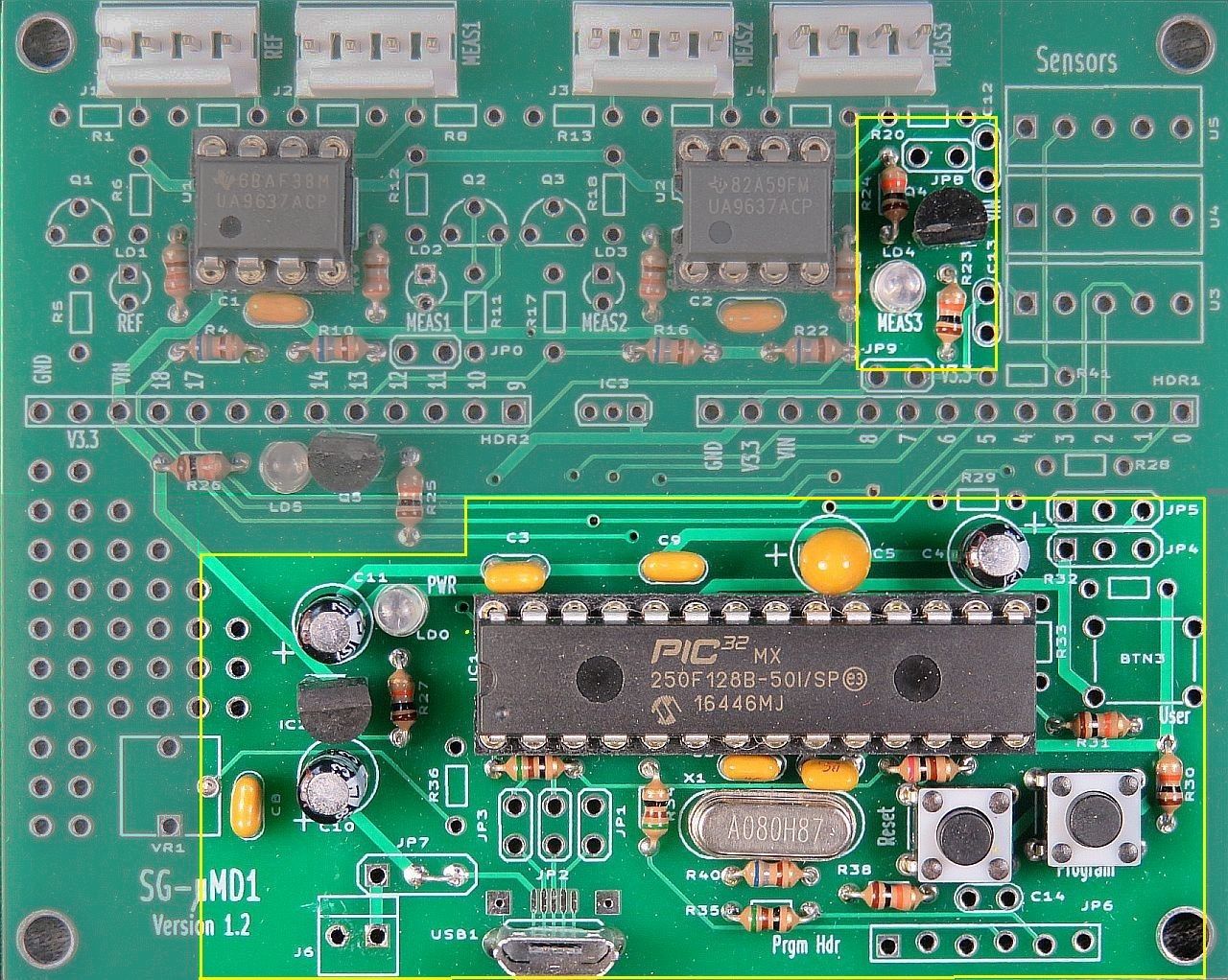

SG-µMD1 PCB Layout Version 1.2
Refer to the SG-µMD1 board layout below.
SG-µMD1 V1.2 PCB Layout Diagram (Left) and Populated PCB with MPLAB Parts Outlined in Yellow (Right)
This shows a PCB populated for a 3-axis system with the required MPLAB parts highlighted. In essense, most parts below mid-board are required to run the PIC32 and for it to communcate with the MPLAB programmer and USB. The only parts above mid-board that are required are LD4 and it's assoicated resistors and transistor. Also a header for JP6, and C14 should be installed (not shown).
