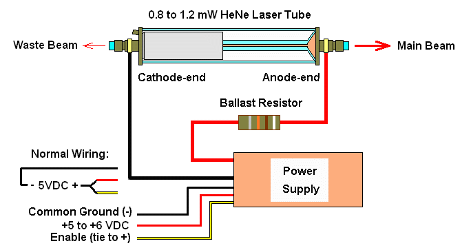

Power and wiring:
The HeNe laser power supply requires a regulated 5-6 VDC power supply at 1.5 A max. A switchmode wall adapter is included in this kit. However, if you'd rather use one of your own, adapters like those for some digital cameras or cell phones should be acceptable, but check to make sure its current rating is adequate and measure its voltage unloaded to confirm it is between 5 and 6 VDC. Jameco, Marlin P. Jones, DigiKey, Mouser, and other electronics distributors will have a suitable unit. Confirm the correct polarity if in doubt. The short red and yellow wires on the HeNe laser power supply brick should be tied together securely (soldered is desireable) and are positive; the short black wire is negative. (The yellow enables the laser when tied to red. For this application, red and yellow should be tied together permanently.) IMPORTANT: If you ordered the kit with a 24 VDC HeNe laser power supply and adapter, the wiring is slightly different! Using the incorrect wiring may destroy the power supply. The following is for the 5 V version:
HeNe Laser Power Supply Connections
(All black wires are the same - return/Ground. The other unused wires provide approximately +/-9 V at low current intended to power an RS232 transceiver in the original barcode scanner application.)
It is even more essential that the wiring to the HeNe laser tube have the correct polarity and insulated so there can't be shorts or arcs. Reverse polarity may ruin the tube in a few minutes even though it may appear to light up and lase normally. The end of the tube that has the thick glass capillary is the anode, positive, red, and 91K ohm ballast resistor. It has the HIGH VOLTAGE and must be separated from the magnet frame by air or adequate HV insulation. The voltage can be up to 5,000 V when starting. The end of the tube with the aluminum can is the cathode, negative, black (either black wire of the power supply brick. A short or arc can destroy the HeNe laser power supply and perhaps even the wall adapter.

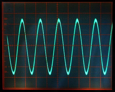

Use this detector to view the Zeeman beat or measure its frequency from the tube in magnet. A polarizer must be placed in front of the PD but without the waveplates, its orientation doesn't matter.

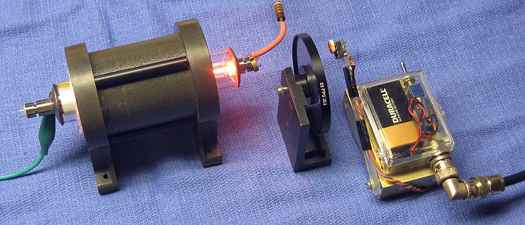

Test the tube for Zeeman behavior:
Temporarily install the tube inside the magnet with adequate insulation to prevent shorts or arcing at the anode end. It should light up nearly instantly, and to the unaided eye, will appear to lase normally. Power it as described above and aim it on the PD (through the polarizer).
Tube Installed in Zeeman Magnet for Testing (Reft) and Typical Beat Signal (Right)
This shows the bare tube snug in the magnet inside some foam padding along with a polarizer and a built up version of the beat detector with a swing arm and 9 V battery inside. The polarizer is also a fancy one but the one in the kit will work just as well. As the tube warms up and the cavity length increases, there will periods during mode sweep where there is a beat at a frequency between 0.8 and 1.5 MHz for the 6 inch tube. The beat will probably be present between 25 to 50 percent of the cycle, and will change frequency somewhat during this time. If 5-10 VDC is applied to the heater (between the two red wires), the rate of the mode sweep will greatly increase since the tube is expanding faster.
