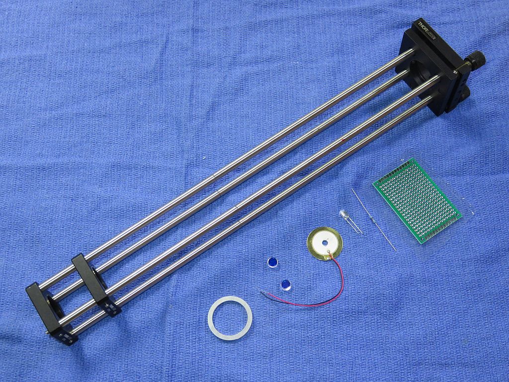

The photo below shows the typical parts in one of the Deluxe kits, in this case with a 14 inch Thorlabs cage assembly. The basic kits include the mirrors, PZT, and photodiode ONLY.

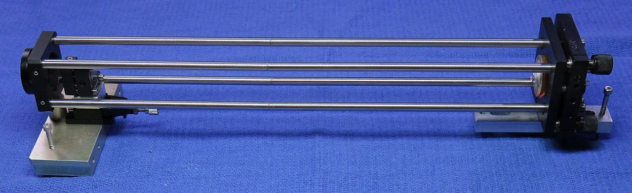

The photo montage below is for an implementation using a 22 inch Thorlabs "cage" assembly like in the Hi Res Deluxe+ kits. It is set up for 1/2 the confocal spacing (~50 cm) which is a good tradeoff between size and practicality. Using the mirrors in these kits, its resolvance (the minimum distance between lasing lines that can be detected) can be better than 500 kHz.

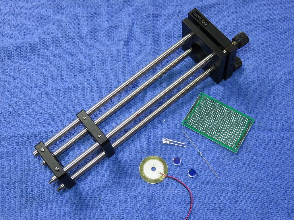

The photo below shows parts similar to those in the standard kits. The mirrors in this photo are much more curved than for the Hi-Res kits though.
Typical Parts in High Resolution standard SFPI Kits
The standard Hi Res kits includes:

The photo below shows the Thorlabs cage frame and other typical parts in the Deluxe Long kits. The Hi-Res and others are essentially similar except for the length of the cage frame.
Typical Parts in Deluxe Mid and High Resolution SFPI Kits

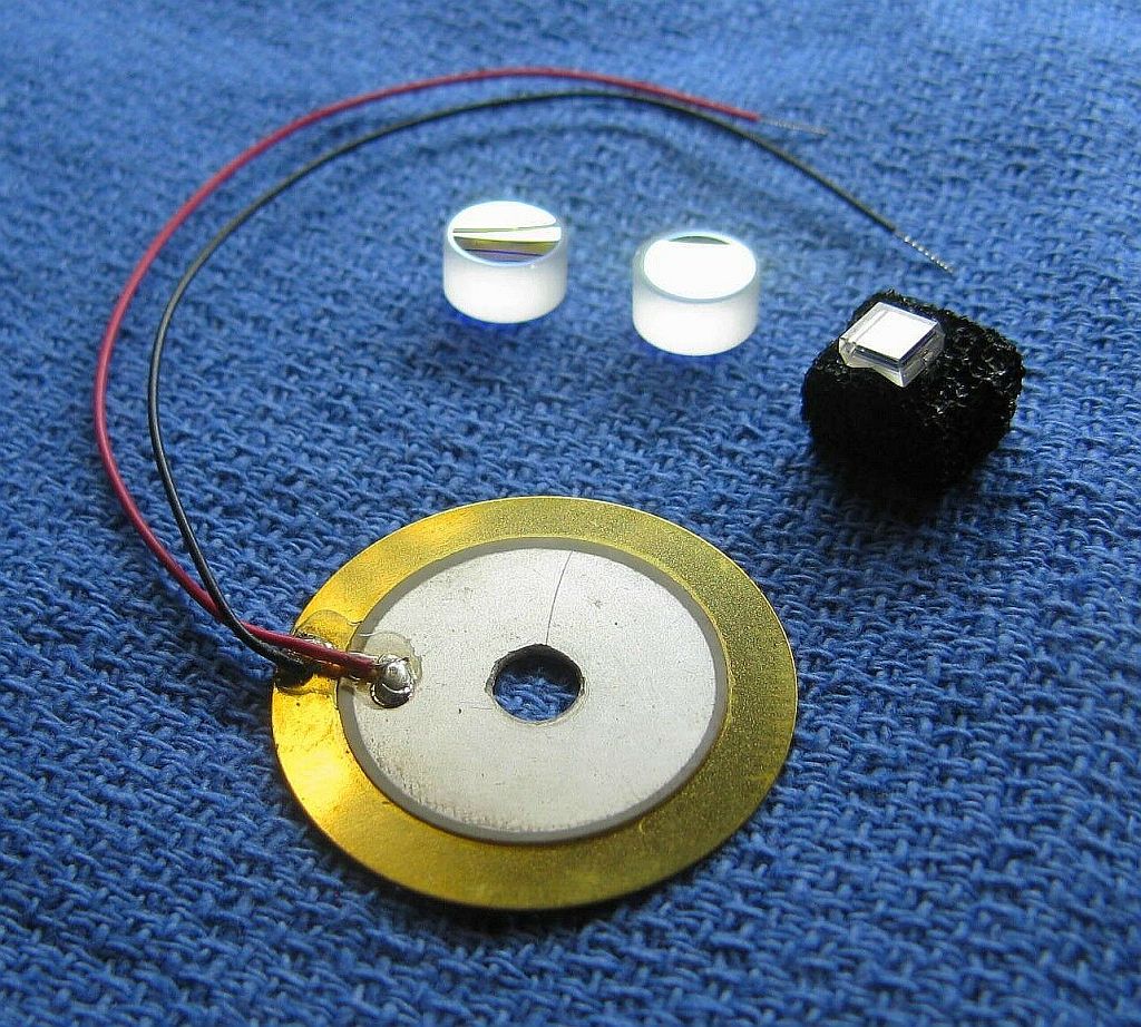

PZT and back mirror:
Prepare the aluminum spacer ring or your preferred mounting scheme and attach the PZT disk to it. (Using the ring isn't essential but will make mounting to the Thorlabs mount slightly easier and provide a path for the PZT leads inside the plate to exit out back.)
Using a narrow file, create a notch wide and deep enough on one surface of the mounting ring for the PZT leads to pass through between the ring and mounting plate.
Use 5 Minute Epoxy to attach the PZT disk to the aluminum spacer ring around its perimeter. The active (coated) side of the PZT disk should be facing up.
The back cavity mirror must be glued to the PZT. First clean the active surface of the PZT disk with alcohol.
(The following applies to the standard 42 mm mirrors. Mirrors with a large RoC may not have significant wedge, if any, and they will likely be installed on an adjustable mount. Therefore this extra step is probably not required.)
Some mirror substrates are ground with significant "wedge" - the front and back are not parallel. Small wedge is often built into mirrors like this to avoid reflections from the non-mirror surface re-entering the laser. Carefully inspect the mirrors under a magnifier or use a caliper taking care not to touch the coated surface. If there is detectable wedge, the mirror should be propped up on the thinner side when gluing so the edge of the coated surface ends up parallel to the mounting surface. (This can be avoided by attaching it to the back of the PZT but I prefer the other way since being recessed, it's almost impossible to clean if that should ever be required.) For the short RoC mirrors used in the Basic and Deluxe kits, the currect angle can usually be obtained by placing a tiny piece of standard Avery sticky label under it on the thin side. :) (Very scientific, huh?) A 1x5 mm piece of label will suffice. For the Hi-Res kits, no propping up may be needed at all for the reasons cited above.
Center the mirror on the PZT disk taking care to orient it so the mark you added lines up with the bump (if applicable). While gently holding it in position with the flat side of a toothpick so as to not contact the coated surface or (less desirable) a clean cotton swab, apply the tiniest amount 5 minute Epoxy in 3 locations around its perimeter. Just enough to secure it. Once the Epoxy sets up, additional adhesive can be added to increase the strength, but there really isn't much stress on this thing and too much adhesive may restrict the motion of the PZT.
After the adhesive fully cures, attach the PZT/mirror on spacer ring (if used) to the KC1, centering it as best as possible by eye. Set this assembly aside covered so the mirror doesn't collect dust or fingerprints.

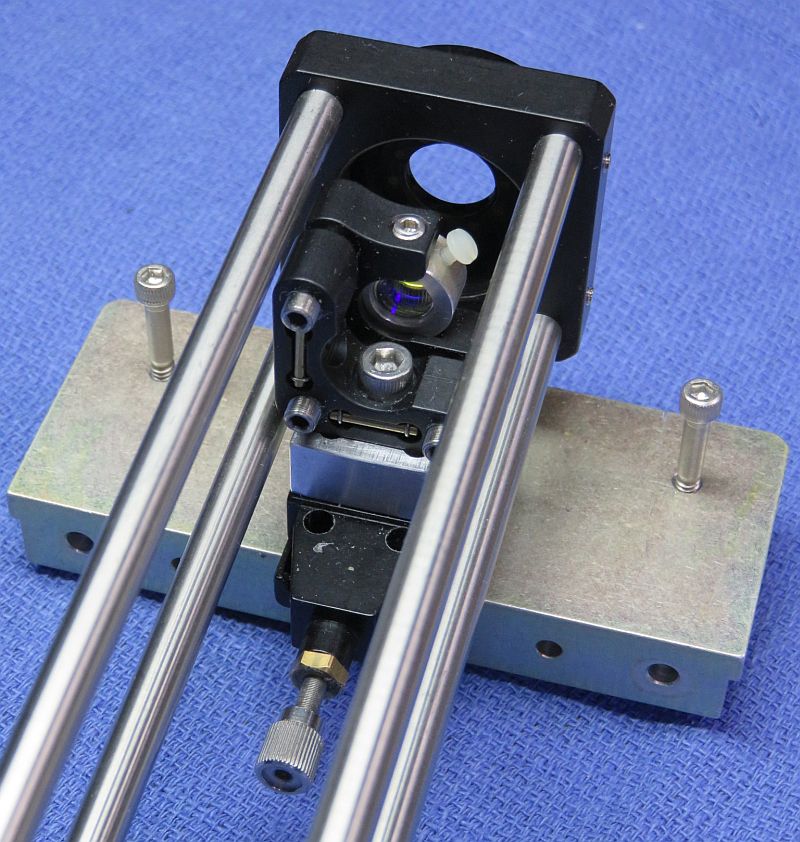

Front mirror:
For these long SFPIs, unless there is a commercial adjustable mount for the front mirror, it will probably be necessary to construct one of your own, or to shim the mirror while reflecting a beam from the other end of the cage assembly off of it to assure it is mounted fair and square. A home-built mirror mount is quite simple though if you have that drill press and small bits and taps. A piece of 1/16" aluminum plate may already be included in the Deluxe kits.
Locate three locations where holes can be drilled in the aluminum plate that will be in areas of the cage plate which can be tapped. The recommended screw size is 2-56 but 4-40 is also acceptable, and bits and taps for 4-40 are less likely to break. Drill three holes in the plate with the correct drill size to be used for tapping the holes. Then secure your drilled aluminum plate to the cage plate in the desire location and use it as a template to drill the mating holes in the cage plate. Tap those 3 holes and widen the holes in the aluminum plate to be clearance holes for the adjustment screws. Use a split washer or rubber O-ring for each hole between the aluminum plate and cage plate as a spring restoring force. Attach the mount to the cage plate and gently tighten the screws. Now locate the exact center of the aluminum plate with respect to the cage plate and drill a 4-5 mm hole there so the beam can pass through.
Secure the AR-coated side of the 1 meter RoC mirror to the plate with 3 tiny dabs of 5 minute Epoxy as with the back mirror. Take care to center it since there are no XY adjustments.

Cage Assembly:
Implementations of the "Hi-Res" and "Long" SFPIs from less than 10 percent or up to twice the RoC may be constructed that are still mode-degenerate. The shorter ones are more manageable in terms of space and stability requirements and have larger FSRs with some sacrifice in finesse. The longer ones are, well, longer, and probably not really useful for the Hi-Res and Long SFPIs. :)
Initial Adjustments
In the table below, the term d/r is 1 for the confocal spacing. For the Hi-Res SFPIs, the nominal RoCs of the mirrors is 100 cm (though the actual RoC may differ from the spec and your mileage may vary). The most useful parameter values are N between 2 and 10 with k=1 as shown below which all result in shorter cavity lengths and larger FSRs.
Of particular interest here are N/k = 3/1 (50 cm spacing) and 4/1 (29.3 cm spacing). These result in more manageable size SFPIs than the 1 meter long confocal, with only a modest reduction in finesse. And 5/1 at around 20 cm would still have decent performance. For a more complete table and much additional info on SFPIs, see the sections of "Sam's Lsaer FAQ" starting with: Scanning Fabry-Perot Interferometers.
When setting the mirror spacing to a specific value of N/k, it's useful to keep in mind that the number of repeated peak-clumps ;-) for a fixed ramp drive voltage scales as N and the average peak amplitude scales as 1/N. So this makes it easy to recognize when a particular distance setting is selecting the incorrect values for N. Further, if not perfectly aligned, the number of distinct spots on the mirror surfaces will be equal to N.
However, if the FSR of the SFPI is smaller than the lasing bandwidth of the laser, there will be wrap-around or aliasing which means the order of the lasing lines will be scrambled and one must be careful about how the display is interpreted. This is certainly true for the Hi-Res SPFIs unless using some very specific types of lasers. Display of a Single Longitudinal Mode (SLM or simgle frequency) laser will be unambiguous with the display repeating at the FSR spacing. Another class of lasers for which this appies are HeNe two-frequency metrology lasers. The "split frequency" of Zeeman-split HeNe lasers from HP/Agilent/Keysight and others is never much above 7 MHz, and most are under 4 MHz. AOM-split lasers like the Zygo 7701/2 have a 20 MHz split frequency. So either type will be well below the FSR and suitable for unambiguous display of their split modes using the Hi Res SFPI at 633 nm.
Assemble the cage rods for the desired frame size, typically either 14 inches or 22 inches. Use a pair of padded pliers to tighten the individual rods together snugly (6+8" or 6+8+8"), they don't have to be super tight, just so they won't come apart with gentle handling. Then install the KC1 adjustable mount flush on the rods and tighten the grub screws. Slide the CP02 or CP33 cage plate with front mirror mount onto the rods but leave it loose. Finally install the front CP02 or CP33 cage plate flush with the ends of the rods and tighten its grub screws. The orientation of the CP02s/CP33s and KC1 should be such that the 8-32 tapped holes on their edges can be at the bottom to secure the front and back to the adjustment plates.
Use an 8-32 screw to secure the smaller foot (adjustment plate) to the KC1. Use a spacer and 8-32 screw to secure the front CP02/CP33 cage plate to the larger adjustment plate. Install the long 6-32 adjustment screws through their respective plates. The entire assembly can now be placed on a flat surface. Putting some soft wood or resilient tile pieces below each adjustment screws will enable them to "seat" by pressing down so the thing won't wonder as adjustments are made. The tips of the adjustments screws can be ground to a point with a file or stone, but if pressed into a soft platform this is not necessary.
