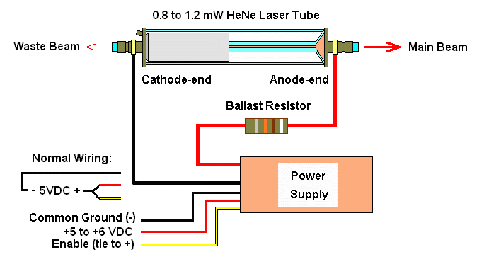

Power and wiring:
The HeNe laser power supply requires a regulated 5-6 VDC power supply at 1.5 A max. A switchmode wall adapter is included in this kit. However, if you'd rather use one of your own, adapters like those for some digital cameras or cell phones should be acceptable, but check to make sure its current rating is adequate and measure its voltage unloaded to confirm it is between 5 and 6 VDC. Jameco, Marlin P. Jones, DigiKey, Mouser, and other electronics distributors will have a suitable unit. Confirm the correct polarity if in doubt. The short red and yellow wires on the HeNe laser power supply brick should be tied together securely (soldered is desireable) and are positive; the short black wire is negative. (The yellow enables the laser when tied to red. For this application, red and yellow should be tied together permanently.)
IMPORTANT: If you ordered the kit with a 24 VDC HeNe laser power supply and adapter, the wiring is slightly different! Using the incorrect wiring may destroy the power supply. The following is for the 5 V version:
(All black wires are the same - return/Ground. The other unused wires provide approximately +/-9 V at low current intended to power an RS232 transceiver in the original barcode scanner application.)
It is even more essential that the wiring to the HeNe laser tube have the correct polarity and insulated so there can't be shorts or arcs. Reverse polarity may ruin the tube in a few minutes even though it may appear to light up and lase normally. The end of the tube that has the thick glass capillary is the anode, positive, red, and 91K ohm ballast resistor. It has the HIGH VOLTAGE and must be separated from the magnet frame by air or adequate HV insulation. The voltage can be up to 5,000 V when starting. The end of the tube with the aluminum can is the cathode, negative, black (either black wire of the power supply brick. A short or arc can destroy the HeNe laser power supply and perhaps even the wall adapter.
WARNING: There is over 1,000 V present while running and over 5,000 V at startup on the anode mirror mount of the tube! Stay clear! After powering down, discharge the power supply and tube capacitance by shorting between the two ends of a tube with a pair of clip leads, attaching one end to the cathode/black wire FIRST! Touching the HV probably won't kill you but throwing the tube across the room as a result of a reflex reaction is bad form and failure of the tube due to being smashed is not included in any warranty.
Make sure all connections are secure before applying power. The tube should light almost instantly. The output power may start relatively low (llke 0.7 mW) and climb to between 0.8 mW and 1.2 mW or more. (This modest increase probably won't even be obvious using only Mark I eyeballs.) It discharge glow and beam should be on continuously with no pulsing, flickering, or sputtering.
Note that there are two beams from the tube. The main beam emerges from the anode-end and may be used as both the main output and for feedback. The waste beam is around 100 times weaker and emerges from the cathode-end. Since the waveplates are required to convert circular to linear polarization, there are two sets of waveplates included in the kit. However, the waste beam can be used for the internal REF detector if desired requiring only a polarizer and eliminating one beam sampler.

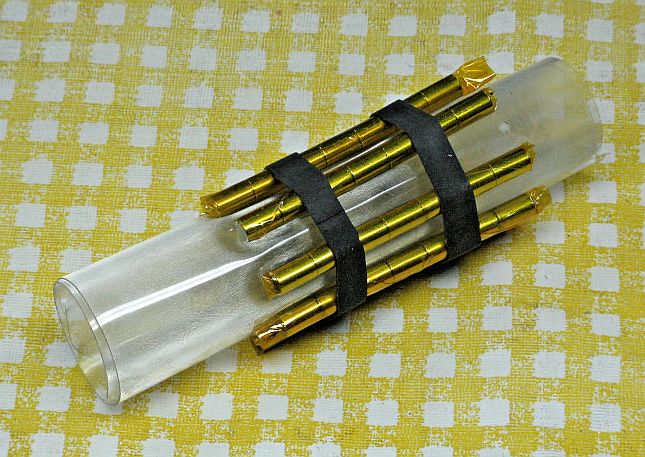

Installing the Magnets:
CAUTION: These are powerful rare earth magnets. Keep them well away from any magnetic media or other magnetic-sensitive objects or devices. Since they are small, flesh squashing isn't a major concern but they still can do damage.
The magnets can be arranged in a variety of ways. The one that has been tested and found to be satisfactory is 7 sets of 7 magnets spaced equally surrounding the tube. They must all be facing the same way, N-S field direction-wise. Whether N or S faces the output isn't critical but will flip the error signal so once a direction has been selected, stick with it. This arrangement of magnets should result in a peak split (or beat) frequency of 0.9-1.1 MHz. However, it's possible that an arrangement of, say, 10 sets of 5 magnets might be even better. Or if a higher split frequency is desired, obtain some more magnets. That's for you to determine if interested. :)
In order for the magnets to cooperate and not jump out of position, each "stick" should be wrapped with 1" Kapton (preferably) or packing tape. Then they can be secured surrounding the tube using slices of bicycle inner tube or tape. Provide adequate insulation so there can be no chance of the high voltage at the anode-end of the tube arcing to the magnets even if they shift position. A sheet of the type of thick clear plastic often used to package grocery items works well here as shown (slightly squashed) below.
The tube can be slipped inside and be close to the magnets without fear of short circuits or arcing.
It may be possible to increase the effective magnetic field - and thus the split frequency - by adding pole pieces at both ends of the magnet array - soft iron rings or the like. However, care must be taken not to boost the field too much. There is there a limit to how high the split frequency can go before "rogue" longitudinal modes are produced resulting in the inability to be locked and poor performance in an interferometer. With the six inch tube and 7x7 magnet array there should be none. A Scanning Fabry-Perot Interferometer (SFPI) can be used to confirm rogue mode-free behavior. Much more on rogue modes via the links, above.
This shows a similar tube inside the magnets but with electrical connections for an HP laser.
Alternatively, the tube can be installed with insulation inside a non-ferrous cylinder as in the complete Zeeman laser shown below.
Rare earth magnets are more sensitive to heat than Alnico magnets, so if installing a heater surrounding the tube, keep the array of magnets slightly away from it with air or plastic in between.
