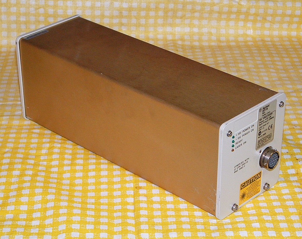

Sample Photos - All the lasers are in the same excellent condition.
Please note that these lasers have the gold one-piece metal shroud for a cover and there is no shutter wheel as it was removed in the original application. Other case styles may be available. :) (The cover and front plate can always be transferred from your defective laser if desired.) Standard metal feet are optional but will be included upon request.
