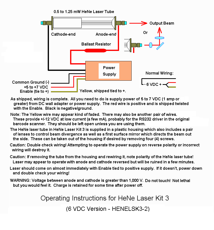

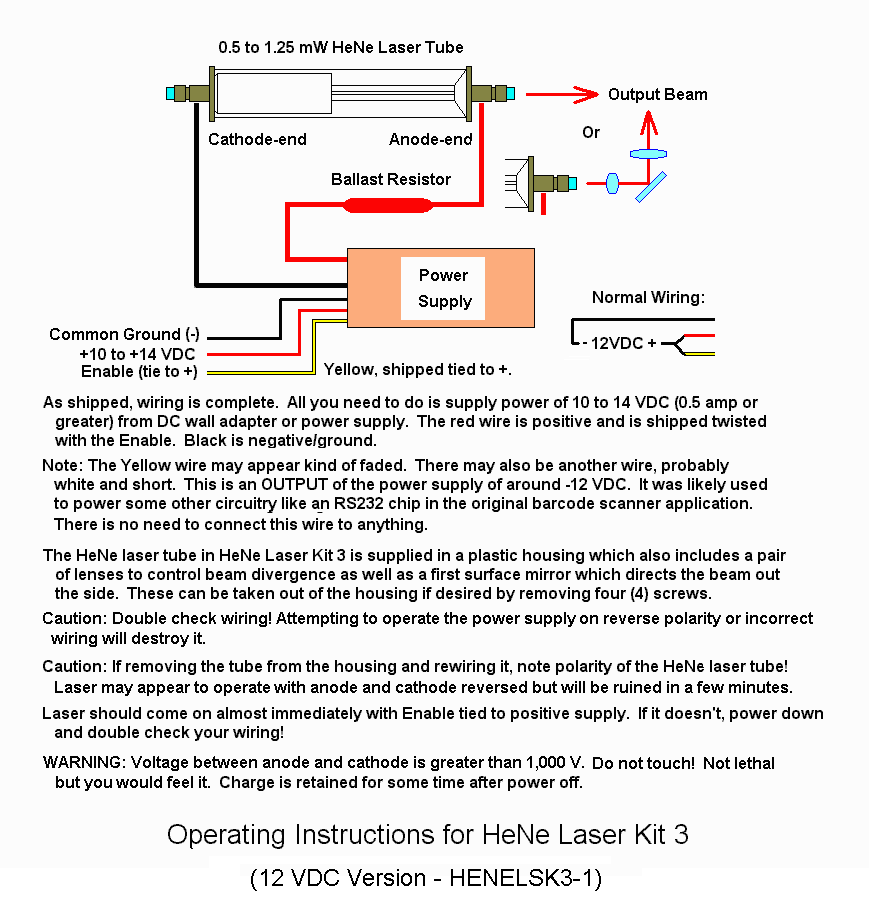

The low voltage wiring is as follows.
12 VDC version (HENELSK3-1): (See Operating Instructions for HeNe Laser Kit 3 - 12 VDC Version).
6 VDC version (HENELSK3-2): (See Operating Instructions for HeNe Laser Kit 3 - 6 VDC Version).
CAUTION: Double check polarity before applying power - reverse polarity may destroy the power supply.
CAUTION: If rewiring tube, polarity of high voltage is critical. Laser may appear to work with reverse polarity but will be ruined in a few monutes. Copper ring from ballast resistor must go to anode end of the tube which is the one that has the large glass capillary visible inside and where the laser beam emerges.
WARNING: Voltage across tube may exceed 1,000 V. The current is low so it won't be lethal but you will feel it and might drop the tube! :(
Note: The DC input doesn't have to be terribly well regulated but the peak current used by the power supply especially during starting may result in a flickering output if it isn't adequate. A large electrolytic filter capacitor (e.g., 10,000 uF) across the input may help with a marginal power supply. DO NOT let it continue to flicker as damage may result.
