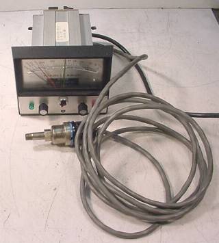

  • There may be potentially lethal high voltages on ionization gauges (hot filament, Penning, etc.), ion pumps, and other vacuum related equipment in addition to the deadly voltages likely present on any laser or other experimental apparatus! The power to mechanical pumps and other vacuum equipment should be attached in accordance with the National Electrical Code (USA) or relevant regulations in your country. All electrical equipment and accessible metal parts of the rest of the vacuum system should be connected together with thick wire and Earth grounded.

    The gauges are only about $250 for a new digital one, which is almost cheaper then buying or scrounging a used ThermoCouple (TC) gauge and these do wear out. You're better off looking for a digital capacitance manometer then an old beat up TC. (Of course I've acquired several complete TC gauges for less than $50 each complete and put one together for around $25 - the cost of the sensor - using junk parts. --- Sam)

    Vacuum Gauges
    Types of Vacuum Gauges
    Some means of determining the precise level of vacuum is perhaps not totally essential but certainly highly desirable. Otherwise, whatever you do is like a shot in the dark. The old 'thumb over the hole' trick really isn't precise enough!

    Thermocouple Vacuum Gauges
    Thermocouple (TC) gauges operate at the lower end of the range in which we are interested. The most common ones provide useful readings between 1 Torr and 1 milliTorr (1 micron) though some go as high as 100 Torr and as low as 0.1 micron (but not with the same sensor). However, the "best sensitivity" range may be somewhat less as each end is a bit squished. The TC gauge is among the most widely available, especially on the surplus market or eBay. However, keep in mind that a good deal on a controller isn't that great if you have to pay full price for the compatible TC gauge tube (sensor). It seems that when vacuum systems are dismantled, the tubes are often neglected and remain with the plumbing. TC gauges with sensors tend to go for about $50 to $100 on eBay, somewhat more from used vacuum equipment companies. The meter and electronics alone (without a sensor) may go for only $10 or less on eBay depending on model, condition, and luck. :) However, when considering a unit in "as-is" condition, try to get the seller to at least test the meter (instructions can be found below). That's the part that unique with its specially calibrated scale and possibly high (mV) sensitivity.
    It is possible to build a TC gauge (readout) for next to nothing with parts from a reasonably well stocked junk drawer but the sensors are still costly (by scrounger standards) and the effort - despite the simplicity of the circuitry - may not justify the money saved. See the next section for my experience doing this. The article: Building a Thermocouple Vacuum Gauge also includes information on a home-made version which can be constructed inexpensively. It also mentions the Pirani and thermistor gauges, which operate on similar principles.
    Specifications of Teledyne Hastings Thermocouple Vacuum Gauge Tubes
    Teledyne Hastings manufactures one of the most popular line of thermocouple (TC) vacuum gauges and controllers. See Teledyne Hastings Vacuum Instruments. (A gauge is just a readout; a controller has adjustable set-points to activate other equipment, alarms, etc., based on pressure limits. Note that in what follows, I use the term "control unit" to refer to any electronics that goes with the TC gauge tube to implement a basic TC vacuum gauge, usually an analog meter movement or digital display, and a small amount of circuitry.) The operation manuals for Hastings gauges and controllers may be found on the Hastings Vacuum Manual Page. (If this link dies, they may be found by going to any of the relevant product pages and clicking on "Manuals".)
    Basic information on the Hastings TC sensors (they call these "thermopile sensors") may be found on the Hastings Vacuum Sensors Page. The chart below has the functional specifications for many Hastings models. Duniway Stockroom sells some of these under their own model numbers. Other manufacturers like Varian and Veeco may have equivalents.
    There are two common types of Hastings TC gauge sensors: Those using an AC heater with a single thermocouple requiring a bridge circuit for readout (the majority including the DV-3, DV-4, DV-5, DV-6, and DV-8) and those with the heater and outputs combined (DV-23 and DV-24). The first group bring out a single connection for the thermocouple which is referenced to both ends of the heater. I currently do not have detailed information on the DV-23 and DV-24 group except that they are used with Hastings' "Economy" line of vacuum gauges and controllers despite appearing to have more sophisticated construction with a slightly wider useful range at the high end than the DV-3/DV-6 and DV-4, respectively. If anyone has such info, please contact me via the Sci.Electronics.Repair FAQ Email Links Page. (A third type of TC gauge sensor using either an AC or DC heater with a pair of wires for the thermocouple is used by manufacturers like Varian and Veeco.) Some older samples of the DV-3M, DV-4D, DV-5M, DV-6M, and DV-8M may not have the letter suffixes but are electrically equivalent (e.g., DV-8 instead of DV-8M). The two sets of DV-4s are not quite identical but are close enough that they may usually be used interchangeably in a given system requiring only a slight adjustment of heater current. There is also a DV-100 with a useful range from 0.1 to 100 Torr used with the NV-100 controller but I haven't found info on this other than the Hastings NV-100 Operation Manual.

    Simplest Hastings Thermocouple Gauge Readouts
    These basic units consist of a zener regulated AC source, a stepdown transformer, the TC gauge tube, and a DC millivoltmeter. That's it! Older units may use a small Sola constant voltage (ferro-resonant) transformer for regulation rather than zeners but are otherwise similar. While newer higher quality systems usually are based on a transistor oscillator fed by a well regulated power supply, and possibly an op-amp to condition the thermocouple output, for many applications, this isn't essential. Given the inherent lack of accuracy of TC vacuum gauges, the improved stability may not make much difference.
    The schematics in Simplest Hastings TC Readouts show the entire circuits for systems using the two types of Hastings TC gauge tubes with zeners for regulation. Except possibly for some part values, the AC line circuitry is identical for all versions. The stepdown transformer runs on a 16 VAC (or other) low voltage input and produces the several hundred mVAC needed for each type of TC gauge tube. The meters are specially designed to have a very low coil resistance to match the full scale output voltage of the TC gauge tube (2, 10, or 13 mV depending on model). Normal meter movements will not work here which is why other manufacturers often use an op-amp circuit to provide amplification.
    More modern versions of VT readouts use a two transistor oscillator to power the TC gauge heater. Line voltage is preregulated by a resistor followed by a surge suppressor to clip the peaks of the AC cycle, then half-wave rectified and regulated down to 6.8 VDC with a zener diode. A typical schematic (courtesy of Teledyne Hastings) for both the VT-4 and VT-6 is shown in: Hastings VT-4/VT-6 Readout Circuit and in the next section. The VT-5 should be similar except for a 2 mV instead of 10 mV meter (or amplifier).

    Repairing a Hastings VT-4B Vacuum Gauge
    The following applies generally to older thermocouple and other similar devices like Pirani gauges. As long as the heart of the unit - the actual meter movement and scale - is in decent condition, everything else can be easily and inexpensively repaired or replaced. Though only you can decide if the time and effort will be worth it, the circuitry is usually so simple and nearly everything is very non-critical, so troubleshooting usually ends up being a rewarding experience. Common problems with older electronics in general are dried up electrolytic capacitors, bad connections, deteriorated wiring, and corrosion if used or stored under damp conditions. The main precautions to take are to avoid blowing out the meter or TC gauge tube heater with excessive current - even measuring their resistance with an analog VOM on the low ohms range may be fatal.
    I picked up this unit for $16 including shipping (just the readout unit, no tube). I'm not sure why almost no one else was interested in it. Although old (early 1980s probably), only the case style is really different in newer models. The VT-4B runs on 115 VAC. It uses a DV-4D TC gauge tube and has a useful range of 0.1 to 20 Torr so it is for the upper end of medium vacuums. The schematic of the VT-4 (courtesy of Hastings) is shown in: Hastings VT-4/VT-6 Readout Circuit. (The VT-4B simply has the VT-4 readout installed in a metal case with power switch and power indicator.)
    This is actually my second TC gauge using a DV-4D tube. When I worked on repairing this unit, I didn't yet have a TC gauge tube for either but was able to look at the heater drive signal with an oscilloscope and inject a low DC voltage to simulate the thermocouple output to test the meter and amplifiers, if any (in this unit there are no amplifiers for the meter). What I saw on the scope was significant 60 Hz modulation of the 4 kHz signal. (It seems that no two TC gauges ever use the same drive frequency!) Figuring that this was due to dried up electrolytic capacitors, I opened the back of the meter (all the circuitry is on a printed circuit board inside a metal cover). There were a grand total of two (2) caps (one for half wave rectified line voltage and the other for the low voltage derived from it - 4 uF at 150 WVDC and 20 uF at 10 WVDC). Both tested bad on my ESR meter. Replacing them with slightly larger values from my used but tested stock, totally cleaned up the drive signal which was a bit over 0.3 V p-p, just about right for the DV-4D TC gauge tube (there is an adjustment of this if needed).
    Next I connected a 9 V battery through a 1000:1 voltage divider to test the meter. This worked fine but I noticed that the mirror behind the scale on the meter face had the measles. :( Corrosion apparently. Being a perfectionist in these matters, I disassembled the faceplate of the meter and removed the scale. The mirror is actually just a thin piece of chrome-plated sheet metal taped to the back of the scale. Shifting its position down slightly exposed a much nicer surface. (Note that any work inside the meter case should only be done in a clean location and tools should be non-magnetic to prevent ferrous particles from being sucked into the meter's magnet as these are very difficult to remove.) I also replaced the line cord which had seen better days. :)
    Now all I need is a DV-4D TC gauge tube! Actually, I do have what appears to be a DV-4AM (no label but the base is Hastings blue and it shows roughly the correct resistance between pins 3 and 5 with another connection on pin 7) which came (incorrectly) attached to a Kurt J. Lesker TCC-220 vacuum gauge controller so I will try that. Though the DV-4AM and DV-4D have slightly different heater requirements, they should be generally interchangeable requiring only a slight increase in heater current. Indeed, the DV-4AM seems to work fine after a small adjustment. I still would like to find a DV-4D for this or my other gauge (which I also tested with the DV-4AM).
    Later, after noticing that the line regulation of the simple zener circuit wasn't that great, and in addition, the reading was drifting as the gauge heated up, I replaced the AC input circuitry with a low voltage power supply consisting of a 12.6 VRMS centertapped transformer, full wave rectifier, filter capacitor, and LT1084 regulator set up for 6.0 VDC, which was slightly less than what I measured across the zener but the adjustment pot had plenty of extra range and that allowed me to use a transformer I had gathering dust on my transformer shelf. I also added a 1 A fuse for the AC as there was none originally. There was plenty of space in the box for everything. Performing a similar upgrade on any Hastings TC gauge where only a zener is used (usually where all the circuitry is inside a metal can on the back of the meter) would probably be beneficial.
