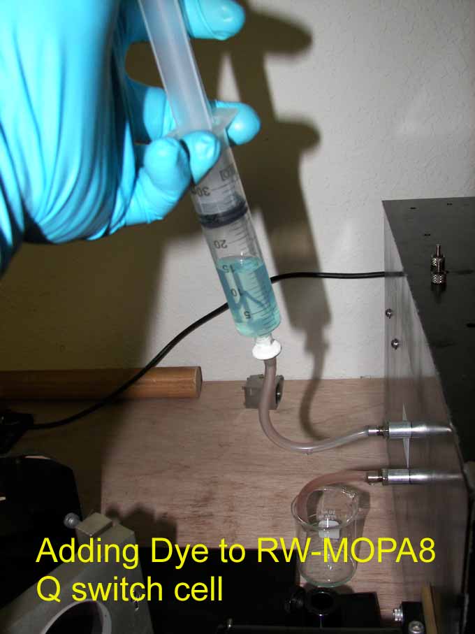

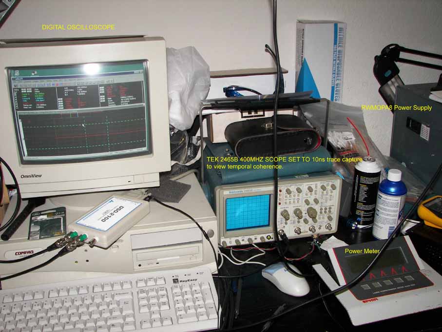

Adding dye/ethanol to q switch and monitoring with oscilloscope to make sure single pulse before a hologram session and the output energy level is verified.dyecell.jpg

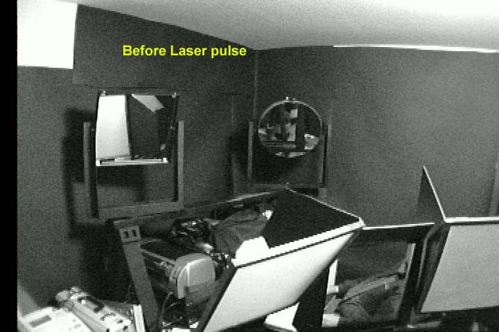

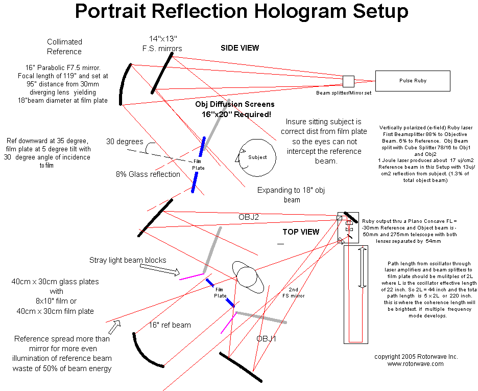

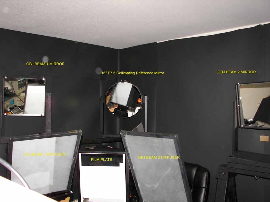

Setup with new 16 inch paraboloid mirror. At F7.5 and 119.84 inch focal length the overall path lengths were measured at 156 inch for the reference beam and 157" for the object beams. mirrors.jpg

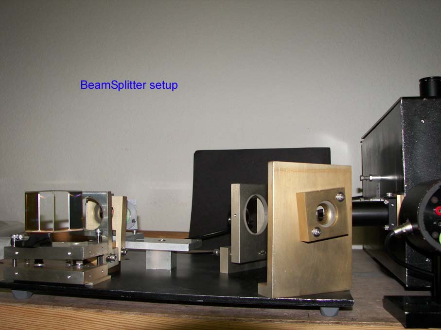

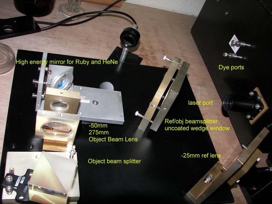

New configuration of beam splitter uses first beam splitter for ref and obj and second BS for obj split. The beam splitter setup was designed to insure a good reference beam quality by using only a single surface reflection and adding versatility to the beam ratio ability by inserting various lens which changes the beam ratios to improve fringe contrast. The target ratio was set to a 3/2; reference/object intensities .

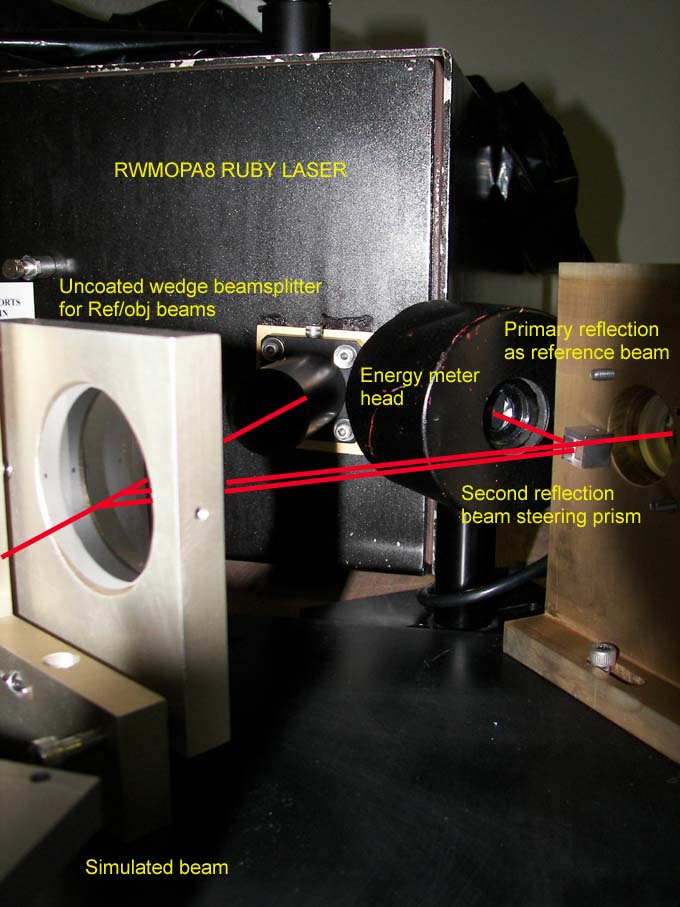

Picture of energy meter sampling of output beam. Secondary reflection from reference splitter is caught instead of wasted to allow energy output measurement. beamsamp.jpg

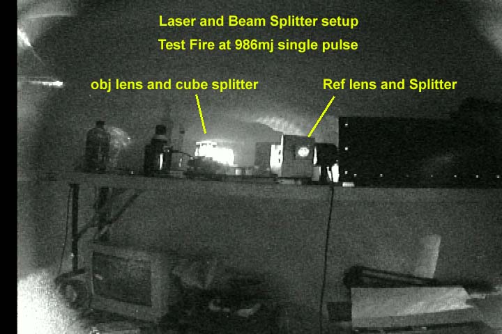

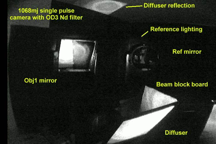

Picture of laser firing though beamsplitter setup using ccd camera with OD3 neutral density filter. testsplit.jpg

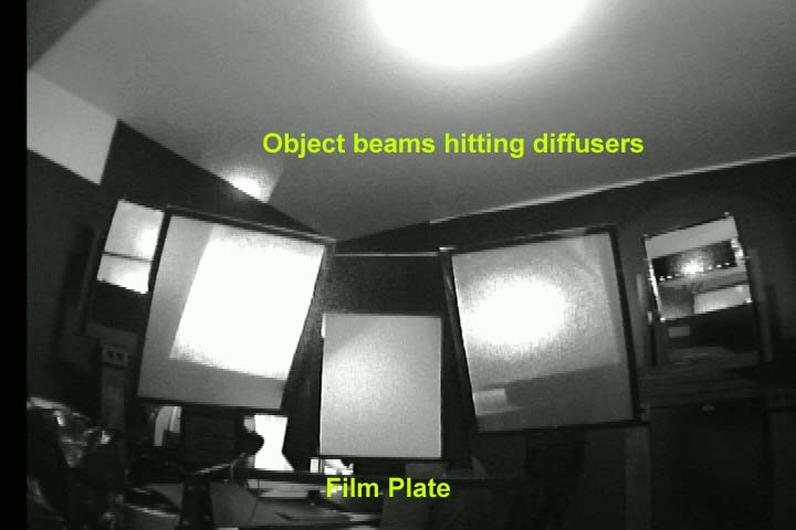

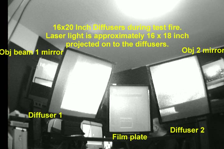

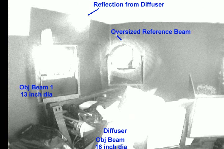

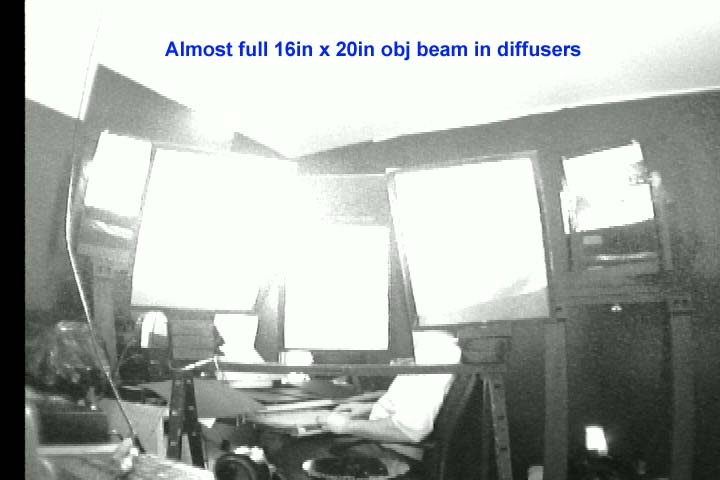

Diffusion screens during a test fire of the holographic setup.

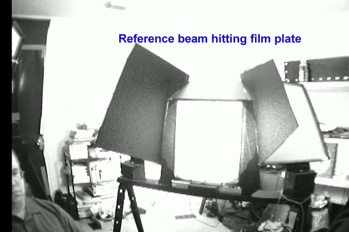

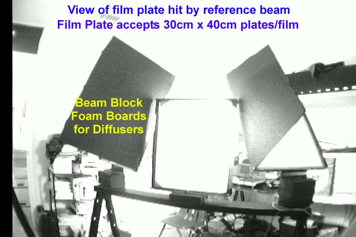

Image of reference beam at film plate with lower power to better visualize coverage. ref2.jpg

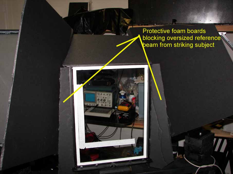

One technique used to shield subject from the reference beam is asking subject if they can see a red light through the film plate is the hene alignment beam source and the stool is raised until they are not able to see the source light. Based on distance from film plate and height the reference beam should not be able to be seen. The beam boards will block any chance of the beam over reaching the film plate and hitting the subject. In order to fill a 30cm x 40cm film plate the reference beam is set to 18 inch diameter. bref.jpg
Even though the laser operates in single frequency mode and the coherence length should be around 3-6 meters or better, the path length differences between obj and reference should be less than half for best result. Also based on the oscillator resonator length the ideal distance of 2L was calculated so that the maximum intensity of the interference fringe on the plate would be closer to the 2L multiple path length, if a second mode should develop. The worst case would be odd multiple of L path length. In this case the path lengths were brought closer to the 10L where L was 22.42 inches of effective resonator length. 10L was 152.58 inch beyond the laser since amplifiers and other beam mirrors inside rwmopa8 made for an additional 71.62 inch laser internal path length. A Tektronix 2465B analog 400mhz scope was used to analyze the pulse shape to see if mode beating occurred. It was found to only occasionally develop a second mode based on clean pulse modulation harmonics present on the pulse envelope. With two modes and L length of 22 inches, this would mean that the coherence length at most would drop to 22 inches. If the second mode was at the same intensity but instead was found be no stronger than 50% of the fundamental mode and generally around 5% of the single mode amplitude. 80 percent of the test shots showed no pulse envelope modulation indicating single mode laser shots.
The ruby rods were setup with c plane horizontal so the output is vertical E field polarization this means S polarized for beam steering mirrors inside the laser and for beam splitters and mirrors. This is how normal optical bench type setup can be done to minimize the polarization angle of the two beams arriving at the film plate since the beam arrive in a S polarized orientation. The main object mirrors and reference paraboloid mirror in this setup are tilted downward and the vertical polarized beam is now a P polarized beam due to the now vertical (downward steering of the beams) and the angles will effect the fringe maximum. Unfortunately this setup has both horizontal and vertical beam steering. So one could evaluate which polarization orientation would produce less possible angle between object beam and reference beam. The laser was built with vertical laser polarization and was kept as default but noted as an issue of concern. Calculations in this setup with a general idea of 25 degree P polarized incidence of the reference beam to the film plate and the film plate at a 5 degree tilt toward the subject, 25-5 = 20 degrees polarization angle and the fringe visibility due to polarization was calculated in excel as =cos(20*pi()/180) or about 94 percent.
Beam splitter 1 used a clear wedge window for reference with a calculated uncoated S polarized at 30 degrees of about 6 percent. Secondary surface 6 percent was blocked Care was taken to make sure any secondary reflections were blocked and additionally the laser and splitters are mounted overhead.
Additionally the setup allowed different lens to be used for object and reference beams to control beam ratio intensities. The reference beam was spread further to give more even illumination.
The object beam was fixed with a -50mm and 275mm telescope at 54mm separation with some adjustment to separation.
The following reference lens gave these results:
-25mm below 1 to 1 ratio as measured at film plate.
-30mm around 1 to 1 ratio
-38.6mm around 3 to 4 to 1 ratio.
Two Thorlabs DET210 detectors with ND filters and a digital storage oscilloscope were used to record the beam intensities and ratios in the setup. test.jpg

Diffusers at 127 inch with 16inch spot size.
Diffuser to subject was 13 inch and then 12 inches to the plate
Reference lens to paraboloid mirror was 94 inch, which is below the 119 inch focal length to yielding a slight diverging reference beam. Reference beam size at film plate was 18 inch.
