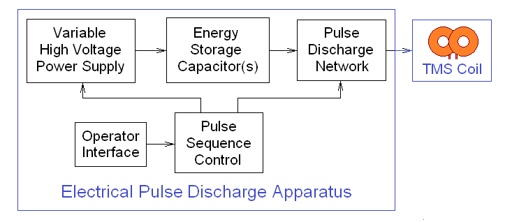

The greatly simplified organization of a typical TMS device is shown below.
There are two separate sub-systems that need to be optimized to work together:
The electrical parameters of the energy storage capacitor (C) and TMS coil (L) interact so that, for example, increasing C also increases the pulse duration while increasing the number of turns of the TMS coil (to boost the magnetic field) increases L at approximately the square of the number of turns (N) and thus also increases the pulse duration (T0). The relationships of some of the key quatities are shown below:
These are NOT equations for the specific quantity, but rather how it changes as a function of each, variable with all the others held constant regardless of how impossible that might be. So, for example, doubling N quadruples L.

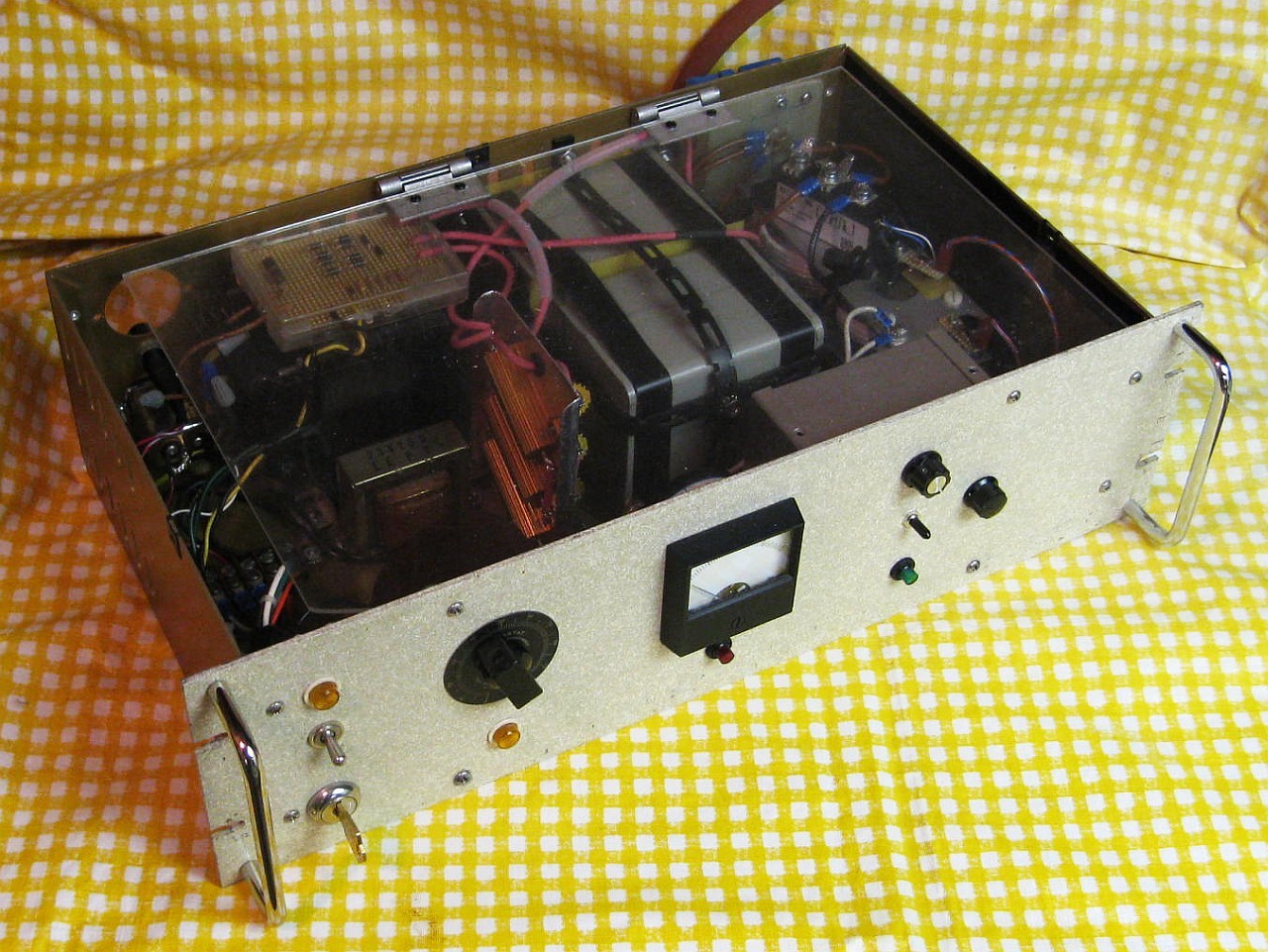

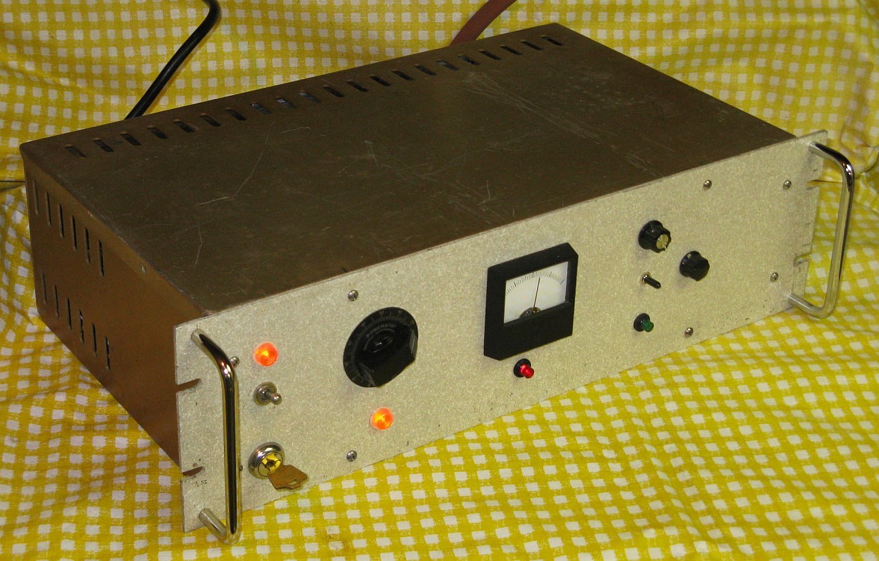

Front View of Complete Unit (Ver. 1)
On the top left is the main power switch and indicator and below that the high voltage keylock switch. The timing circuits are enabled with main power so that the repetition rate can be set. Running without high voltage enabled but with charged capacitors is possible.
The Variac controls the high voltage from 0 to approximately 1450 V on the capacitors. The meter and red LED below it show the charge on the capacitors.
The knob to the right of the analog meter (!!) sets the pulse rate from approximately 1 pulse every 2 seconds to 10 pulses per second. The meter monitors the high voltage and is optimized for transient response. The switch below it selects free run (up), off (middle), single shot fire (down, momentary). When used in this mode, the pulse repeat rate is still limited by the setting of the pulse rate control. The green LED flashes with each pulse.

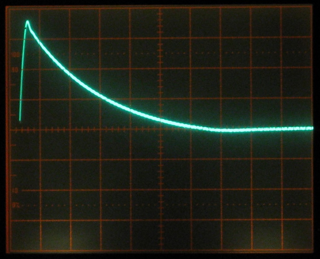

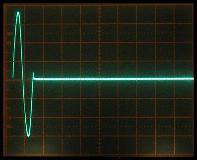

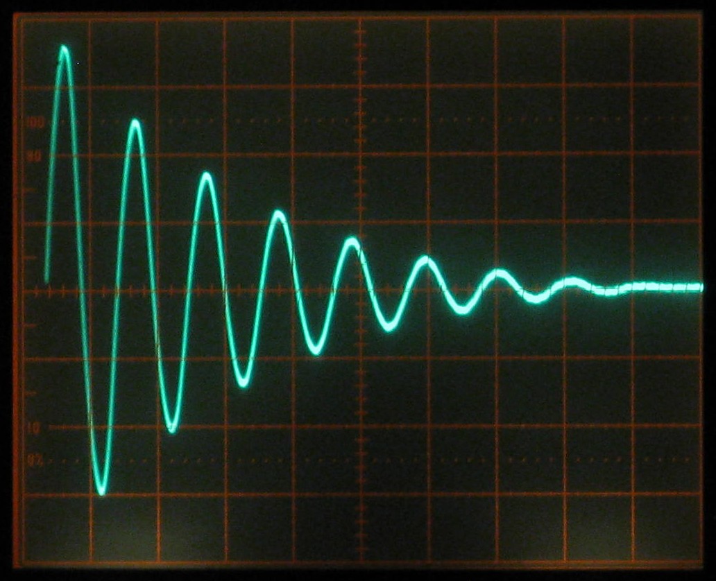

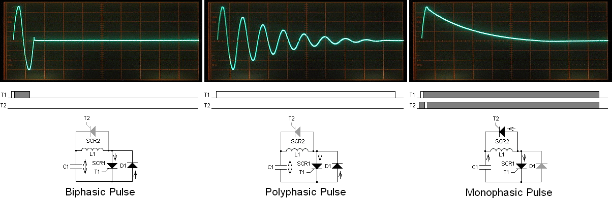

The knob on the far right selects the pulse type: biphasic (CCW), polyphasic (middle), monophasic (CW, if implemented).

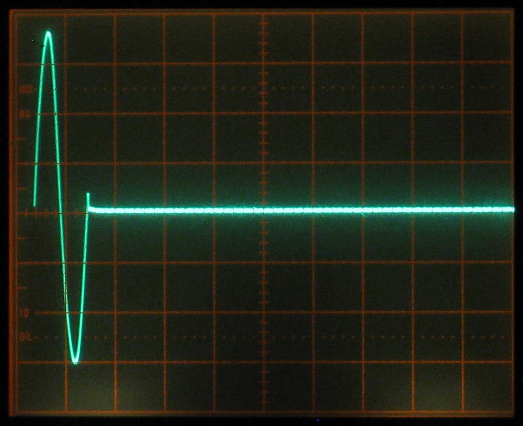

Typical Waveform of Pulse Types: Biphasic, Polyphasic, Monophasic
These waveforms in the photos used a coil with an inductance of approximately 34 µH (Sam #2) with the original (Ver. 1) energy storage capacitors (25.4 µF total) resulting in a frequency of ~6.1 kHz or period of ~164 µs. With Ver. 2 having a capacitance totaling 166.7 µF and a 10.8 µH coil, the resulting frequency is ~3.75 kHz or a period of ~267 µs. But their appearance is similar except that the monophasic has not been implemented in Ver. 2.
The positive half-cycle is through the primary SCR. The negative half-cycle is through its associated parallel diode. The little blip at the end is believed to be due to the reverse recovery time of the primary SCR. (More below.) With another coil of only 10 µH, the damping factor ended up being slightly lower resulting in a more extended decay of its ~10 kHz oscillation.

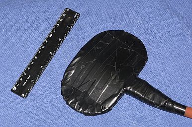

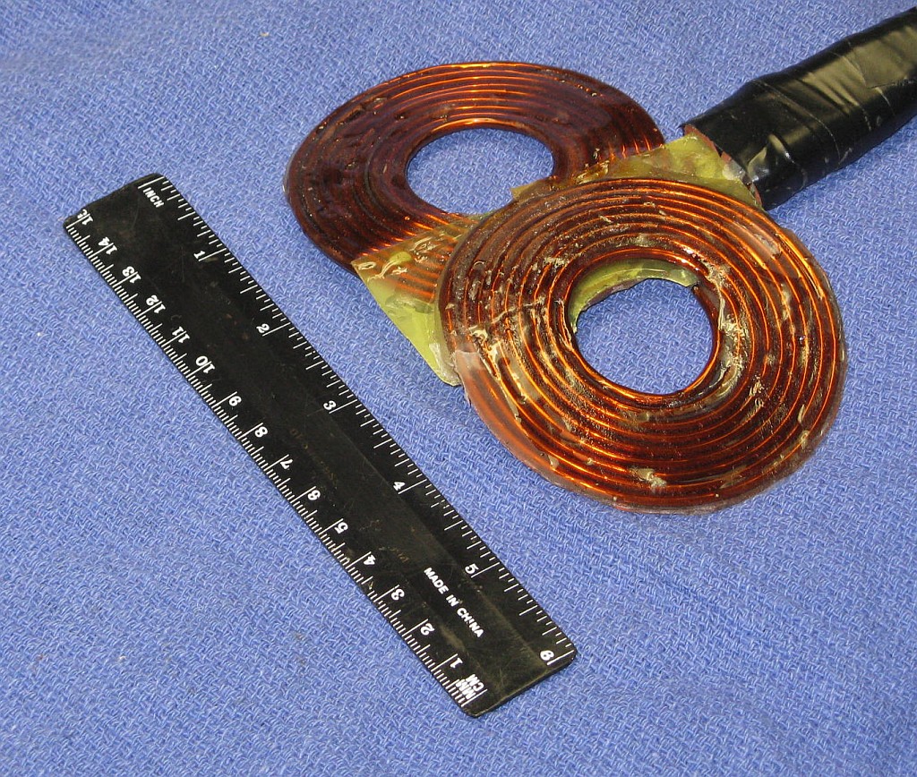

Descriptions and photos of all of the author's coil attempts to date may be found at Sam's TMS Coils. Most of them are somewhere between unsuitable and quite laughable for TMS. :( :) However, most of the air-core coils would be useful for peripheral nerve stimulation and probably have other applications. Some of the smaller coils are capable of an impressive dB/dt and have better localization than the large ones.

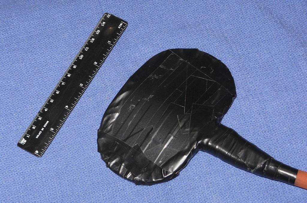

The final coil constructed to date (called "Sam #13") is a slightly smaller version of a design based on the Medtronics/Magventure B70, which uses a pair of overlapping pancake coils rather than thicker coils sitting side-by-side. Coil winding parameters and biphasic pulse duration were found from the literature and the Magventure Web site. From these, an estimate of the value of the energy storage capacitor(s) in their system could be made. The next coil planned called Sam #14 would be similar, but to be constructed from thick-wall 3.2 mm (0.125") OD copper tubing with an oil-to-air heat exchanger to permit continuous operation at maximum energy and repetition rate. Its completion date is unknown and possibly unknowable. :)
Sam #13 coil specifications
Sam #13 Coil: Design, Before Final Insulation, and Ready for Use
It's not as scary as it looks. Sam #13 was fabricated by first hand-forming the #8 AWG high temperature magnet wire of the two sections of the figure-8 to approximate dimensions. They were then clamped together in a wooden jig via only the center portion along with a 0.02" Fiberglas-Epoxy insulating panel (thin PCB board material) sandwiched between the wire in the overlapped region (visible in the center photo, below) and thin plastic sheets top and bottom to prevent sticking to the wood of the jig. (The photos for Sam #9 at Sam's TMS Coils show a jig similar to the one used in the fabrication of Sam #13.) The wire position and symmetry in each winding could then be fine tuned before filling with two-part Epoxy. After setting, it was removed from the jig, the wings were formed. and the cable wiring was attached. Then a similar 0.02" thick Fiberglas-Epoxy insulating panel cut to be slightly oversize was added underneath and non-acidic RTV Silicone was added for additional insulation, after which another matching Fiberglas-Epoxy insulating panel was placed on top with both formed to hug the coils. The edges were then filled with yet more RTV and Epoxy, covered with 0.001" Kapton tape, and finally the entire assembly was wrapped in multiple layers of black electrical tape.
No, I don't own stock in a company that makes adhesive products. ;-) The extensive filling with Epoxy and RTV is not only for electrical insulation but to make the entire structure essentially monolithic to suppress intra-winding movement which would eventually destroy the wire insulation, as well as to minimize the "woodpecker" sound and vibration resulting from the rapidly changing magnetic field from each TMS pulse.

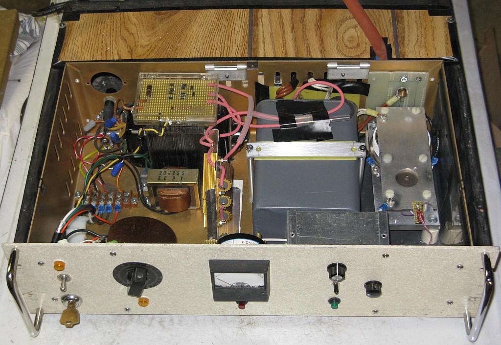

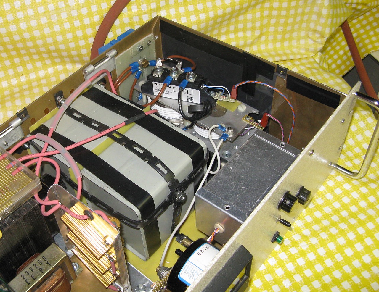

Interior view with Plexiglas Safety Cover in Place (Ver. 1)

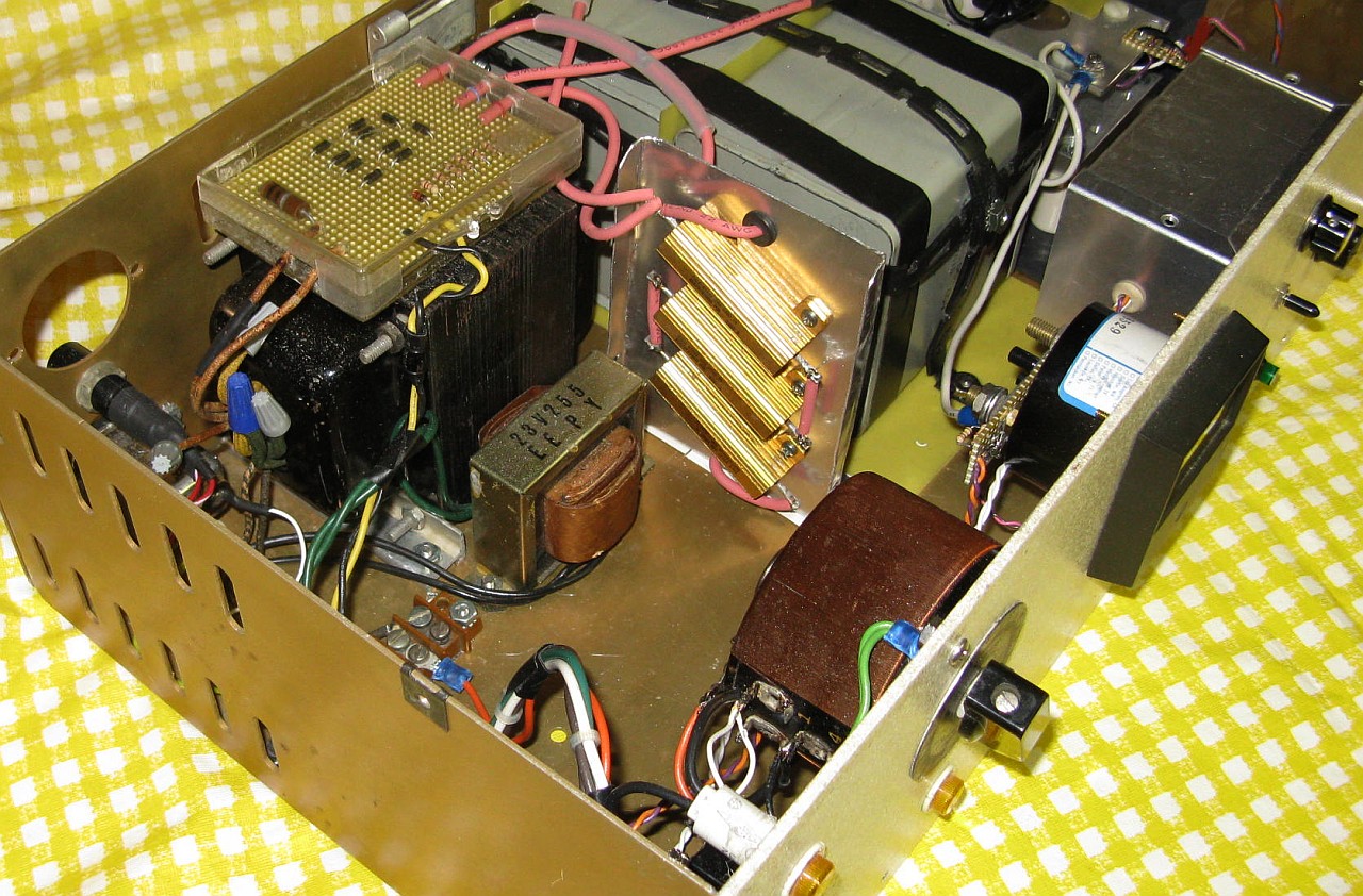

The high voltage power supply uses the power transformer from a large 1950s vintage black and white tube-type TV and is controlled by a Variac. :) The transformer has multiple line voltage taps and is set to produce the highest output voltage. The otherwise not very useful 5 V and 6.3 V filament windings are also connected in series with the primary with reverse polarity to further boost the output voltage. The transformer hums a bit at maximum input with the Variac producing 110 percent of line voltage, but doesn't get even detectably warm after a few minutes so it can't be too unhappy with little or no core saturation. Its HV main output goes up to approximately 1,050 VRMS. A bridge rectifier consisting of 4 series pairs of 1N4007 diodes feeds the main energy storage capacitor via a 1.05K ohm 150 W series resistor bank resulting in a maximum voltage on the capacitors of around 1,450 VDC. The resistor bank both limits the current from the transformer and provides isolation during the discharge to maintain a low damping factor.
Closeups of: Power Supplies, Energy Storage Capacitors, Pulse Discharge Network, High Side SCR Trigger (Ver. 1)
A voltage divider feeds the meter with a peaking circuit to improve response time. The red HV LED is driven from an emitter follower with an identical LED serving as a voltage regulator to linearize the response. The voltage divider is mounted along with the high voltage bridge inside a plastic box for insulation. The monitor circuits are attached to the back of the meter.
A separate 12 V transformer powers the logic and SCR drivers.
The controller and its power supply are housed in a shielded Minibox. Whether the shielding is really needed is not known, but there was no point in taking chances with multi-kA pulses floating around. :) (Even so, there is often a spurious pulse generated when switching the HV off.) The power supply provides regulated 12 VDC using AC from the small transformer mounted on the chassis. The "logic" consists of a pair of 555 timers. :) The first generates the clock for continuous (approximately 0.5 to 10 pps), or single shot. It's output drives the Pulse LED and the 555 for the SCR trigger with a pulse width determined by Pulse Type: around 50 µs for the biphasic pulse type; 2 ms for the polyphasic and monophasic. These values should work over a wide range of coil inductances.

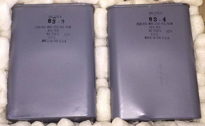

The main energy storage capacitors (Ver. 1) consisted of a pair of 10 µF (labeled), 1,500 V pulse discharge capacitors in parallel. Their actual capacitance was measured to be 25.4 µF.
Two high current SCRs and a high current diode are used to create the three pulse types. The "hockey puck" style devices visible in the second photo from the left were way over the top for Ver. 1 in terms of what was required with the relatively small energy. :) These are for the main pulse discharge. The ratings of the SCR are not known. It was acquired on eBay for $22 delivered described as an 800 A at 1,800 V unit, but these ratings are suspect, not because it doesn't work based on them, but because the closest datasheet Google has been able to locate shows a dramatically lower voltage rating, and by all rights, it should have blown up at well below the 1,450 V used here. (Happily, I had not seen that datasheet when first building this, basing my decisions on the eBay listing! More below.) The diode is spec'd at 1,500 A and 1,800 V. An SCR in the smaller IXYS unit on top implements the free-wheeling discharge path for the monophasic pulse (Ver. 1 only, removed for Ver. 2.). It is only rated at around 100 A and 1,600 V but for low repetition rate pulses, it should be able to handle 30 times this or more. The same IXYS unit would work for the main discharge except that its turnoff time was found to be way too long to be able to select out only the single cycle for the biphasic. The eBay SCR turned out to be a high speed (inverter) type, so the puck had to be retained.

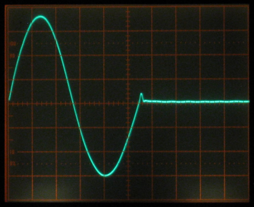

TMS Pulse Generation Timing
The T1 and T2 timing diagrams show drive to the gates of the two SCRs. The high level represents the gate drive being fully on, typically several times the spec'd IGT for the respective SCR. The gray areas denote "don't care" for the pulse level. (Note that to simplify understanding of these diagrams, the labeling of the components does NOT match what's on the full schematic below.)
All three pulse shapes start with the same 1/4 sinewave as shown in the expanded biphasic pulse below. The peak current is thus similar for all. T1 initiates the discharge and must be high long enough to reliably fully turn on SCR1. What happens after that changes for the three pulse types. For the biphasic pulse, T1 must go low at least tq (SCR1) prior to when the voltage across SCR1 (and the current through it and the coil) would go positive again. For the polyphasic, T1 remains high for the entire duration of the decaying sinusoid since SCR1 must be driven into conduction multiple times. But T1 must eventually go low to allow the energy storage capacitors to recharge. For the monophasic, T1 only initiates the discharge and its state doesn't matter after that. T2 must be high at least tgd (SCR2) prior to peak of the sinusoid. And T1 can remain high during the remainder of the monophasic because any current through SCR1 after the peak would increase the voltage on C1. So except perhaps for a couple volts, this simply won't happen because the the easier path is through SCR2. The state of T2 doesn't matter elsewhere during the monophasic, but it must be low for the other pulse types. (In the actual implementation of the monophasic, T1 and T2 are the same as T1 for the polyphasic.)
For SCRs to turn off, either the current through them must go below their holding current (IH) or the voltage across them must go negative. For the biphasic, the voltage reversal assures reliable shutoff of SCR1. This is also true for the polyphasic as long as T1 terminates before the oscillation has died out entirely. For the monophasic, the current being diverted through SCR2 accomplishes this. SCR2 shuts off once the current through it has decayed to below its IH. At that point, the voltage across C1 will be very slightly negative assuring that SCR1 will also shut off as long a T1 is low. (In principle, there could be a peculiar sequence of events whereby SCR1 doesn't shut off properly and there is enough current from the capacitor charger to hold it in conduction since it is not actively isolated discharge network. But this does not appear to have ever occurred during the lifetime of the monophasic's existence in this system.)
Biphasic Pulse Expanded on Scope Display

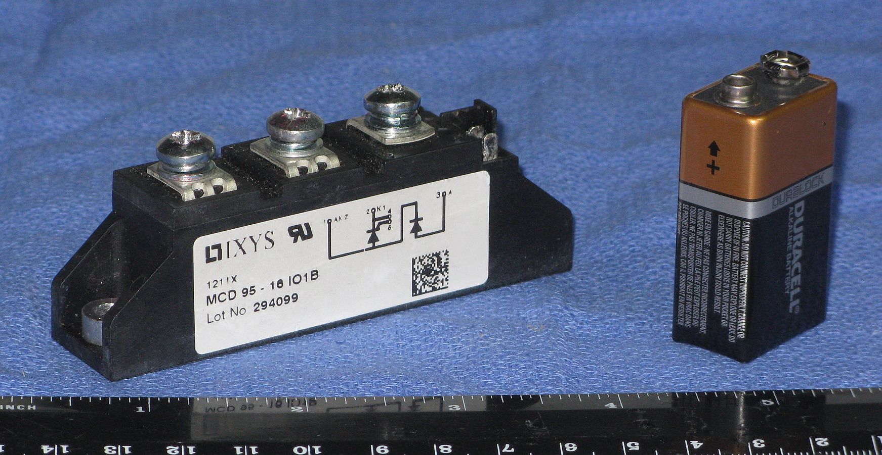

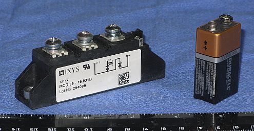

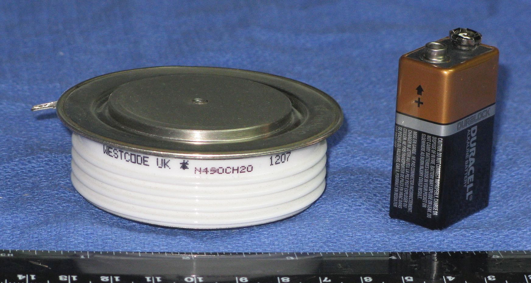

That free-wheeling SCR switch for the monophasic pulse turned out to be the most difficult to implement due to the requirement that its gate and cathode swing up to almost +/-1500 V with respect to the circuit common during the discharge. My first attempt using a home-built ferrite pulse transformer lasted about 3 shots due to insulation breakdown. Ferrite is supposed to be an insulator, correct? Nope, at least not this batch of cores at high voltage. A Westcode N490CH20 Hockey Puck SCR rated 2,000 V, 1,200 A average and over 18,000 A pulsed, that is almost 3 inches in diameter weighing in at around 1 pound was originally installed for the free wheeling circuit. It failed shorted when its gate circuit arced through the trigger transformer core. Remarkably, nothing on the low voltage side was damaged. And the primary hockey puck SCR and diode, which were then discharging into basically a dead short. also didn't seem to care. The first replacement switch was a combined SCR/diode block, a IXYS MCD95-16IO1B. While its current rating is about 1/10th that of the unlucky hockey puck, the low repetition pulse rating should easily be enough, hopefully. The companion high current diode was in series with the SCR (mainly because it was available), with a low current diode (a pair of 1N4948s in series) across the SCR so that the full reverse voltage would be taken by the large diode, hopefully reducing the turn-on time of the SCR. The core of the replacement trigger transformer has 2-3 layers of Kapton tape covered with Epoxy for insulation. :)
Westcode N490CH20 Hockey Puck SCR and IXYS MCD95-16IO1B
As noted, the IXYS devices was removed from Ver. 2 since (1) because there is little evidence that a monophasic pulse has significant general utility for TMS, and (2) because there would almost certainly be more difficulties associated with it at the much higher peak current.

Ver. 2 Energy Storage Capacitors
Interestingly, the damping factor with the larger capacitors is nearly as low as it was before the swap, so the original ones must have had a higher ESR. The ESR of the ~83.5 µF capacitors is almost unmeasurable using my meter - less than 0.01 ohm and much of that may be due to the capacitive reactance at the meter's test frequency, not resistance. The total effective system resistance now appears to be between 30 and 40 milliohms including the coil and cable (about 20 mohm total). And around 50 percent of the energy is recovered with the biphasic pulse.
Of course charge time is longer but so be it - for now. It's still near full energy at 1 pps. Coil heating is becoming more of a problem though. The latest coil (Sam #13) uses #10 wire but at 10 mohms dissipates 20-30 W at 1 pps. So the duration with continuous operation is limited to a few minutes.

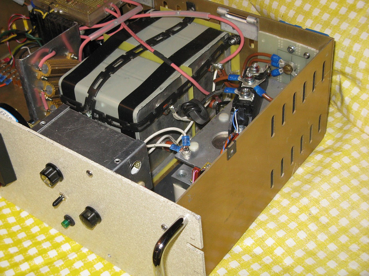

The photo below show the modifications. One of the two energy storage capacitors is visible. The other one is under the genuine imitation wood grain plywood cover at the rear. ;-) The higher current SCR for the monophasic has not been installed.
Interior view (Ver. 2)
The next coil (Sam #14) is planned to use 0.125" (3.2 mm) thick-wall copper tubing in place of magnet wire with the two pancakes wired in parallel to reduce inductance and boost dB/dt. A closed-loop cooling system will force transformer oil (to maintain electrical insulation) through the copper tubing and then through an oil-to-air heat exchanger (radiator with cooling fan). Here are the tentative specifications for Ver. 3 assuming other parameters for Ver. 2 are unchanged:

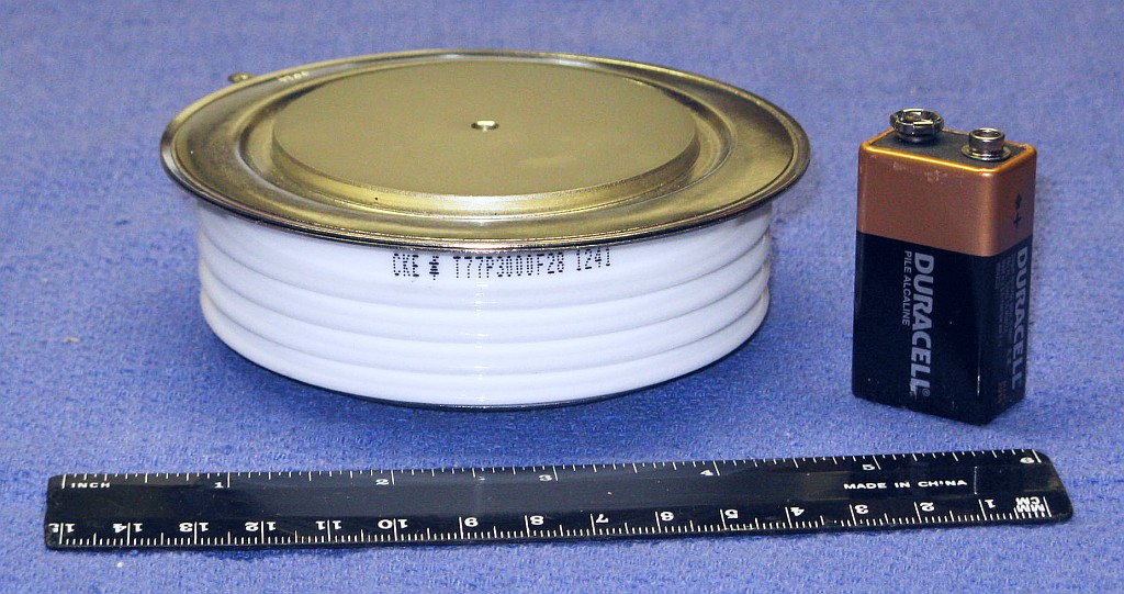

Ver. 2 has been running reliably at up to somewhat over 5,000 A but going higher is something I'd rather not risk with the poor "little" 387NX198 primary SCR assumed to be rated at around 500 A. Repetitive pulsed current ratings of SCRs are rarely given. And while when they are, they tend to be around 30x of the average maximum current (Itavg), there is no data on the 387NX198. SO, I found a couple of these at a bargain price on eBay:
CKE T77P3000F28 Monster High Speed SCR: 2,800 V, 3,000 A, tq=75 µs
The CKE T77P3000F28 is over 4 inches in diameter and weighs around 3-1/2 pounds! :) That's just a wee bit more massive than I had expected.
The target current is around 9,000 A to achieve a full biphasic cycle of 150-160 µs at 1,450 V and ~176 J into an inductance of 3-4 µH.
Perhaps the new SCR should handle anything even I can throw at it, space permitting! :) However, size is not everything. SCRs are at least as likely to die from issues with insufficient gate drive current or too short a drive pulse duration as excessive low duty cycle peak current. If something more reasonable can be found - closer to 1,500 A and 1,500 V with a tq of 75 µs or less - that will be used instead. :) If not, the 387NX198 may be asked to take the risk in the interest of science. :) Based on specifications of the assumed to be similar C387, it may just handle 9,000 A in a short pulse! At least the C387 datasheet does have some data for moderately short pulses, though not quite short enough.

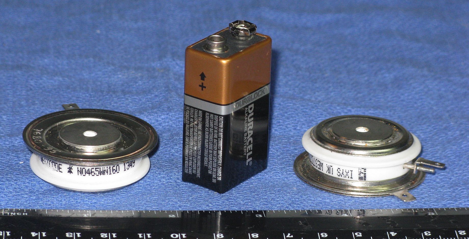

Another less extreme option is to use the Westcode (IXYS) N0465WN160. These are only about 1.5 inches across with a tq of 125 µs, maximum rated voltage of 1,600 V, average current of 465 A, and non-repetitive peak current of 5,000 A.
Westcode N0465WN160 Small Hockey Puck SCRs: 1,600 V, 500 A, tq=125 µs
