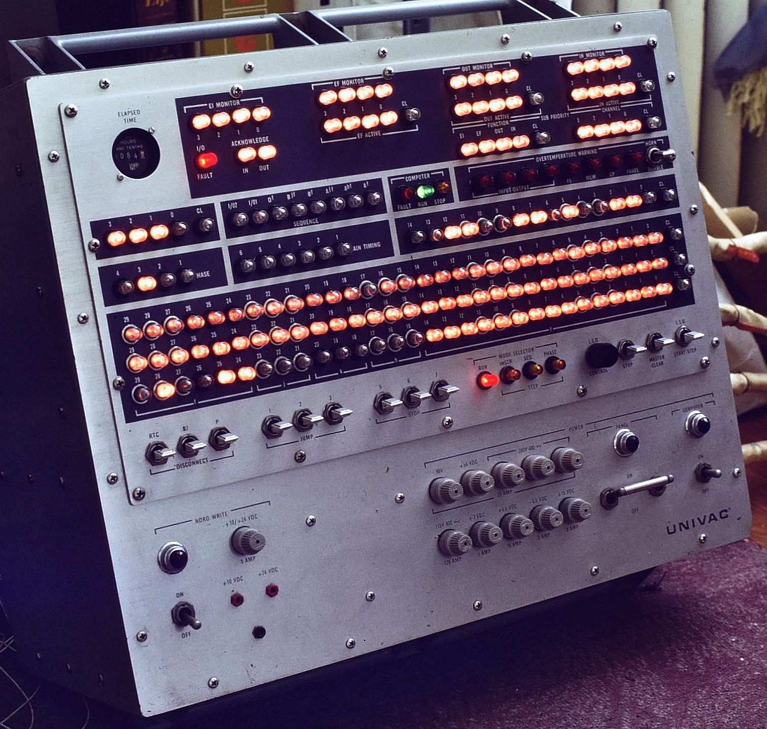

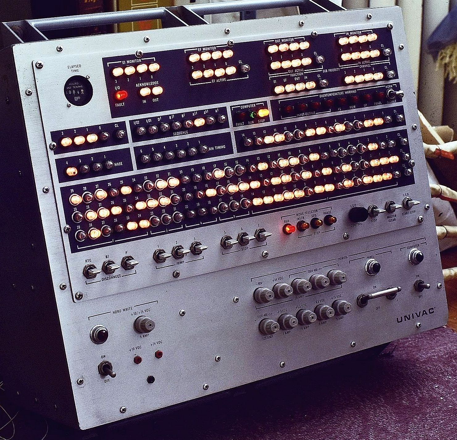

    The only visual record I currently have of the Univac 1830 are a pair of Kodachrome 35 mm slides taken in September 1978 of the operator's console powered up and connected to the CPU. Versions of these are also on the Wikipedia page, along with the photo of the eight massive electronics boxes comprising the 1830. What is not shown are two or three cartons of garden hose-diameter interconnecting cables and the reams of documentation including logic diagrams, schematics, and programming manuals. An archive of some of these may be found on Todd Thomas's Website, link below. However, not surprisingly, the super large "pink sheet" logic diagrams and schematics have not been scanned for obvious reasons. Too bad, they are the good stuff.
    The main core memory was known to be faulty when I acquired the 1830 in the early 1970s and repairing it was beyond my level of determination. But the console and CPU could be powered stand-alone, which was accomplished using a half dozen or more cobbled-together DC power supplies. Few if any were regulated! It was then possible to run complex ;-) single instruction programs like "Increment" from one CPU register operating on another one, entered via the rows of neon lights which also served as push-button bit toggles. That is probably what the running program is doing.
    Those neon indicators/switches were interesting in themselves. As I recall, they were powered by low voltage DC and each one had a miniaturized inverter to generate the greater than 90 volts required for the NE2-type neon lamps. Their state was directly controlled by the DTL logic levels which switched the inverter on and off.

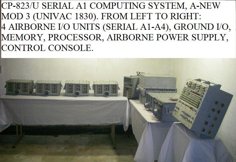

    The first two images are macro photographs of those slides taken in 2025 using a Nikkor DX Micro f/1:2.8 lens and home-built slide copy adapter. These may be the only surviving color photographs of a Univac 1830 in operation, sort of. ;-) Unfortunately, back in the 1970s, documenting everything with photographs was not something that was automatic and there were no smart phones in everyone's pockets. The third one is of the eight electronics boxes that comprised the 1830 taken by Todd Thomas, to whom I eventually sold the Univac 1830.
    Univac 1830 Operator's Console with Program Halted (left) and Program Running (center); Univac 1830 Electronic Boxes (right, from Wikipedia)
