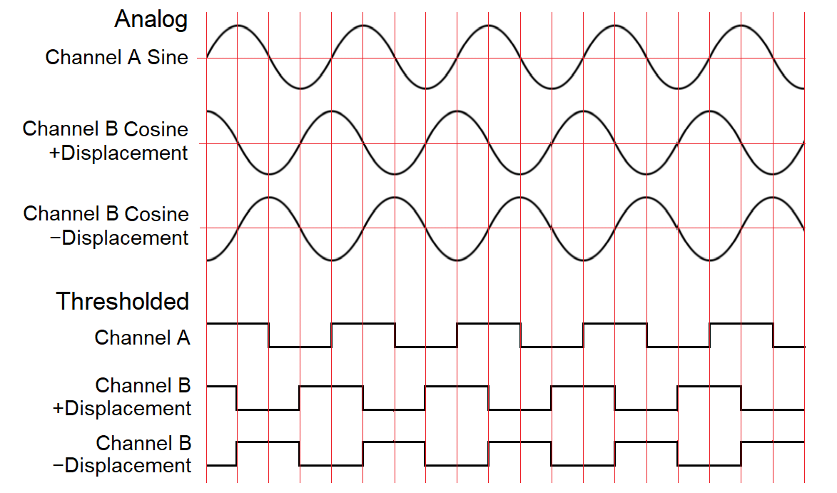

Rotary Encoder Digital Signals as a Function of Orientation
This shows a rotary optical encoder which uses a pair of LEDs and photodiodes physically offset by 90 degrees to generate Quad-Sin-Cos analog signals which are then thresholded to yield Quad-A-B digital signals. The specific type of sequence is called a "Gray" code (not based on color but attibutable to someone named Frank Gray) and has the property that any possible allowable change in value is a change in only a single bit. This eliminates the ambiguity with sensors using the normal binary order where two bits can change at not quite the same time.
(The annimated graphic seems to be all over the Web. If anyone knows who the original copyright holder is, I will acknowledge them.)

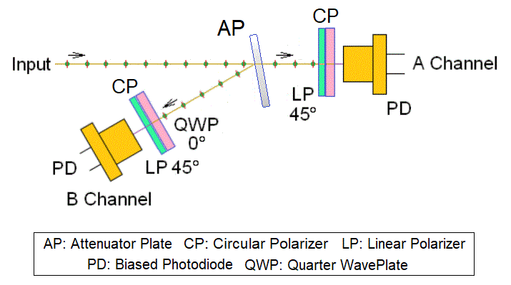

An interferometer with angled paths for the two interfering beams produces fringes similar to the pattern of an optical encoder so a quad detector could be built with offset photodiodes and this has been done in some ring laser gyros as well as stabilized HeNe lasers. However, more commonly, the 90 degree phase shift is done optically using a single combined beam as shown below. The Quarter WavePlate introduces a 90 degree phase shift. If resulting Quad-Sin-Cos analog signals are thresholded and converted to digital form, the result would be a Quad-A-B format.

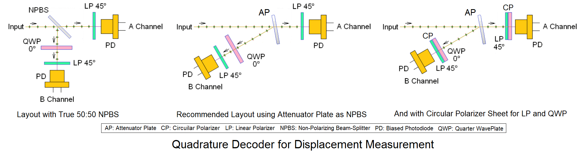

This shows variations on one of several common implementations for a Quad-Sin-Cos decoder that provides Sine and Cosine outputs for use in a displacement measuring system. This is among the simplest. In most instances, the photodiodes would be reverse biased to provide a linear response. Commercial systems will generally have a third "Intensity" channel to compensate for variations in detected power due to the laser aging, changes in alignment, and contamination over time. The Intensity channel can be implemented electronically or optically with a non-polarizing beam-splitter at the input and additional photodiode.
The purpose of the angled arrangement is to minimize the difference between the amplitudes of the two polarizations. Otherwise, with 45 degrees being close to the Brewster angle (around 57 degrees), one will be much larger than the other. Even so-called 50:50 beam-splitters may be subject to this, so using the angled arrangement for either one may be beneficial. There is an Attenuator Plate (AP) in these kit, which simplifies construction. Using the AP also permits the relative amplitudes of the Channel A and B signals to be mostly balanced without electronic adjustments.
Alternatively, the NPBS could be rotated 45 degrees with respect to the X and Y axes
The signal outputs from the biased photodiodes will be analog and close to sinusoidal. The relative phase shift betweem the A and B channels will be determined by the construction of the encoder or interferometer and the direction of motion. The graphic belows shows the specific case of a displacement measuring interferometer:
The photo shows the typical optical parts and photodiodes. The basic detector using a single photodiode like the DET110 can generate a signal corresponding to light and dark fringes, but cannot provide direction information, essential for using an interferometer in metrology applications. The Quad-Sin-Cos decoder provides a pair of outputs that are 90 degrees offset from each-other in position, similar to the outputs of a rotary or linear encoder:
Quadrature Detector using Variable Attenuator Plate and Circular Polarizer Sheets: Optical Layout, Parts, Built on Solderless Breadboard, Protoboard, and PCB

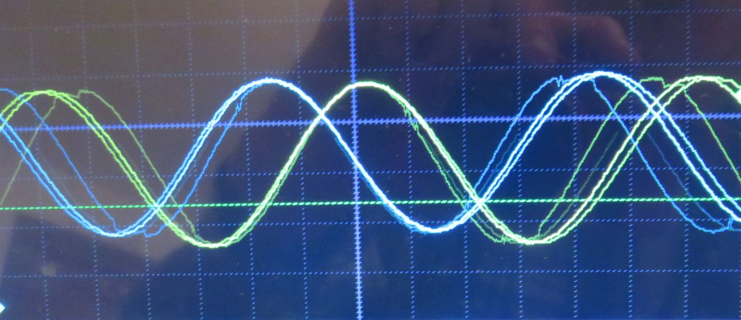

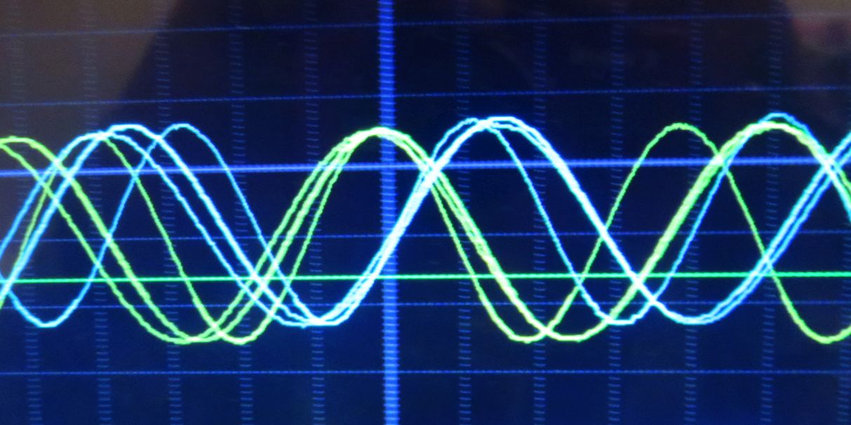

The ugly scope screen shots below shows behavior which is close to perfect:
Channel A and B Signals with Positive (Left) and Negative (Right) Displacement
Capturing a decent photo while twiddling the micrometer screw is quite challenging. ;-) But the conclusions are clear: This simple Quad decoder does its job well with a phase shift of close to ±90 degrees. If the Arm 2 mirror or retro-reflector were on an electronically controlled positioner like a loudspeaker voice coil or linear motor driven with a ramp, the waveforms would be textbook quality. ;-) With only a small stretch of the imagination, it can be seen that the screenshots agree with the expected behavior based on the diagrams, above. OK, perhaps not such a small stretch. ;-)

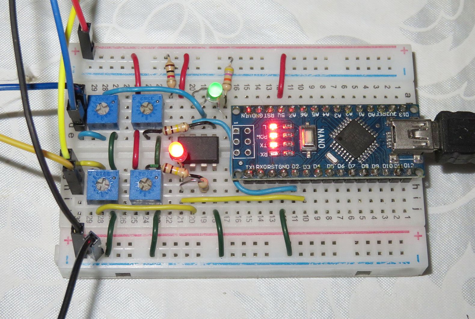

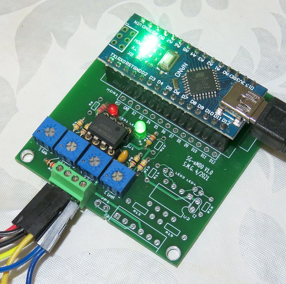

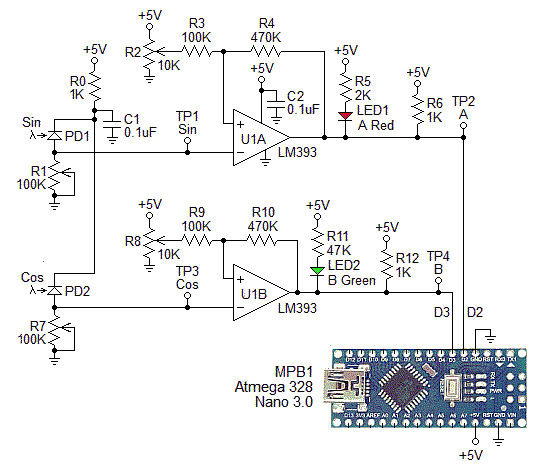

Quad-Sin-Cos Interface to Atmega 328P Nano 3.0/µMD0 Schematic (Left), on Solderless Breadboard (Center), using Custom PCB (Right)
Interface to µMD0 Parts List
Here is the very long detailed parts list for driving a TTL-compatible device like µMD0. :) The numbering refers to schematic above:
Prt# Description Comments ----------------------------------------------------------------------- U1 LM393P, 8 pin DIP Dual voltage comparator C1 0.1 µF capacitor AC bypass for PDs C2 0.1 µF capacitor Power supply bypass for U1 LED1 LED, red Thresholded Sin, A LED2 LED, HB green Thresholded Sin, B R0 Resistor, 1K, 1/4W Photodiode protection R1 Trip-pot, 100K Sin (Channel A) load resistor* R2 Trim-pot, 10K Sin (Channel A) threshold R3 Resistor, 100K Sin (Channel A) trim-pot isolation R4 Resistor, 470M, 1/4W Sin (Channel A) hysteresis R5 Resistor, 2K, 1/4W Red LED current limiting R6 Resistor, 1K, 1/4W Channel A pullup R7 Trim-pot, 100K Cos (Channel B) load resistor* R8 Trim-pot, 10K Cos (Channel B) threshold R9 Resistor, 100K, 1/4W Cos (Channel B) trim-pot isolation R10 Resistor, 470M, 1/4W Cos (Channel B) hysteresis R11 Resistor, 47K, 1/4W Green LED current limiting R12 Resistor, 1K, 1/4W Channel B pullup SBB1 Solderless breadboard with 400 tie points PCB1 µMD0 PCB (optional with µMD0 PCB version only) STB1 4 pole screw terminal block (optional with µMD0 PCB only)
R1 and R6 can serve as load resistors for the photodiodes (as shown) if bandwidth is not critical, or as the feedback resistors for proper trans-impedance amplifiers. The 100K value should be satisfactory to result in a signal of a few volts p-p using a laser with an output power of around 1 mW and no beam expander. (The expanded beam may slightly exceeds the dimensions of the photodiodes, so the sensitivity will be reduced.) For a lower power laser or a laser with a beam expander, larger values may be required. Or for finer control, fixed resistors can be added in series with the trim-pots.
Most of these parts are also included in the kit for µMD0, which includes a solderless breadboard as well. A similar circuit on a solderless breadboard is shown below.

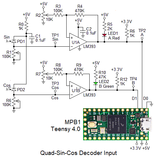

And here is a version to interface directly to the Teensy used in µMD2:
Note the 3.3 V source from the Teensy for the output pullups. This is critical to the health of the Teensy. Higher voltage (i.e., 5 V) may damage it.

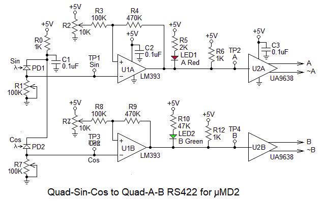

And finally here is a version to generate RS422 for use with SG-µMD2 or other compatible device:
Additional parts for RS422 Output:
Prt# Description Comments ----------------------------------------------------------------------- U2 UA9638, 8 pin DIP Dual RS422 line driver C3 0.1 µF capacitor Power supply bypass for U2
