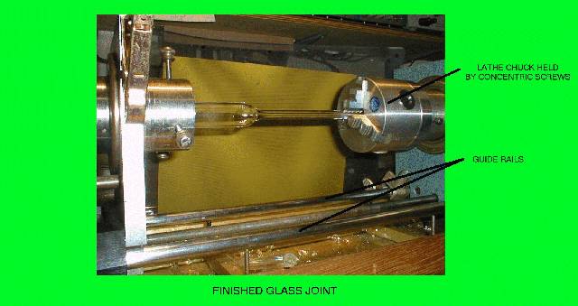

Although I was able to make hand supported butt seals that were
functional, they looked uneven and were difficult to lineup in the
laser tube support so that the capillary would be centered. I then
decided to manufacture a device that could reduce my lack of skills in
this area.

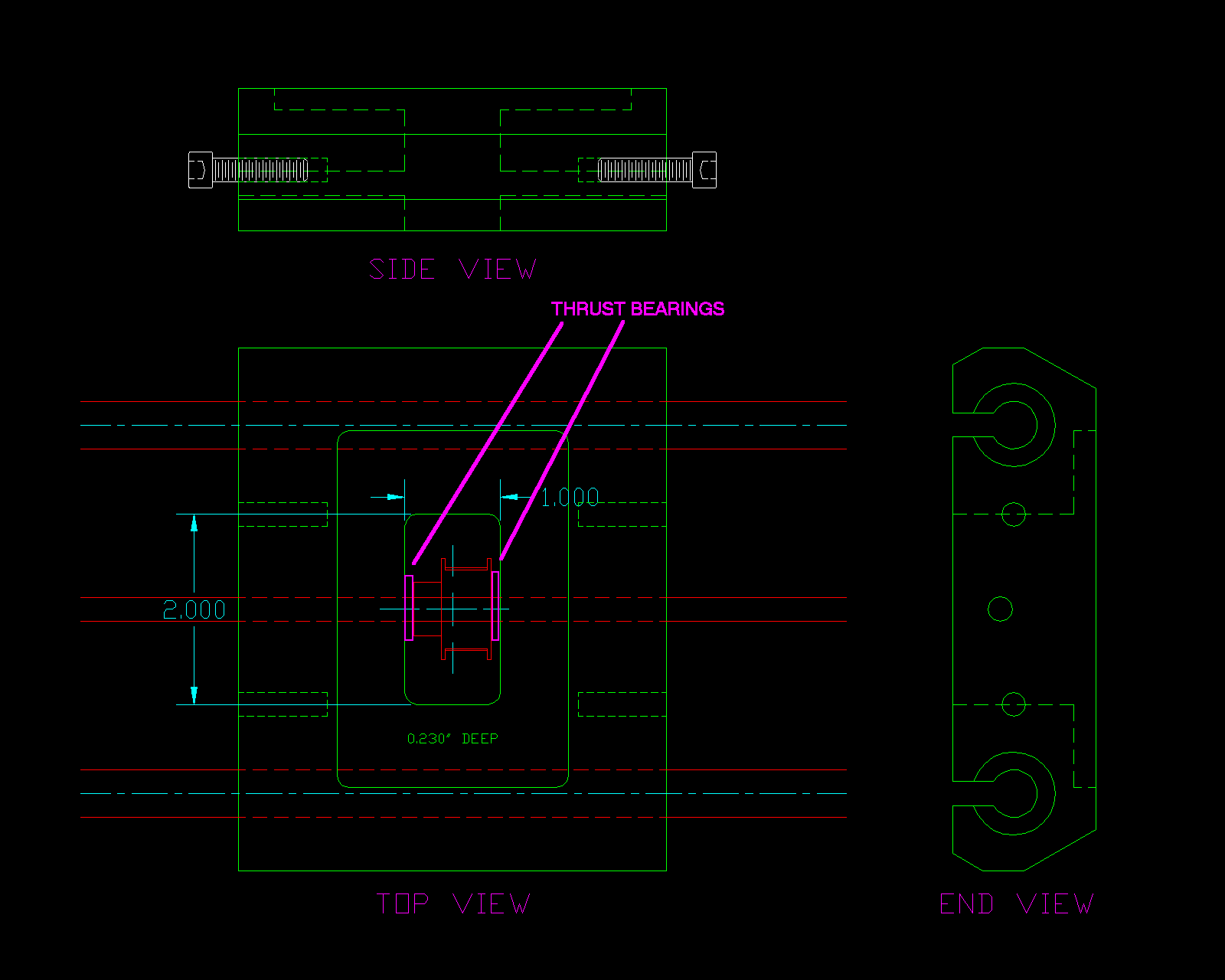

Description of the Glass Working Lathe

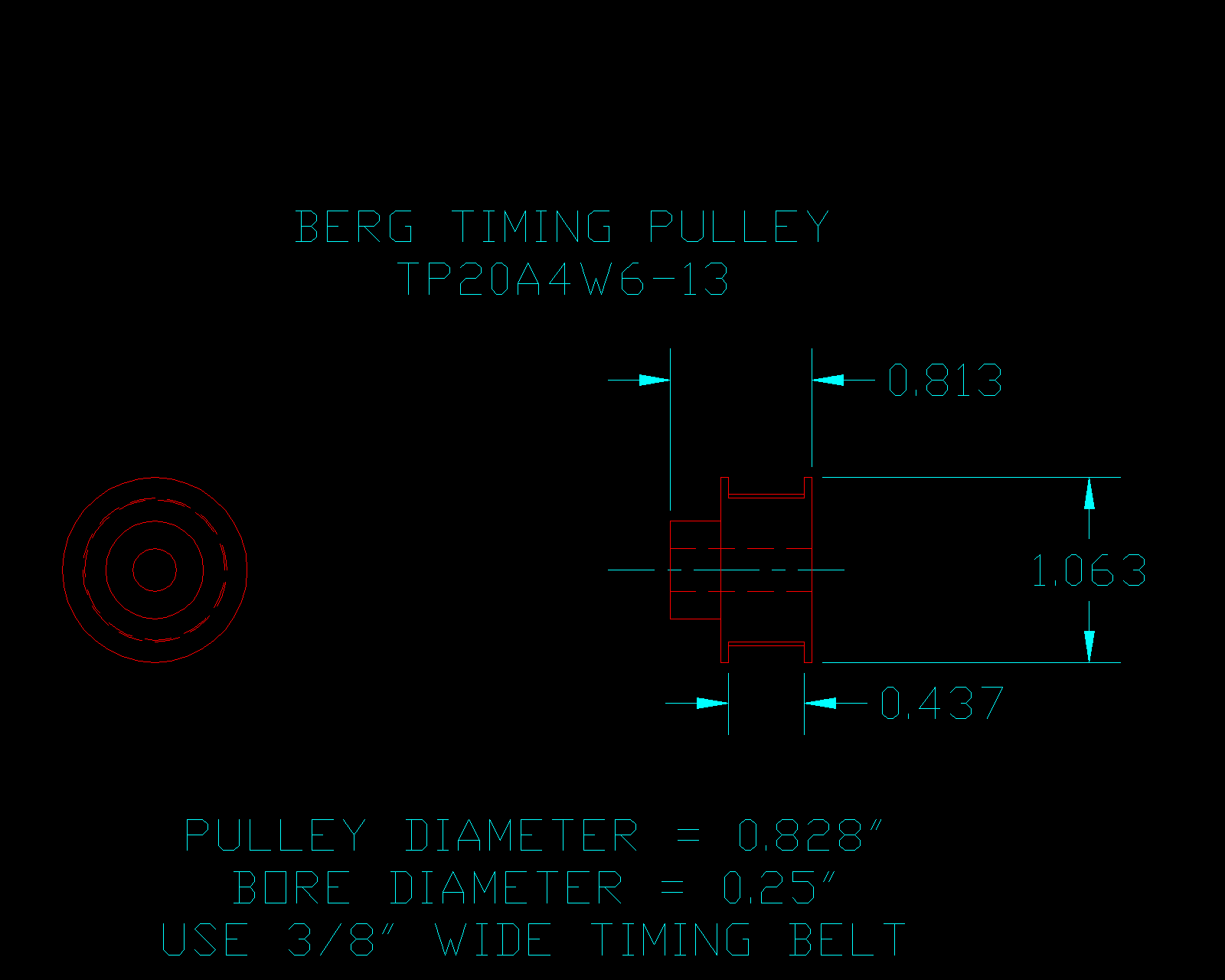

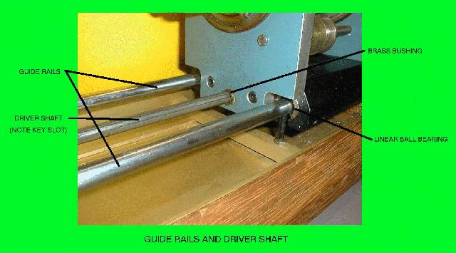

I came across a microwave measurement device manufactured by
Measurements Corporation that had a couple of carriages riding on two
parallel rails. The carriages used linear ball bearings, which made
their riding very smooth and accurate. This was the starting point for
the lathe. However, this could have been manufactured using parts from
W. M. Berg Incorporated. They have a web site with catalog
information. They specialize in hardware of the type needed for this
project, such as timing belts, machined rods, linear bearings, pulleys
etc.

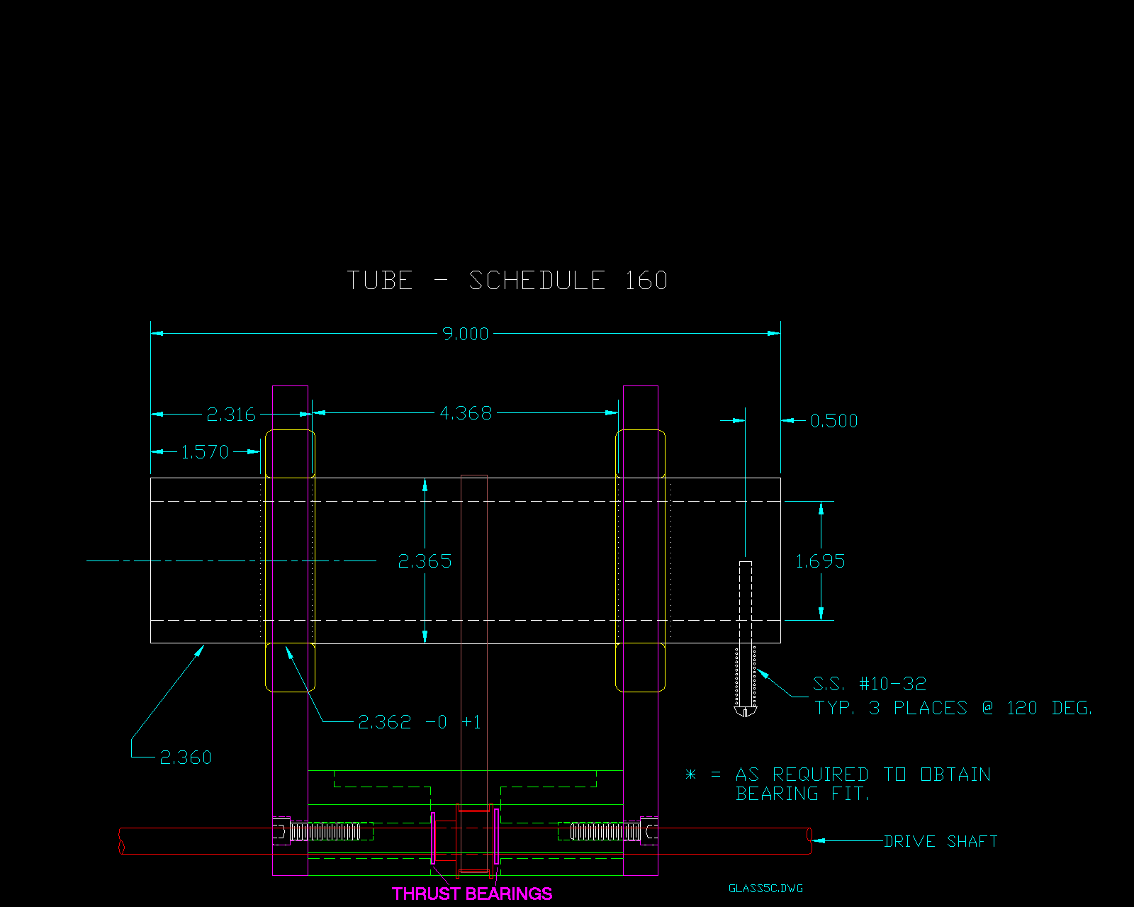

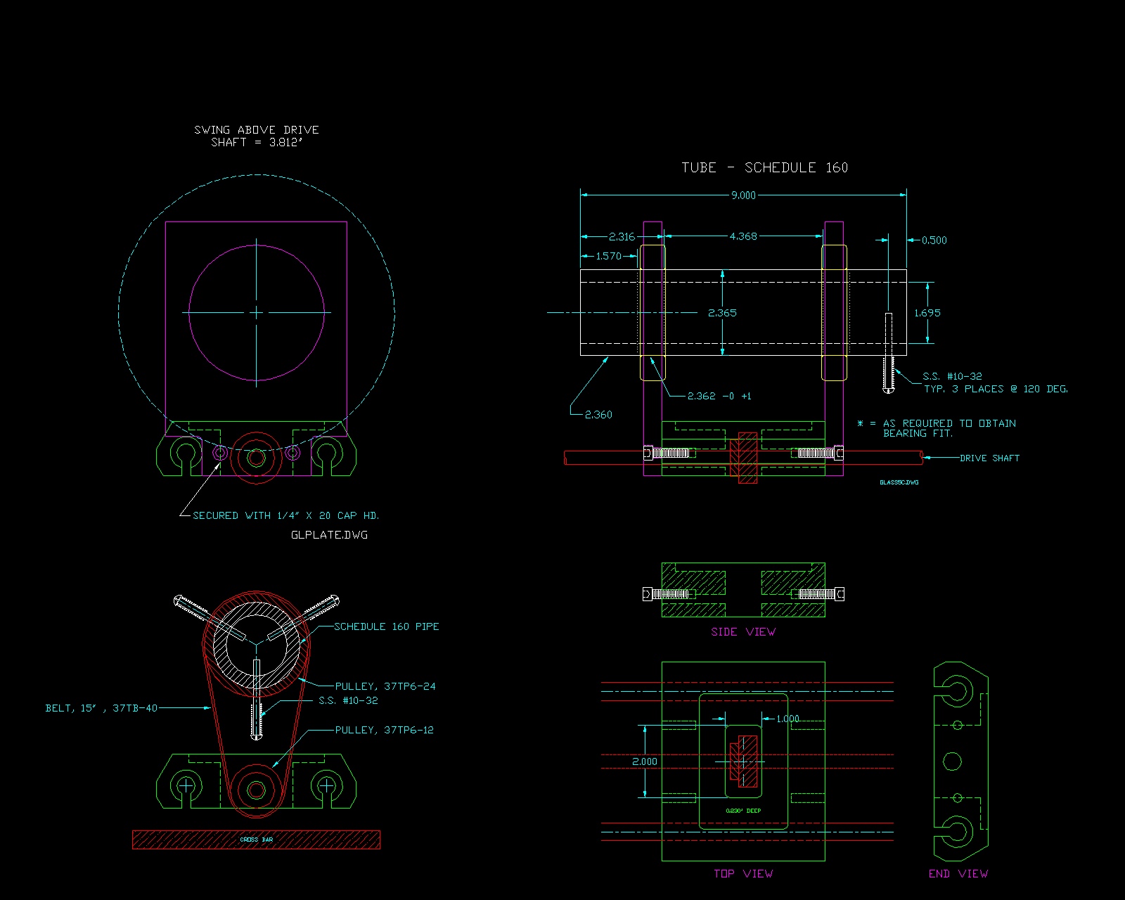

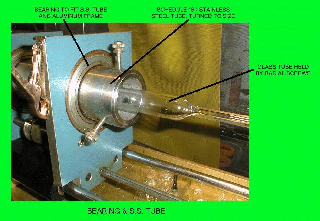

There were several items, which I could not manufacture at home due to
lack of proper machinery. I located a machining shop and had them
made to order. Those were the two pieces of stainless steel schedule
160 pipe and the key on the driven shaft. The other pieces and
components were readily available or were purchased from W. M. Berg.
The carriage end plates were leftover pieces of aluminum from a
previous project. This limited their size and therefore the rotating
clearance. The thickness of the rotating pipes was selected so that
the radial glass holding screws would have enough "meat" without the
need to attach nuts to the internal diameter of the rotating pipe. A
much lighter rotating pipe can be used if screw nuts are soldered to
the inside or outside of the rotating pipe. Make sure that the screws
are radial to the longitudinal centerline of the pipes.
The reader is encouraged to replace components and to find
alternatives to the design and parts shown in this article. The
principle should be maintained: two glass tube holders which run
concentrically, can hold the glass tube centered and one of the
holders needs to move horizontally, maintaining concentricity.
In lieu of the Measurement Corporation carriage, one could use a
dovetail rail if it can be made to ride smoothly in the horizontal
plane. Getting fancy, one could install a rack and pinion drive to the
movable carriage.

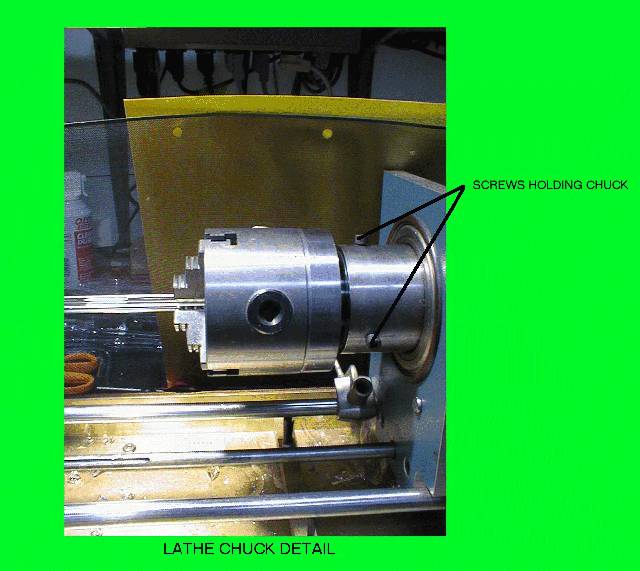

- Use of a metal working lathe chuck on one end. This allows supporting
short pieces of glass, such as the end pieces of the pulsed Argon tube
and sealing electrodes to Pyrex glass etc. This is shown on the
pictures. For a lower cost, a standard 3-jaw drill chuck can be
used. Either can be supported by the radial screws on the carrier
pipe.
The Drawings
The original drawings were developed in AutoCAD and converted to GIF
files. Although the GIF files are adequate, if someone is interested
in the project and benefits from the original drawings, they can drop
me an email and I will attach the drawings to my response. The only

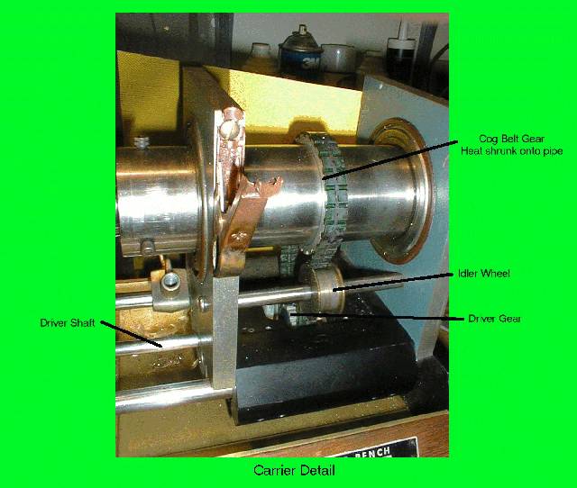

addition to the final product, which is not shown on the drawings, is
an idler pulley on the timing belts. This was required due to a small
amount of slack on the belt, yet not enough to allow the next standard
smaller size belt to be used. The idler is shown on the pictures but
not on the drawings.
Here are the drawings:
