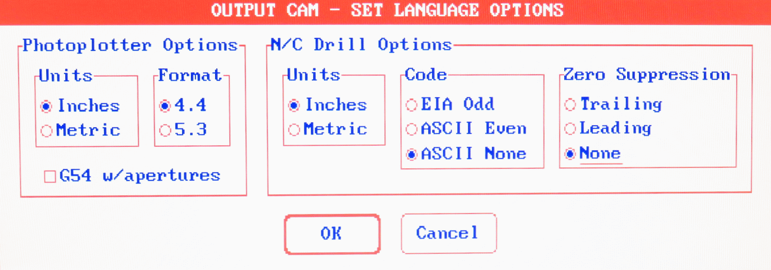

Since Tango is used to generate RS274D-format Gerbers, its
CAM settings are critical:
Some other values work but not all.

- Generate all the Gerber layers and
the Excellon drill file for 4LAYER.PCB using the settings shown
above - ASCII: None and Zero Suppression: None. The typical extension
is .XLN. This is NOT the DRL file that Tango normally produces,
which is just a map of drill symbols and useless for machines.

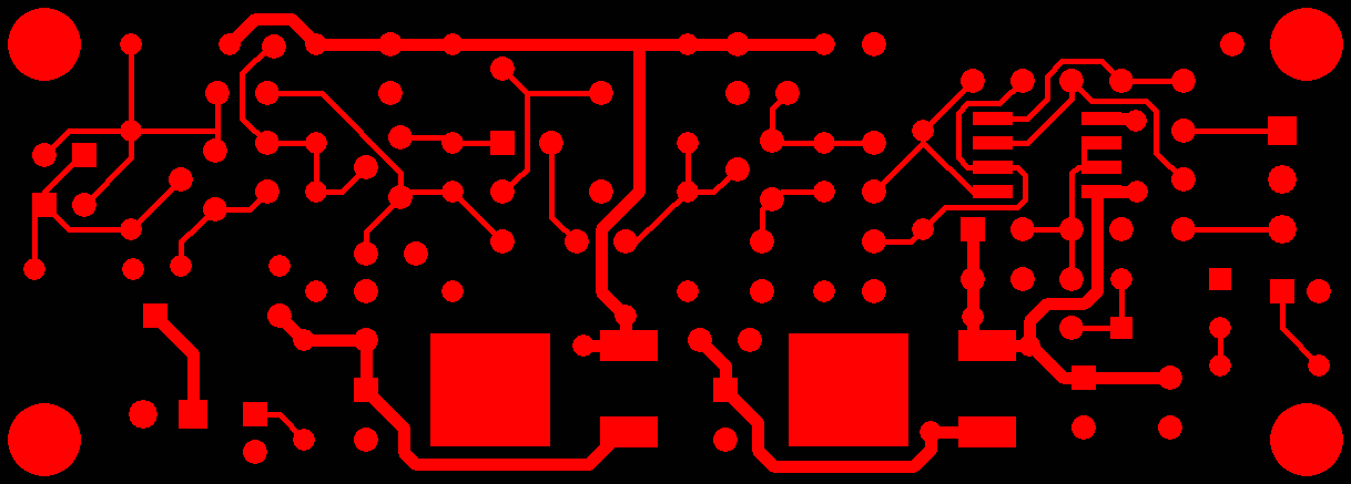

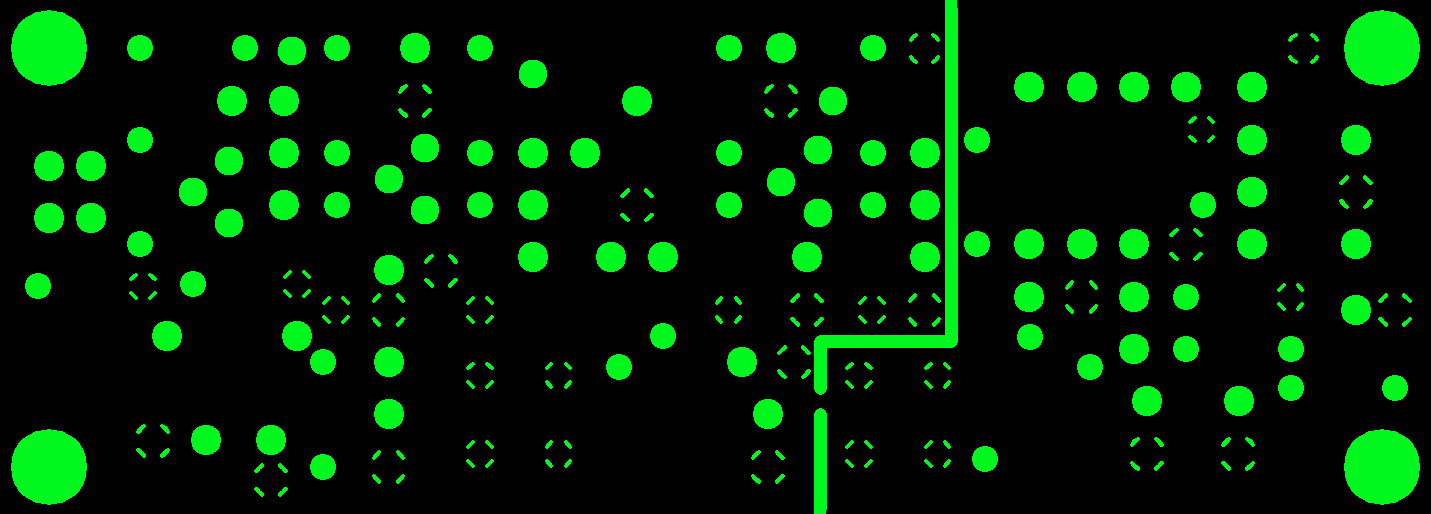

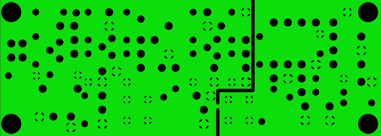

The examples below show the typical appearance of the Gerbers for
a signal layer, a (split) plane layer as generated in Tango PCB, and
the same plane layer from the JLCPCB production file for the board
as displayed using Gerbv.
Typical Gerbers: Signal Layer (left, copper is red); Plane Layer
Generated by Tango (center, copper is black); Plane Layer from
Production File (right, copper is green)
