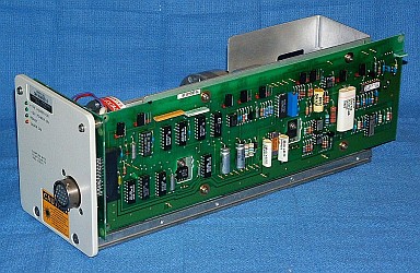

The heart of HP/Agilent two-frequency lasers is the custom HeNe laser tube assembly, which represents most of the cost of the laser. When the heart degrades to the point of making the laser unusable or dead, the choices are a heart transplant, or a rebuild. The transplant is simple, quick, and low risk: Find a good tube assembly in a laser that is broken for some other reason and pop it into a chassis with good electronics. Only one trivial adjustment is required.
Used HP/Agilent metrology lasers are also widely available. But many of them are already unusable due to low output power or other problems. These lasers are often run 24/7 from the day they are installed until the day they die or fail preventive maintenence checks. Such lasers invariably find their way to eBay and unscrupulous sellers will either claim the "came from a working environment" or an inability to test. The working environment claim may not be inaccurate, it's just that the laser is dead! :) However, if the seller has tested the laser and offers a warranty, then a previously owned unit may be perfectly acceptable with low risk. Even where it has failed for other reasons like a bad HeNe laser power supply, a broken laser with a good tube may be easily repaired.
However, where the tube is bad, if it were possible to rebuild it, then this opens up a third possibility with performance potentially equal to that of a new laser at a fraction of the cost. A photo of a typical tube assembly removed from an HP laser is shown below:

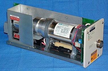

And a diagram of the internal structure of a typical tube assembly is shown below:
The HP/Agilent tube assembly consists of the actual glass HeNe laser tube, a permanent magnet, beam expander, and adjustable waveplates. The part that goes bad is the HeNe laser tube, which is mounted within the magnet using a rubbery potting compound.

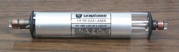

A typical conventional 6 inch HeNe laser tube is shown below:
Then, a heater with characteristics similar to those of the original tube must be installed on the exterior of the tube:
For a more detailed description of doing this, see Installing a Common HeNe Laser Tube in an HP 5517 or 5501B.
The tube above was actually mounted in the magnet assembly from an HP-5501A laser (because that was available) and installed in a 5517D laser chassis. It locked and produced a usable output, though at a REF frequency of only 1.2 MHz. Normally, a 5501A would be between 1.5 and 2 MHz, but due to the use of the standard tube and/or incomplete coverage of the bore by the magnetic field, the REF frequency was lower.
The benefit of using a conventional HeNe laser tube is that it doesn't involve anything that is totally custom or require high vacuum equipment, ultra pure gases, glass working, and other sophisticated processing by the laser rebuilder. When done on a small quantity basis, thes can require substantial investment in high tech equipment and the skills to go with it. However, the laser tube supplier will almost certainly need to modify their "recipe" in terms of gas-fill (He:Ne ratio and pressure) and mirror parameters (reflectance and radius of curvature) at the very lesat. Nonetheless, that should be much less expensive than developing the capability to rebuild tubes in-house, and a company that produces HeNe laser tubes routinely, will have the experience to get the processing correct.

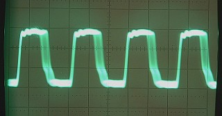

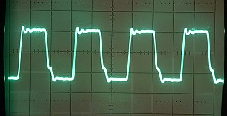

The symptoms are as follows: The MEAS signal out of the optical receiver should be a clean square-wave with approximately a 50 percent duty cycle. As the remote mirror or cube corner moves, the period/frequency of the square-wave gets smaller or larger due to Doppler shift but the duty cycle remains the same. The system determines position by accumulating the relative phase difference between MEAS and REF, which is a square-wave of fixed frequency, the unmodified Zeeman beat output of the laser
These two photos show an example of a normal MEAS signal with clean rising
and falling edges, and a MEAS signal where there is a small amount of movement
of the remote mirror. In fact, it's likely that both the rising and falling
edges are moving back and forth, but since the oscilloscope only triggers on
the rising edge, that one appears sharp. (The jaggedness in the falling
edge is an artifact of the wiring termination.)
