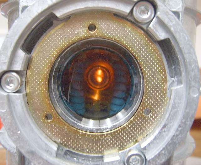

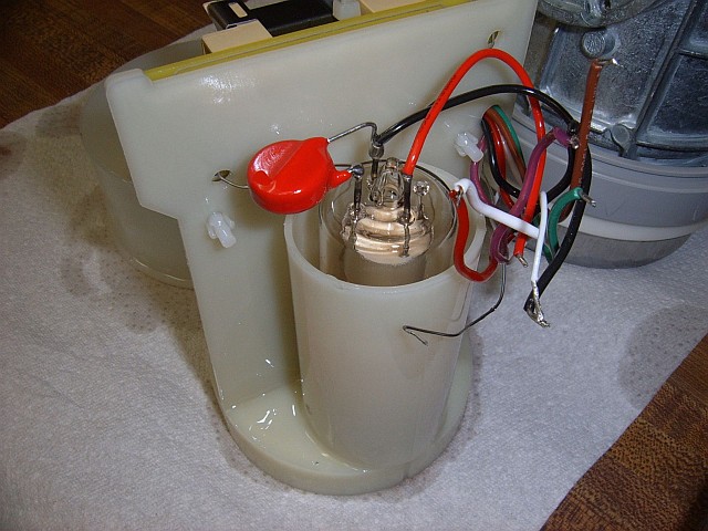

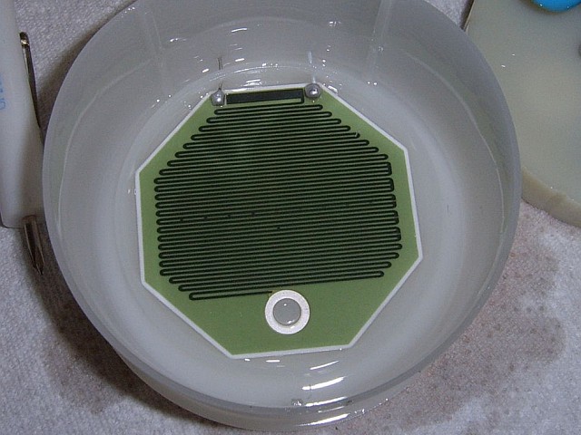

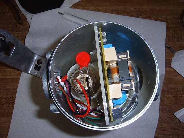

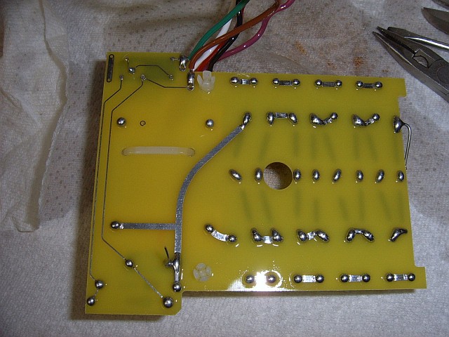

    Trophy TRX708 X-Ray Generator
    This is the head from a Kodak 2200 intraoral (dental) X-ray system. See Trophy TRX708 X-Ray Generator Schematic. The head contains the inverter and high voltage multiplier with the wall-mounted controller housing the full-H-bridge high frequency driver, timing, and safety circuits. Information on the overall system may be found at Kodak 2200 Intraoral X-Ray System User's Manual or if this link should decay: Sam's Copy of Kodak 2200 Intraoral X-Ray System User's Manual. A Web search will turn up other copies.
    (Mostly from: James Sweet.)
    Here are some photos of the head components:
    1. The filament voltage can be figured out by watching the tube current. For a fixed kVp, tube current is controlled by the temperature of the filament. It should operate nicely with a filament voltage around 4 V. Don't go much higher than 4.8 V or there is a risk of ending up with a nice paperweight. I think the filament current was a couple of amps at that point. It's pretty easy to remove the aluminum filter and look at the glow from the filament. It should look about the same as an ordinary light bulb, slightly yellowish, if it's pure white that's too hot.
    2. Beam current should max at 4 mA with the relay disengaged, 7 mA with 24 VDC applied to the green wire to engage the relay inside the head.
    3. The original circuit used a resonant converter IC that drives the transformer with a mosfet H-bridge off a 170 VDC bus, it also has an inductor in series with the output to the transformer (value unknown).
    The transformer is definitely custom made for this specific system. The only info I have is what I was able to extrapolate by visual inspection and driving it with a low voltage while measuring the output. I successfully tested the head using a MOSFET half bridge fed by an oscillator that was adjusted to about 80 kHz while watching the current waveform. The input voltage was adjusted with a Variac feeding a voltage doubler to get approximately 290 VDC. Both the frequency and voltage have to be regulated to keep everything happy as the tube current varies depending on heater voltage. Closed-loop feedback is mandatory since there is a lot of sag in the multiplier ladder. I just used a DMM for playing around with it but the original driver board used the feedback directly to control the regulator.
    CAUTION: If powering the head using a home-built driver, note the duty cycle (cooling requirements) in the manual! This head is not designed for continuous operation. Something like 0.1 second on every few seconds max, dependent on tube current.
