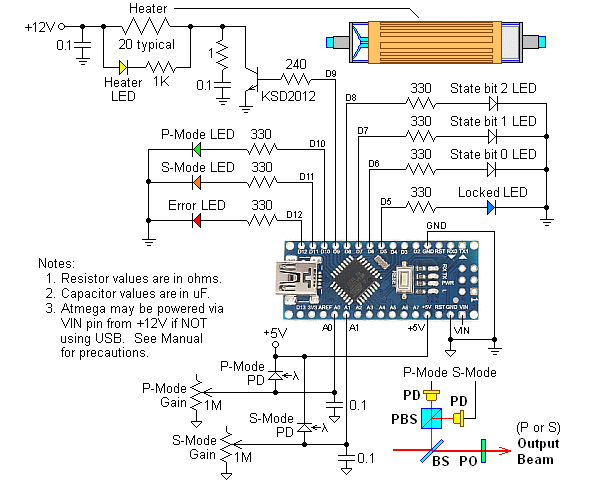

Wiring Diagram and Parts List
The diagram below - a sort of a hybrid between an electronic schematic and wiring diagram - shows the parts required for an Atmega328 Nano 3.0 system (with or without the GUI) incorporating all the bells and whistles. (Well at least the LEDs in decorator colors.) But for basic functionality, LEDs for Locked and Error would be all that's needed.
µSLC1 Schematic/Wiring Diagram using Atmega 328 Nano 3.0
The following are the components required to put together a basic system for the controller. These parts are available from electronics distributors like Digikey and should total no more than around $10 to $15. The Atmega is available from many eBay sellers for as little as $2 delivered. This list does NOT include the laser and its associated optical and electronic parts.
For those not familiar with the common resistor color code (Black/0, Blown/1, Red/2, Orange/3, Yellow/4, Green/5, Blue/6, Violet/7, Gray/8, White/9), the resistors shown above are 150 ohms (brown-green-brown or 15 with 1 zero) ohms and 330 ohms (33 with 1 zero) ohms. The gold stripe indicates 5 percent tolerance on the value but for the use here, tolerance doesn't matter. (It's possible the resistors you use will have 4 stripes where 3 of them are the value and the 4th is the multiplier, along with one for tolerance. If in doubt confirm the value with a multimeter.) The chart below is from Digikey. (If the link decays, a Web search will readily find another one.)
The photo below shows the first version of µSLC1. It matches the schematic/wiring diagram above except for some minor details like specific part values, lack of filter capacitors and snubber, resistors instead of trim-pots for mode gain, and differences in LED colors.
Prototype µSLC1
Other parts like jumper wire (solid insulated #22-#26AWG for breadboard connections), cables to attach the PDs and heater, and connectors (if desired) will be required to complete the system.
Most of the connections on the breadboard are made with the electronic parts themselves or bits of excess wire cut from their leads. But there will be a need for a few insulated jumpers which should use #22-#24 solid hookup wire stripped to fit in the holes.
It may be desirable to wire the laser with the photodiodes and heater as a separate assembly, using some sort of connector to attach it to the controller. One suggestion is to use DB9F (controller) and DB9M (laser) connectors wired according to the Spectra-Physics 117/A pinout:

DC power supplies for the heater (12 VDC at 1 A max assuming a heater of not less than 12 ohms cold resistance) and the Nano 3.0 (5 VDC at less than 1/2 A, unless always connected to USB) will also be required.
CAUTION: The Nano 3.0 can take +12 VDC on VIN since it has an on-board 5 V regulator. But there can be problems when connecting to USB. Inadvertent ground loops can result in erasing its brain or damaging the USB chip as I found out. I currently use USB to power everything but the heater, which takes +12 VDC from its own regulated wall adapter. When used without USB, VIN can be connected to +12 VDC.
And the HeNe laser itself must include the tube heater, and photodiodes monitoring the two polarized modes:
Atmega/Arduino Pin Assignments
Here is a list of the Atmega 328 Nano 3.0 external pins used by µSLC1:
 Arduino Pin   Physical Pin   Function
     D3             6         Real Time Clock/Interrupt (Do not connect)
     D5             8         Locked LED (0 or 5V)
     D6             9         State bit 0 LED (0 or 5V)
     D7            10         State bit 1 LED (0 or 5V)
     D8            11         State bit 2 LED (0 or 5V)
     D9            12         Heater Drive (5V PWM, 0 to 100 percent)
    D10            13         P-Mode LED (5V PWM, 0 to 100 percent)
    D11            14         S-Mode LED (5V PWM, 0 to 100 percent)
    D12            15         Error LED (0 or 5V)
    D13            16         Heartbeat LED (Atmega "L")
     A0            20         P-Mode input (0 to 5V)
     A1            21         S-Mode input (0 to 5V)
     A2            22         External Modulation input (future, 0 to 5V)
    +5V            27         +5 VDC from on-board regulator or USB
    Vin            30         Optional DC input (+7 to +20 VDC)
    GND           4,29        Ground/Common

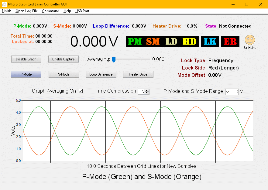

Installing and Running the µSLC1 GUI
Note that µSLC1 does not require the GUI to control the laser, but it is convenient for troubleshooting and/or fine tuning locking parameters.
Save the µSLC1 GUI .exe file into any convenient directory. (There's a small chance that the first time it's run, an error is produced since there is no configuration file associated with it. Simply continue and the GUI will come up. When it is closed using "Finish", valid settings will be saved so that the error should ot appear again.)
Important: DO NOT reset the board while the µSLC1 GUI is running. The GUI will need to be aborted, the board may need to be reset again, and only then can the GUI be restarted. However, the GUI may be aborted and restarted ad-infinitum without affecting the firmware and laser. ;-)
The graphic below shows the typical GUI main window at startup.
Typical µSLC1 Main Window at Startup
Yes, this bears remarkable similarity to the µMD1 GUI due to having inhereted much of its DNA. ;-) When first started, all the readouts are loaded with zeros and the indicators are turned on to show that they are there. Sort of a high tech "lamp test". ;-)
GUI Operation
The µSLCS1 GUI (henceforth simply called the "GUI") comes up with the P-Mode amplitude in the main readout. The only action required by the user is to select the USB COM port. Once selected, the readouts and graph will begin displaying the data from the laser. Behind the scenes, the GUI has uploaded the Locking Control Block from the firmware to update its widgets with the current set of locking parameters.
Important: The GUI can be started at any time but the firmware must be running before the USB COM port is selected or else the Universe may implode or explode, which one occurs and when has yet to be determined. :) Confirmation of this issue is left as an exercise for the user. ;-) There should be no need to reset the firmware when restarting the GUI - it will pick where it left off.
Note that the GUI is NOT required to run the laser with the µSLC1 controller and starting or restarting the GUI has absolutely no effect on laser behavior. (Or at least it shouldn't.) Unless messing with the parameters in the "Laser Firmware Hacking" (Command) window, which will be explained below. For most users, the GUI will only be used to monitor the laser. Actually, for most laser users, there is no need for the GUI at all! It's been developed primarily as a development aid and for unapologetic laser jock technoduibes. ;-)
Main Window Controls and Readouts
The first set are the selection buttons at the top of the window. Note that except for USB Port, these do not invoke drop-down menus and require only a single click to activate.
These buttons may all be accessed via Alt-first letter.
The next set are the buttons for selecting what's shown in the Main Readout and what is plotted:
Main Window Indicators
Next are the various fields for displaying information in the Main Window:
When the firmware is started (power on to the board, reset, or just after the firmware is uploaded), the controller enters State 0, Startup. When it detects laser output, it goes to State 1 which drives the heater at full power while monitoring the length of the mode sweep cycle.
The graphic below shows a snapshot of the Main Window about halfway through warmup. The mode sweep cycle at this point is around 8 seconds.
Typical µSLC1 Main Window about Halfway through Warmup
Once the mode sweep cycle time exceeds the "Mode Period" value, the controller goes to State 3, Locking. There it checks for the Loop Difference to settle down below the "Locking Tolerance" value. It then goes to State 5, Locked.
The graphic below shows a snapshot of the Main Window just after the laser has locked. On the left portion of the graph is the laser mode sweep of the P-Mode and S-Modes prior to locking.
Typical µSLC1 Main Window shortly after Locking
The laser will remain locked forever unless the P-Mode or S-Mode go bonkers (technical term!). If it does go bonkers, the controller will go to State 7, Error and try again.
Data from the Atmega board is sent at a rate of just over 60 pps. However time compression of the plot may be set up to 1,000 so that more than 2 hours of data may be visible. At a complression of 5, the time between horizontal divisions is close to 10 seconds. While the data is subsampled, not averaged, graph averaging can do something similar.

Controller-Only Version of uSLC1 for ATtiny85
The µSLC1 firmware has been ported to the Digispark ATtiny85 development board but has not been fully tested with a laser. That would be your job should you decide to accept the challenge. :) The core locking routines are virtually identical, but all GUI and EEPROM code has been stripped out. Thus, any custom settings would need to be made as changes to the firmware parameters before compiling. Even then it's a tight fit in program memory.
ATtiny wiring
Only 3 connections (and power) are required for the board. What could be simpler?
µSLC1 Schematic/Wiring Diagram using ATtiny85 Digispark
There is also a version of this board labeled "ATtiny85" which should be functionally similar but with a slightly different layout and a proper USB connector. :)
The single on-board LED serves as a multi-mode status display (documented in the firmware). To further simplify the circuit, eliminate the Heater LED and its current limiting resistor.
VIN goes directly to a 78L05 regulator so the +12 VDC for the heater could be used to power the board when not connected to USB. DO NOT use them both at the same time. CAUTION: There is no protection on +5V power. So when connected to USB, any wiring mistakes or failures that result in excessive current from +5 VDC to GND will pull it from the USB port. Depending on the computer's USB subsystem, this could be bad. It has been suggested that connecting the ATtiny board through a USB port replicator or hub might provide better protection. USB is supposed to handle overloads gracefully but not all implementations do.
