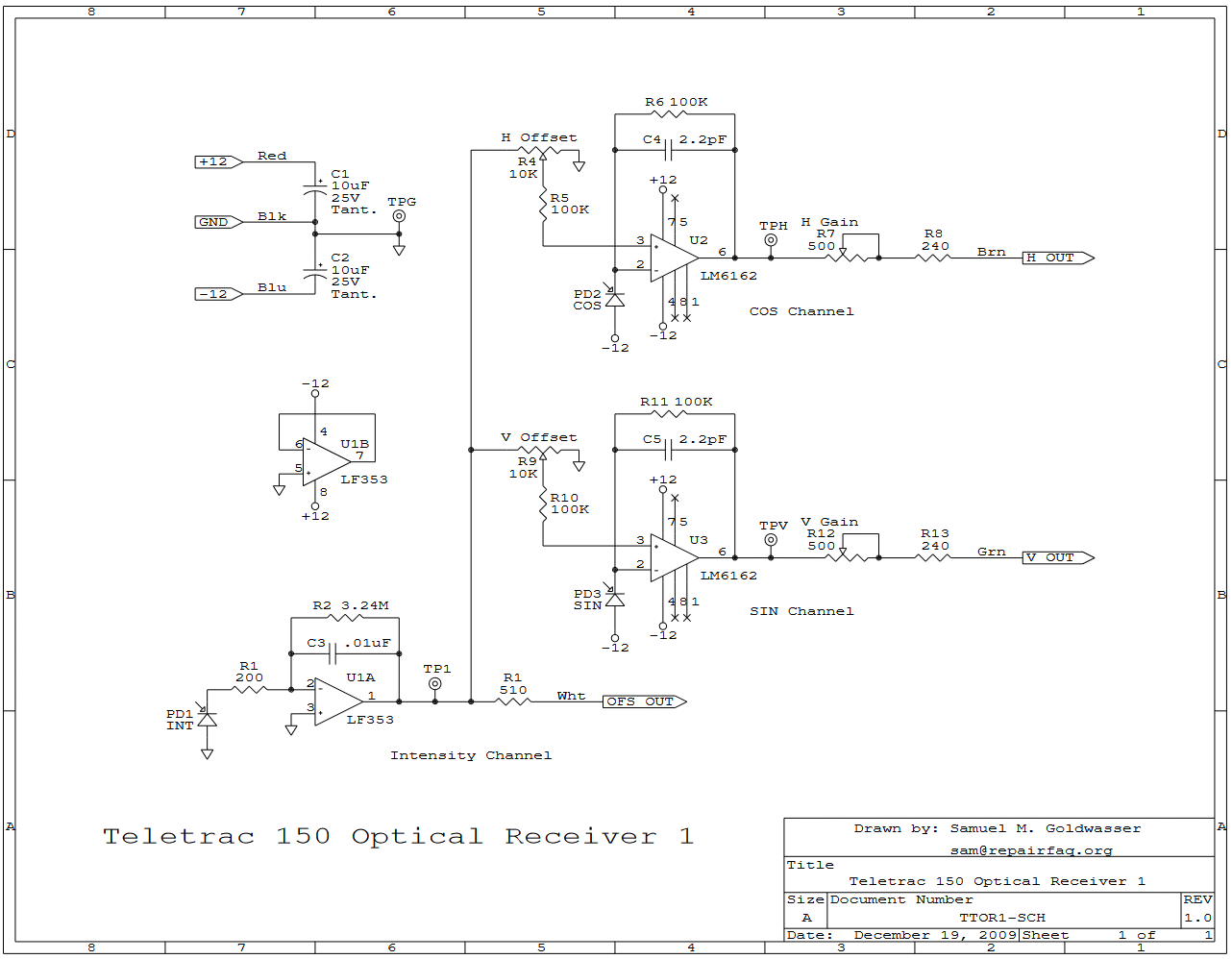

  3. Schematics of higher bandwidth front-ends: Here are three circuits that can at least be use as starting points to design and/or construct systems with count rates of 1 MHz or more. (Click on the image for the full resolution version.)
    The first is/was used by Teletrac for their single frequency laser-based systems.
    In addition to the Sin and Cos channels, it also has an Int (intensity) channel which adjust the offset to accomodate varying signal levels.

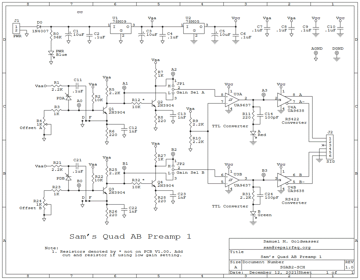

    The second is a circuit for which I am contemplating designing a PCB but it may not happen for awhile.
    It's a combination of a dual trans-impedance pre-amp, gain stage, threshold to convert to Sin-A-B, and RS422 line drivers.
    The third will be a simple PCB that accepts the two optical inputs and outputs RS422. So it should be a straightforward solution not requiring high speed op-amps. Its bandwidth is greater than 3 MHz with an optical power below 25 µW.
