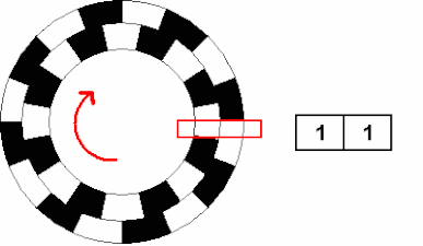

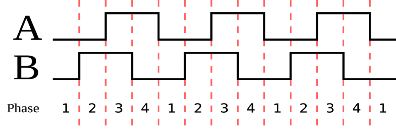

The graphics below show a rotary optical encoder which uses a pair of LEDs and
photodiodes physically offset by 90 degrees to generate Quad-Sin-Cos analog
signals which are then thresholded to yield Quad-A-B digital signals.
The specific type of sequence is called a "Gray" code (not based on color
but attibutable to someone named Frank Gray) and has the property that any
possible allowable change in value is a change in only a single bit.
This eliminates the ambiguity with sensors using the normal binary order
where two bits can change at not quite the same time.

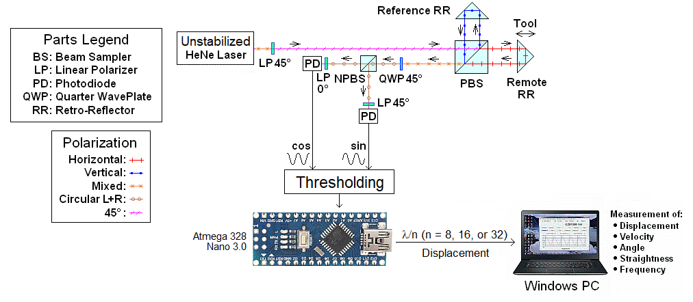

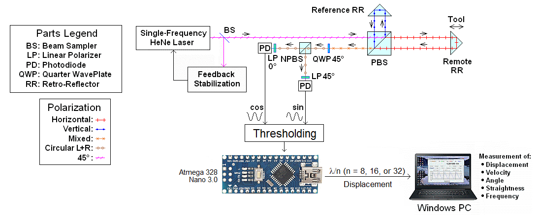

For use with interferometers, the only difference is that the origin of
the analog signals are from a different type of detector:
This also applies to devices like Ring Laser Gyros (RLGs) which have
similar types of detection schemes.
Where the Path Length Difference (PLD) between REF and MEAS is less than
a few cm, the HeNe laser doesn't even need to be stabilized or single
frequency:
This can be either a linearly polarized HeNe with its polarization
axis at 45 degrees (no LP required), or a random polarized HeNe oriented
so that its orthogonal polarization axes are at 0/90 degrees with the
external LP at 45 degrees.  In the latter case, it may be necessary
to assure that the laser is well behaved - not a flipper; such a laser
may be noisy around the flip points.
The interferometer produces (ideally) sinusoidal analog signals in quadrature
that are thresholded to produce the Quad-A-B digital signals used by
µMD0.

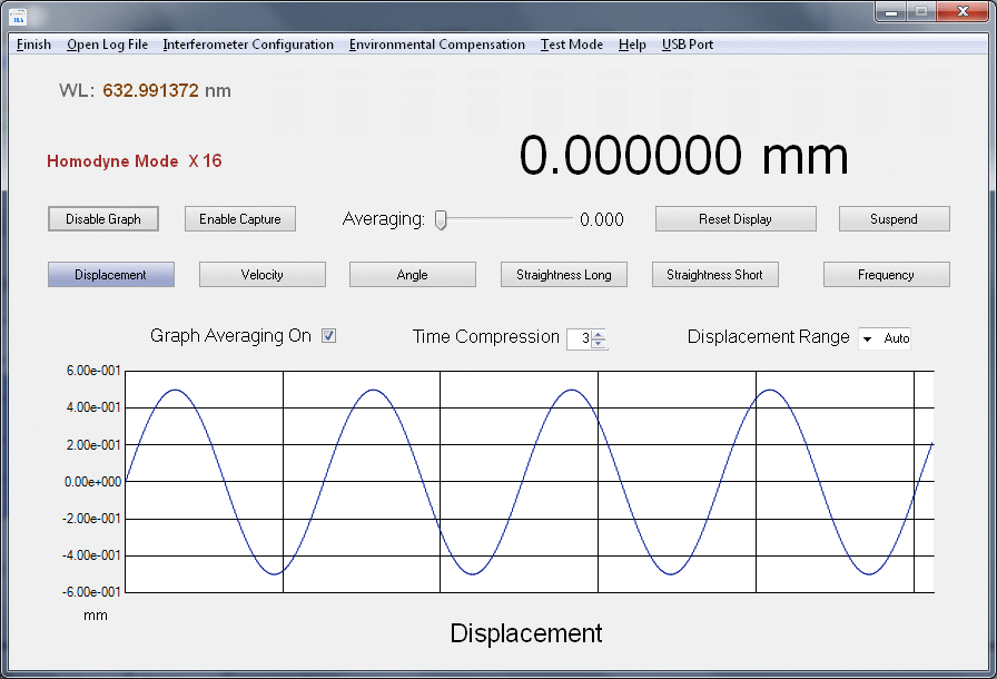

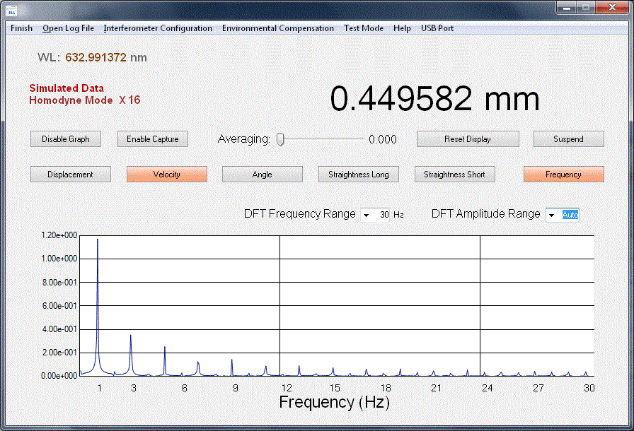

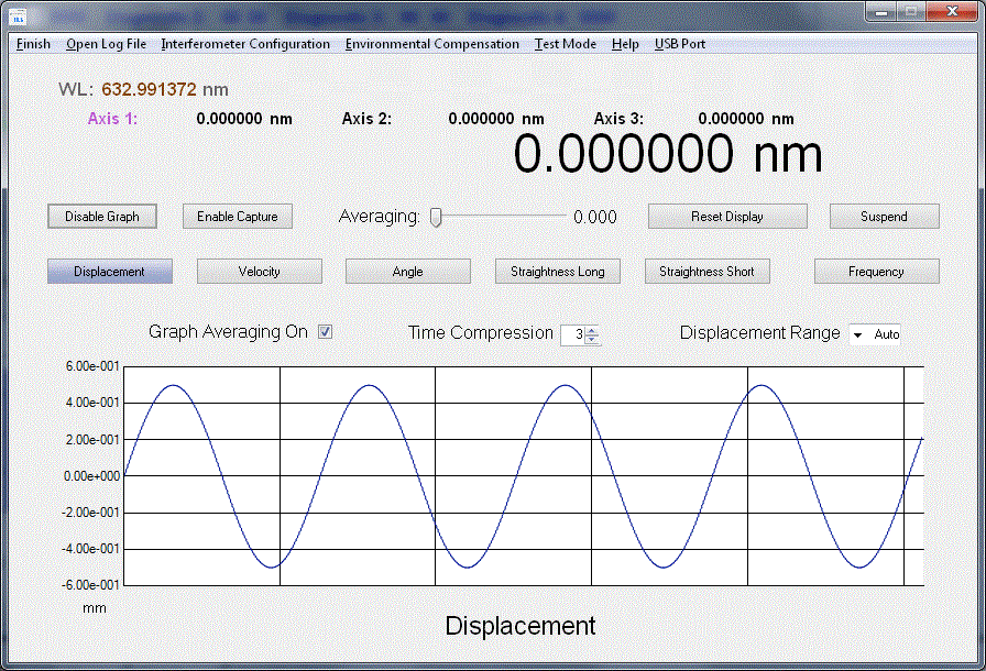

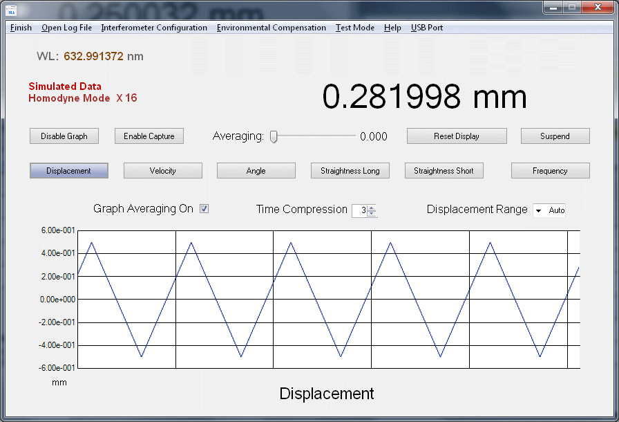

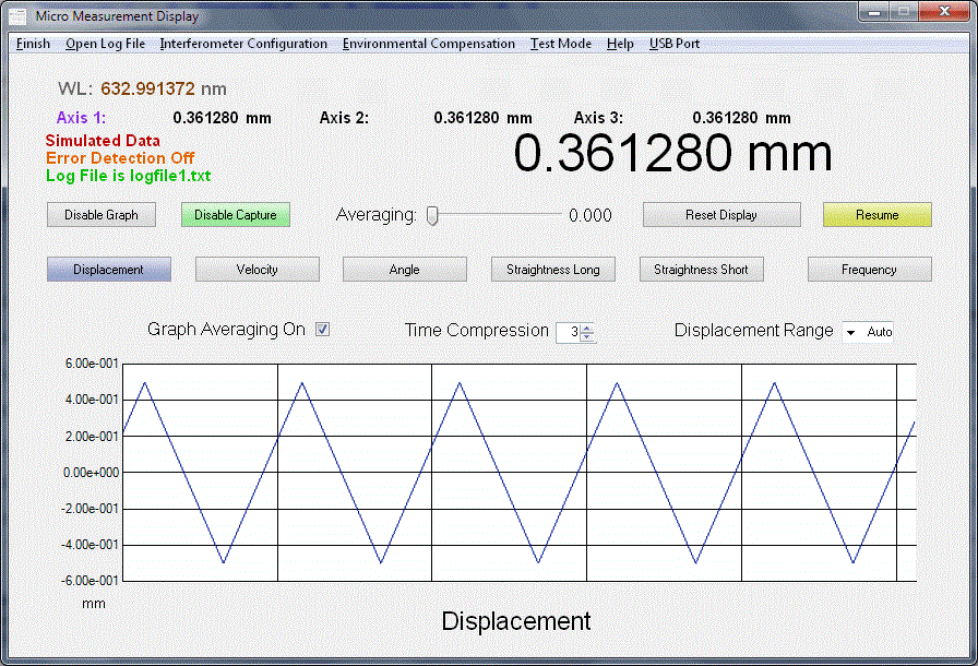

Mote: Throughout this document, "µMD0"
to the Atmega-based hardware.  "µMD" refers to the Windows Graphical
User Interface (GUI), which is identical to that for µMD1 and µMD2.

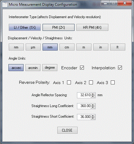

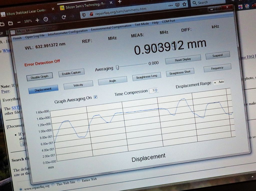

 An adjustable weighted average to smooth data may be applied to the readout
 and graph.  There is no interpolation.

Rotary Encoder Digital Signals as a Function of
 Orientation
Typical Homodyne Interferometer Setup with Stabilized Single Frequency
 HeNe Laser using µMD0
Typical Homodyne Interferometer Setup with Unstabilized Multi-Longitudinal Mode HeNe Laser using µMD0

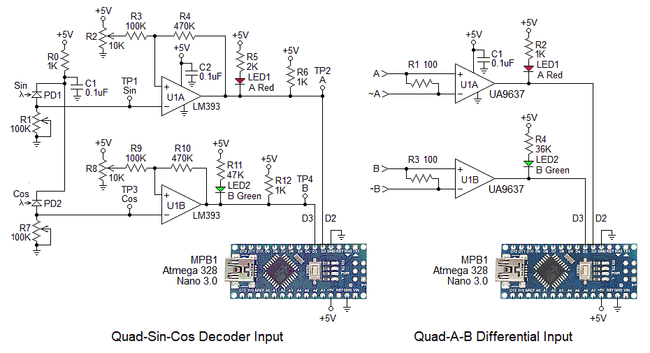

Wiring Diagram and Parts Lists
Since the Nano does most of the work, the only additional parts needed are
to interface to the encoder or laser.  And some very simple circuitry
will suffice to get started - or forever.  If higher performance is needed,
consider using µMD2 instead along with a proper photodiode preamp.
(#24-26 solid hookup wire or male-male jumpers may be needed to connect
the photodiodes to the rest of the circuitry, not listed.)
Some typical basic circuits are shown below:

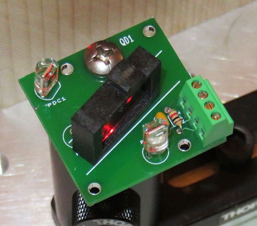

A slightly more detailed schematic may be found at µMD0 Sin-Cos Analog and RS422 Digital Interfaces. (This is the one used for the SG-µMD0 PCB.)
The LM393 is an 8 pin DIP so it, along with the Nano and other parts, will easily fit on the typical 250 column 2-1/4 x 3-1/4 inch solderless breadboard with room to spare, but a custom PCB is also available for the interface as well as one for a Quad-Sin-Cos Decoder. For a distance of up to a foot or so, simple wires will suffice at the modest speed of µMD0.
The Quad-Sin-Cos Decoder converts the optical output of the interferometer into a pair of analog electrical signals that are 90 degrees out of phase so that directional information can be generated. The followig parts list applies to the second photo, above:
Quad Decoder Parts List
Prt# Description Comments ------------------------------------------------------------------------- SB1 Solderless breadboard (SBB) 1-3/4 x 1-1/4 inch, 17 columns MP1 SBB mounting plate Attaches to optical post PCB1 Quad Decoder V1.0 PCB Custom PCB with 8-32x3/8 inch screw PD1 Silicon photodiode Sin (Channel A) of Quad-A-B detector PD2 Silicon photodiode Cos (Channel B) of Quad-A-B detector SKT1 Male-female 2 pin socket For PD1 SKT2 Male-female 2 pin socket For PD2 C1 Capacitor, 0.1 µF Bypass capacitor R0 Resistor, 1K ohms Photodiode protection AP1 Attenuator plate/BS Angled plate used as beam splitter CP1 Circular polarizer sheet Piece of CP (QWP+LP) for PD1 LP1 Linear Polarizer sheet Piece of LP or CP used as LP for PD2 STB1 4 pole screw terminal block Photodiode bias and outputs
These parts mount on the Quad Decoder PCB (which may not have an actual part number on the silkscreen). AP1 sits on the PCB and can be positioned to so the reflected beam is centered on PD2 and the intensities are close to being equal. This will probably be where the beam is near the far end of the attenuator strip and 50:50 is probably not achievable, but can be compensated for by the settings of the trim-pots R1 and R7. Once the optimal location is found AP1 can be secured with double sticky tape or a drop of Epoxy.
The Quad-A-B Differential version (RS422) is even simpler since the input is electrical. The input cables can be long and also be twisted with a single 100 ohm resistor between the two inputs for termination, but there needs to be a common ground connection somewhere. While the UA9637 is essentially a voltage comparator with built-in hysteresis, it CANNOT be used with photodiode inputs because its bias current is too high.
The resistor values for the red and green LEDs balances their brightnesses, mostly. Of course, the LEDs aren't *really* essential. ;-)
Tne value of 100K for the photodiode load resistors has been selected as suitable for the typical ~1 mW laser to result in the signal going from near 0 to around 3 V. It's not necessary to have them be adjustable since the threshold settings are adjustable. But you can if you wish (and they are trim-pots in the kits). You can of course change their value to reflect the real world situation of your laser power and losses in the Quad decoder. If the source is differential analog (typically each 1 V p-p), the signals can go directly to the comparator inputs dispensing with the load resistors and trim-pot.
It is not anticipated that later versions will differ in any major way. This is supposed to be bare bones after all. ;-)
µMD0 Parts List
Here are the very long detailed parts lists. :) The numbering refers to schematic above:

 STB1  4 pole screw terminal block  Photodiode bias and inputs
RS422 version:
(The parts unique to the RS422 version may not be included in all kits.)
MPB1 Atmega 328 NANO Arduino board with pins SB1 Solderless breadboard 3-1/4 x 2-1/4 inch, 250 columns PCB1 SG-µMD0 V1.0 PCB Custom PCB U1 UA9637 or UA9639, 8 pin DIP Dual RS422 line receiver LED1 LED, red Channel A LED2 LED, green Channel B R1 Resistor, 100 ohms Channel A termination resistor R2 Resistor, 100 ohms Channel B Termination resistor R3 Resistor, 1-3K ohms Red LED current limiting R4 Resistor, 1-3K/20-50K ohms Green LED current limiting SKT1 Parts for 30 pin 0.6" socket For Nano (PCB version only) SKT2 8 pin 0.3" DIP socket For LM393 (PCB version only) STB1 6 pole screw terminal block A/B inputs, external power, and ground
For this simple setup, a wireless breadboard with 25 columns (400 tie points) should be adequate. The Nano with soldered pins can plug in at the right side with the USB connector facing out, and the LM393 and associated components can be placed next to it. Those connections that cannot be made with component leads should use pieces of #22-#24 AWG solid wire. The solderless breadboard may not be included in kits with the SG-µMD0 PCB.
The "cables" for the photodiodes can simply be twisted pairs. Keep them short but a foot or so should be fine. If the source is something else like a commercial optical detector or signals from a self-contained laser/interferometer, a different type of termination than the load resistors may be needed.
For more information on the Quad decoder and interface, see Construction Guidelines for Basic Quadrature-Sin-Cos Decoder and Quad-A-B Interface Kits. Some of it is redundant but there are more details on the implementation and instructions on mounting the optical parts and the actual circuits and wiring.
The (non-Alpha) versions of the firmware are absolutely guaranteed to be new and improved in terms of features, capabilities, and performance. This probably means there will be some new and improved bugs as well. The Alpha versions are even more likely to have some juicy bugs. However, the µMD0 firmware is so simple that bugs would have difficulty hiding. ;-) Please contact us via the link at the top of this page should any dare to appear (or for any other legitimate reason). ;-)
   Input    Interrupt  Arduino Pin  Nano Pin
    1A          0          D2          5
    1B          1          D3          6
The LED on D13 is used as the heartbeat/status indicator for homodyne depending on firmware version. Currently it blinks at between a 1 and 2 Hz rate, more or less.

When started, the µMD GUI (henceforth simply called the "GUI") comes up in Displacement mode with graphing enabled. The only action required by the user is to select the USB COM port. Once selected, the readout and graph will begin displaying the interferometer data.
Even if there is no encoder or interferometer hardware attached to the board, it is possible to confirm that the Nano is talking to the GUI. Go to "USB Port" and select the same COM as used to upload the firmware. The graph should immediately start scrolling to the left indicating that it is accepting valid data, even if it is all 0s. With homodyne, there will be no error detection, but the fact that it started scrolling means the communications link is working.
Important:
For homodyne mode with µMD0, the default sample rate is 244.14 s/s. Attempting to change it is not recommended and no one at µMD Central is losing much sleep over the funny number.

The first set are the selection buttons at the top of the window. Note that except for USB Port, these require only a single click to activate:
The log file is closed and its name and path are saved upon exiting the GUI.
The values are signed long integers of the designated displacement(s) in nanometers including averaging and axis flip. (Same as the readouts.) The "*" can be used by the parser at the receiving end to detect the end of line.
To indicate that the Monitor COM port is active, a "+" will appear to the left of the "Graph Averaging On" label, flashing at the rate of the data lines being sent. Its color is subject to change without notice. :) Note that the graph does NOT need to be visible for the data to be transmitted.
Note: Once a USB port has been opened, the selection cannot be changed or closed. Code to close an open USB port is purported to do bad things and has been disabled. If an incorrect USB port was selected by accident, exit the GUI and restart. Any open USB port will be closed upon exiting.
These may all be accessed via Alt-first letter.

The format is slightly modified when Frequency mode is selected. This graphic shows the actual DFT of the triangle waveform in the one above. Note that the DFT coefficients go as 1/N rather than 1/N-squared because it's actually using the velocity data, which is a squarewave.
The horizontal scale is approximately accurate for real data. The vertical scale is somewhat arbitrary. The Main Readout shows Displacement data when in frequency mode.
There may still an error of up to 25 percent is the actual values since they depend on the sample rate being used, which varies depending on the sample rate. The uMD technical department has not gotten around to provided corrected labels, can you believe that? :)
Selecting Frequency sets Time Compression to 1 since the graph data is used for the DFT calculation. There will also be a delay in the Frequency plot accuracy depending on the DFT Frequency Range and input signal as data is accumalated.

The units for the Main Readout, as well as for the graph vertical axis (all except Frequency mode) are selected in the Interferometer Configuration window. The options are nm, µm, mm, m, in, and ft for all but angle, which has arcsec, arcmin, and degree. For velocity, "/s" is added. The same units also apply to the graph "Range" selection and vertical axis of the graph.
For encoder applications with environmental compensation OFF and "LI / Other" selected in "Interferometer Configuration", the resolution will be WL / (HomodyneMultiplier * 2).
Linear coefficienets:
These settings only affect linear measurements.
Units (as appropriate)
Known quirk: If neither the COM Port or Test Mode is active, switching among the Units buttons will only change the Units lable and/move the decimal point/precision without affecting the readings. Just thought you should know. ;-)
Parameters (as appropriate):
Miscellaneous:

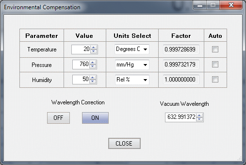

If the Temperature Auto checkbox is checked, nothing should change since the homodyne firmware doesn't send any sensor data.
Test Mode sends 34 °C.
If the Pressure Auto checkbox is checked, nothing should change since the homodyne firmware doesn't send any sensor data.
Test Mode sends 567 mm/Hg.
If the Humidity Auto checkbox is checked, nothing should change since the homodyne firmware doesn't send any sensor data.
Test Mode sends 89%.
For use with encoders, it can be set to almost anything.
For use with encoders, it should be set to Off.
Note 1: With the current GUI, the Factors for Temperature, Pressure, and Humidity will change based on the entered values However, their exact value is not guaranteed to be meningful and should only be considered for trends. This was supposed to be fixed when the environmental calculations were corrected using the NIST formulas, but the staff assigned to do the work took a couple decades off, sorry.
Note 2: With Environmental Compensation turned OFF, the vacuum wavelength is used in calculations. Therefore, Environmental Compensation should be turned ON for laser interferometers even if using standard values.

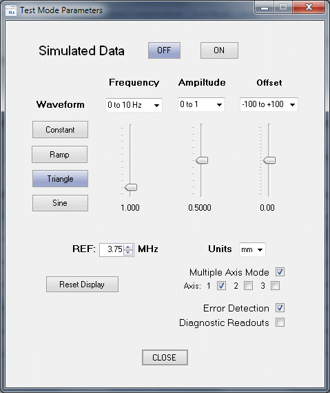

Note that while Test Mode will operate in Angle mode, the values it sends are always linear displacements. Thus, what this really means may be too difficult for the average human brain to evaluate and may result in an overload and an unintentional brain reboot endless loop. :)

Use the "#define Homodyne n" or "#define Heterodyne n" line in the firmware specify how many axes will be displayed. The value for "n" may be 1 or 3. Setting it to 2 will do the same thing as 3.
All GUI functions apply to the primary axis, which defaults on startup to Axis 1. The primary axis is what the Main Readout, REF/MEAS/DIFF frequency displays, frequency analysis, averaging, and graph apply to. Clicking on the Axis 1, Axis 2, or Axis 3 labels will select it to be the primary axis and change the color of the selected axis label to identify it as the primary axis. The units of the primary axis are also used for the others. Error detection (if enabled) only applies to the primary axis. Averaging is NOT applied to the Axis 1, Axis 2, or Axis 3 readouts, even the one that is the same as the primary axis.
Note that in Multiple Axis Mode, the communications format sends somewhat more data over the USB COM port and the GUI must perform more computation. Thus this may cause problems for a wimpy pre-Jurassic PC operating on the hairy edge of what's possible. Once Multiple Axis Mode is entered using the interferometer hardware, the only way to return to Single Axis Mode is to restart both the firmware and GUI. This is because neither has any way to know whether dropouts of measurement clock signals are due to a beam path being momentarily interruprted or an axis actually being shut off (whatever that might mean).
Test Mode is also capable of exercising all three axes singly or in combination but the function generator data will be the same for all. This is controlled by the Multiple Axis Mode checkbox. When enabled, Axis 1, Axis 2, and Axis 3 checkboxes will appear below it with Axis 1 being the default on startup. Turning Multiple Axis Mode off will put the GUI back in Single Axis Mode. But this will be overidden when Test Mode is turned off if the USB port is enabled and the firmware is running with multiple axes.
Multiple Axis GUI support has been under development for a semi-infinite amount of time. Specifications and behavior are subject to numerous changes without notice. ;-) However, no major features beyond what are described above are anticipated to be implemented in the GUI.
