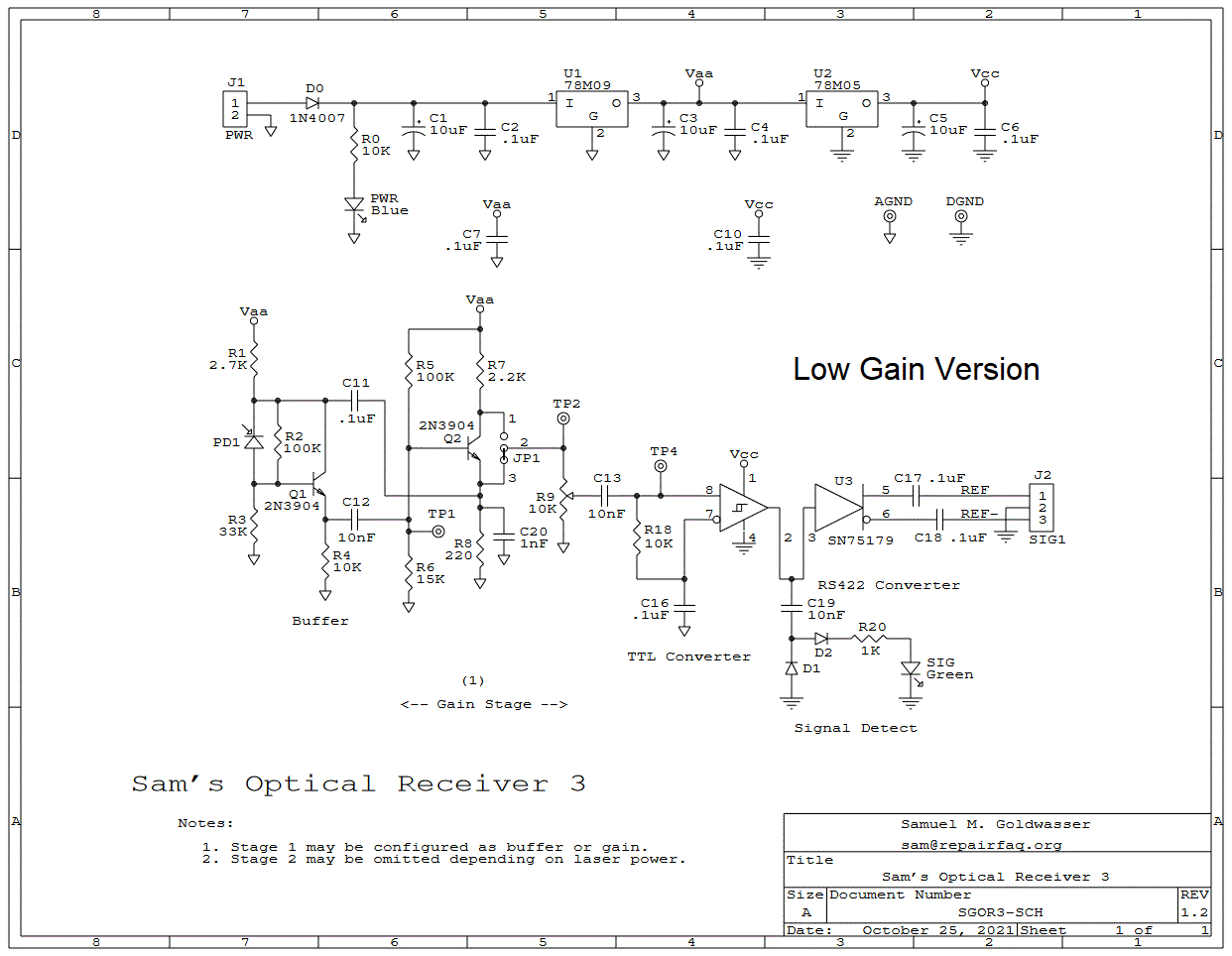

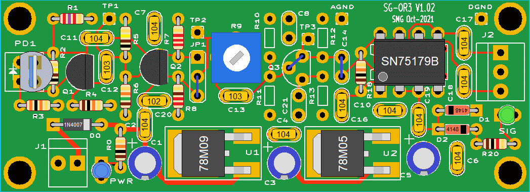

  1. Low Gain Version: Eliminate and bypass Gain Stage 2. Jumper the lower two pins of JP1:
    OR3: Low Gain Schematic
    OR3 Low Gain Component Locations

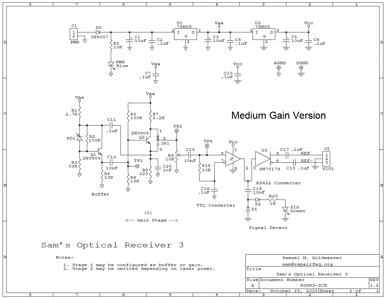

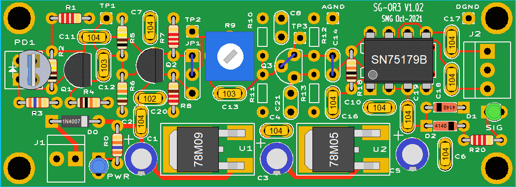

  2. Medium Gain Version: Eliminate and bypass Gain Stage 2. Jumper the upper two pins of JP1. This is the one that should work for most applications.
    OR3: Medium Gain Schematic
    OR3 Medium Gain Component Locations

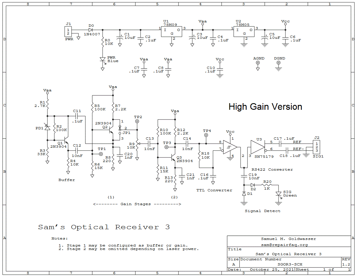

  3. High Gain Version: Jumper the upper two pins of JP1. Installation in a shielded case may be required to avoid interference from other sources.
    This is the same as the default schematic except for the jumper. It can also be set up similar to the medium gain version by jumpering the lower pins of JP1.
    OR3: High Gain Schematic
