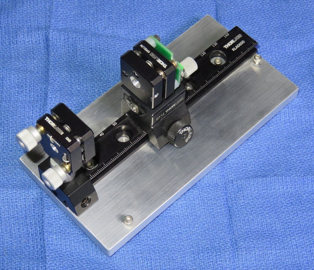

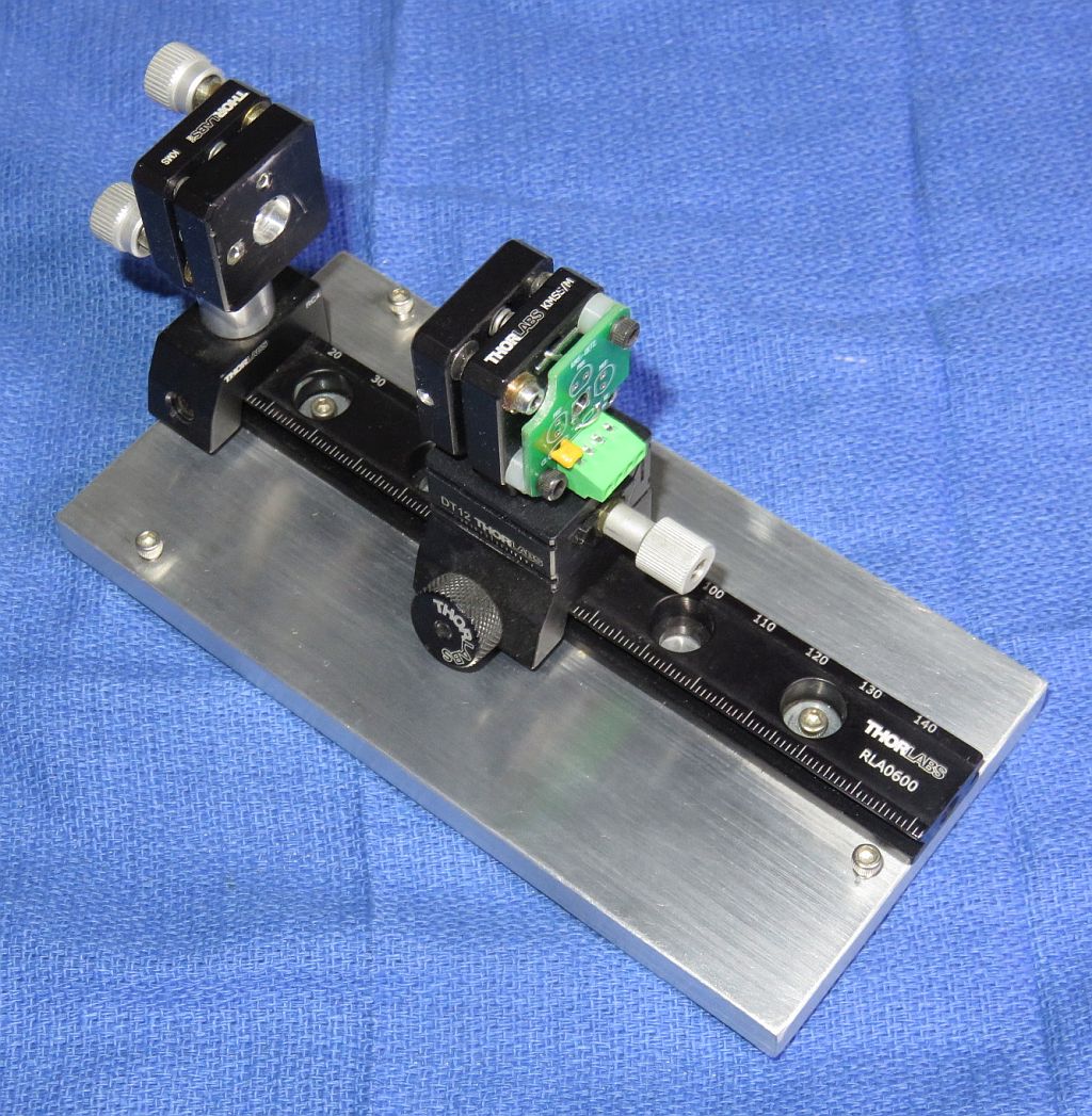

Selectable FSR SFPI using MGN12 Rail (left) and Thorlabs Rail (right)
And the version with the Thorlabs rail before installing the PZT, mirrors, and detector.
Prototype of Selectable FSR SFPI using Thorlabs Rail
The rails allow one of the mirrors to be positioned from the mirrors nearly touching to over more than 3.5 inches (8.89 cm), which is the spherical spacing and the largest one that is stable. The carrier may be locked in position so that fine adjustments can be performed using the micropositioner. The kinematic mirror mounts enable the alignment to be fine tuned.
The MGN12 ball bearing rail allows for very smooth movement but is more complex to assemble and locking is not quite as rigid as with the Thorlabs RC1 carrier. Everything is secured with screws except for the joint between the linear slide and MGN15 carriage, which may use 5 minute Epoxy. I was not able to drill a mounting hole in the steel carriage block. :(
