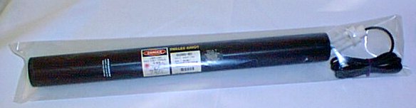

These are Melles Griot 17" long HeNe laser heads complete with 5 foot Alden cable. The tube is actually a Hughes design manufactured by Melles Griot (who bought the Hughes HeNe laser operation). The tube inside the head may be either a Melles Griot or Hughes style (most likely) but with the same specs. The tube part number is 3227-H-PC rated 7.5 mW minimum output power with most specs similar to that of the Melles Griot 05-LHP-171 but a bit shorter. Divergence = 1.1 mR, mode spacing = 400 MHz, linear polarization = 500:1. The output is a very nicely collimated TEM00 and has the highly desirable linearly polarization. Power requirements are approximately 2,700 V at 7 mA.

The tube inside most likely looks like the one in the photo, below (though a small percentage have normal Melles Griot style tubes with the same specifications. I will attempt to honor a specific request if available). Removal, if desired, is relatively easy as these things go. This provides easy access to the mirror mounts, both of which are adjustable (but watch out for the high voltage on the HR/anode!). Ask for details. CAUTION: No connection should be made to the mirror mount at the output-end of the tube - this will result in permanent damage after a few minutes of operation.
