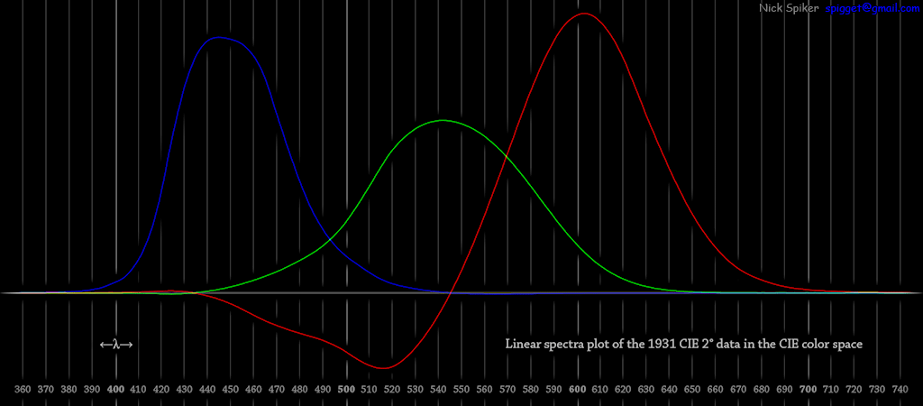

Now, on to reproducing an accurate color spectra on a standard display. In 1931, the CIE (International Commission on Illumination) decided to develop a standard for human vision. They took three monochromatic light sources and had a bunch of people adjust the brightness of the three primaries to match them with a particular color from the visible spectrum. The three primaries were chosen so that it roughly approximated the three types of color receptors (cone cells) in the human eye and were easily reproducible from a mercury vapor light source. The wavelengths of 700 nm (red), 546.1 nm (green) and 435.8 nm (blue) were chosen for the primaries. To match the colors, negative values of light had to be used. The reason for the negative values is because you cannot directly stimulate one color receptor without stimulating another. In order to achieve the negative values, white light was added to the sample of the spectrum to be matched until it could be matched with the three primaries. The amount of white light needed represents the amount to be subtracted from the three primaries.
2 Degree-CIE-Linear is a plot of the spectra into the CIE RGB color space as seen by an average human eye in a 2 Degree FOV and with no gamma correction applied. Once this data was obtained, it was translated into a new space which had the following properties:
