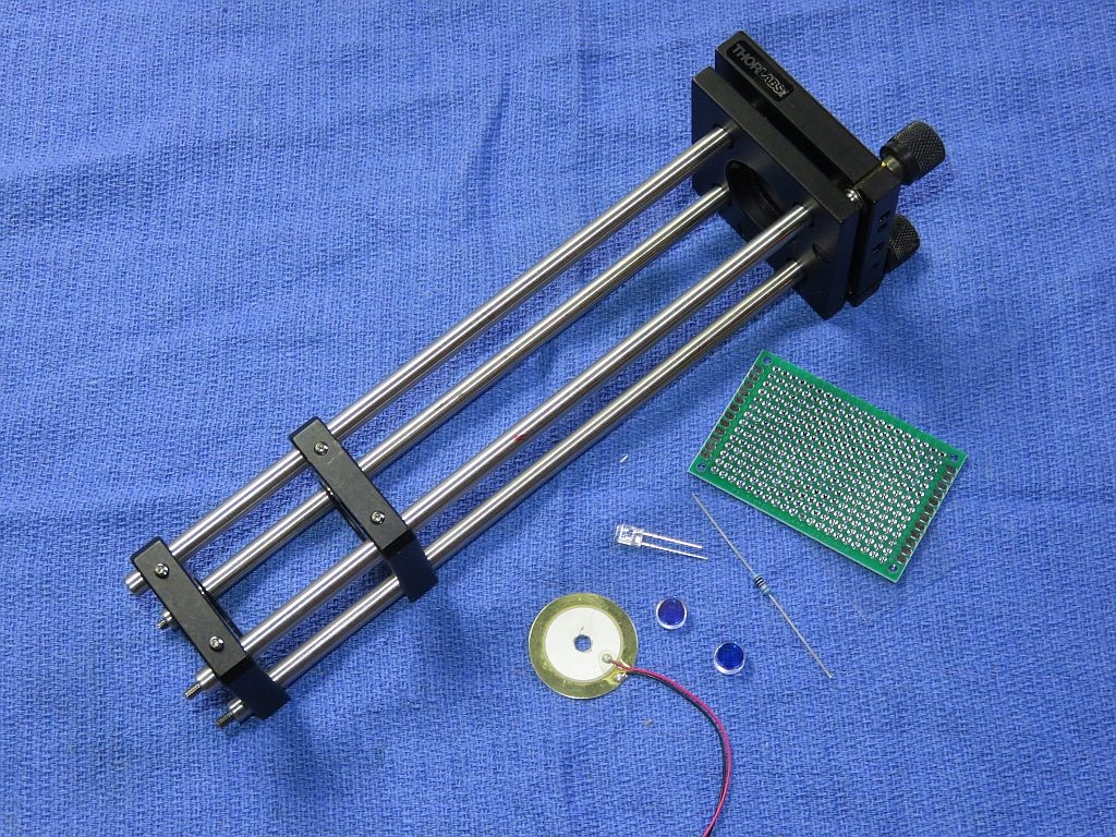

Completed Frame and other Parts for Typical Deluxe Planar SFPI

KC1 Adjustable Mirror Mount Preparation
The KC1 is used to mount the PZT/rear mirror assembly on its front side and the photodiode and its wires, as well as the PZT wires on its rear side. The best way to do this is to drill and tap three 2-56 holes on the front side for screws to secure the PZT/rear mirror assembly on its adapter ring and two 2-56 holes on the back side for the PD/wiring board. Take care with the photodiode as it's real easy to break off the leads. I recommend poking it through the Perf. board and immediately securing it with 5 Minute Epoxy. Then solder fine wires to the leads way from the body of the PD.
If you don't have a drill-press and are not familiar with using small drill bits and taps, it's probably best to consider some alternative. It's really easy to put holes in the wrong place at strange angles and to break drill bits and taps, which ends up making a mess because at the very least, it often impossible to extract the broken pieces. (Don't ask how I know.) Hot-melt glue or 5 minute Epoxy are also satisfactory.
The PZT/rear mirror assembly and Perf. board can be attached to the cage plate with 5 minute Epoxy, which is soft enough that it can be removed and replaced if the need should arise.

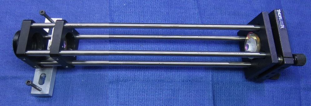

Completed SFPI on Three-Screw Adjustable Base (not included)
This shows an SFPI using a home-built adjustable front mirror mount (rather than the cage plate with adapter) as well as the optional iris diaphragm aperture. The rear mirror on PZT is glued to a piece of pill bottle which is then secured in the KC1 using its set-screw, though a short piece of 1" diameter metal cylinder woult be more rigid.
