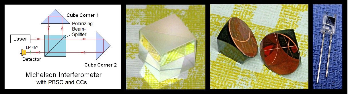

Mich3 consists of a 12.7 mm (1/2 inch) polarizing beam-splitter cube good for 600-670 nm, a pair 12.7 mm (1/2 inch) cube-corner retro-reflector trihedral prisms, a silicon photodiode (PD) to use as a detector, and a piece of linear polarizer (LP) sheet to be used for both forcing a random polarized HeNe laser to output a linearly polarized beam, and to combine the output of the interferometer on the PD.

The montage below shows the most basic interferometer layout and typical parts in this kit (except for the LP).
