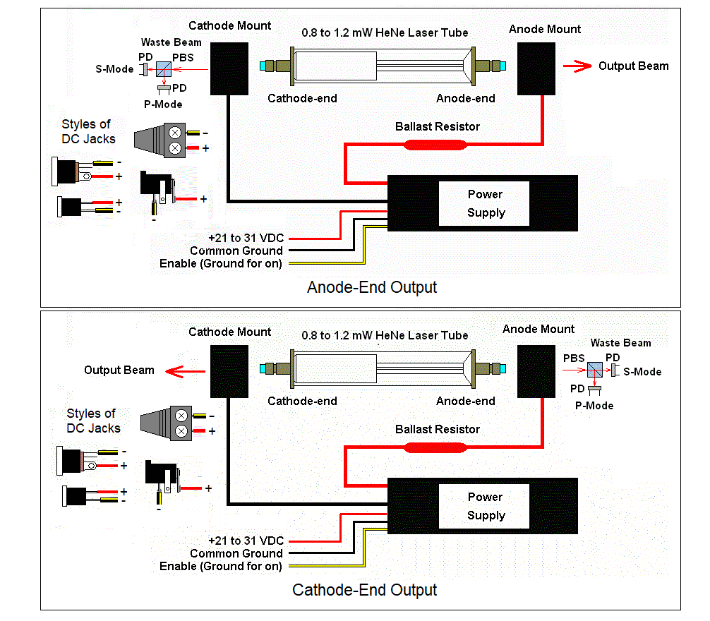

Instructions for Wiring the Laser Drive 103-23 HeNe Laser Power Supply
This is detailed info on assembling the Laser Drive 103-23 power supply brick
with ballast resistor(s) and tube mounting brackets.  The diagram below shows
the general arrangement.
Wiring the power supply
- Attach the thin red wire to the positive of the wall adapter.  Attach
 the yellow and black wires (tied together) to the negative of the
 wall adapter.  DOUBLE CHECK THE WIRING.  REVERSE POLARITY WILL BLOW
 THE HENE LASER POWER SUPPLY OR DAMAGE IT SUCH THAT THERE IS NO OUTPUT
 CURRENT REGULATION - WHICH WILL DAMAGE THE TUBE.  AND MAY BLOW THE
 WALL ADAPTER AS WELL.
 - A female power jack has been included with the kit which may be used
 if desired.  Otherwise, cut off the barrel connector on the DC adapter
 cord and connect directly to the wires of the brick
 Refer to the diagram above for the terminals on the DC jack depending on
 the style that you have.  DOUBLE CHECK POLARITY WITH A MULTIMETER BEFORE
 ATTEMPTING TO POWER THE BRICK AND TUBE!!!!
CAUTION: ALL INPUT WIRING MUST BE SECURED USING SOLDER, WIRE NUTS, OR
A SUITABLE CONNECTOR.  DO NOT JUST WRAP THE WIRES TOGETHER.  INTERMITTENT
CONNECTIONS BLOW STUFF.

Wiring using the brackets:
- If the output is from the cathode-end of the tube,
 there should be a hole in the cathode-end bracket so
 the photons can escape. ;-)  If not, it is possible to swap the two brackets
 or drill a hole.  But the bracket with the red wire MUST have the anode-end
 of the tube.

 - CAREFULLY lay the tube ends on the mounting brackets paying particular
 attention to polarity: The positive has the fat red wire and receives the
 anode (glass)-end of the tube; The negative has the fat black and receives the
 cathode (aluminum can)-end of the tube.  Make sure the anode-end bracket isn't
 too cockeyed to permit the beam from getting out of the hole. :) Make sure the
 tip-off (exhaust tube) at the cathode end clears the structure of the
 bracket.
 CAUTION: THE TUBE MAY APPEAR TO WORK WITH REVERSE POLARITY
 BUT WILL PROBABLY BE RUINED IN A FEW MINUTES.  Gently press the covers
 in place so they click and are secure.
 Take care to avoid stressing the fat red wires to the ballast resistor.
 If either breaks off, it may be necessary to replace the ballast resistor.
