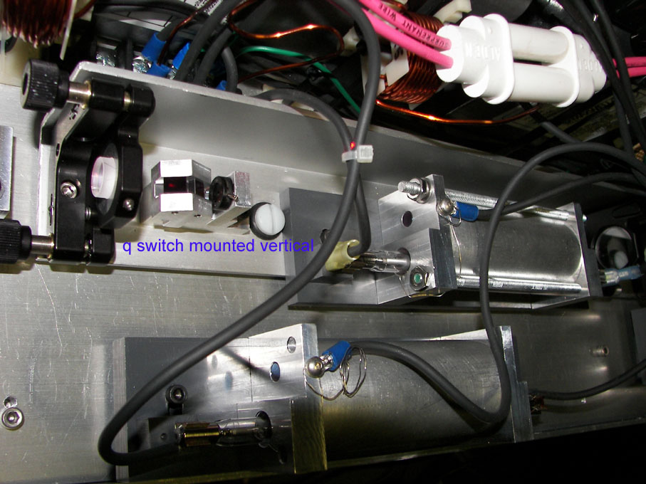

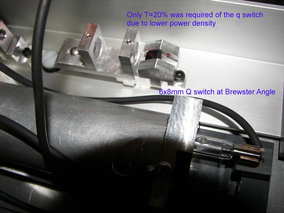

System after q switch was reoriented vertical and the amplifiers moved to make more room near the KTP. r5y1.jpg Closeup of q switch r5y2.jpg This brewster angle in the vertical plane orientation was found to create the best beam quality and brightness with the KTP crystal installed with the c axis vertical, the pencil dot pointed upward.
Version 4 had several issues. Cavity efficiencies were low in part due to cavity reflectors and this created a larger demand on pump power. This thermal load increased the thermal lensing effect, which increased the divergence of the system. This higher divergence lowered the power density of the system for conversion efficiency and 34 percent efficiency was all that was obtained. A beam reducer was tried including making more space for it, but it's optical surfaces helped to create parasitic oscillations in the amplifier chain. Obviously improved cavities could help correct some of the deficiencies noted above. Even with that the overall 1064nm output was around 250mj and was a basic limiting factor in reaching higher 532nm output as well.

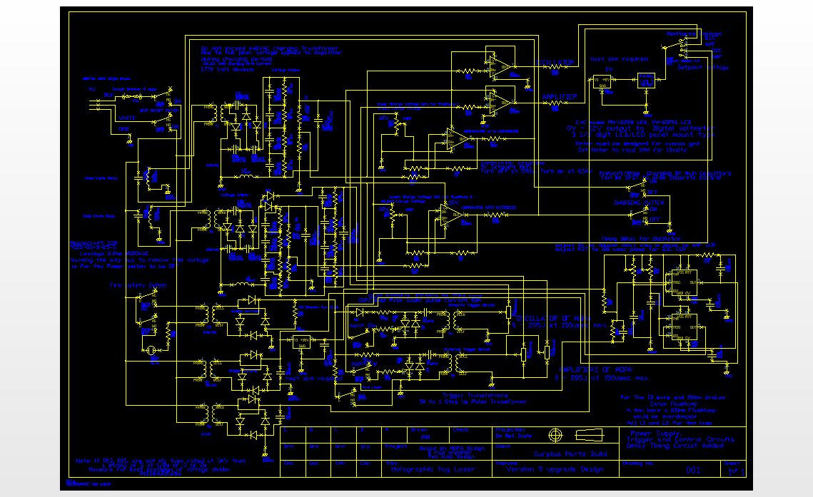

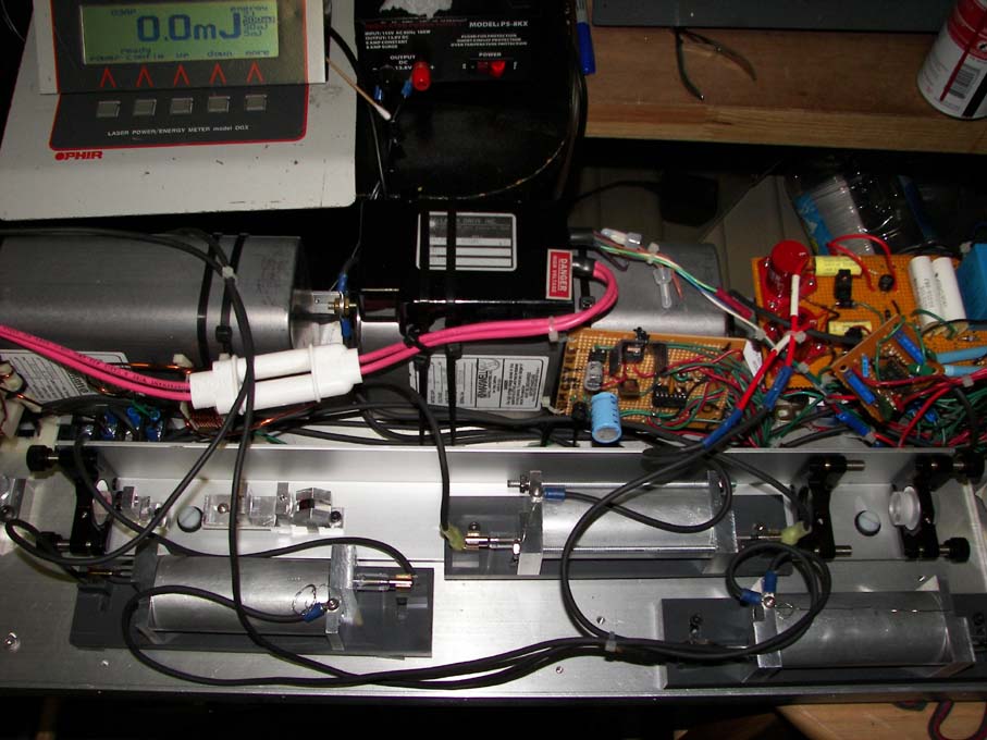

The first modification to be done is to time the oscillator to the amplifiers. It was noticed during the pump pulse that the q switch pulse arrived 100 to 120usecs after the flashlamp fired. It appeared the oscillator could still be delayed 50 usecs that would allow the amplifiers to achieve a higher possible storage. So a 556-delay timer was installed to allow the oscillator flashlamp to be fired between 10 to 100usec of delay from the amplifier flashlmap firings. Optimum settings was found to be a delay of 160usec from amplifier flashlamp begin time until arrival of q switch pulse or inother words almost near the end of the flashlamp pump pulse.

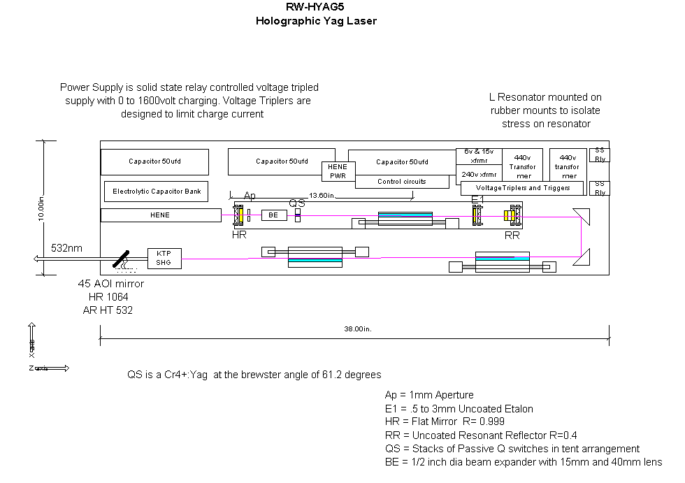

Basically the oscillator flashlamp was fired 50usec after the amplifier flashlamps were fired. With this setting the electrical pump to the amplifier could be reduced to 1200v at 132ufd from the previous 1550v. or down from 160joules to now 95joules of electrical input. Here the total system produced 220-250mj 1064nm and up to 86mj of 532nm output. Due to the reduced pump for each amplifier without loss of amplification, the total beam divergence was also reduced due to the lower thermal load. This modification was very important as it reduced the total pump power requirements to produce 250mj 1064nm and slightly improved divergence. Oscillator running at 75j electrical input was found to yield 5 to 7mj of single pulse. So before Osc 75j+160j Amp1 +160j Amp2 = 395j total pump requirement. Now the total system uses 75j+95j+95j=260j pump to achieve the same result. Here is the updated schematic with the 556 timer circuit added for delay of the oscillator flashlamp firing.yag5.dxf yag5.jpg Refer to version 1 regarding downloading a DXF viewer as this is the best way to see this schematic. A photo of the additional timer added:

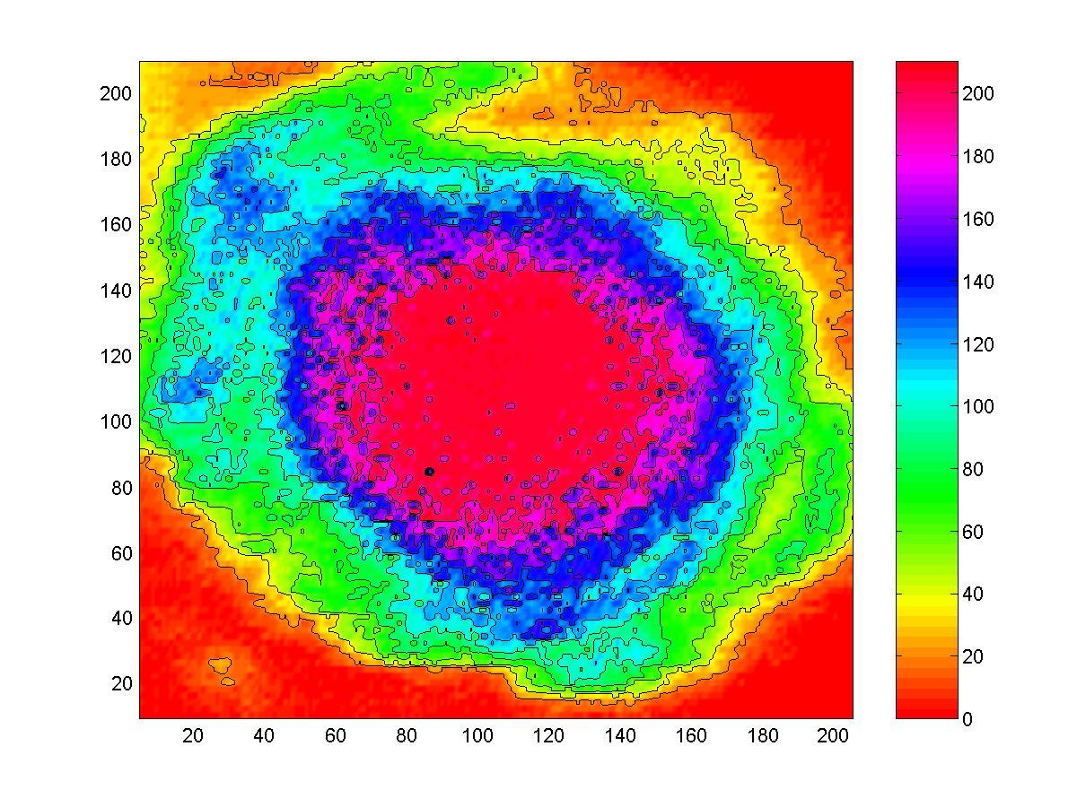

532nm testing indicated output polarization were at a ratio of 35 to 1 with the output polarization aligned horizontal. The KTP was mounted with the Dot marking up and the oscillator should have created P polarized vertical polarizaton due to the above mounting of the q switch crystals. But when the 1064nm was measured it appears it had almost equivalent output in both vertical and horizontal with vertical slightly ahead at a 1.27 to 1 ratio.

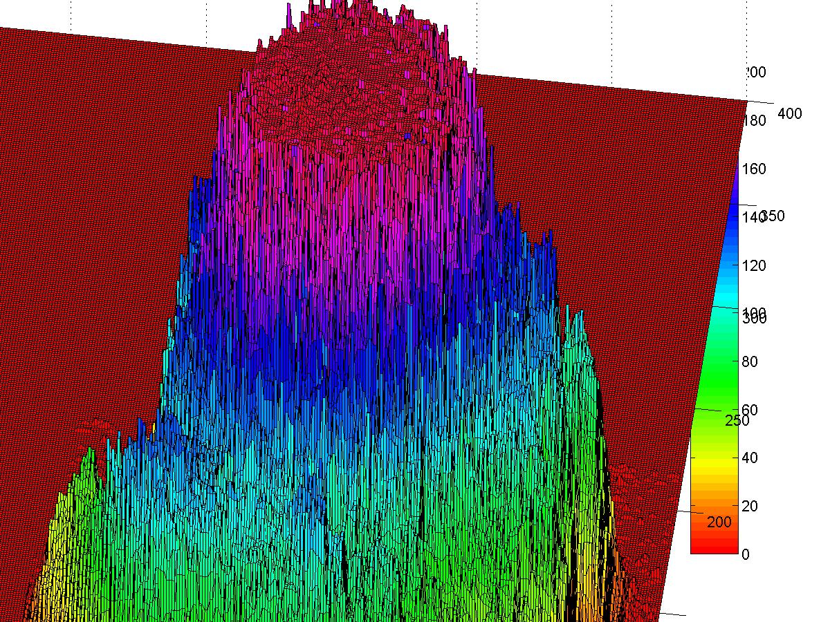

Single longitudinal mode was confirmed as the temporal envelope was completely smooth and no hint of second mode modulation on all pulses generated. Pulse width was confirmed at 10nsecs.Since SLM was confirmed and based on the observed spatial profile, the laser operated in the TEM00 mode.Images of the output beam quality with improvement due to lower beam divergence from the lower pumped amplifiers. Image: eyag1.jpg Image processing: eyag2.jpg eyag3.jpg

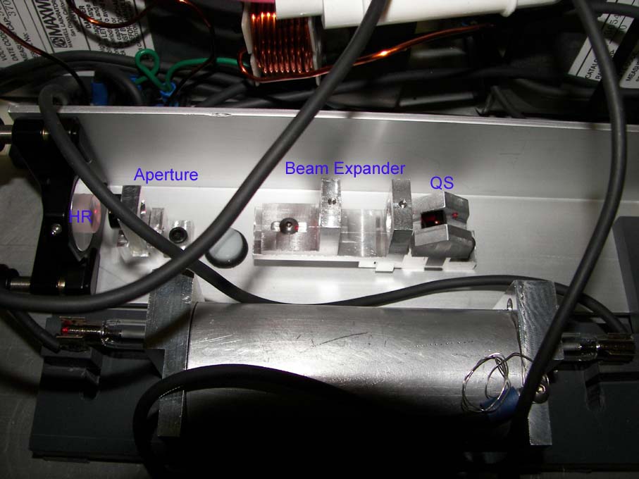

The laser oscillator upgraded to a telescopic resonator.

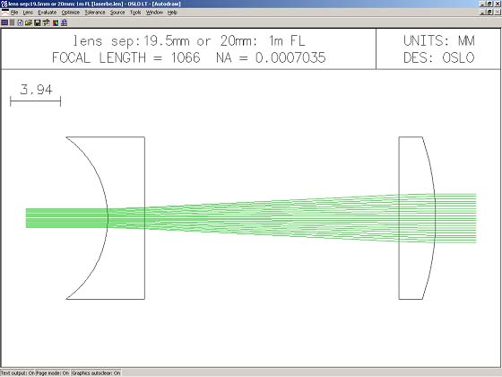

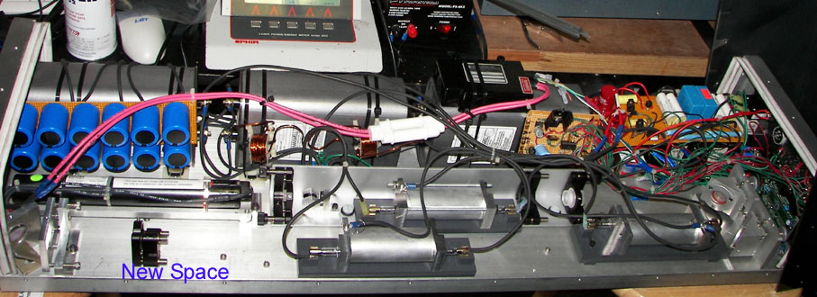

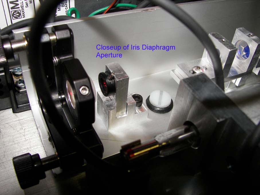

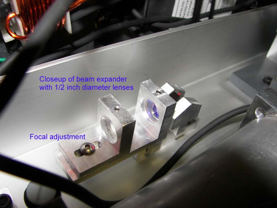

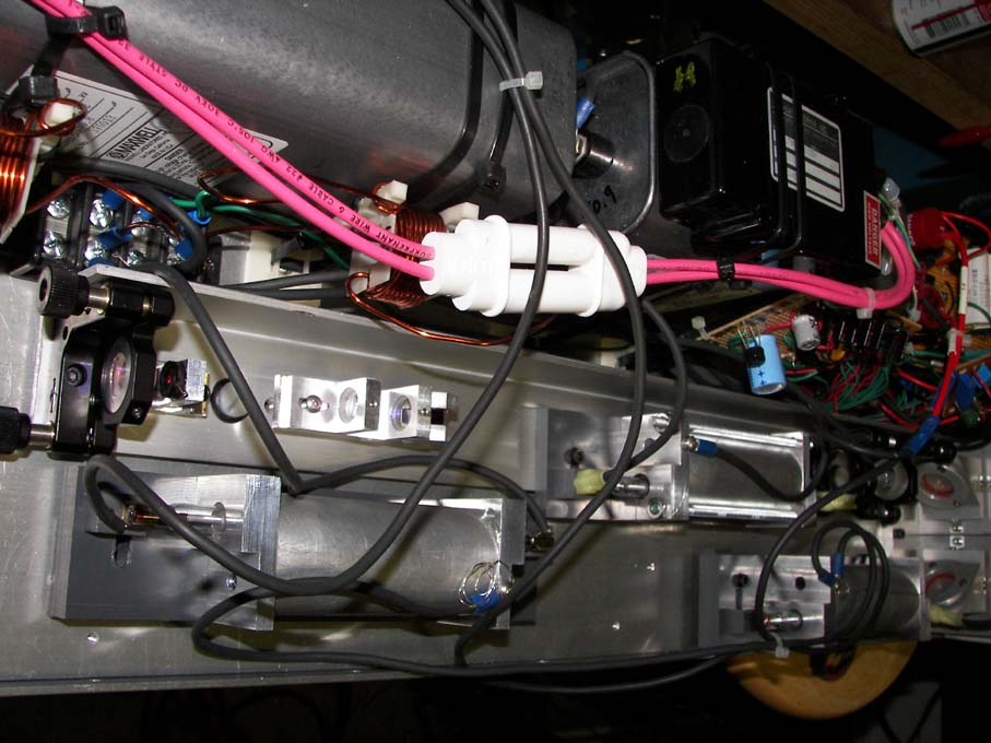

The goal is to get to 15mj of oscillator output and a beam expander will be placed in the resonator. Two lenses from CVI laser were ordered. PCB-12.7-7.8-C-670-1064 and PXB-12.7-19.6-C-670-1064. The first lens has a radius of 7.8 mm and the second lens has a radius of 19.6mm. Both of these lenses are ½ inch in diameter, 12.7mm. Both of these lenses when separated by 19.5mm form a 2.5x beam expander to increase the mode volume in the yag rod from 1.1mm to 2.8mm. The beam expander will be adjusted to also correct for some of the negative thermal lensing of the laser rod by increasing to 21 mm lens separation. lbe.jpg laserbe.len OSLO lens file. http://www.lambdares.com/downloads/index.phtml to download the free OSLO. Inorder to accommodate the beam expander etc, the laser resonator was increased from 13 inches to 19 inches long. The configuration of the laser oscillator: rwhyag5.gif Here is some photos of the new oscillator: to1.jpg to2.jpg to3.jpg to4.jpg to5.jpg to6.jpg The beam expander was machined to allow focal length adjustment with a button head 6-32 screw and embedded nutplate.X and Y positioning similar to the same technique for the q switch and aperture by using a 4-40 stainless set screw to hold in place. The lenses are held by 4-40 nylon tip stainless set screws. The beam expander can adjust the divergence of the laser beam and help to reduce the overall negative thermal lensing. The oscillator output was focused to 2mm and then the output of the system was 4mm , instead of the usual 6mm. This meant the output energy density went from 48MW/cm2 to 90MW/cm2 with regards to the KTP conversion.
The oscillator output was increased to 9.5mj to 13mj compared to the 6 or 7mj as before but since the beam divergence was better controlled the overall 1064nm output was less at 228mj compared to the previous 275mj before the oscillator was rebuilt. A single pulse event (actually as stated before these are actually two pulses 50-100nsecs apart) was achieved with a single brewster oriented q switch Cr4+:yag crystal of initial transmission at 20 percent. This was achieved with an aperture set at 0.046 inches diameter or with a fresnel number of 0.5. With a 0.060 inch diameter aperture and a fresnel number of 0.94 for the 19 inch long resonator, the output was closer to 16 to 18mj output.
