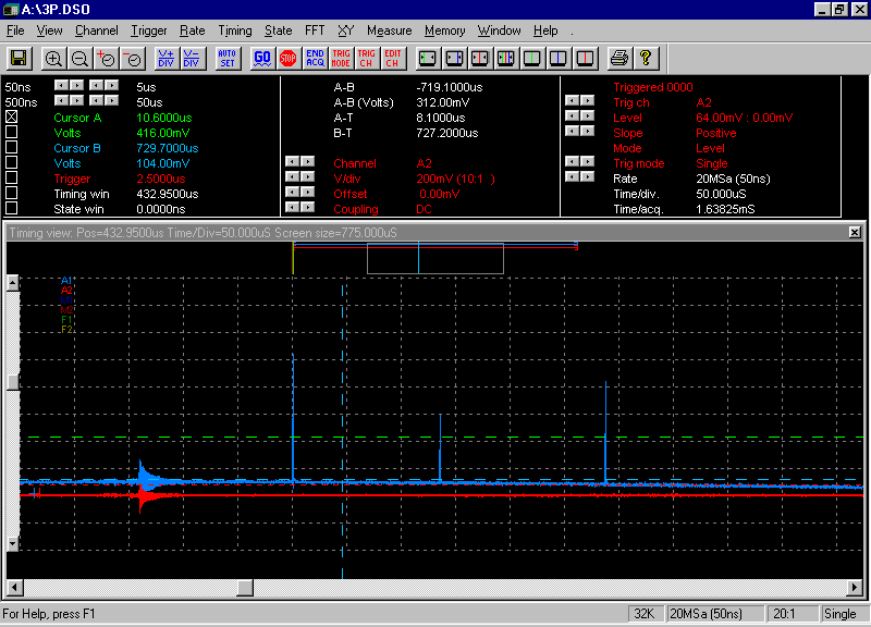

OUTPUT MONITOR FROM RW-MOPA 5
Prior to using for holography
Above is the output of RW-MOPA version 5 adjusted for triple pulse operation. Measurements like this give total and individual pulse magnitudes. Yet, from one firing of the laser to the next, these pulses vary in strength and separation by a small percentage. If the first pulse is larger, the second may be smaller, but total yield is similar. In this case, each time division is 50 microsecs, and the vertical is 22.47mj/div. The first pulse is 107mj, the second pulse is 135usecs later at 56mj, the third is 84mj and 155 usecs from second. Each pulse is 50 nano seconds long. Another type of measurement is done with two photometers to establish the relative magnitudes of the object beam and the reference beam using the dual channel capability of the DSO. Notice Link instrument's new DSO2102 oscilloscope software. Very nice!!! As a note: calibration of the vertical is done by getting total pulse energy measured by an accurate thermal head meter for example while capturing the pulse data and then taking the data, in this case as 11 total vertical units of the pulses divided into the output of 247.2mj as measured.
