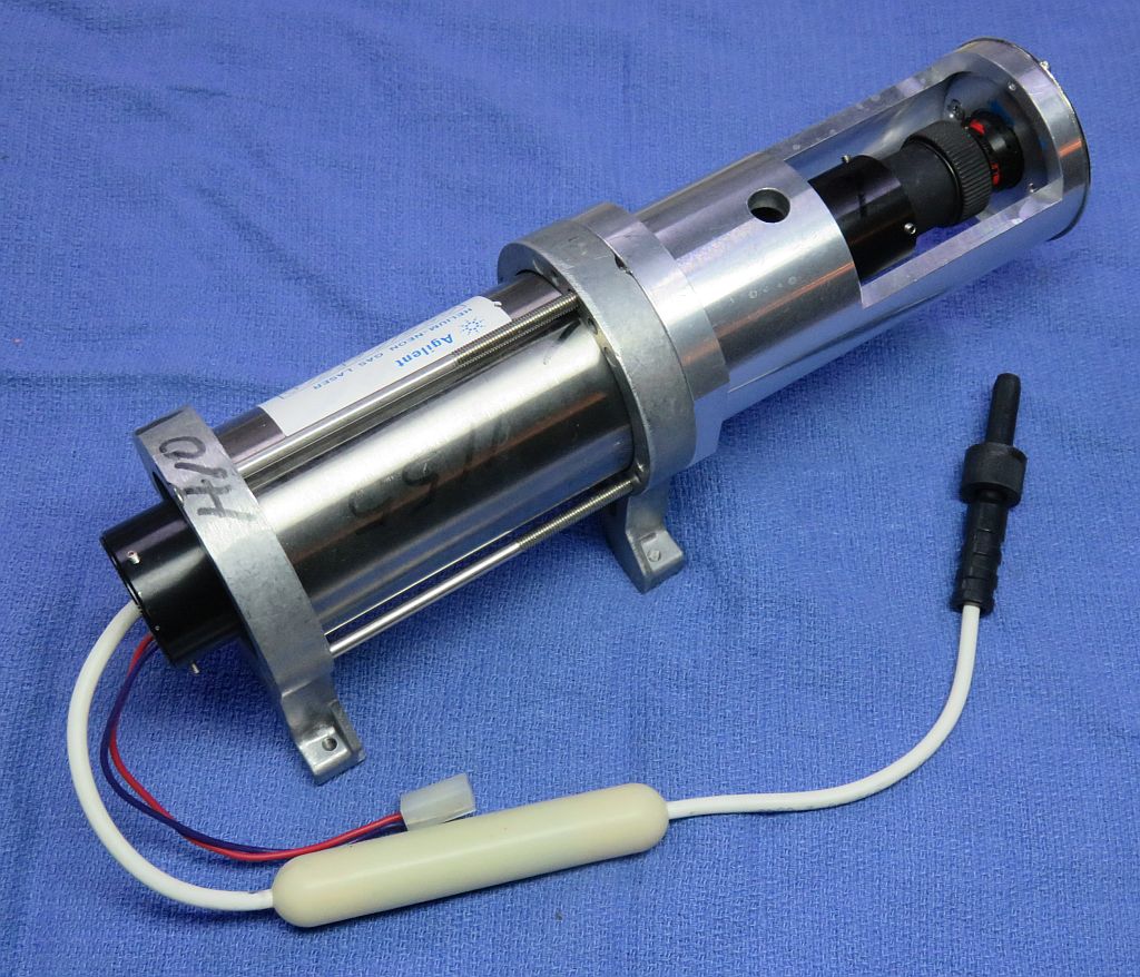

A photo of a typical tube assembly removed from an HP laser is shown below:

The differences in appearance of these tube assemblies are mostly related to the rebuilder's style. :) They have nothing to do with the laser model, split frequency, or beam size. While the N1211A (for the Z4203 Fiber AOM Laser) does have slightly different dimensions, the grossness of the frames, and bulbous optics mount on the second one, is inexplicable, except perhaps to make it difficult to install them in a 5501B or 5517! The conventional HeNe laser tube, magnet, and heater are physically similar.
(Note: I am not at liberty to divulge and/or am not even absolutely sure of the name of the companies who rebuilt these lasers or others I've tested, being either acquired from a third party or eBay, so please do not ask. There aren't that many doing this so a Web search should be able to locate them. The only one I can name is Pactec Second Source with whom I am affiliated. They can be contacted through their Web site or I can provide an email contact. DISCLAIMER: I receive a small commission on each rebuild.)
The HP/Agilent tube assembly consists of the actual glass HeNe laser tube, a permanent magnet, beam expander, and adjustable waveplates. The part that goes bad is the glass HeNe laser tube, which is mounted within the magnet using a rubbery potting compound. Rebuilding the laser tube will require that it be removed from the tube assembly as shown below:
This tube assembly was also from a 5517B, but there are some very minor physical differences, which are mostly of little consequence, among other models using the "Long" type tube. While the collimation of the output beam can be fine tuned by freeing up the knurled section of the black beam expander with a heat gun, it is not adjustable in terms of the beam diameter, and this may make it more difficult to match up with a non-HP/Agilent laser tube.

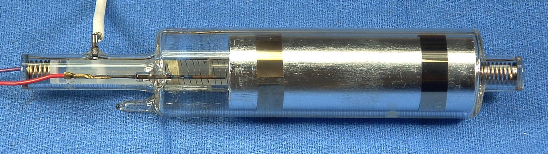

Rebuilding an HP/Agilent tube assembly can take two forms:
The second view shows the glass nipple at the bottom that would need to be carefully cut in a dust-free environment and attached to the vacuum/gas handling system.
This glass laser tube is normally not considered a separate replaceable component, only the complete magnet/optics assembly (with the tube). And Agllent probably won't sell the tube assembly to a third party anyhow. While most other parts of the the currently supported lasers may be obtained at highly inflated prices direct from Agilent, laser tube assemblies are listed as: "Not orderable, contact Agilent for repair service". And even if they could be ordered, the cost would probably be nearly the price of a new laser, if not more.
Removing the glass tube intact from the tube assembly is the sort of thing that anyone in their right mind would only attempt at most once unless appropriate noxious chemicals are available to dissolve the potting compound without damaging anything else in the assembly (except that they likely rot human internal organs). Mechanical removal using piano wire, saws, knives, and other instruments of torture is possible, though extremely tedious and time consuming for most of the lasers with tubes that conform to the diagram, above. Even the trained monkeys hired to do this would consider it cruel and unusual punishment and quit after 1 or 2 tubes despite the promise of unlimited bananas. :) For all tubes, it might be possible to simply cut the magnet lengthwise with a low vibration high speed diamond cutoff wheel, and then replace the magnet with a new one. Once the magnet is gone, it's relatively easy to pick and peel off the potting compound. While the glass tube is physically the same for the 5517A, 5518A, and 5519A/B, removing it requires cutting apart the outer casing. But, if the glass tube is to be reused as with regasing, the extraction must be done with great care to avoid damage to the glass envelope or internal components. Otherwise, a hammer and chisel will suffice. :-)
The benefit of regasing is that most of the vital original parameters of the special HeNe laser tube are preserved, especially if it is replaced in the same magnet/optics assembly at the same orientation so that no adjustments of the waveplates are required. Thus, the beam diameter and divergence, and the stability of the internal heater should be unchanged. However, without knowing the original isotope ratio and gas fill pressure, there could still be differences in optical frequency, split (Zeeman, REF) frequency, and other parameters. While the cavity loss and Zeeman magnet strength probably have the dominant effect on the REF frequency and are likely the primary means of setting it for lasers up through the 5517D (4.0 MHz max), both the isotope ratio and gas fill pressure have a dramatic impact on the optical frequency of the center of the neon gain curve. And either of them (though especially the isotope mix) could affect the effective width of the neon gain curve, and this impacts the mode pulling that gives rise to the Zeeman split of the central longitudinal mode, and thus the REF frequency. Based on data from industry sources, it appears that HP/Agilent lasers use a gas-fill that is weighted toward 20Ne to narrow the gain bandwidth.

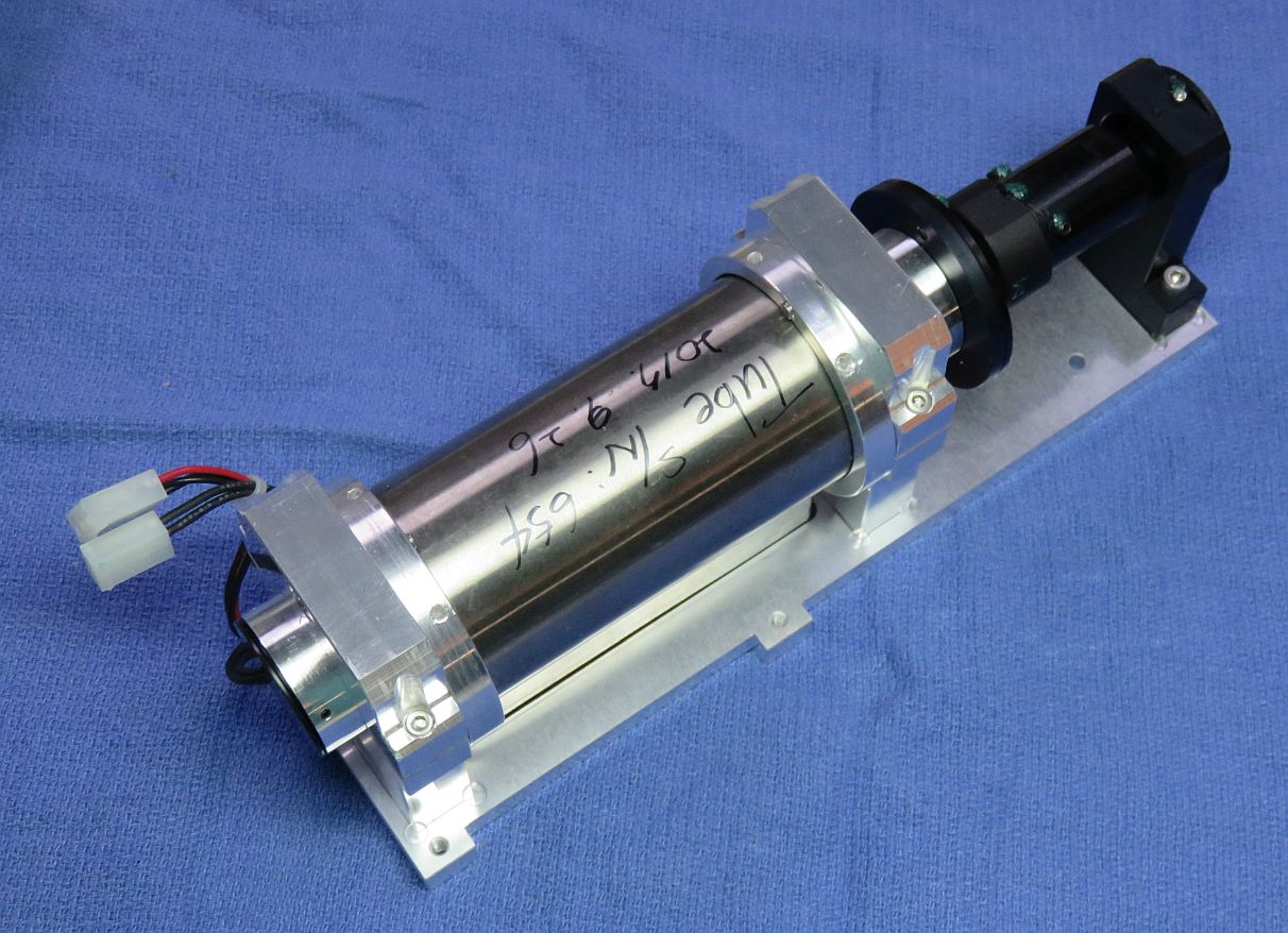

A typical conventional 6 inch HeNe laser tube is shown below:
Then, a heater with electrical characteristics similar to those of the heater in the original tube must be installed on the exterior of the replacement tube:
The tube above was actually mounted in the magnet assembly from an HP-5501A laser (because that was available) and installed in a 5517D laser chassis (because that was available). It locked and produced a usable output, though at a REF frequency of only 1.2 MHz. Normally, a 5501A would be between 1.5 and 2 MHz, but due to the use of the standard tube, the REF frequency was lower.
When a similar tube was installed in the magnet from a 5517B laser which normally has a REF frequency of 1.9 to 2.4 MHz, it produced a beat frequency of only about 1.3 MHz max. But these two tubes had been selected for high output power. When the rear mirror was deliberately misaligned to reduce the output power, it was possible to obtain REF frequencies from 1.5 to 2.4 MHz at somewhat lower, but still very decent output power. This would exceed the HP/Agilent minimum power specification by a factor of 2 or 3 when set for the 5517A or 5517B REF frequency, and still be comfortably above it when set for the 5517C REF frequency. It might be possible to reach the range for the 5517D (3.4 to 4.0 MHz), though that my be marginal. So, in a pinch, a standard tube might work, but would be a less than optimal solution due to the much lower life expectancy of the typical small HeNe laser tube - 12,000 to 16,000 hours.
A tube with a mirror adjuster added was then installed in the magnet assembly from the 5517B laser shown above, and that was installed in the 5517B body as shown below:
After adjustment of the waveplates, it produced a good MEAS signal, in fact actually cleaner than that of the commercially rebuilt laser described below.
