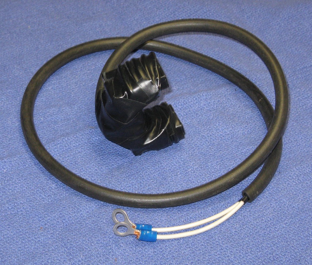

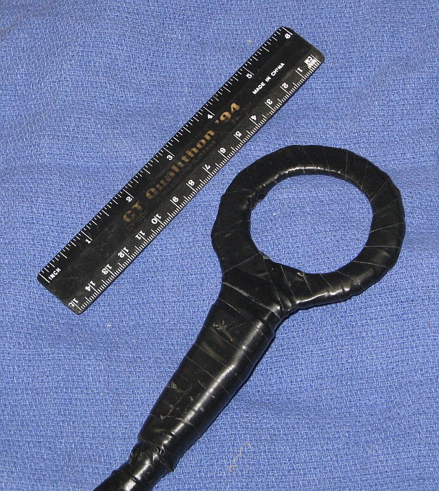

Unless otherwise noted, the following air-core coils run fine.
Coil 1: 2 x 21T, 3" D

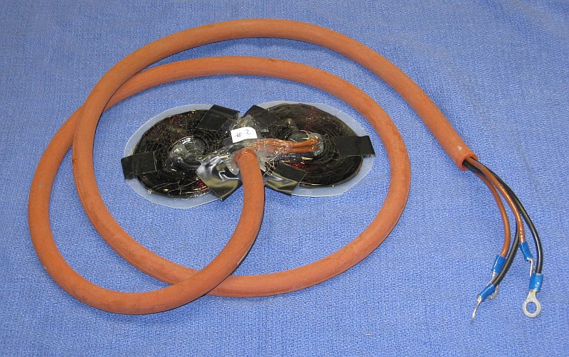

Coil 2: 2 x 15T, 2.5" D, Pancake

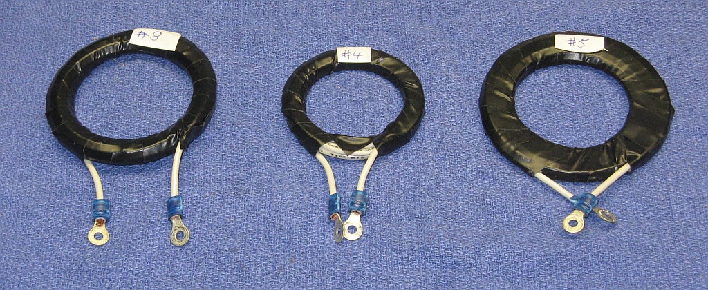

Coils 3-5: 10T, 2.5" D; 6T; 2" D, 10T; 2x5T,2.5" D
Coil 6: 2x5T, 2.38" D

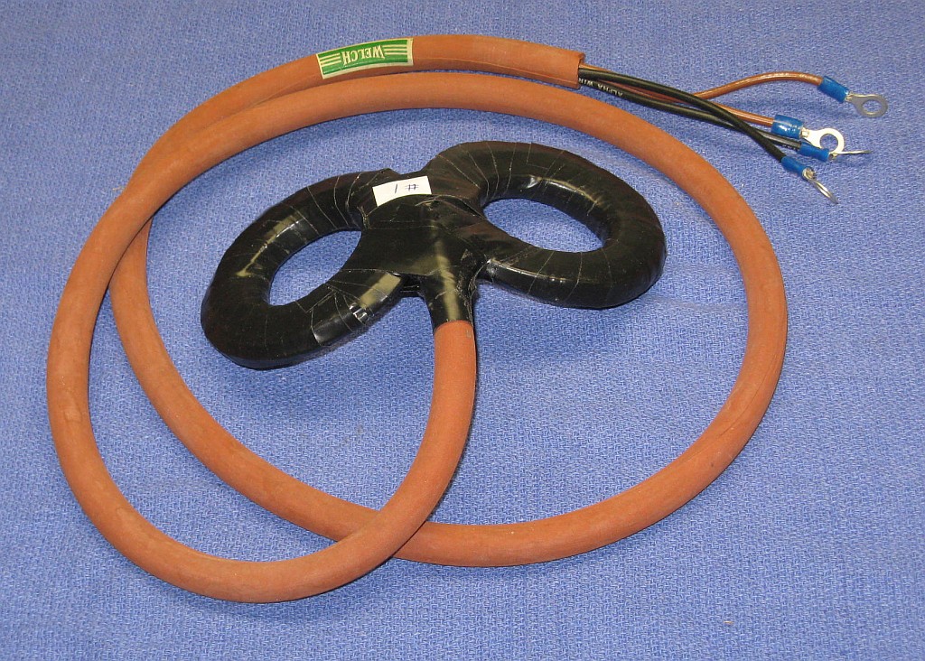

The one below was made using laminations from an unidentified power transformer with the center leg cut off. But it was a total disaster either due to core saturation or too many eddy-current losses and blew the free-wheeling SCR on the first shot even though it wasn't even being used for the monophasic pulse.
Coil 8: 12T on Laminated 2x3" C-Core
