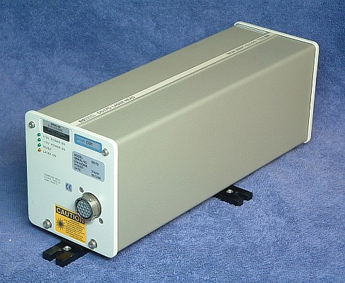

The HP/Agilent 5517 or 5501B Metrology Laser
These are red (~633 nm wavelength) HeNe lasers producing two optical frequencies differing by anywhere from 1.5 to over 7 MHz depending on model. The two frequencies are denoted F1 (lower frequency) and F2 (higher frequency). For all the 5517s (and 5518A and 5519A/B), F1 is horizontally polarized and F2 is vertically polarized. For reasons probably no longer known to anyone on the Planet, these were reversed for the 5501B and earlier HP metrology lasers. The exact wavelength has 6 more significant figures but for our purposes they are both red. :) And since there is nothing that can be done to alter the optical frequency once the tube is rebuilt, it's not something that is worth measuring. However, once the laser is put back into service, a full dimensional calibration will be required as there is no guarantee that a rebuilt tube will operate at exactly the same wavelength as the original HP/Agilent tube to all those significant figures. Even so, environmental factors like temperature, humidity, and pressure have a more significant effect on measurement calibration than any conceivable change in optical frequency.
Typical HP-5517D Metrology Laser

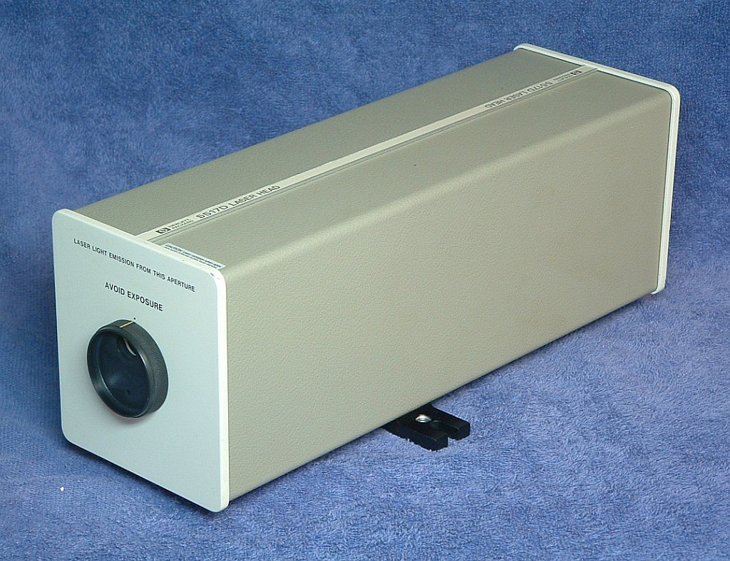

The general appearance of all the 5517 and 5501B lasers is similar, but those made by Agilent after around the year 2000 have a cheesy metal shroud in place of the 2-piece gray cover. The 5517B, 5517C, and older 5517Ds, as well as all 5501Bs have a physically similar tube assembly with a "long" glass laser tube. The procedure below is written for those. Some newer 5517Ds, and the much less common 5517E/F/G lasers use a "short" glass tube, but are otherwise also very similar. But minor modifications to the procedure will be required for those if the time comes.
The first step in the tube extraction process is to remove the laser's feet (if present) and laser cover. The feet are removed since accurate positioning of the laser for checking and setting beam alignment requires the screw holes on the baseplate of the laser. It would not be precise enough with the feet present.
The feet simply unscrew, but on some lasers, they are quite tight. Clamping a recalcitrant foot in a bench vice and rocking it back and forth is usually is effective to loosen it.
If there is a shutter wheel on the front of the laser, rotate it so the large hole is at the bottom. The flat-head screw engages a quarter-turn fastener. Use a flat-blade screwdriver that just fits the head and press it in and turn it counter-clockwise 1/4 turn. The screw should pop out (but remains captive) and the front plate will come off. Then, where there are covers as above, they can be spread apart to remove. On the newer lasers, there is a rubber gasket of sorts all around the metal shroud, so some force may be required to push in the front plate to allow the screw to turn. Then spread the bottom apart slightly and slide it off. Take care to not get it hung up on any components on the control PCB. For a pre-2004 laser, the result should be very similar to the photos below.

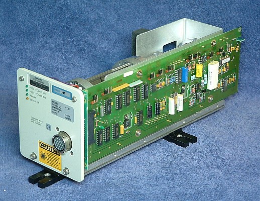

HP-5517D with its Cover Removed
Most newer Agilent use a control PCB with mostly surface mount parts but it essentially emulates the older one so very little changes as far as tube replacement is concerned. A very few 5517s have a third type of PCB. And some newer lasers have an additional sheet metal cover inside that necessitates a different tube assembly removal process. Deal with those on a case-by-case basis.

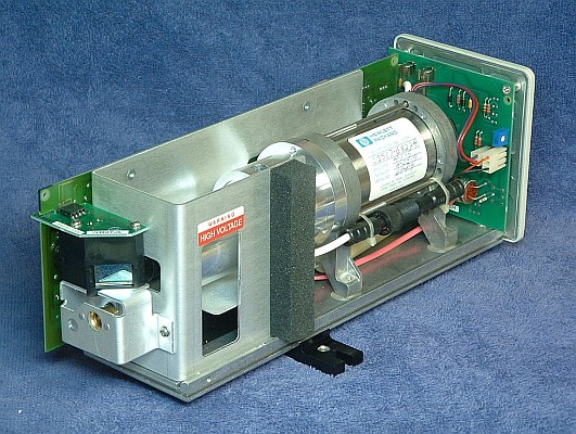

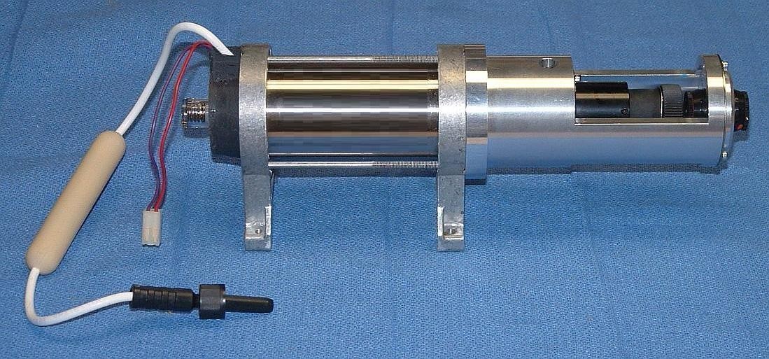

The next step is to remove the tube assembly from the laser. A typical sample is shown below. Some details may be different on yours like the method of securing the magnet assembly (the 3 long screws) and the style of the beam expander. But in general, it will be almost identical in all other respects. On the left are the high voltage (HV) connector and 2 pin cathode/heater connectors. The back-end of the glass tube is sticking out the back. The large shiny object is the Zeeman magnet. The black beam expander and waveplate assemblies are at the right.
Typical HP/Agilent 5517B/C/D and 5501B Laser Tube Assembly
Removal requires cutting any cable ties, disconnecting the black high voltage connector and unplugging the 2 pin cathode/heater connector, and taking out the 4 screws below the baseplate. It should then be possible to maneuver the tube assembly out of the laser body.
Note: If there is a plastic cover on the back of the tube assembly, it has a "short" tube. The procedures to replace it differ in minor details but should be similar to those for the "long" tube assumed here.

Our ultimate objective is to break it down (no pun intended...) to its component parts without literally breaking anything:
Components of a Typical HP/Agilent 5517B/C/D and 5501B Laser Tube Assembly
(The exact style of the beam expander and some other parts may differ slightly depending on the model and age of the laser.)

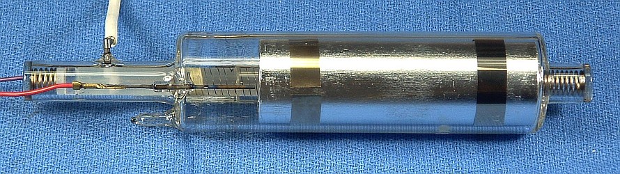

Once the front section has been pulled off, it's time for the main event - removal of the potting compound from between the tube and magnet.
  1. Use an Xacto knife or single edge razor blade to slice away the potting compound at the back of the tube so that what remains is a cylinder about 5-7 mm smaller in diameter than the inside of the magnet. DO NOT make it any smaller as the remaining potting compound will serve to protect the remains of the fragile glass tip-off and feed-throughs during the tube removal process.
  2. Now if you weren't having fun up to this point, here's your chance. The idea is to get in between the tube and magnet and pick away at the potting compound one bit at a time. This is by far the most time consuming and boring part of this entire operation. My principle tool is a 1/16th inch hex driver. Unless the tube is way off-center, this can get in in the confined space easily and with care, will not damage the tube. But don't force anything! Take your time. (I can hear the trained monkeys already complaining.)
    Work from both front and back but avoid going toward the center in the back to prevent damage to the fragile tip-off and feed-throughs. Didn't I say that already?
    (Note that if this is an older 5501B, then the magnet consists of 4 segments. Working from the front, it's much easier to go one segment at a time and then remove that magnet and set it aside. However, don't get carried away removing the last segment at the back. It is still possible to damage the glass tip-off or feed-throughs or break the tube! But all lasers made after about 1992 have one-piece magnets.)
  3. Once first contact is achieved - meeting of the excavation so that a thin tool can be pushed all the way through - it will go faster. Then, the idea is to work around the circumference until somewhat over 1/2 of the tube is free. A piano wire or coping saw blade may speed this process, though I haven't tried them. Eventually, with some wiggling, the entire tube should come free. It will have a lot of potting compound debris stuck to it but be intact.
  4. Use a single edge razor blade or Xacto knife to carefully peel away the remaining potting compound from all nooks and crannies of the tube. Be particularly cautious in the are of the anode, tip-off, and feed-throughs. It's still possible to screw this up!
  5. The result should look something like the photo below except perhaps that the wires are cut short.
    Typical HP/Agilent 5517B/C/D and 5501B Glass HeNe Laser Tube

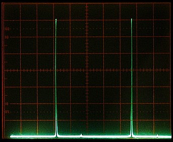

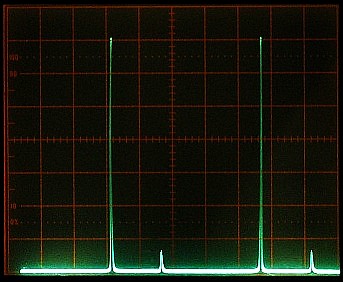

Testing for Single Longitudinal Mode Output
At this point, those who are anal retentive would want to test the output of the tube to assure that only the desired longitudinal mode is present. The presence of significant power in the second longitudinal mode that's lasing (but should be blocked) can potentially result in small positioning errors over distances on the order of 10s of cm. How large the output power in the second undesirable mode needs to be before this becomes an issue isn't known. And I've seen at least one almost new HP/Agilent laser that had one.
The test will require the use of a Scanning Fabry Perot Interferometer (SFPI, also known as a laser spectrum analyzer) to display the mode structure of the laser. As a practical matter, there isn't much that can be done if a rogue mode is found, so as long as it is small (2 percent or less) ignore it.
Scanning Fabry-Perot Interferometer Positioned in Front of Laser
While the photo shows the SFPI very close to the laser, it's better to Position it further away since alignment that results in the best display will result in a reflected beam directly back to the laser. There is the potential for that to destabilize the laser causing it to lose lock. Keeping it just a little bit off-axis will help greatly, and positioning the SFPI head further away will make this easier. A distance of a 2 or 3 feet would be more than adequate. Having said all that, it worked fine as pictured. :)
Adjust the SFPI mount so that the laser beam is centered on the SFPI input lens. For the height, use shims under the laser or SFPI mount if it is not adjustable.
For a typical SFPI like an SP-470 head attached to an SP-476 driver, attach the cables as follows. Adhere strictly to the color code if available.
The controller should be set for "Free Run", maximum sweep rate (Time fully CW), X1 Dispersion, with the Variable and Centering controls about mid-range.
The scope should have the Vertical Amp (green) going to Channel 1, Trigger Out (yellow) going to Ext Trigger or Channel 2 (with the scope set for triggering using Channel 2). Start with Vertical Gain second position from CCW and Variable centered. On the rear panel, the slide switch above the HV Scan Output should be set to low or 300 V and the Blanking Output control should be set fully CW. With these settings, there should be something on the scope if alignment of the SFPI head is reasonable. Fine tune alignment for maximum amplitude and adjust controls for appropriate horizontal and vertical display. Refer to the SP-476 Operation and Service Manual for more details.
Scanning Fabry-Perot Interferometer Display of Laser Output After Locking - ~8% MM, ~1% MM, Pure SM
The three photos shows varying degrees of rogue modes. The one on the left has a unwanted mode at about 8%. This would be really bad and unlikely to occur unless a tube susceptible to rogue modes were installed in a much stronger magnet than it was in originally. Or, an inappropriate non-HP/Agilent tube were used. The center one is about 1% and while not optimal, is probably acceptable. The one on the right is 100% pure SM, which is the way most HP/Agilent lasers are built.
Note that single peaks like those in the photos are a deception. There are actually a pair of peaks separated by the REF frequency, but they are too close together to be resolved by the SFPI.

Optional: Set up the laser with a polarizing beam splitter, dual photodiodes, and PC-based data acquisition system, and capture output at a minimum 50-100 samples per second for 24 hours or more. Inspect the data to assure that there are *NO* mode flips, glitches, or other unsightly blemishes in the laser's output power for either polarization after the laser has locked. This would catch infrequent (but fatal in terms of performance) problems in the HeNe laser power supply, ballast resistance, or wiring, problems with the control PCB; or a misbehaving tube. A recording laser power meter can also be used, but it will not likely have a high enough sample rate to capture short events. Here are the most likely symptoms and causes:
  1. Glitch (dip) in both polarizations: Possible laser tube current dropout due to high mileage tube, or high (increased from use) value or nearly open ballast resistor. Both of these would be very unusual.
  2. Loses lock and re-establishes: The temperature set-point is incorrect, defective control PCB, defective heater inside tube or bad connections to it, defective DC power suppl(ies).
